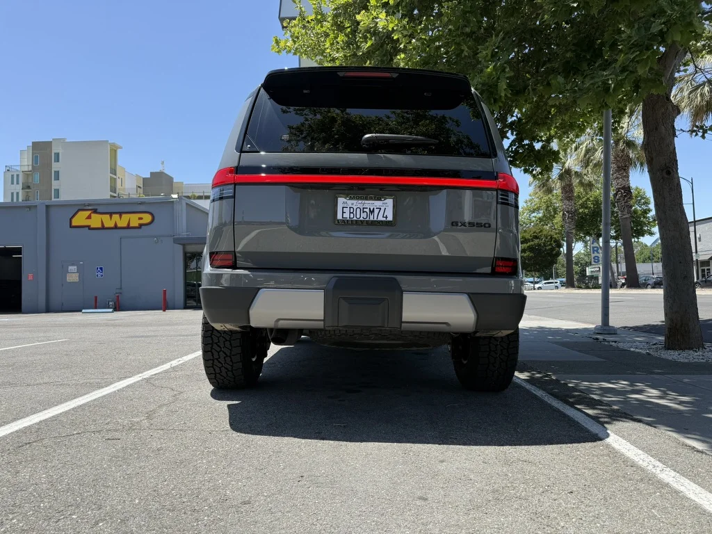

First picture is stock spare.

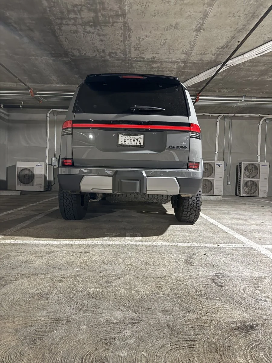

Second picture is a 285/75/17 (Wildpeak AT4) - definitely lost some clearance with such a wider tire, but at least I'm able to fit a 34" (barely).
