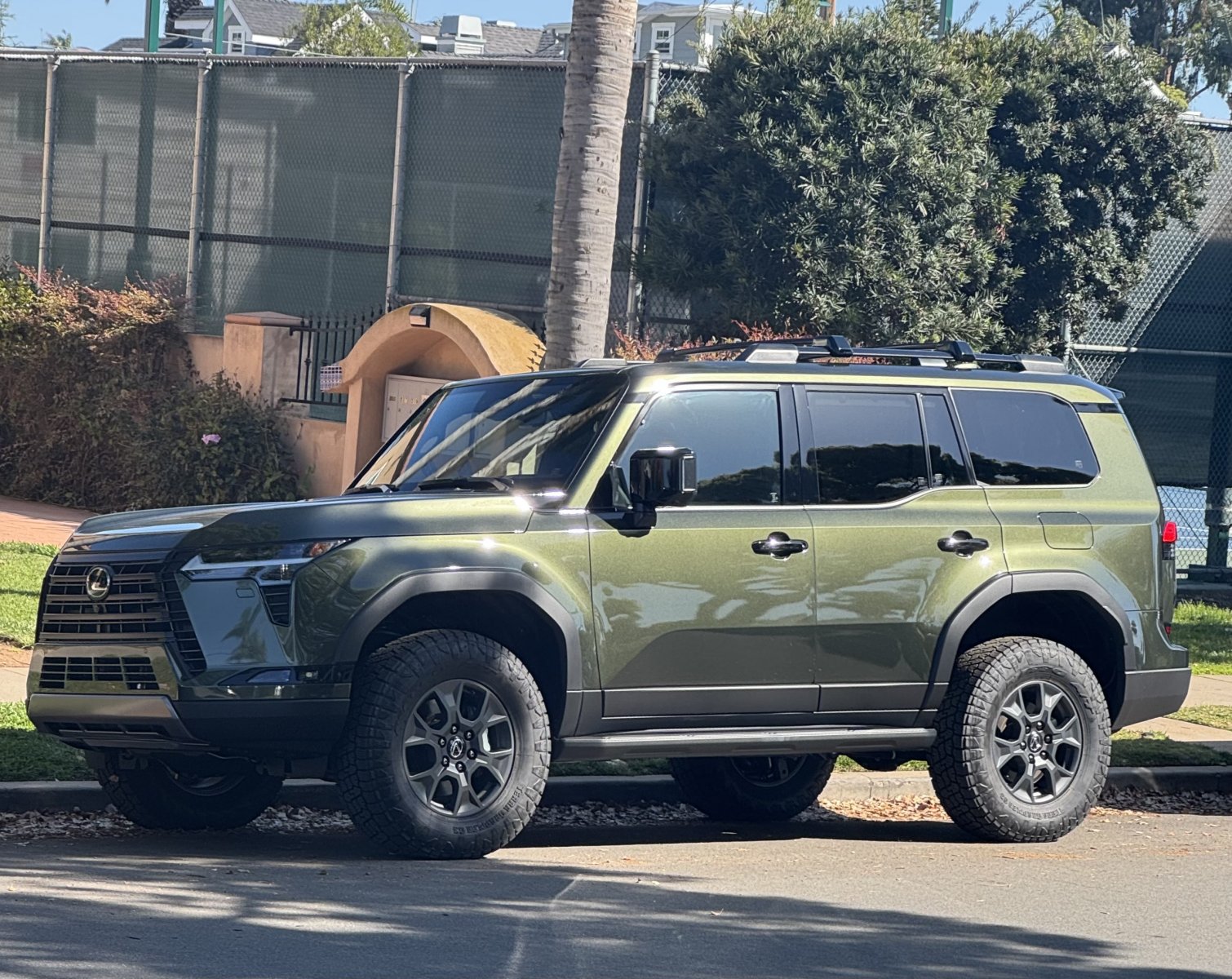

I’ve heard some say 285/70r18 will fit, but I went with 275 Nitto Terra Grappler G3’s since it was the largest size in an SL rating. No lift or rub

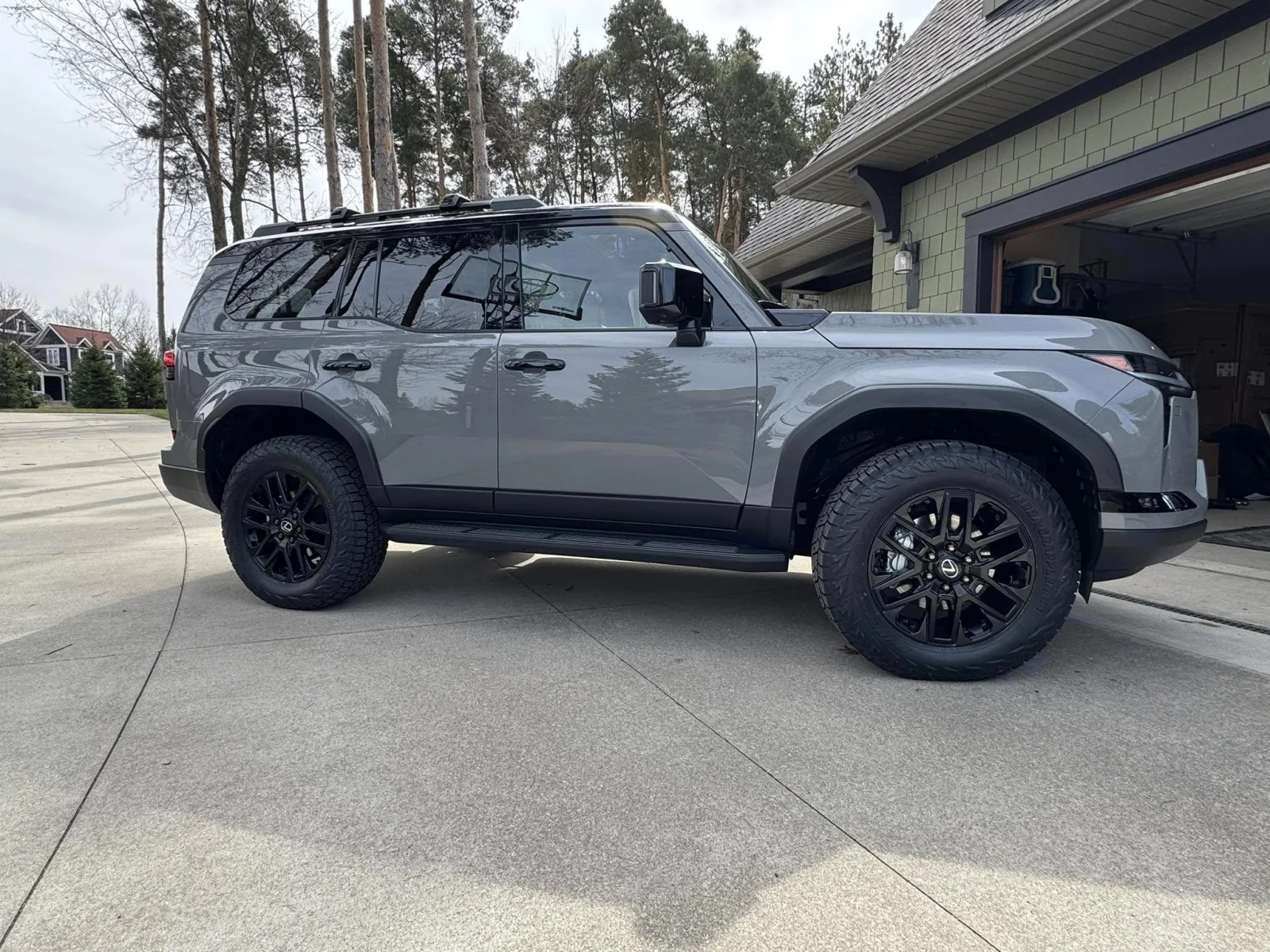

I did 275/65/r20, stock 25 OT+
no additional lift, Toyota Sequoia 20" wheels
Very nice! How close are you to rubbing on the front? I'd like to go this size but I've got Methods with an offset that could limit my ability to fit a 34" OD tire.
Not close to rubbing at all, full size spare is tight and has to be at zero pressure to fit with TPM Toyota "pipe bomb" for sensor
