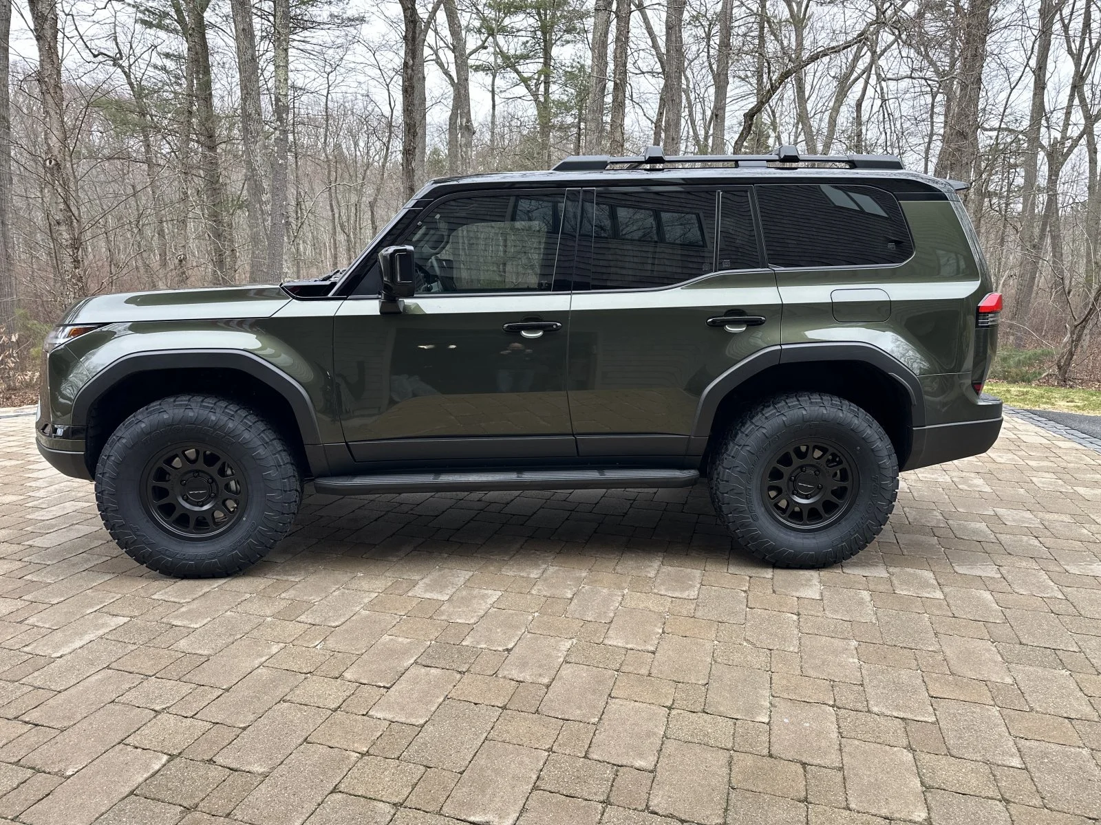

2024 OT +
Westcott preload collar
Toyo ATIII load E, 35x12.50 R17, psi 46
Method 703 +35
Minor fender trimming needed. I have plans to replace front bumper anyway and possibly suspension.
Ride is bit firmer, but no complaints.
