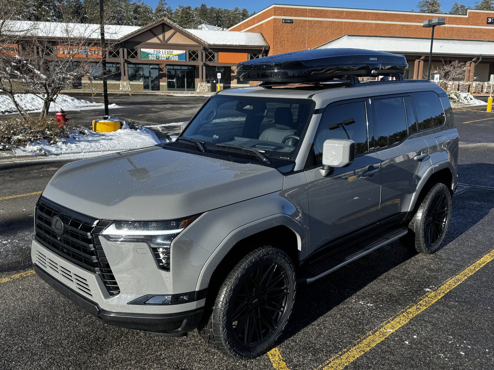

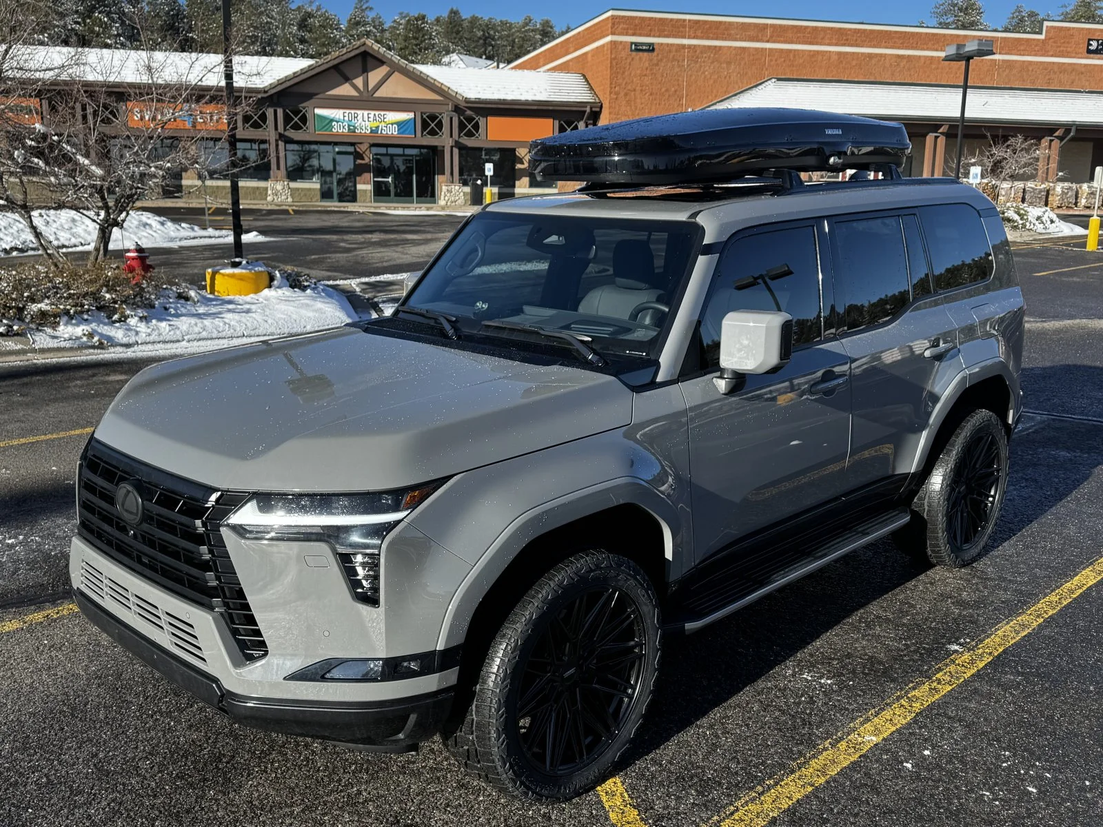

Just mounted up 22" Vossen HF6-5 in satin black (22x9.5 ET 20) on Nitto Nomad Grapplers (285/45/22). Couldn't be happier, exact look I was going for!View attachment 8865
That looks great! Are there any fitment issues or rubbing at 285/45R22? I am thinking of eventually going with 275/50R22 on the Luxury wheels and keeping everything else stock. Just wanted to be sure there wouldn’t be any problems. Thanks!
Truck looks amazing! Quick question: I am looking to replicate this set-up, did you have to manipulate suspension in any way, or cut plastic pieces w/in the wheel wells to fit these rims and tires?
