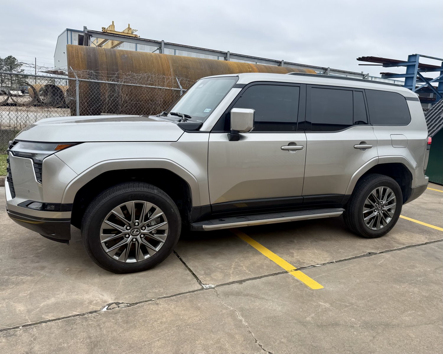

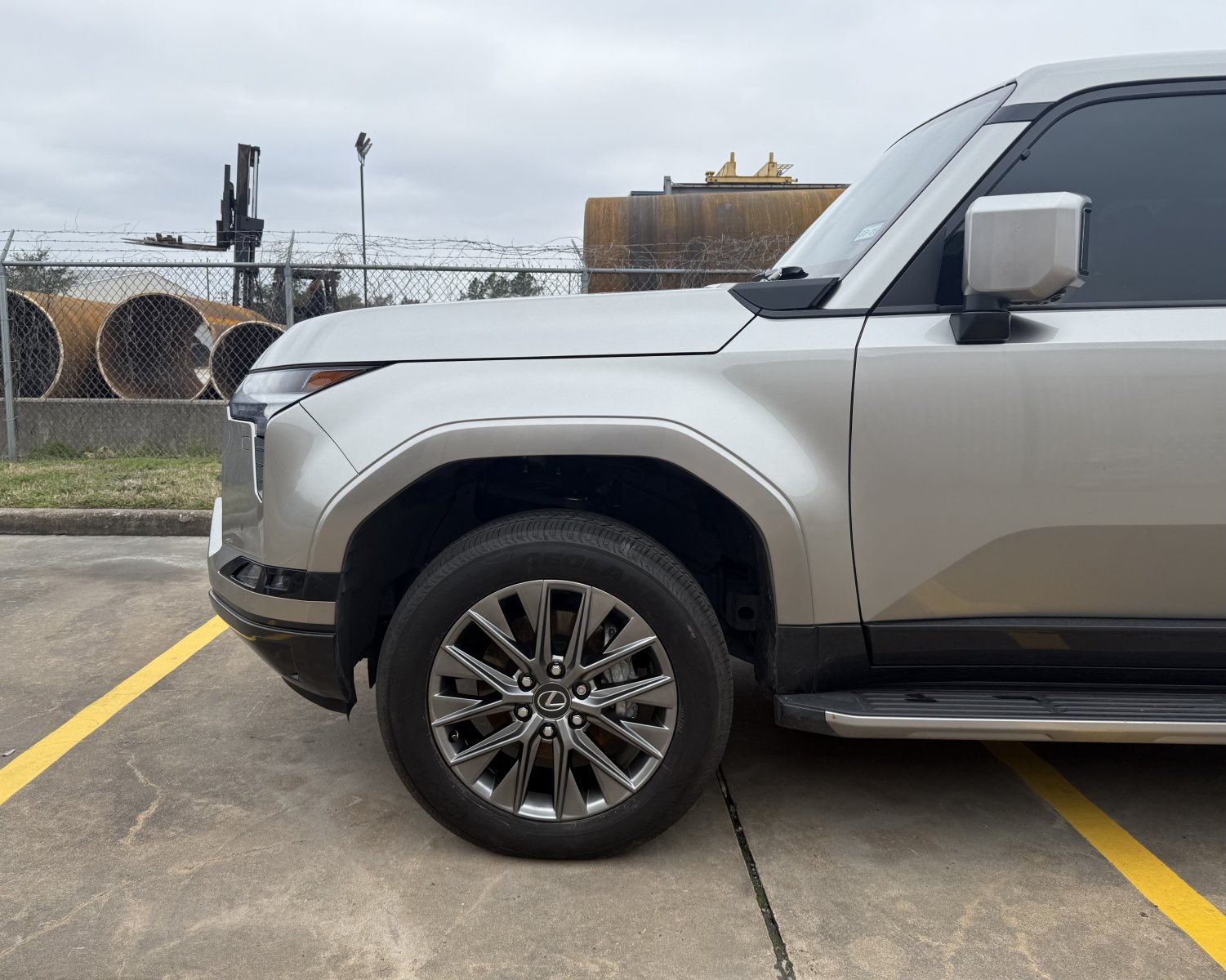

Finally got around to powder coating my Premium+ asterisk wheels. Went with gunmetal and very pleased with how it turned out!

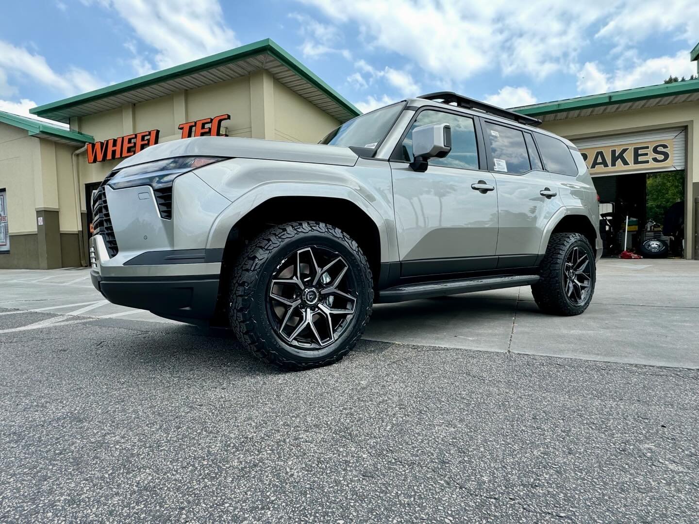

Here’s mine with 22” Fuel wheels and 285/55/22” I do have the Westcott

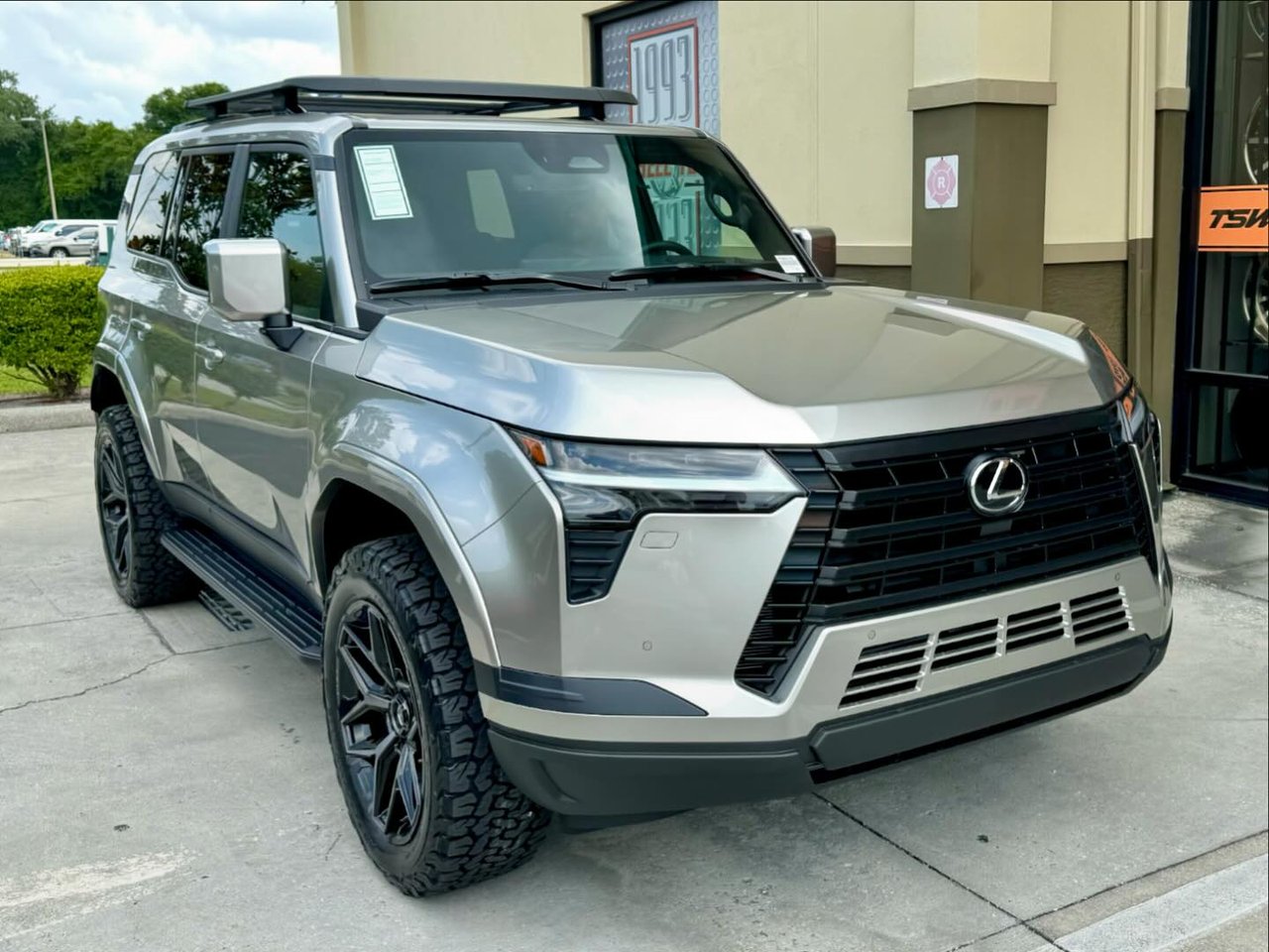

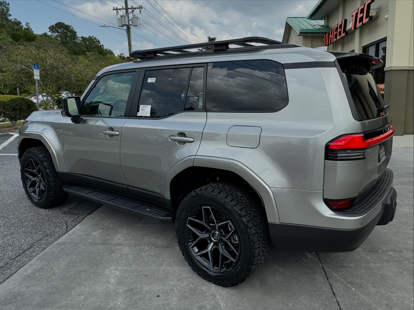

I have a Luxury+ with 22” Fuel Wheels and 285/55/22” Nitto tires with the Westcott Lift kit, keep in mind I had trim some plastic on the bumper and inner fender. Tomorrow the Westcott Roof rack is going to be installed.
Looks great...!!!
How wide are those wheels?

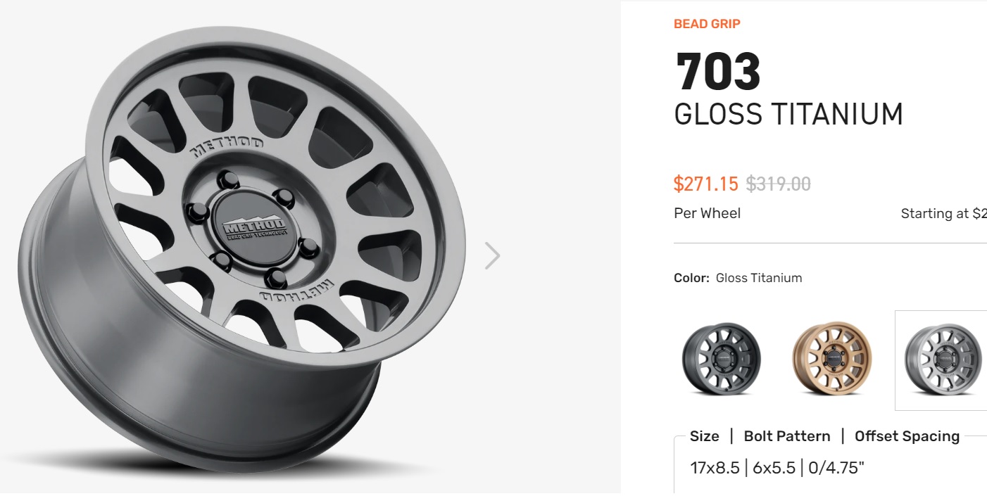

I went with Titanium Method 703s.
I picked up a set of four 2003-2009 4th generation 4Runner OEM alloy wheels for $50 a few weeks ago. They are 7.5" wide X 17" diameter with a +30 offset. My Method wheels are 8.5" wide X 17" diameter with a +35 offset. I'm using one of the 4Runner wheels as my spare and I'll be taking it to the tire shop in about 500 miles to get my tires rotated and also buy a spare tire - going to try to fit a 33.5" spare (a "34" tire) under the cargo hold in the stock spot. I bought the 4Runner wheels because I'll be selling my stock Overtrail 18" wheels as a full set of five. The best part is that I sold the remaining 3 4Runner wheels for $100 the other day!
Nice set up! Where did you get that hood vinyl?
Finally got around to powder coating my Premium+ asterisk wheels. Went with gunmetal and very pleased with how it turned out!View attachment 8322View attachment 8323
How does this work? Does the shop take them off car, take off the tires, clean the wheels, powder coat them, then remount and balance the tires and then pit them back on the car?
Or do you need multiple vendors here. Wondering if powder coater just wants clean wheels with no tires etc…
My shop did it all, though it would have been about half the price if I had just brought in the unmounted, tireless wheels.
