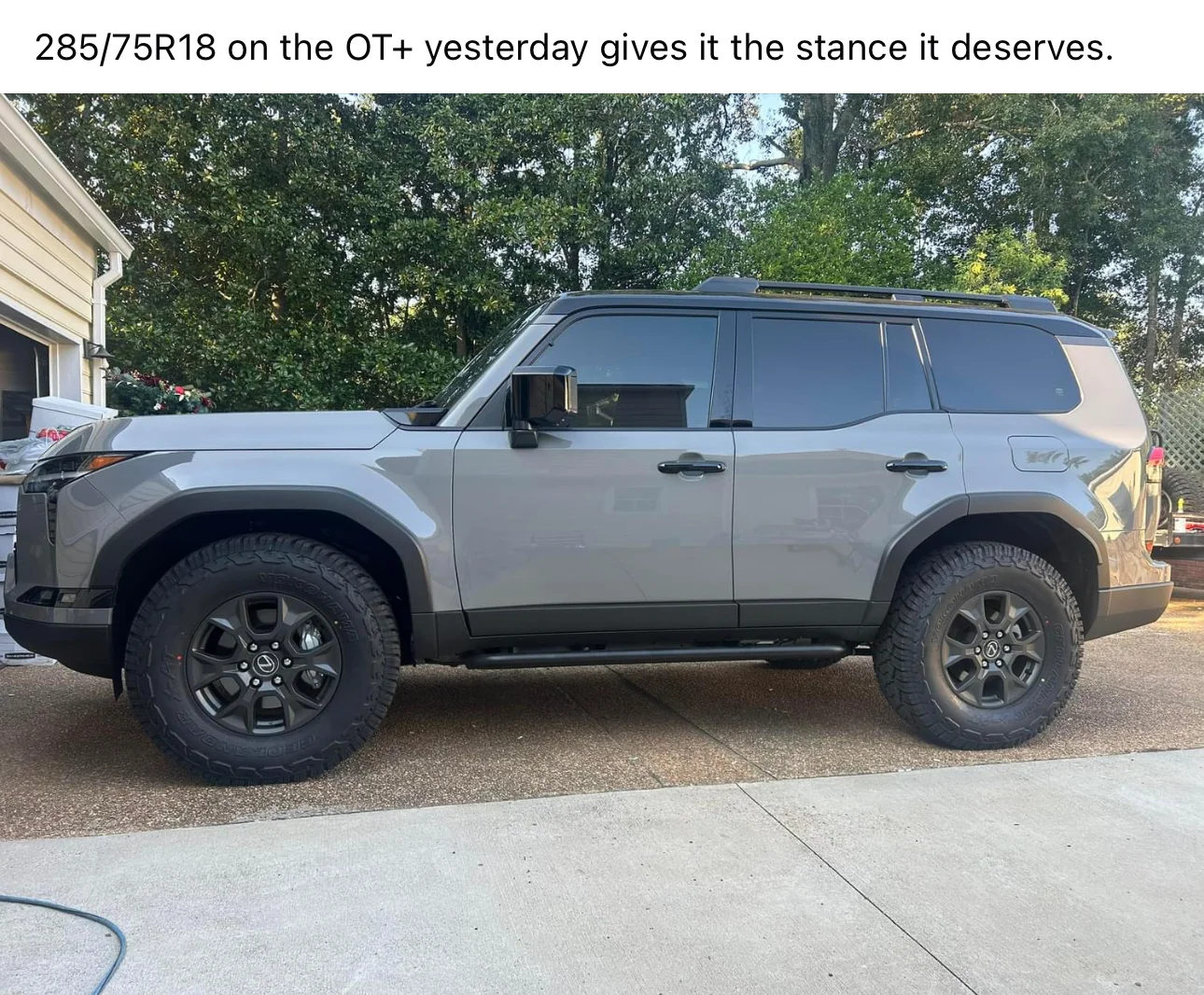

Will 285/65 r18 on stock OT+ wheels fit a stock OT+ with no rub an no mud flap removal?
This guy fit 285/75 on stock suspension. He said no rub

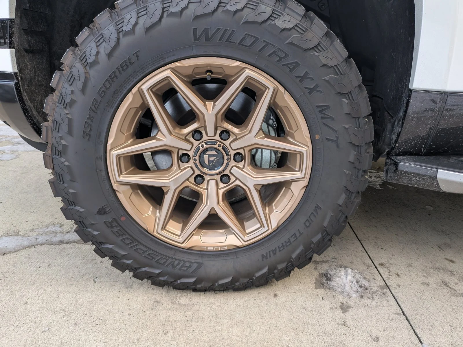

Greetings all! I recently took delivery of a Premium + that is basically brand new except that the GM of a Lexus dealership had it for a few months and just drove it to and from the dealership. It came with a 2" lift, Fuel 18" wheels, and Landspider Wildtraxx M/T 33x12.50R18 LTs. I can tell from the little driving I've done that they are not enjoyable at all on road(obviously). They also rub pretty severely when turning the wheel more than 60-70%. I like the look of them but they're not practical for on road, which is what I would mostly be doing. I don't know the offset as I had trouble getting all the information since the dealership I purchased the vehicle from was not the original dealer and it came to them like that. I just ordered some Nitto Terra Grappler G3s 275/65/R18s to put on the existing wheels. They should retain the aggressive look but being that they are an 11" wide tire, 32" tall, and only 42lbs, they should do much better on road and hopefully not rub. This particular size also comes with a 70K mile warranty! Does anyone know from personal experience anything about the NITTO Terra Grappler G3s and how the ride, fuel economy, and sound on highway is? I will post and update and pictures once I put the new tires on but in the meantime here are some pictures of the current set up. God bless!

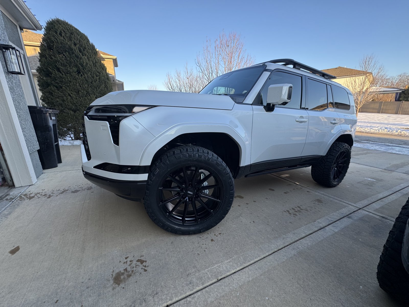

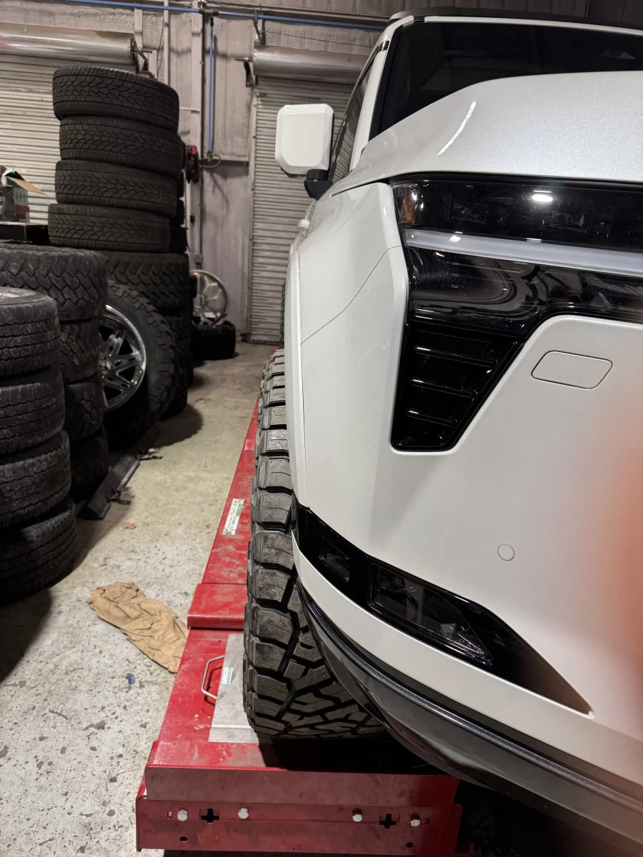

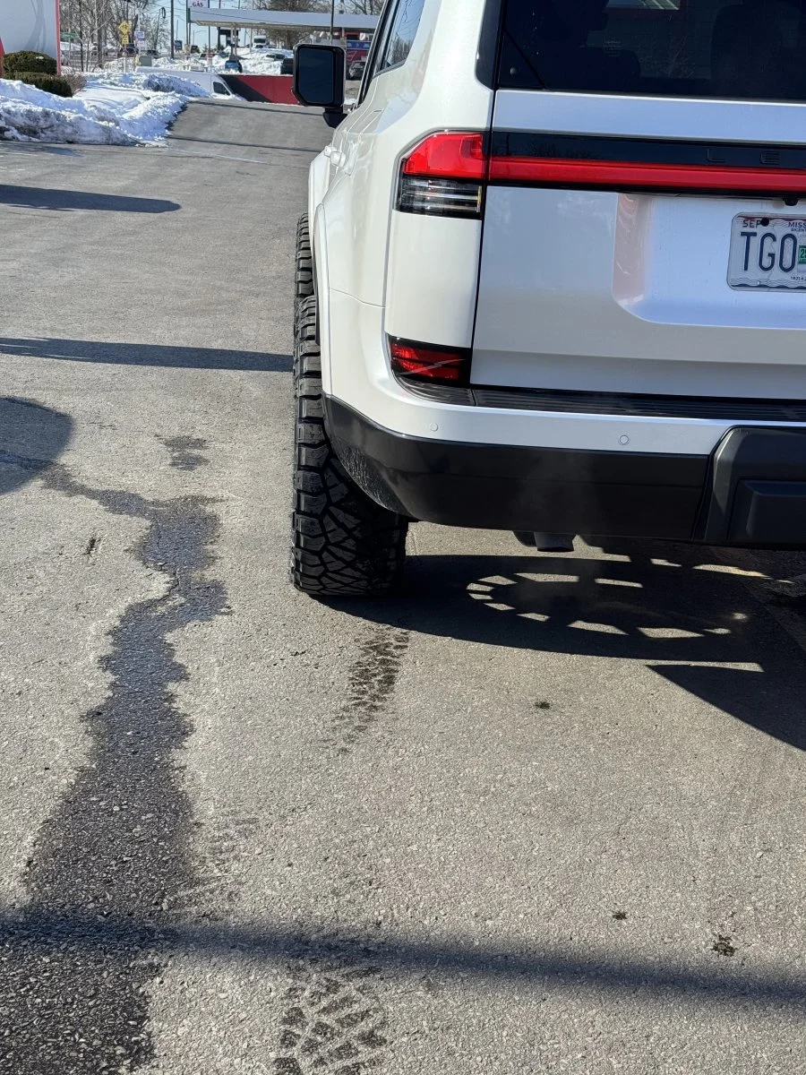

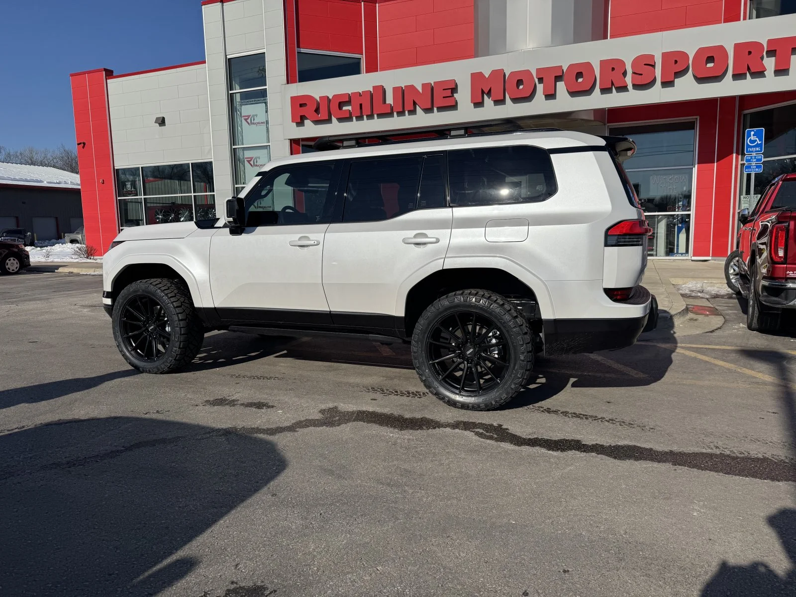

For those of you searching for fitment of bigger tires and more poke on a Luxury+...
2024 Luxury+
Westcott Designs Preload Collar Lift (2.5" front lift, 0.75" Rear)
Vossen HF6-1, 22x9.5 +20
Nitto Ridge Grappler 285/50R22

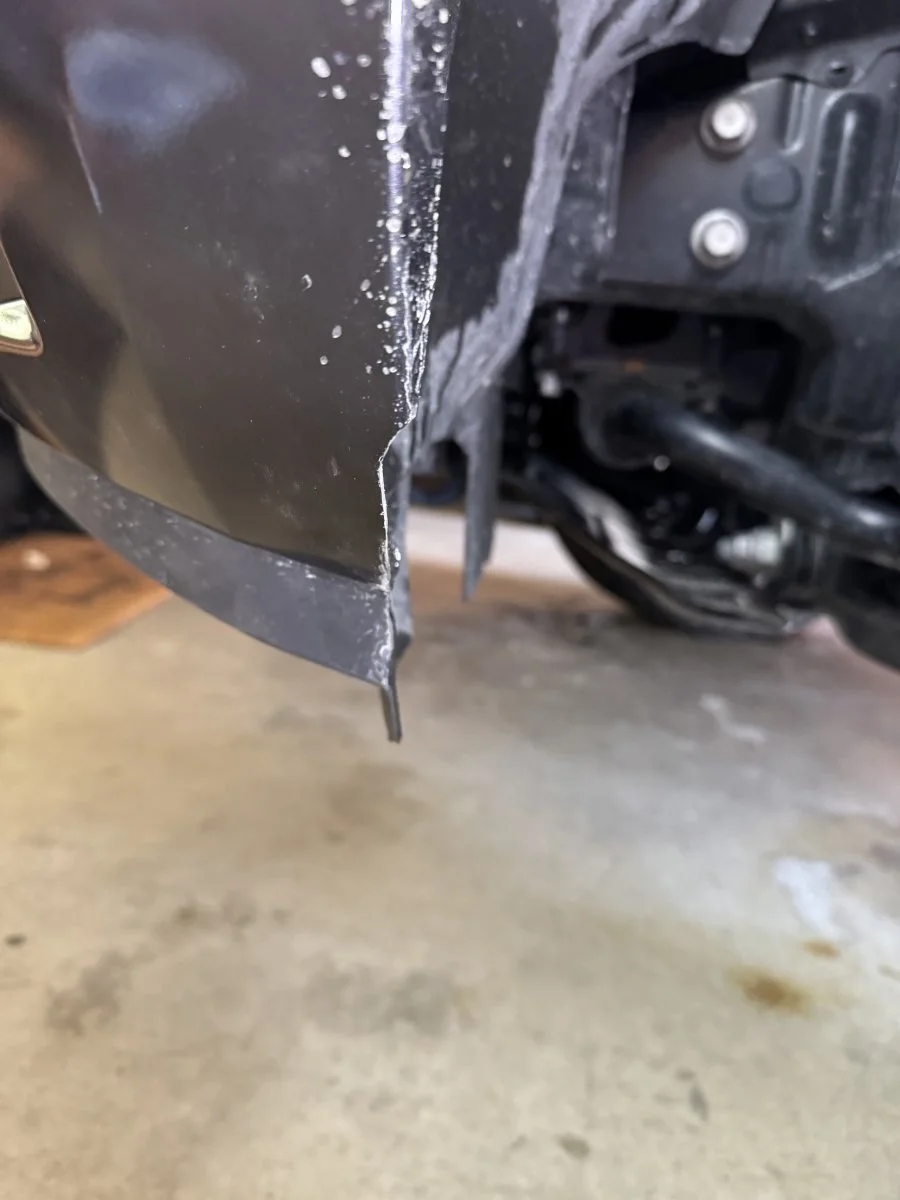

Very minor trimming required to the lower corners of the front bumper (less than 0.25") and did NOT need to trim aft of the tire or remove the "crash box." I included a picture of the trimmed driver's side corner. This picture is taken from a slightly upward angle, and actually makes it look like a bigger cut than it really is. You can't see the trimmed corner from standing up.
I think a +30 offset with the same tire MIGHT have cleared without trimming.
First attempted to fit a 285/55R22, but the rub was pretty bad, and it would have required significant trimming to the bumper (at least an inch at the bottom corner of the bumper), as well as removal of the "crash box" at the rear of the front wheel wells. I'm not sure if all the 285/55R22s I've seen on social media are able to fit because of more aggressive trimming, or if the other trim packages are more forgiving.
Lift/Wheels/Tires/Trimming (as well as trial and error for the larger tires) done at Richline Motorsports in Independence, MO (Kansas City)
Very happy with the results.
Cheers!
