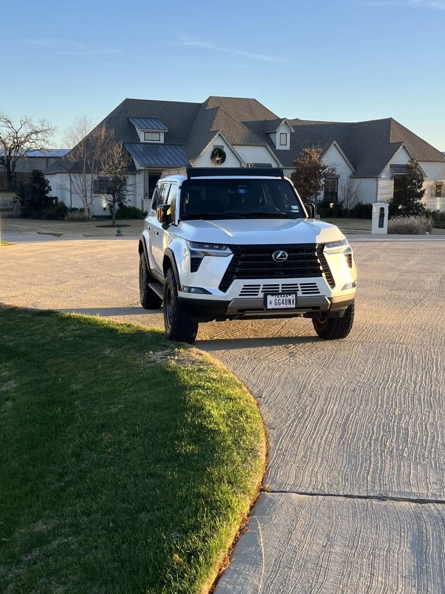

For those interested in wheel and tire swaps, this thread serves as a helpful resource. A common question we often encounter is about offset and its effect on the stance of the vehicle. If you've recently switched to new wheels & tires, we'd appreciate it if you could contribute by sharing the wheel/tire size, offset, and detailed photos
Here's an example of 18x9 wheels mounted with 265/70r18 tires. The wheels have a negative 0 offset.
(Photo credit S. Yoon - GX550 Owners FB Group)

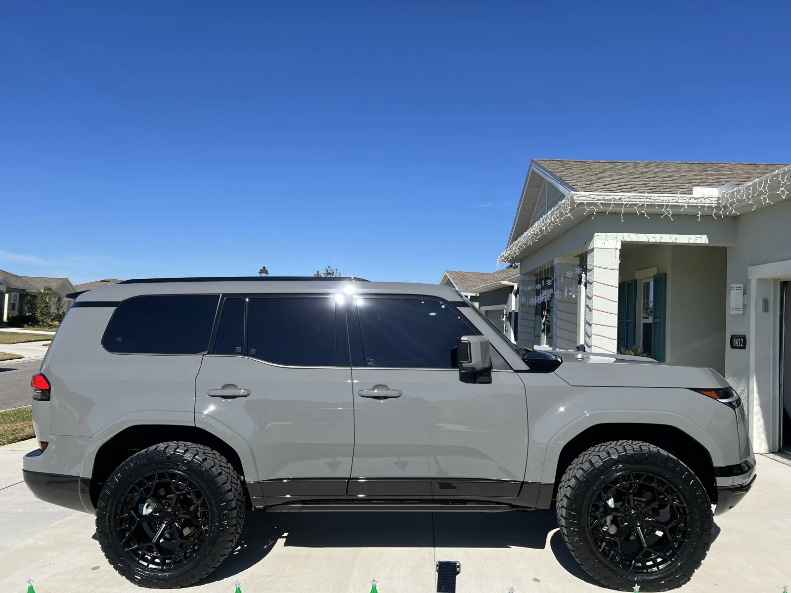

Here’s mine with 22” Fuel wheels and 285/55/22” I do have the Westcott

I have a Luxury+ with 22” Fuel Wheels and 285/55/22” Nitto tires with the Westcott Lift kit, keep in mind I had trim some plastic on the bumper and inner fender. Tomorrow the Westcott Roof rack is going to be installed.

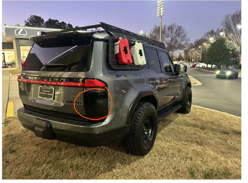

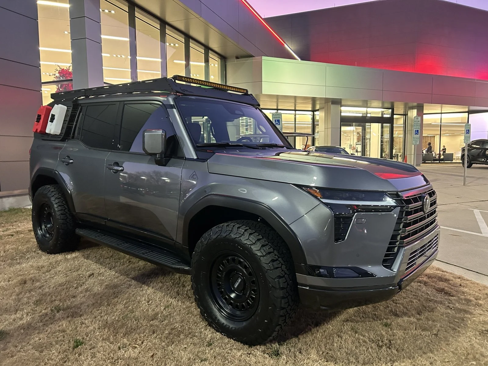

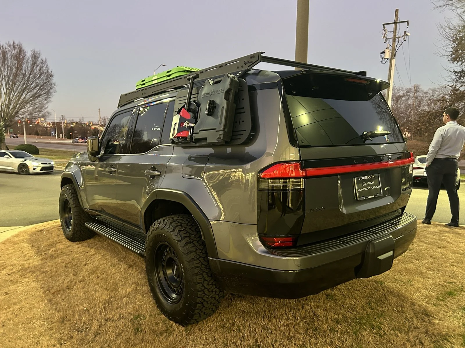

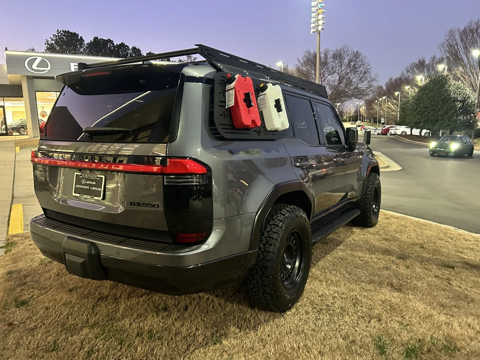

This is a GX550 for sale at Johnson Lexus of Raleigh / NC. Method wheels with BFG K03s
Nice! Is that Atomic Silver? Looks a little brownish from the pic. What’s the price on this one I’m guessing it’s over 90k
I believe it's "Nebula Gray". It was posted for $100k. 🤯
I figured, thanks. Looks like an OT. Didn't know they came in that color but it sure looks nice. So nice I would be afraid to take it out on the trails, but then I'm real OCD
Not an OT - look at the door handles. They're painted body color. The OT comes with black door handles. I'm guessing they wrapped the fender flares in black.
Ahh! It was the fender flares that got me. I didn’t look at the handles. Thanks

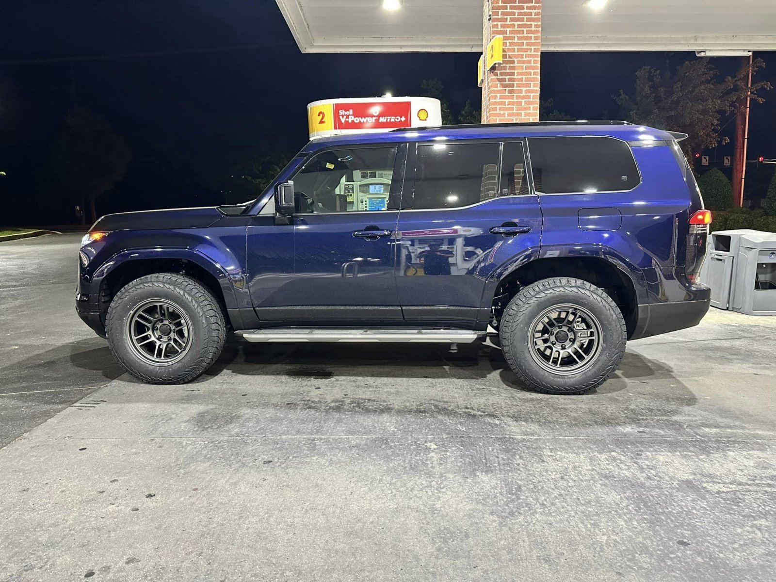

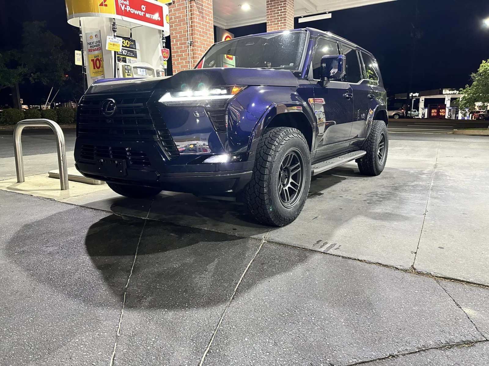

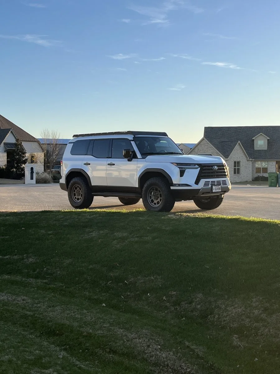

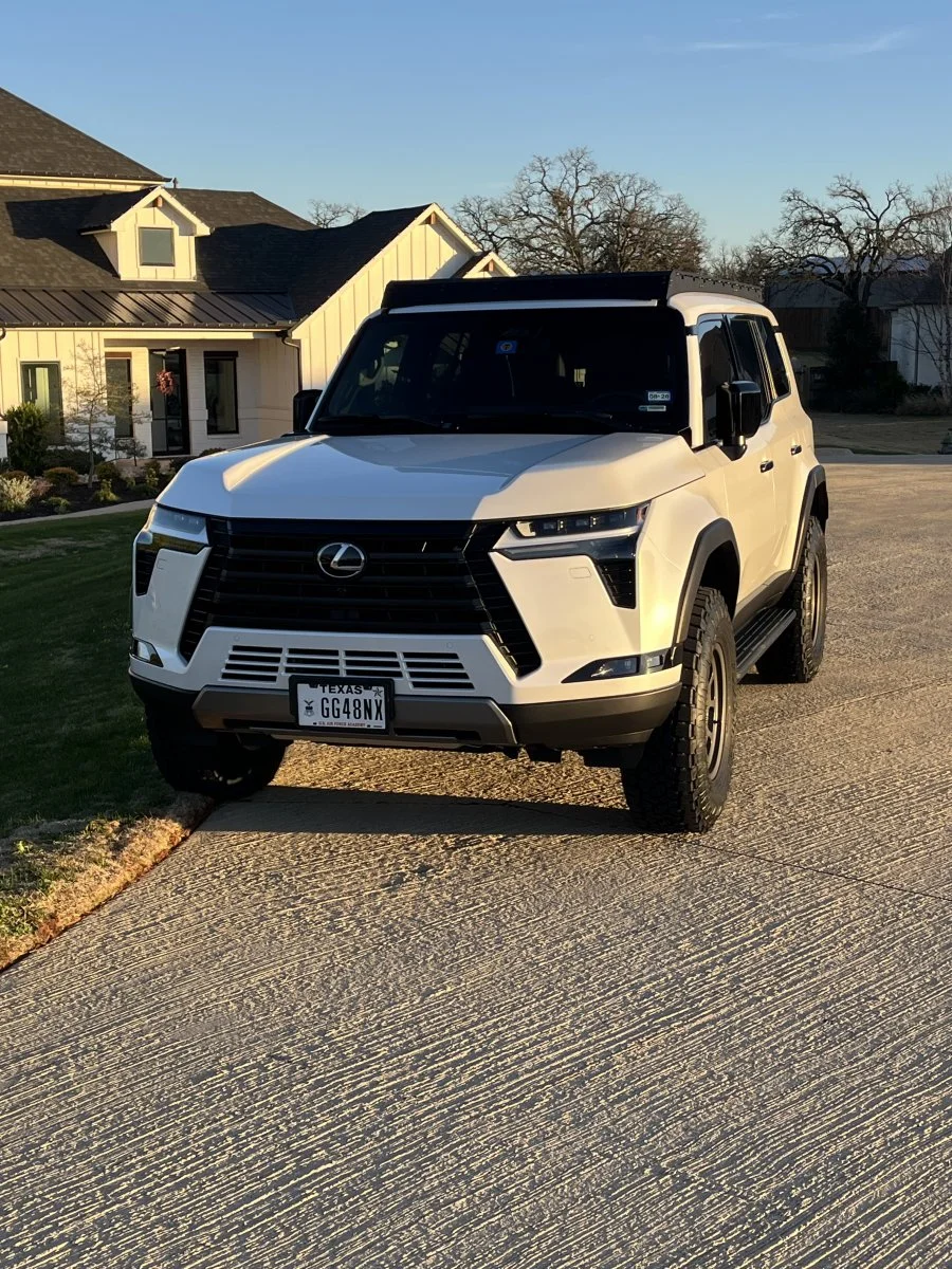

Here is my wheel and tire upgrade on my OT+
17” Method 705’s
Toyo Open Country ATIII 285/75 R17’s
Westcott Designs Preload Collars
Also did the Westcott Full Length roof rack

Anybody running this setup on stock suspension? Any rub?
The folks at Westcott said I would need 1” Spidertrax spacers even with their lift. I would imagine the larger tire would fit without the lift but spacers are probably needed to address any rubbing.

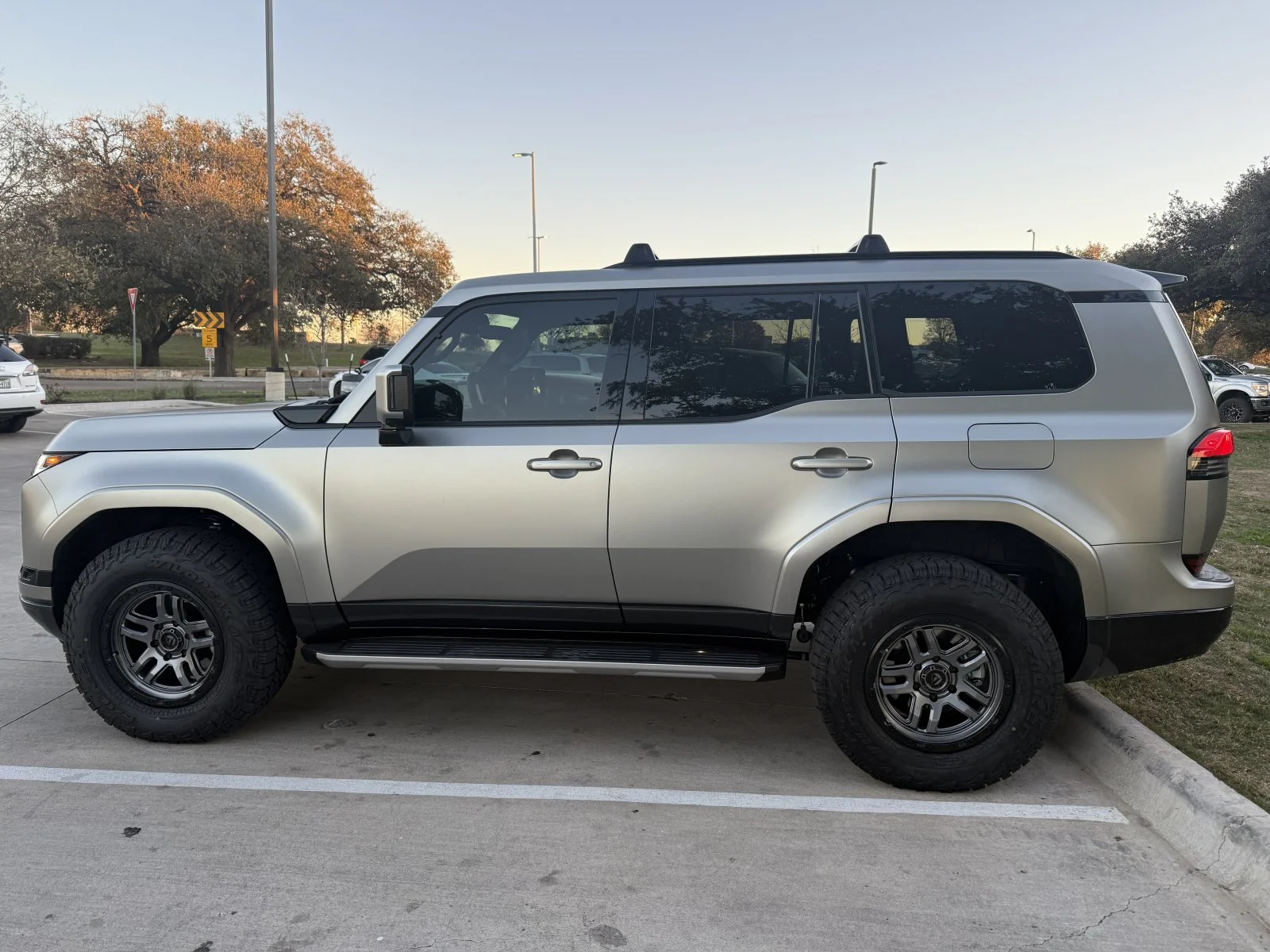

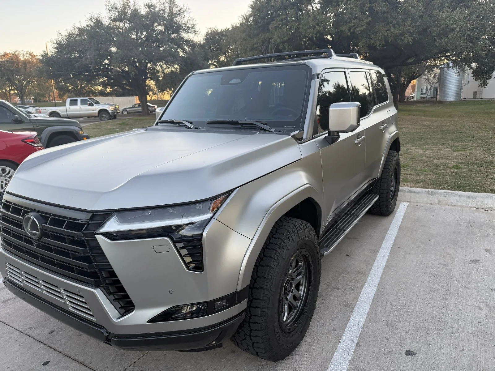

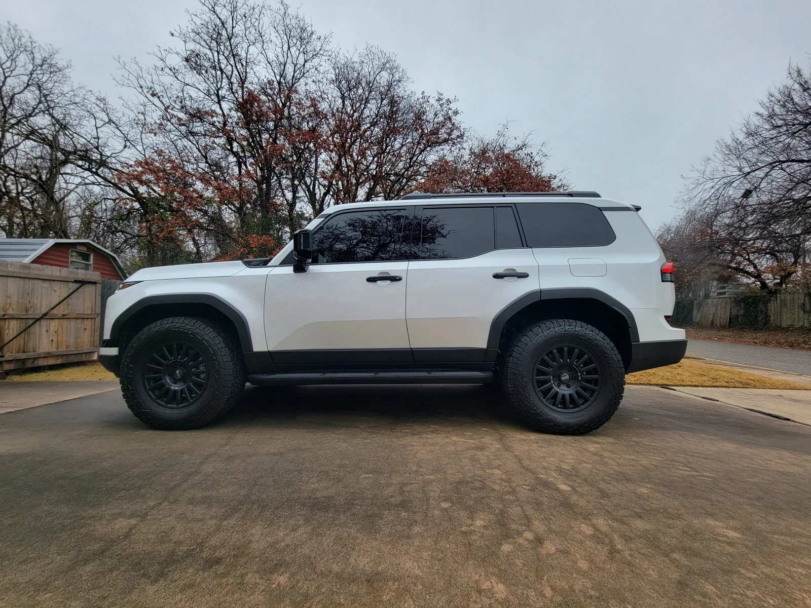

18” Fuels and Falken Wildpeak A/ T4W LT275 /70 R18. Stock Premium Plus suspension - wouldn’t mind a little front level, but not worth having anything to roughen the ride. As is, rides smoother than then stock 20” wheels and highway tires, imho. Tiny bit of rub at full turn in reverse, will trim if it doesn’t wear itself out. Atomic Silver with Expel Stealth full ppf, came out great.
