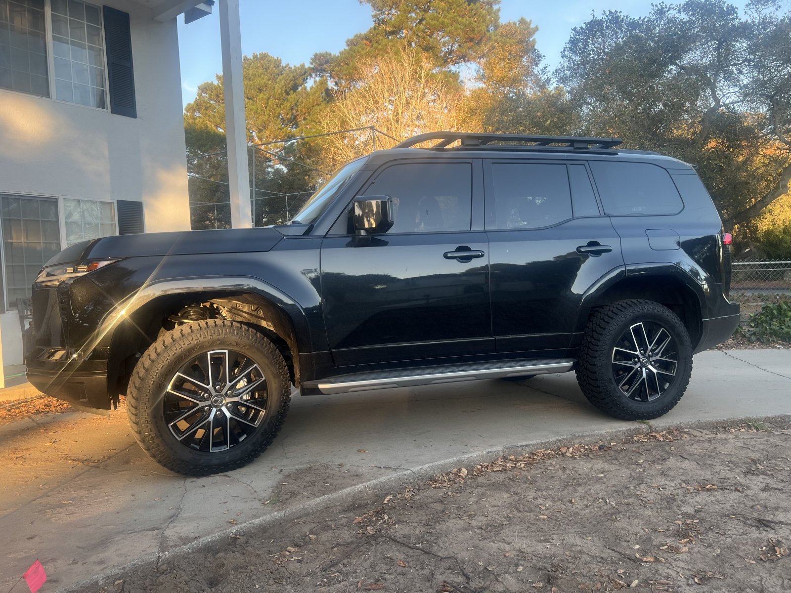

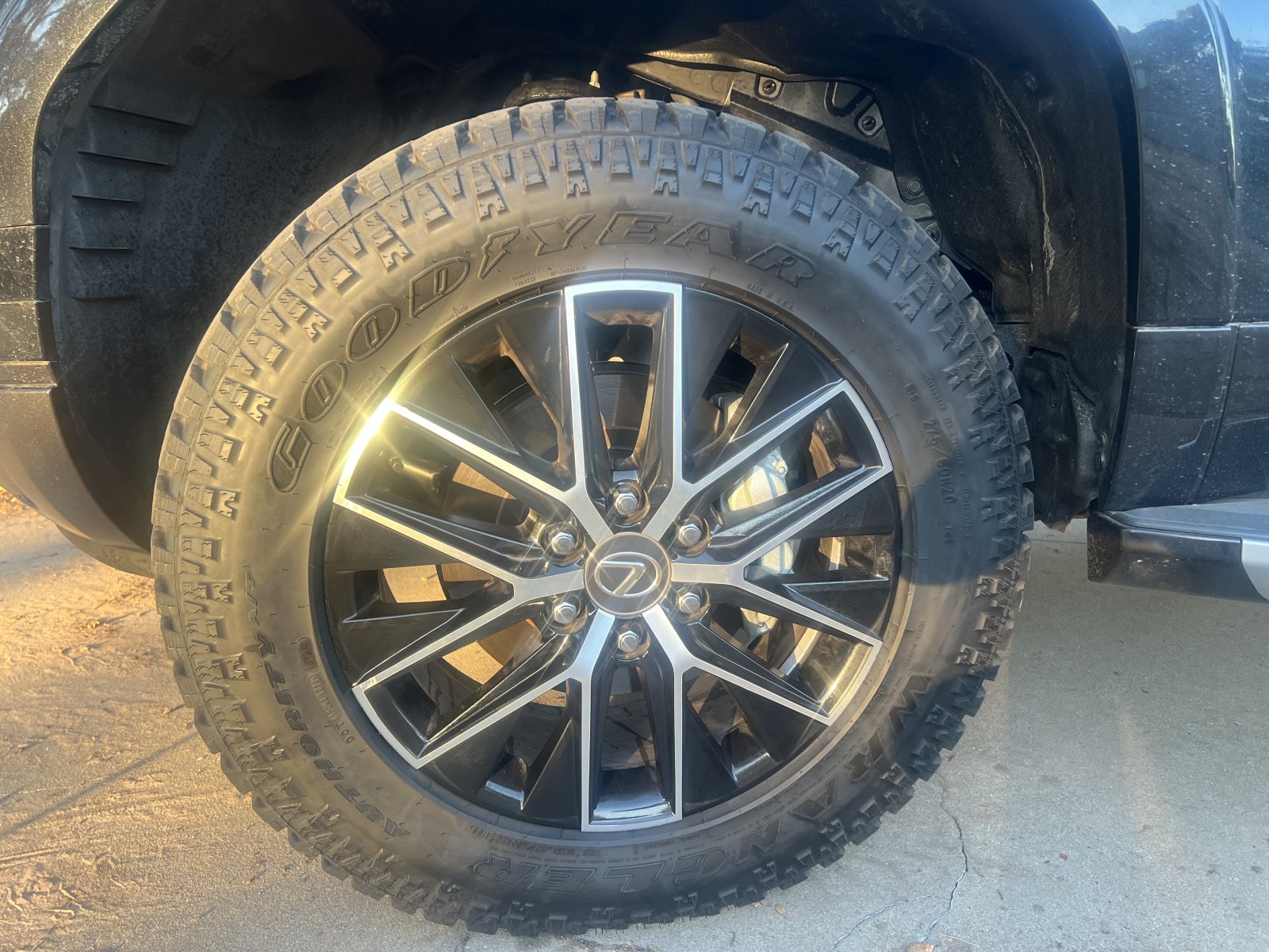

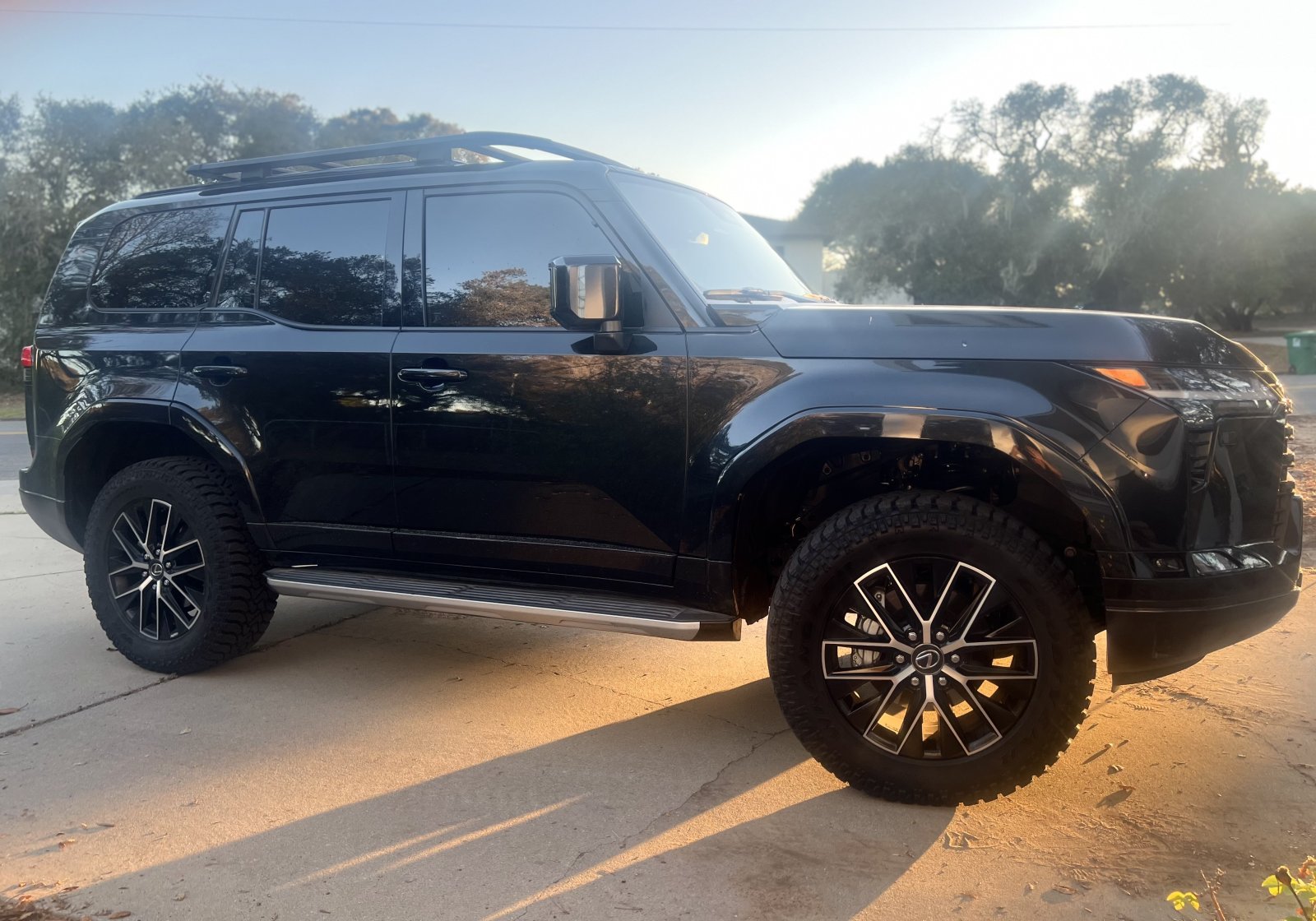

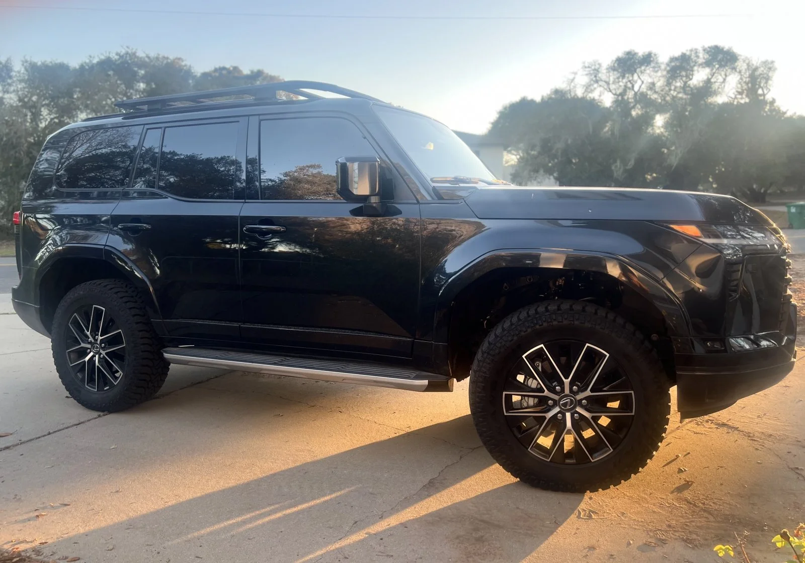

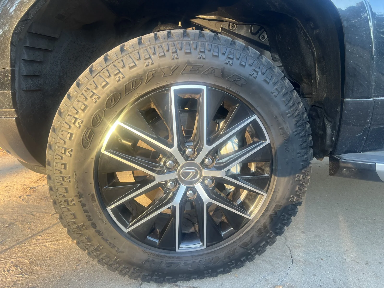

Really appreciate this thread. Was a huge help on deciding size for tires. I did some quick measuring and decided to go with 275/60r/20 Goodyear Wrangler ATs. 33 x 10.8 x 20. Installed Wescott collars and wanted to keep the stock Prem+ 20s (powder coatIng all black soon). Here’s a couple pics after install. No difference in ride quality from what I can tell. Very pleased with outcome. Thanks for the help all!

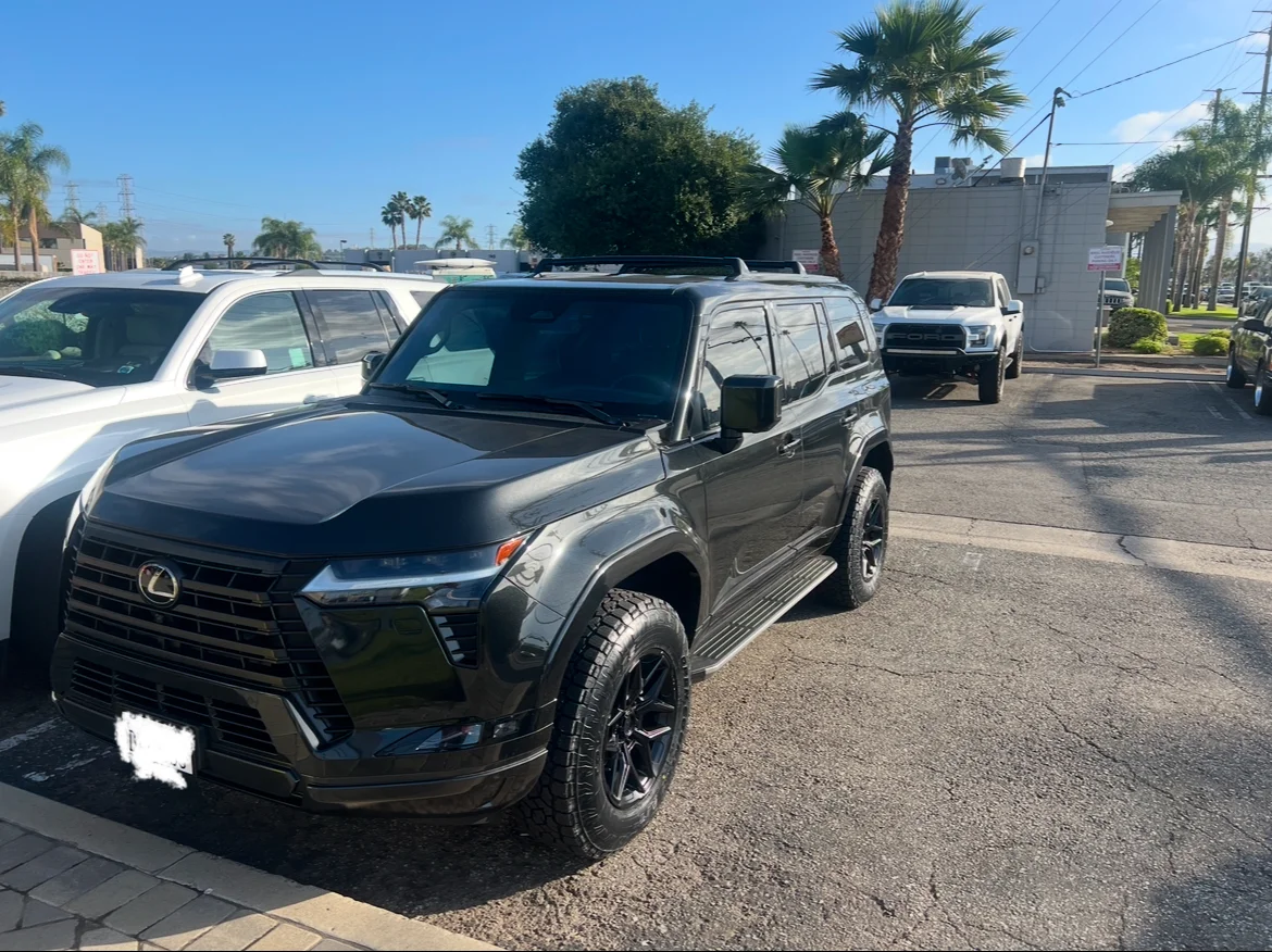

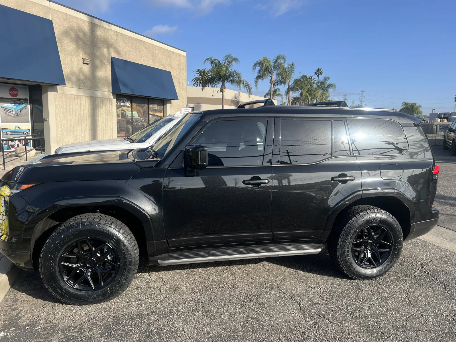

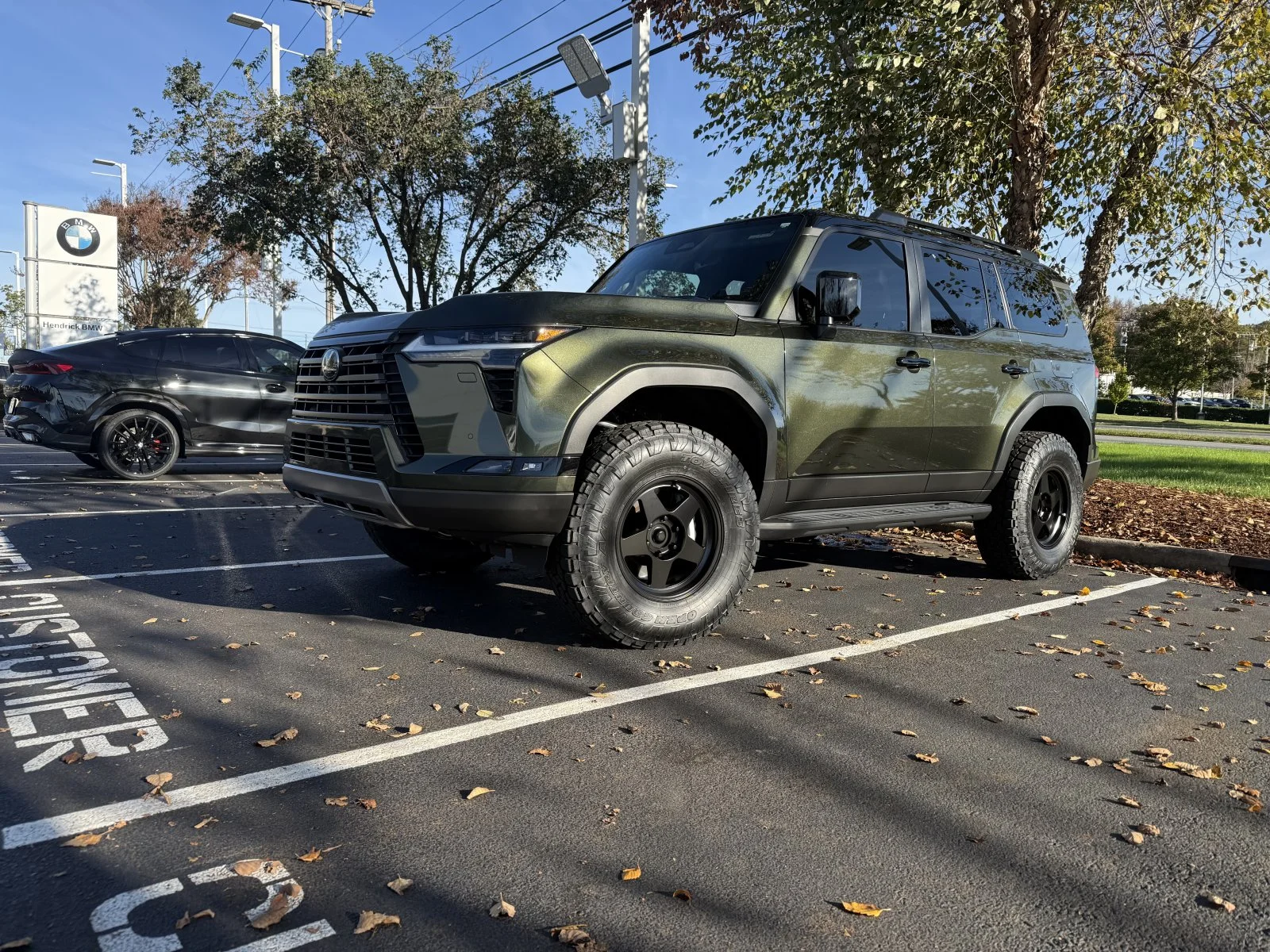

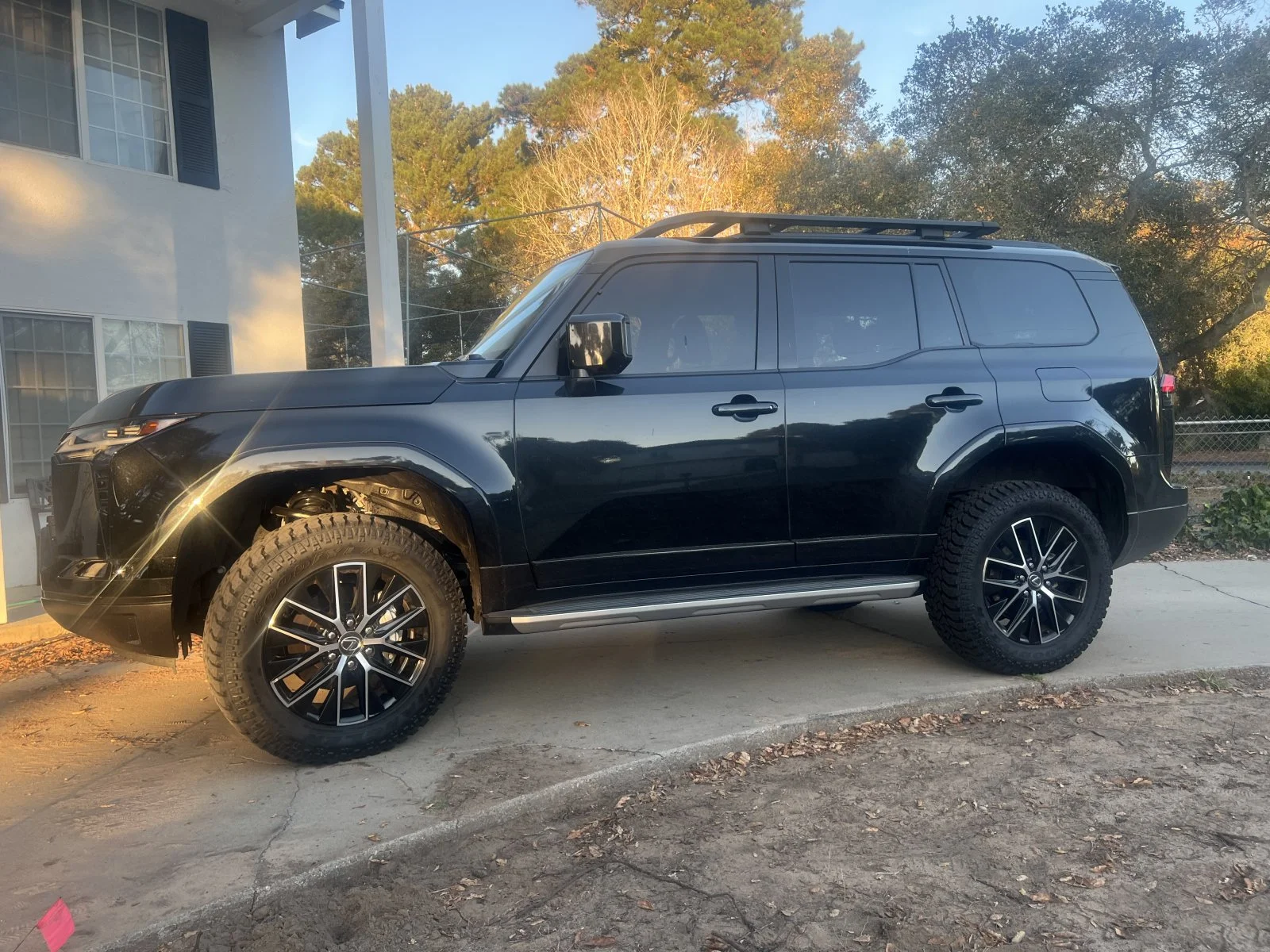

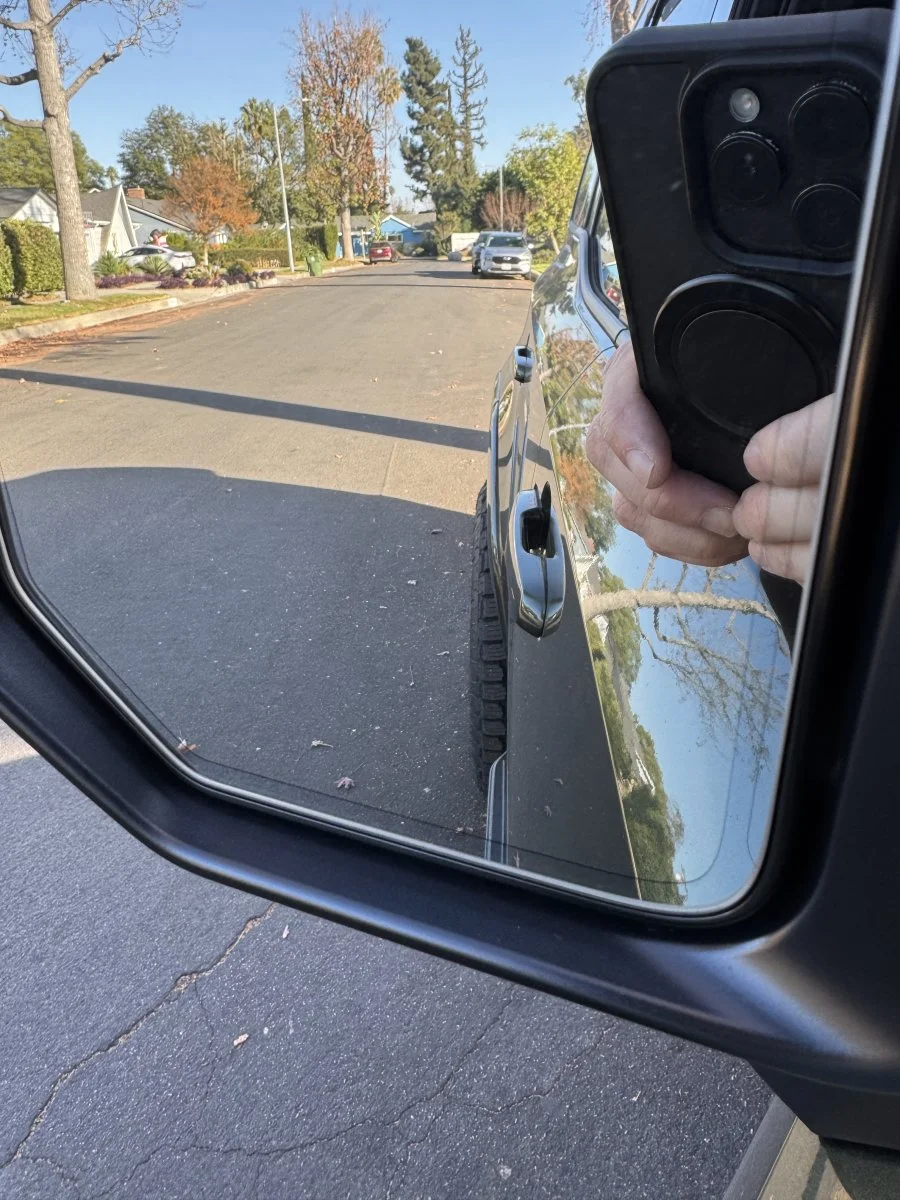

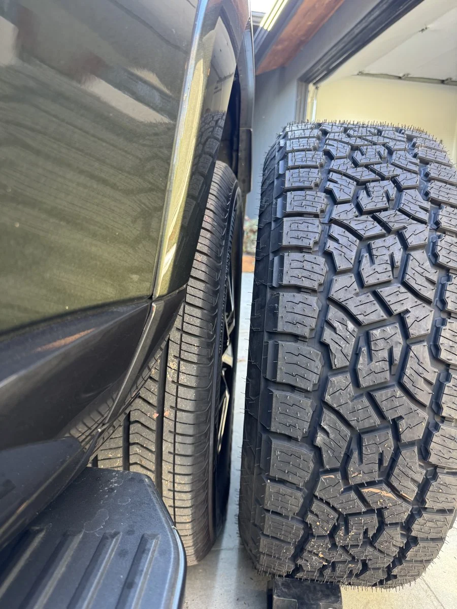

New to the forum but have been lurking for quite some time to try and find the right size/ offset. This thread and all the photos was super helpful so paying it forward with the final product and specs.
Luxury trim
Fuel Flux 18x9 +30
Toyo Open Country A/T III 265/70 18
Tiny bit of poke and happy with the outcome. Rides great. I live in Southern CA and went to Wheel Warehouse in Orange, they gave me a very decent deal in buying the OEM Luxury wheels (no future need and wife doesn’t want another set of wheels stacked in our garage). That credit applied towards the new set made the out the door cost insanely affordable, and no hassle with shipping. Food for thought if you’re in this area.

Looks great! Your not far from me. I live in North County San Diego. Which dealership did you get your GX from?

Can you confirm that this is a premium plus and that the stock wheels come black? If so, is the center cap black also or is it gray like the other stock GX wheels? I want to powder coat my overtrail wheels black but I want black center caps too so I’m trying to determine if these would work.

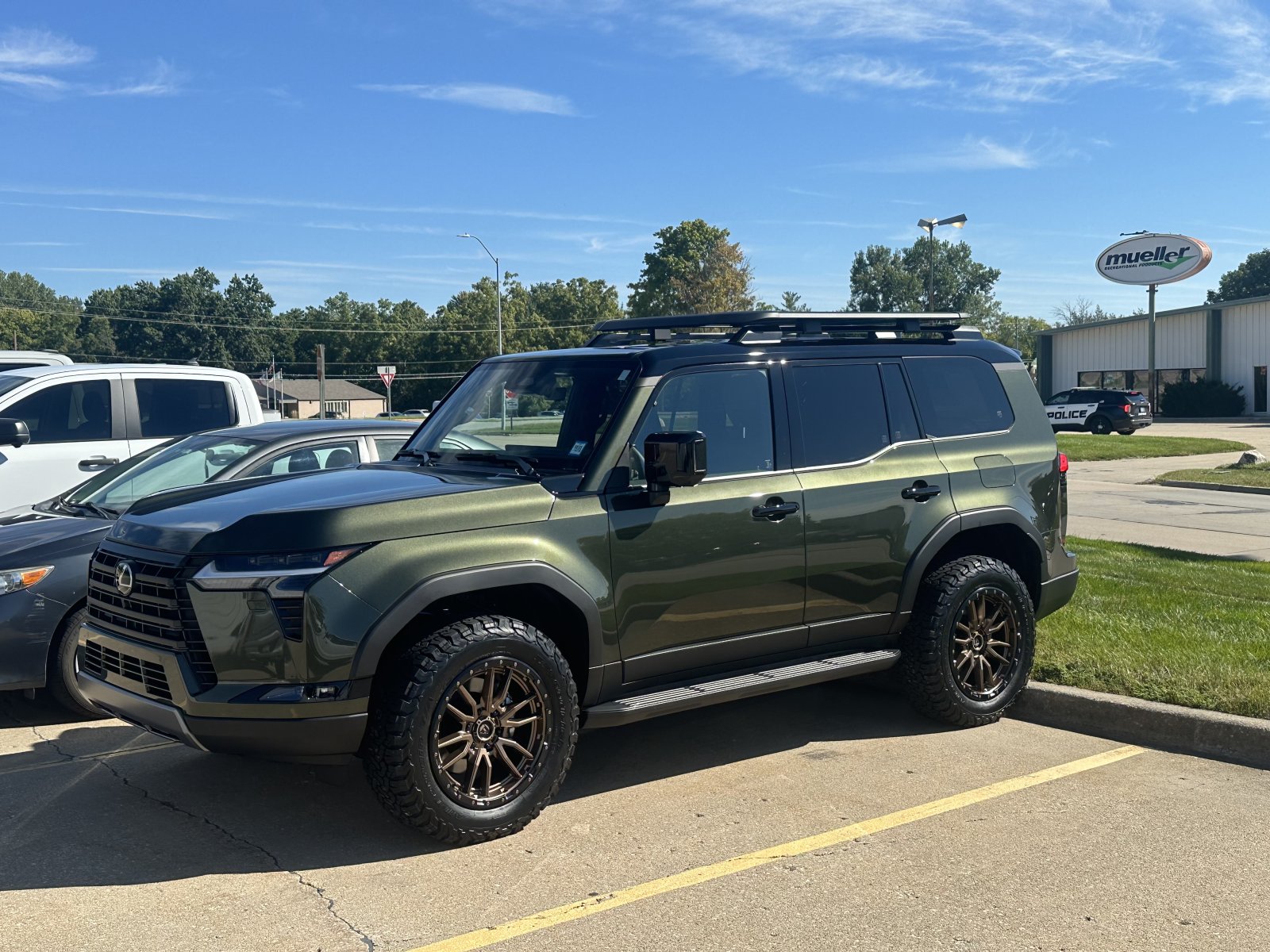

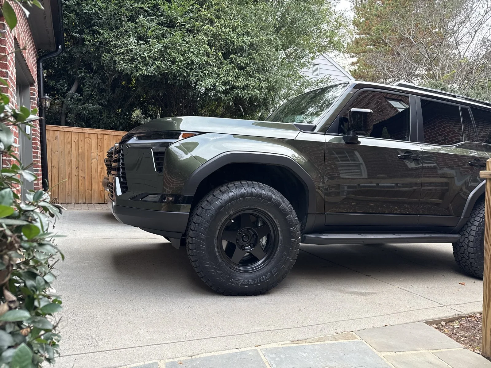

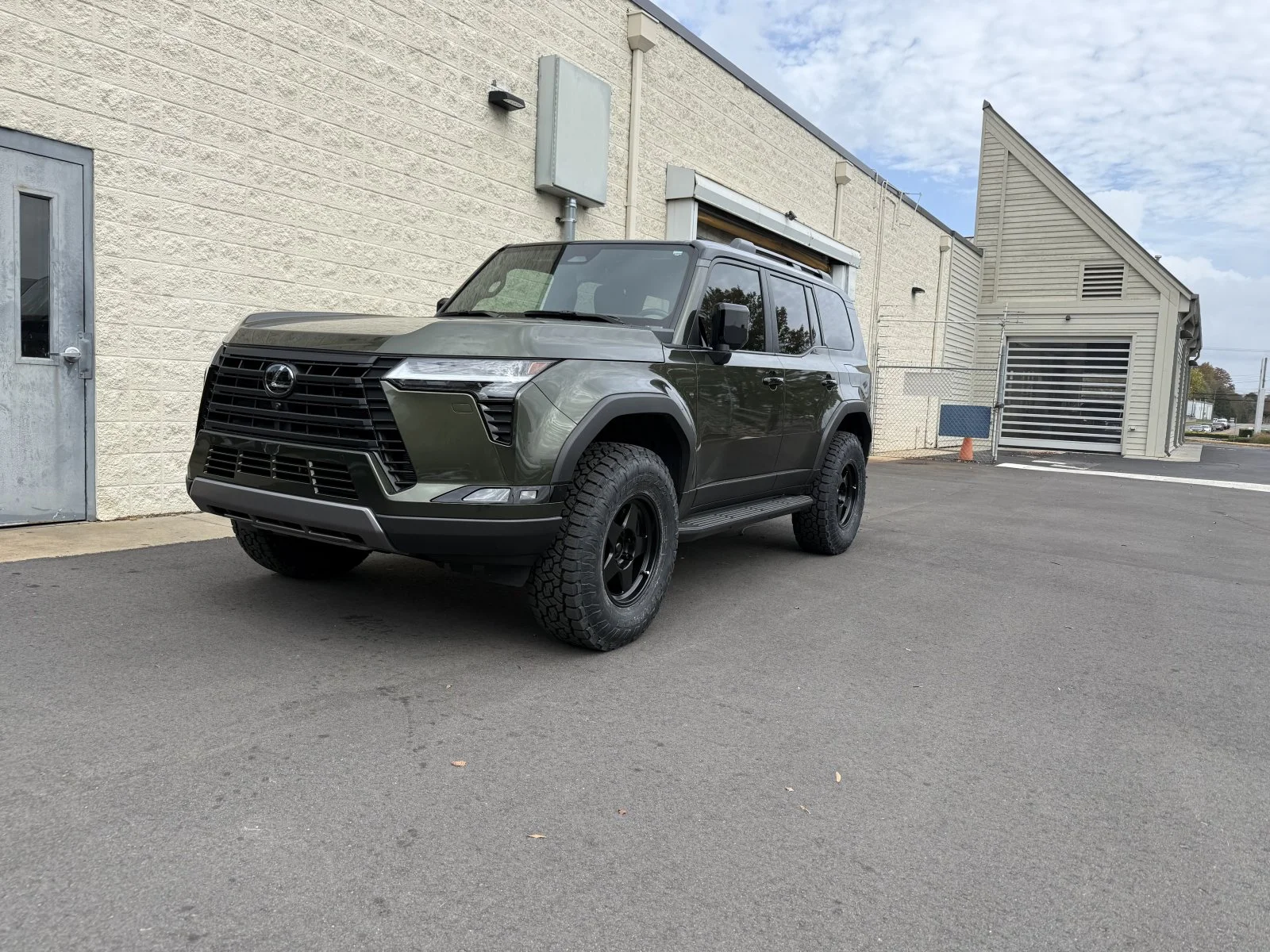

Stealth Custom Gen5s 17x8.5 +20 and 285/75r17 Toyo AT3s. Did the Westcott collar lift and still needed to pull the fender liner forward and heat gun the edges of the lower bumper to completely clear.

I have the same tires and wheels, made no changes to the liner and have no rubbing. Wonder what's different? Looks great!

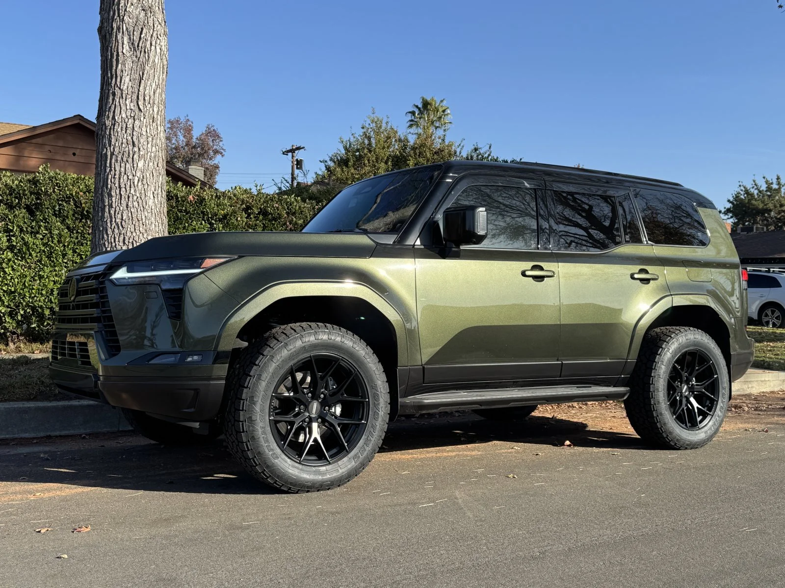

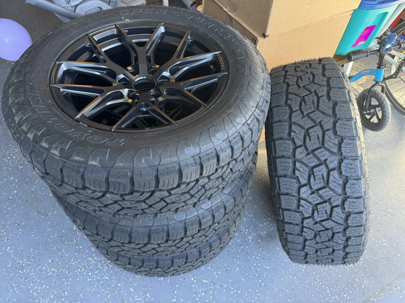

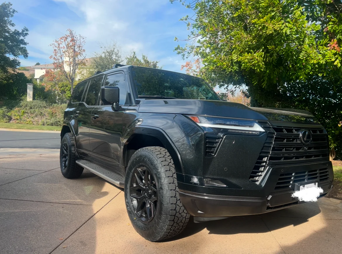

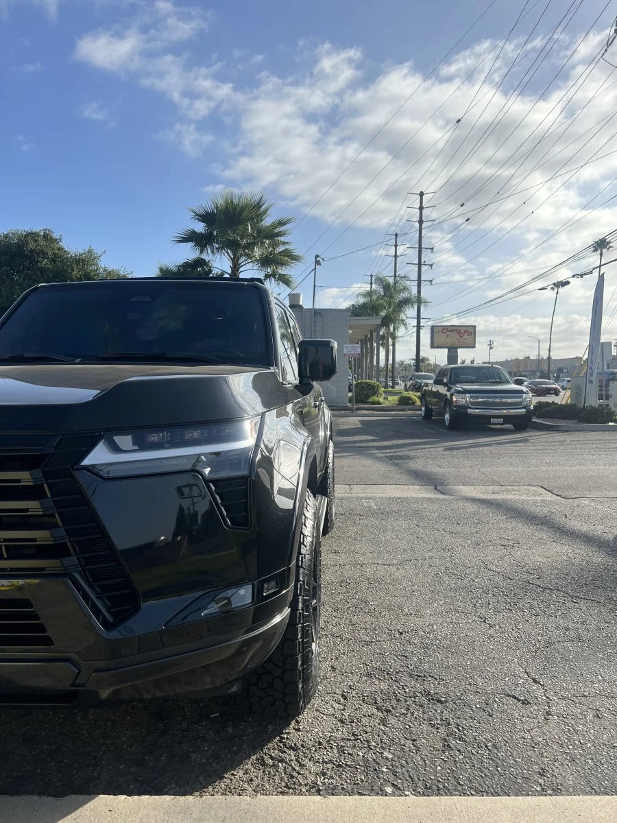

Haven’t had time to take pics and post
Vossen HF6-4 20x9 +18 satin black
Toyo AT3 275/60/20 (SL) a true 33” that fits (barely) in the spare tire location.
This set also only weighs 2lbs more per wheel than the stock 20's
Just a small amount of poke from the tires. The rim is flush with the premium fender flares
10% off code for those looking to buy Vossen rims as well (as well as other brands/ truck parts)
Get 10% off using my discount code
My experience with trucksrus.shop was great. Located in Texas and had great customer service.

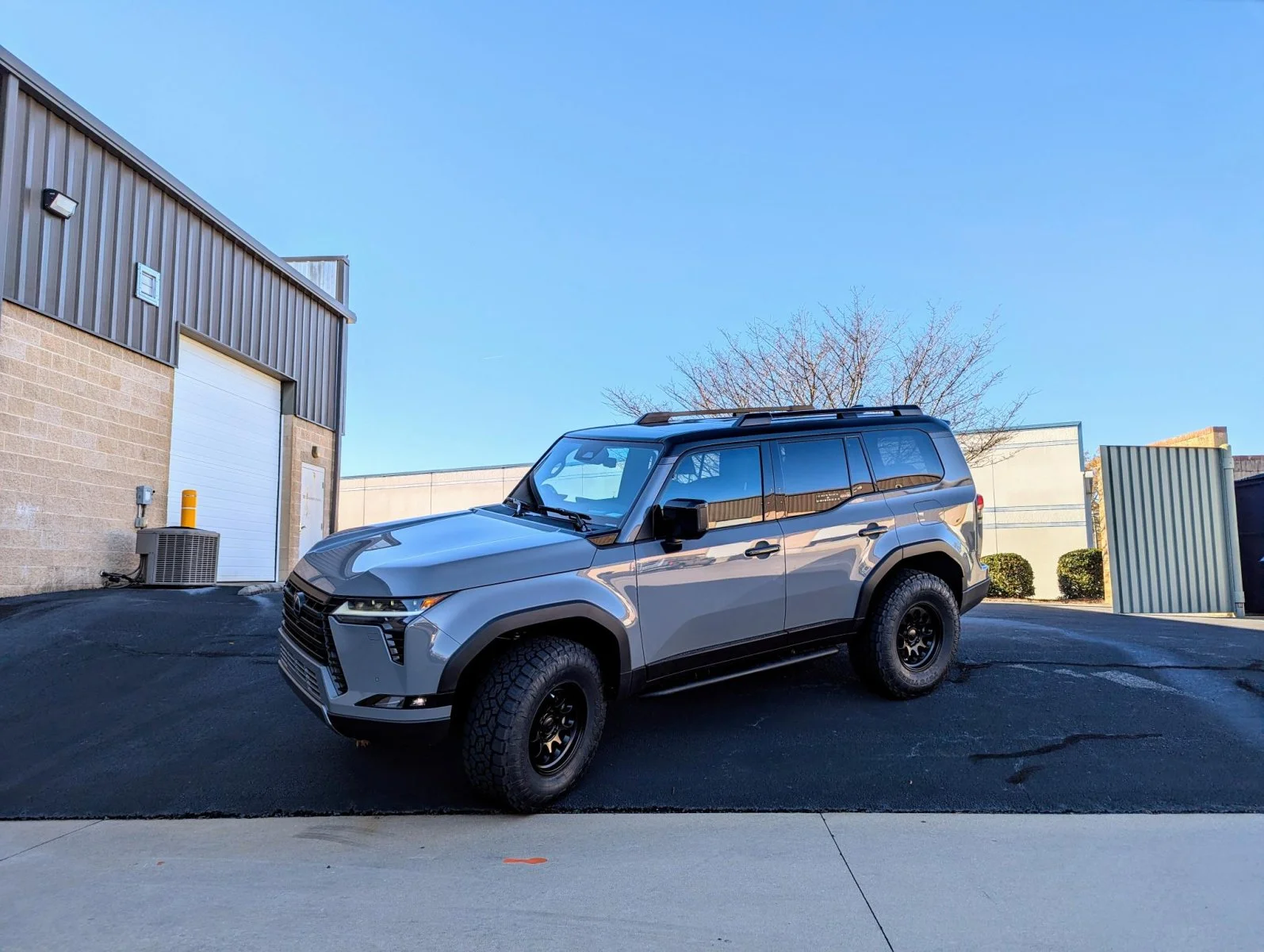

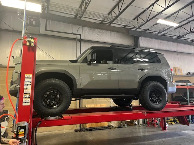

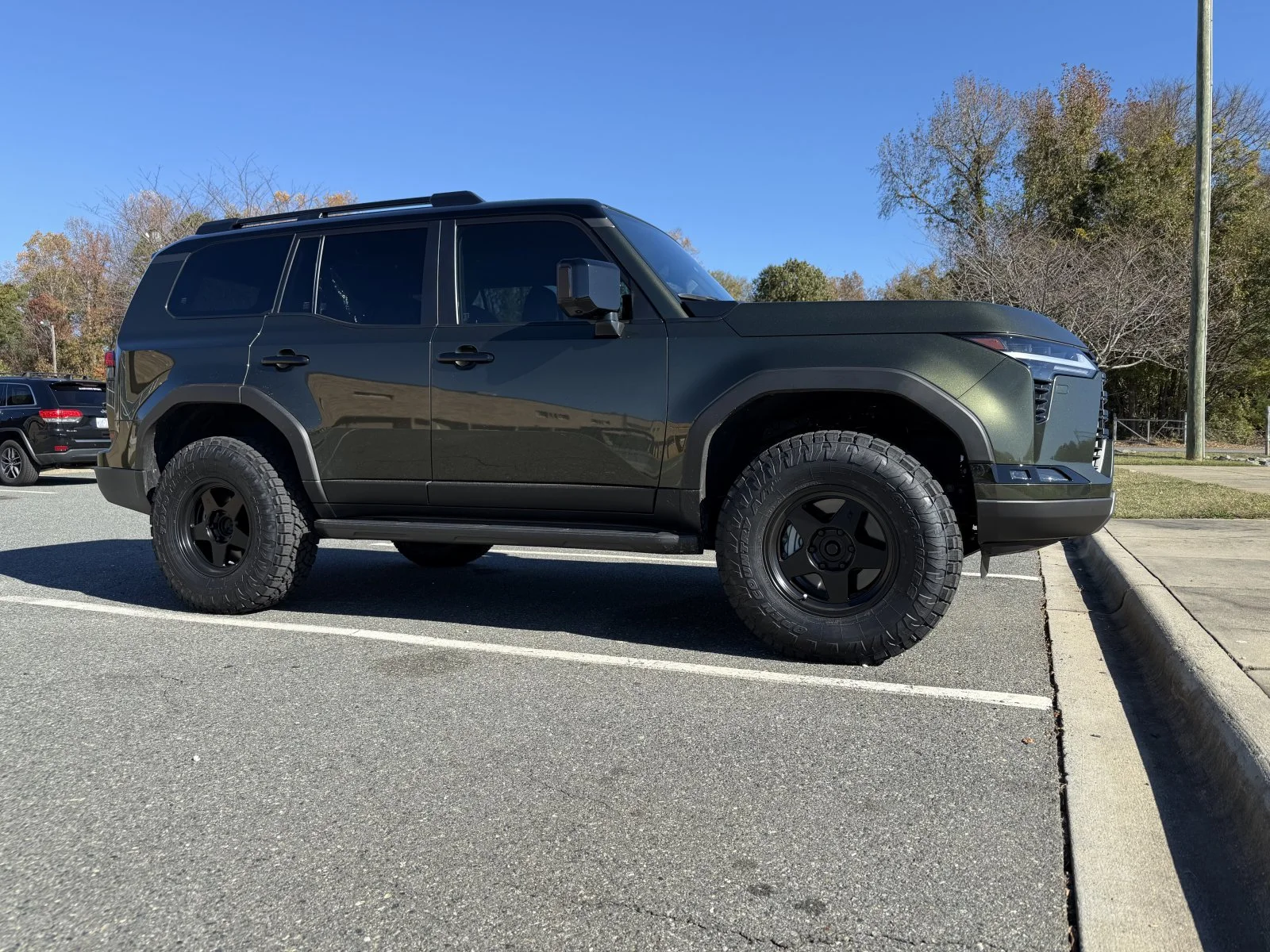

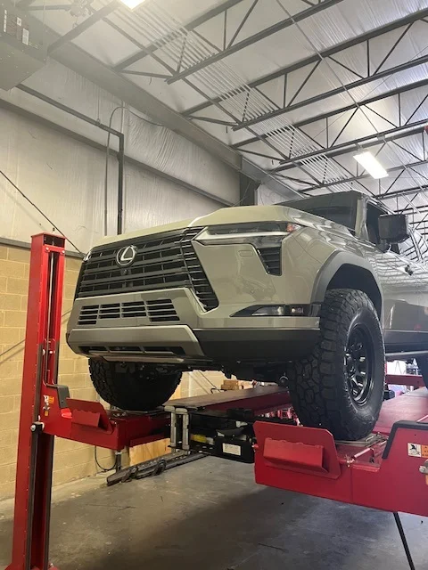

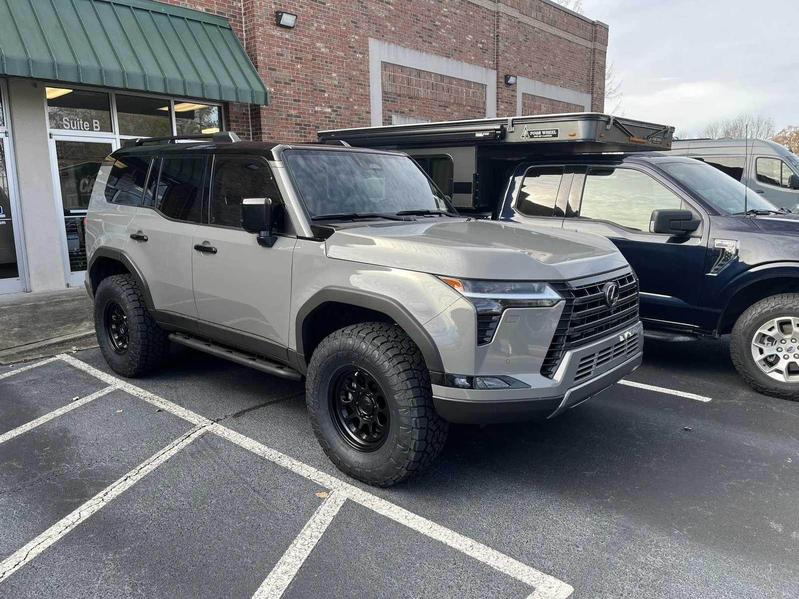

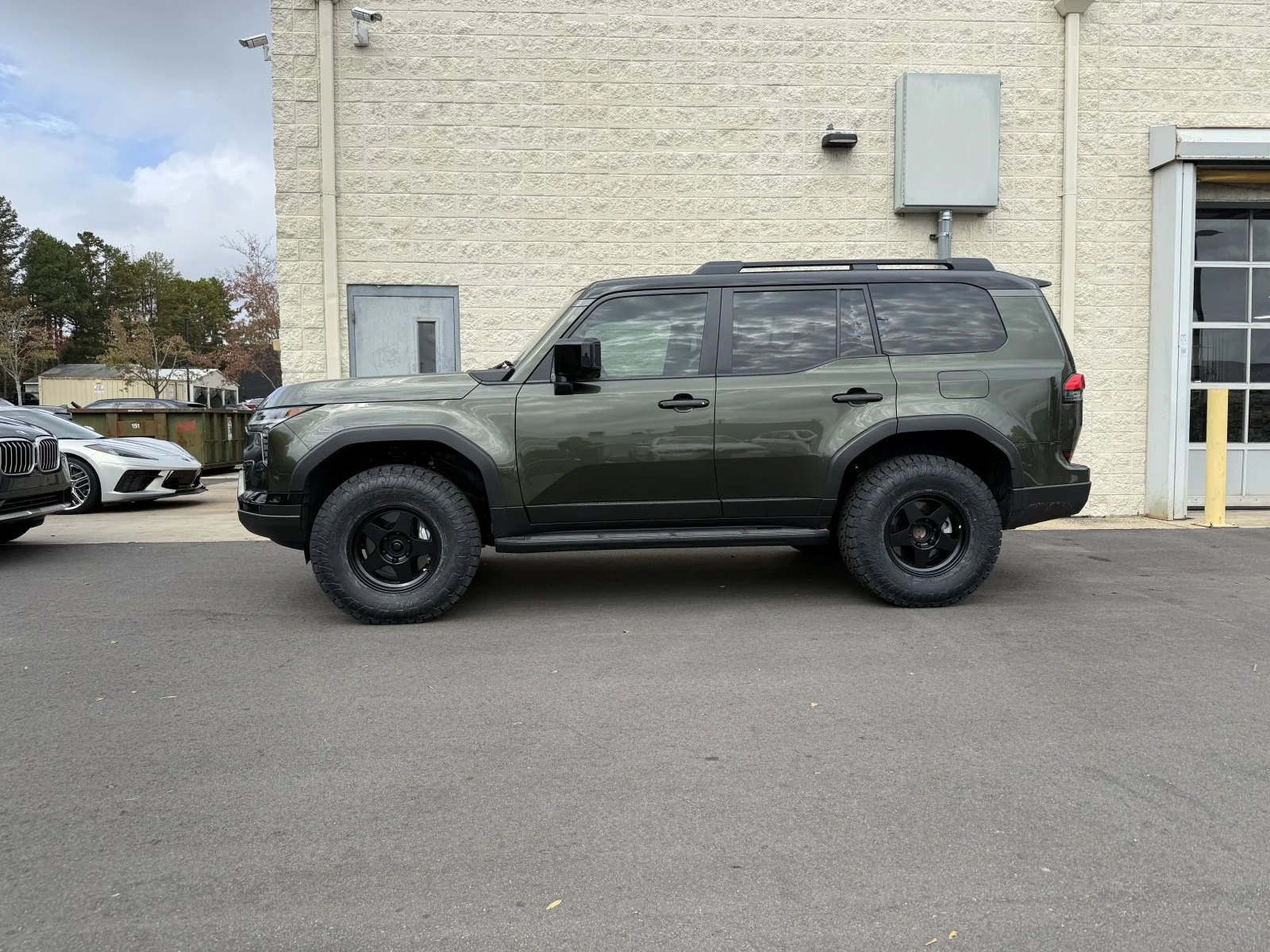

Long time listener, first time caller.
SCS Blaze 10 17 x 8.5 6 x 139.7 5.50"/+20
Toyo AT3 35x12.5R17
Put in by Main Line Overland here in Charlotte. Good guys.

This looks great, I just wish they offered these with a slightly higher offset (30mm or 35mm) to not poke.

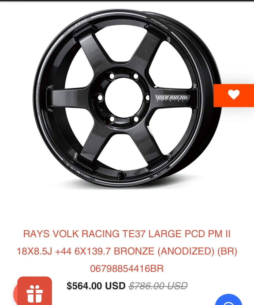

Anybody know the largest tire I could fit on a 18x8.5 +44 stock suspension. I know 275/70 fits but anybody seen bigger? PFA
