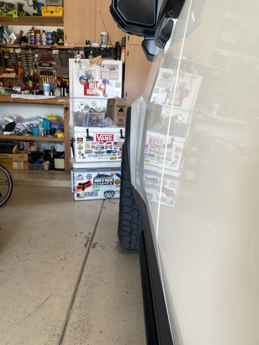

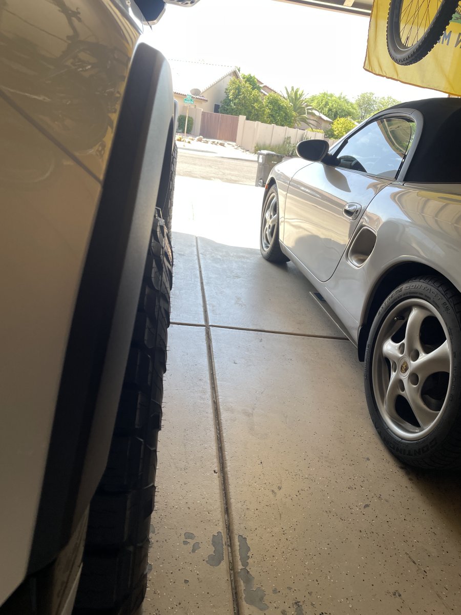

Any issue with rubbing? I'm also looking at 35x11.5 on 17x8s with a +25mm offset with the Westcott lift. They suggest a +35mm offset but I'm wondering if the skinnier 11.5" tire (that maybe only measures 34.6") will save me with the 25mm offset?

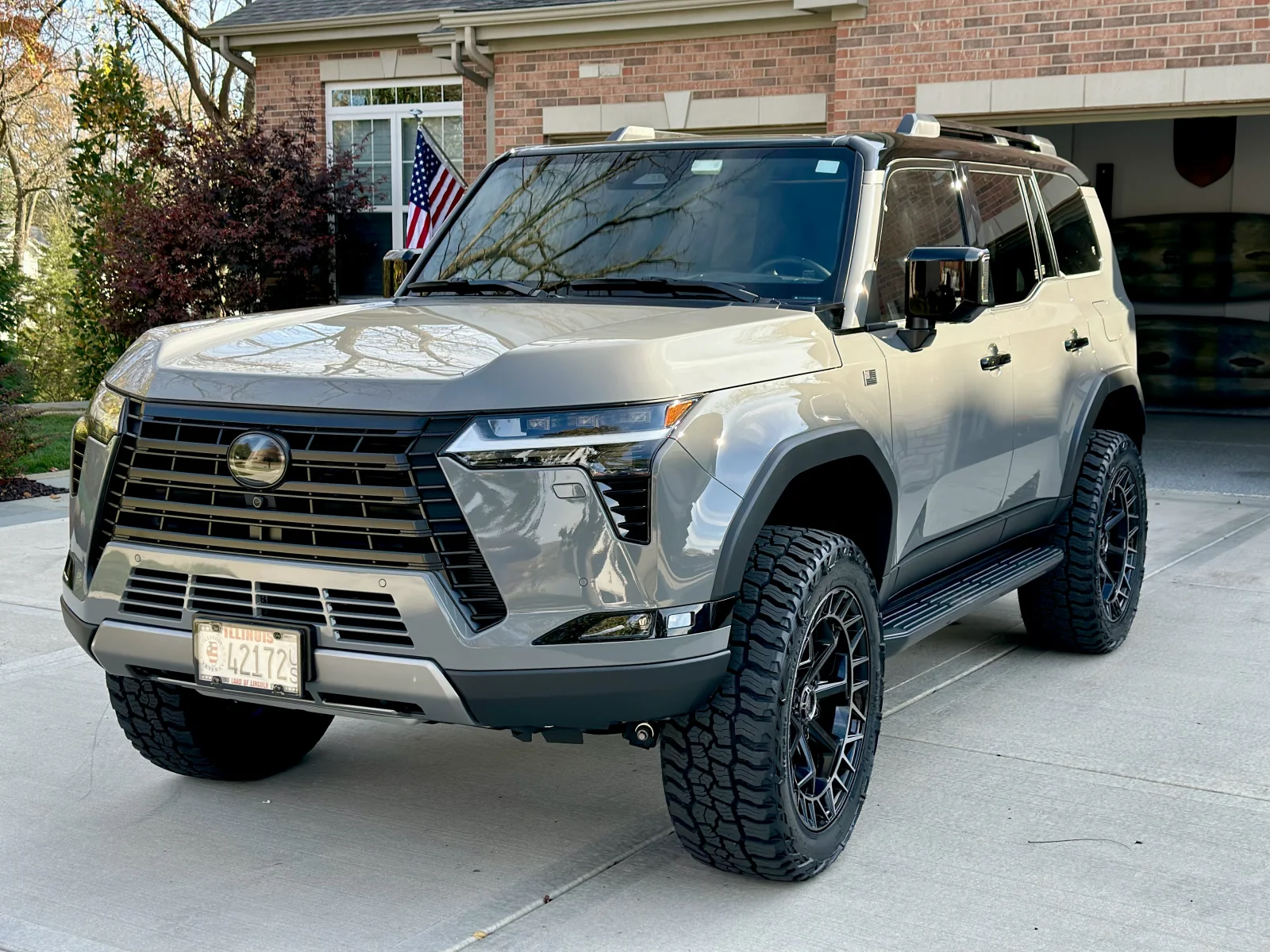

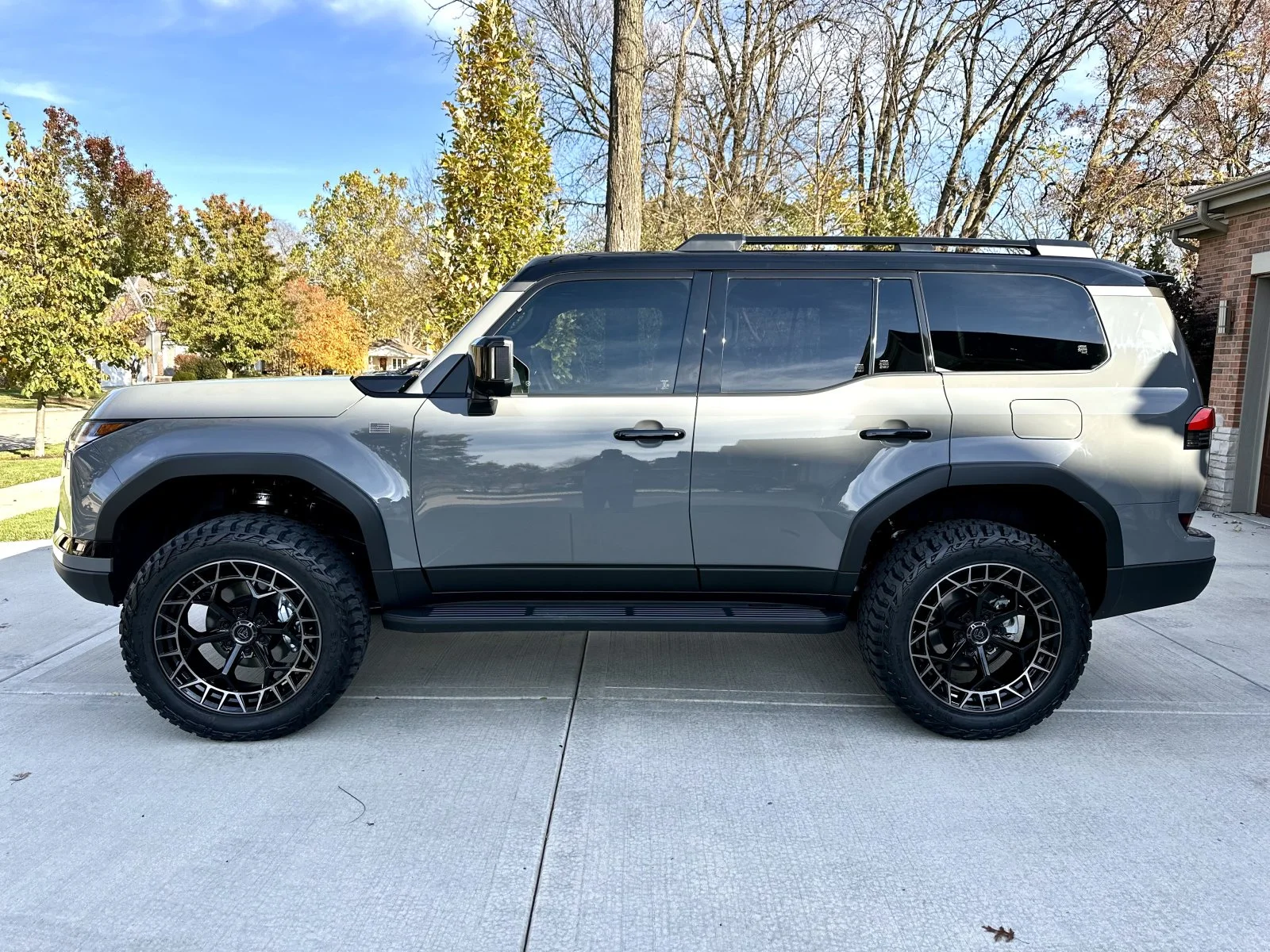

There was a slight rub on the lower bumper trim. The plastic black piece. Trimmed in neatly about an inch and no other issues since. I'm on an 18x9 with a 20 offset. If you stick with a 35 mm offset no trim should be necessary

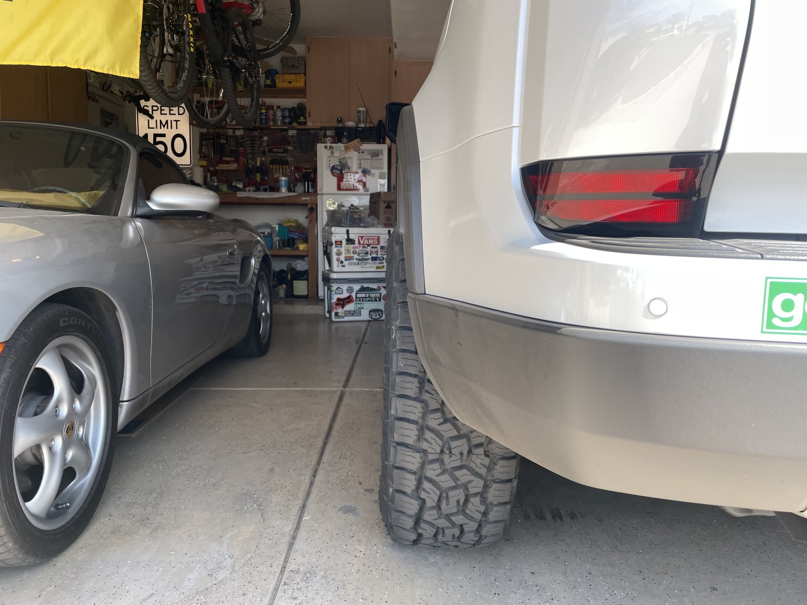

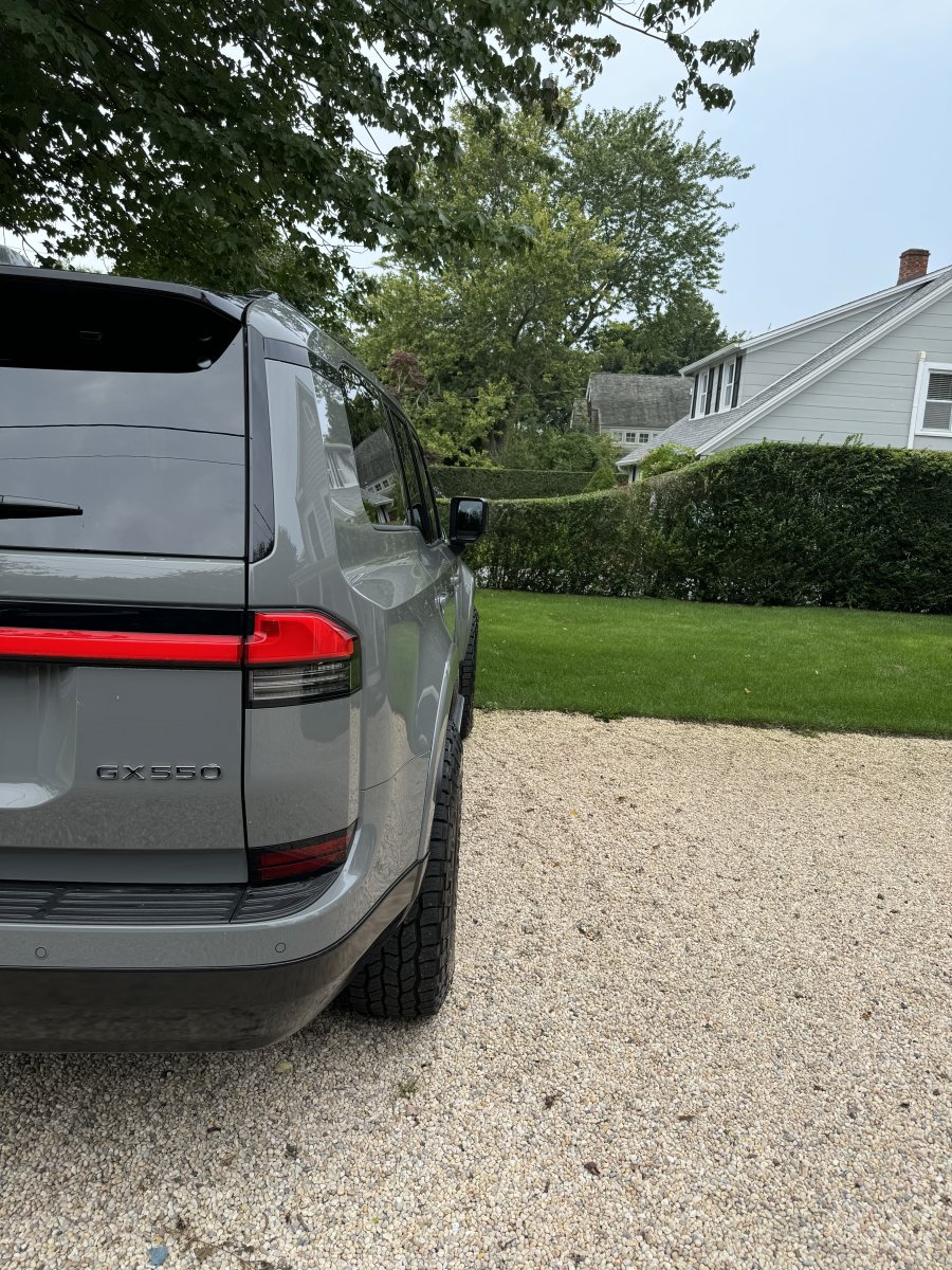

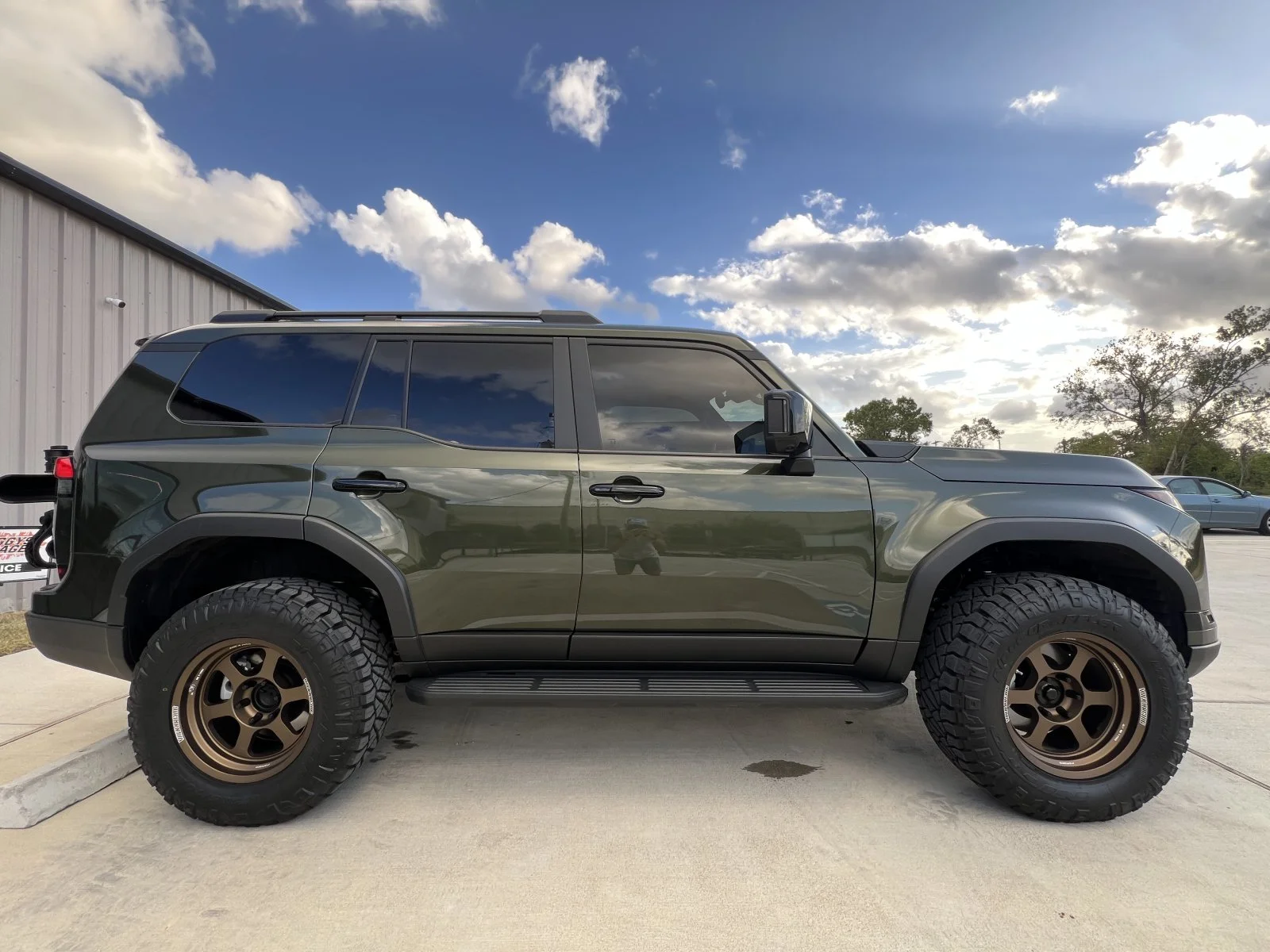

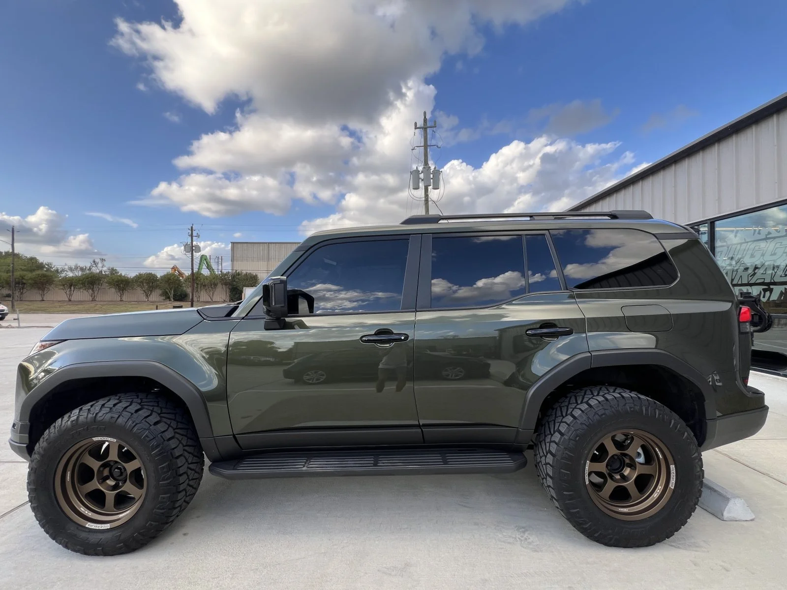

Here is the side view of my truck with Westcott lift, +35mm offset Method 703s, and 35x12.5x17 Toyo AT3s at the manufacturer's specified 35 psi.
View attachment 4721View attachment 4722View attachment 4723
So with 11.5 tires and 35mm offset, picture my side view with the tire tucked inboard a 1/2 inch (your 11.5 would be 1 inch narrow, thus 1/2 inch per side. It would be a negligible difference.
If you are poked 10mm farther outboard with a +25mm offset, that's a bit less than 1/2 inch, so it should look essentially the same as my setup. You'll be a few mm inboard of mine, all else being equal. Again, negligible.
Prepare to be happy, you'll like the Westcott treatment!

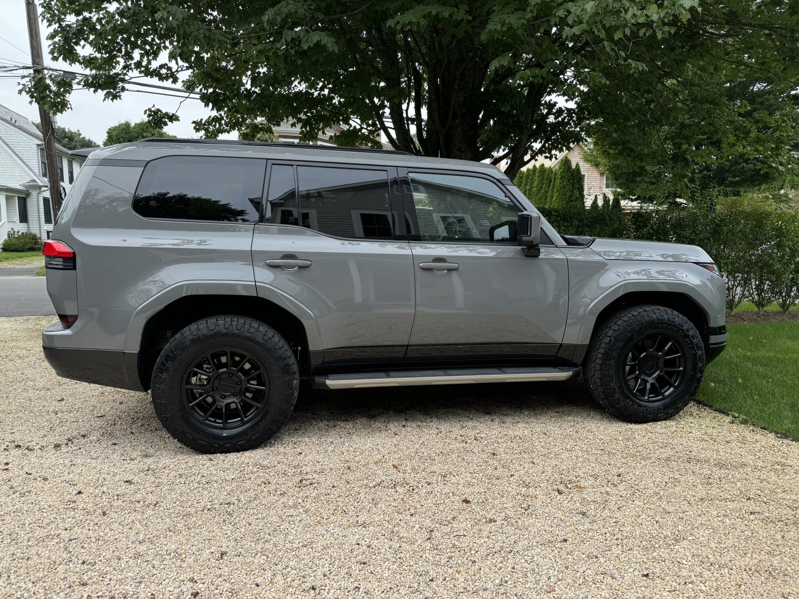

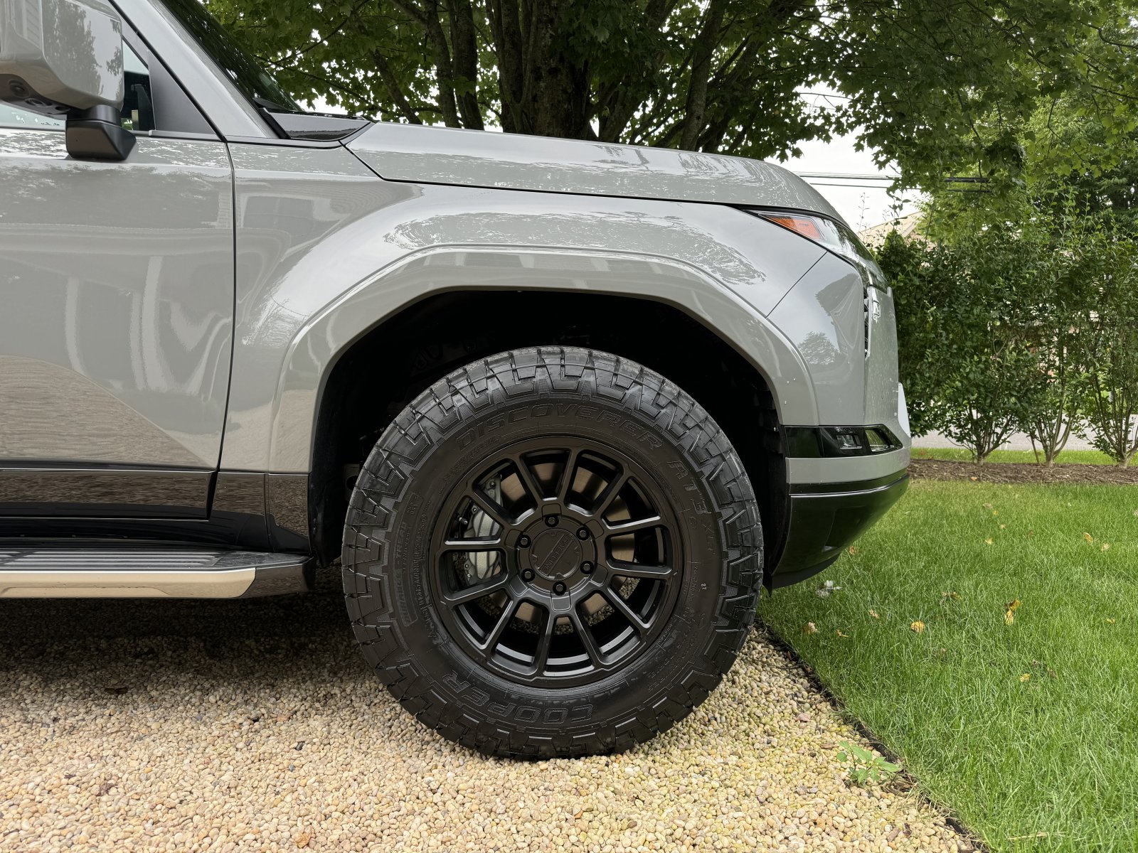

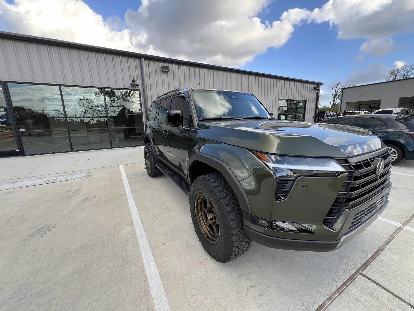

18x9 +0 TE37XT
285/70/18 Nitto Grapplers
Wescott Collar Kit
The front bumper needed minor trimming and mudflaps removed due to rubbing. I love it!

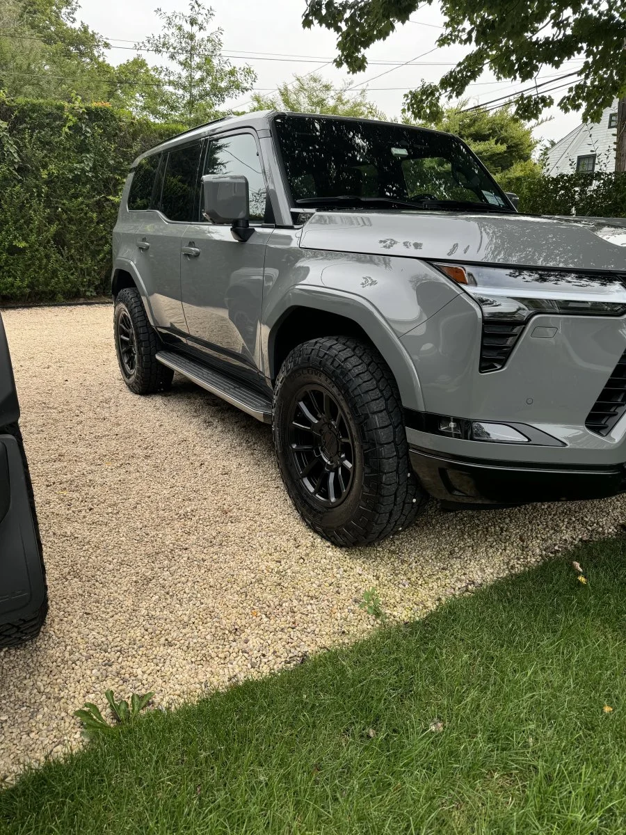

Fuel Charger's 22x9.5/-18. - MT Baja Boss 285/55R22. Had these on when purchased. Did trim the bumper because of rubbing. Came with the spacer lift also, but going to Icon asap. This size tire won't fit as a spare without trimming/removing the guide bracket for the spare. Haven't done that yet cause unsure even if I did that it wouldn't rub the panhard bar.
