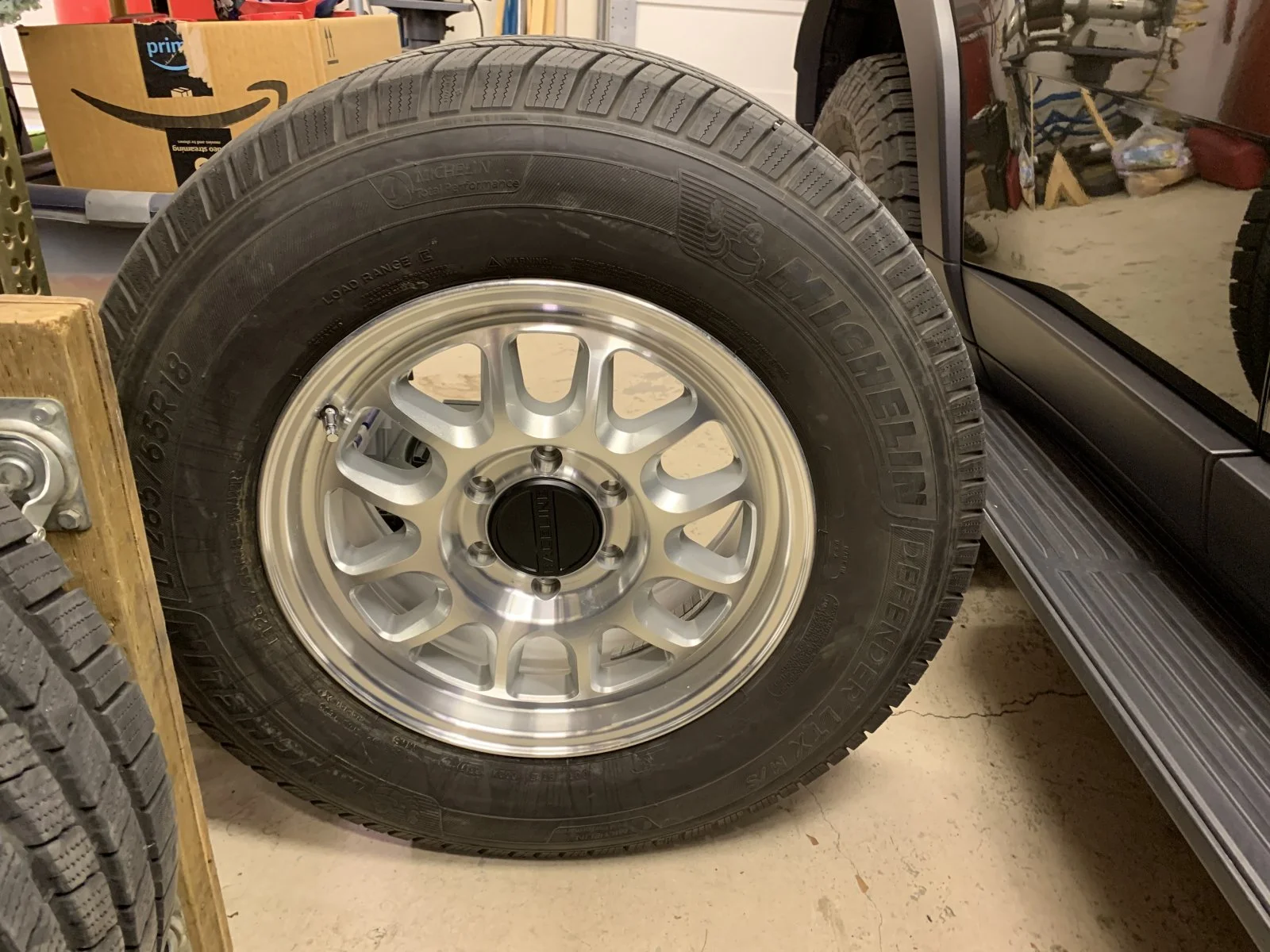

Quick update. Still leaning towards Defender tires but torn between the MS2 and Platinum (only made for 20" wheels right now). They advertise the Platinum for "luxury heavy-duty trucks". I like the look of it a bit more than the MS2--a little more aggressive look while still being a road-first tire. I noticed the weight difference is pretty substantial--55 lbs vs. 38 lbs for MS2. Would that weight difference have a significant negative impact? Hey, I assume I'm dropping some weight going from 22" to 20" wheels ; ). I was just surprised to see that differnce.
Any thoughts on the Defender Platinum for the GX?

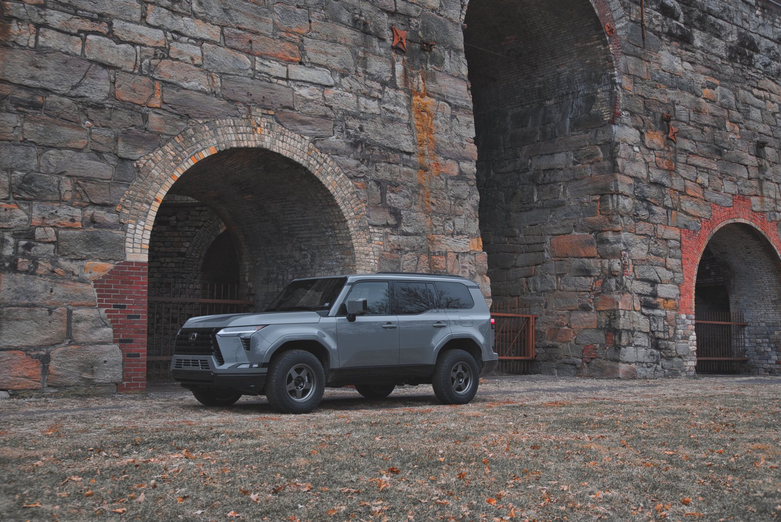

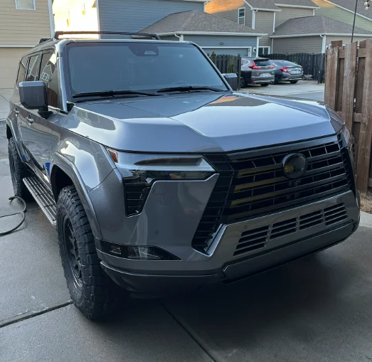

SCS Gen5 17x8.5 et20
Cooper 255/75/17
Not a common choice, I'll put an explanation below the pretty photo.
Went down a deep rabbit hole of rim/wheel weight.
I was also trying to have flush/zero poke, but also didn't want 703s.
For tires... I have had bad experiences with LT tires.. which means I had to do 32ish.
With the more aggressive +20 offset, I had to do skinnys to stay tight.
Which, I think I'm happy with? I'm on the fence still. I think one more inch would have been great. It would also be great for SCS to make a +40/+35..
Anyway, saved 11lbs per corner and added .75" of tire diameter over the Stock P+ Wheels. While making it look like a truck. Still a win.

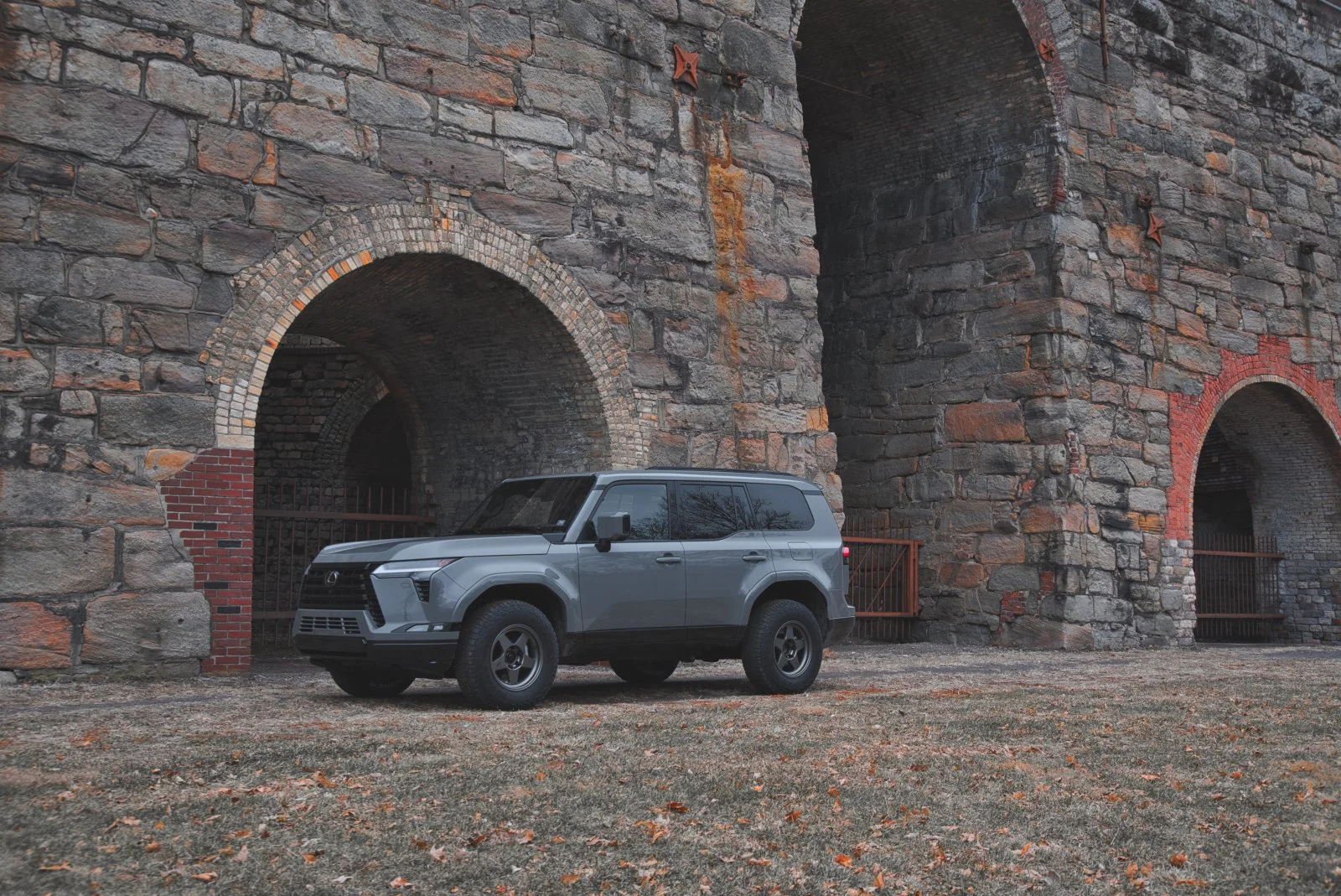

Cooper 255/75/17

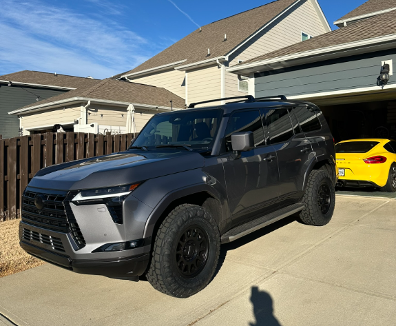

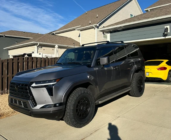

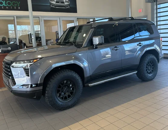

Installed the Westcott collars (w/ floor stands - not fun, but doable) last weekend and finally got the new shoes on yesterday.
Thanks to this forum, I ended up going with 285/75-17s (Method 703s w/ 35mm offset and Toyo ATIIIs). I believe this to be the largest size one can go without rubbing/trimming. I was afraid after getting them mounted I'd regret not going with 35s, but man these look absolutely great - perfect size and poke - no rub and no regrets. Discount initially ordered the wrong rims with zero offset, and we didn't discover it until after they were mounted up, as they rubbed badly. I'm glad I got to see the setup though (with a little more poke), and glad to share the info on this thread. Ultimately, Discount gave me $100 back for my trouble, reordered the correct rims, and had me taken care of in 2 days.
Below is a pic in all her glory, albeit dirty as hell. More pics to come - next up are NYTOP sliders and axle dump exhaust, and then F/R bumpers. Roof rack eventually...

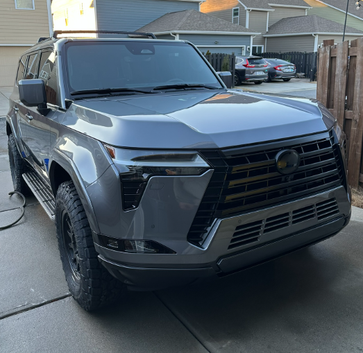

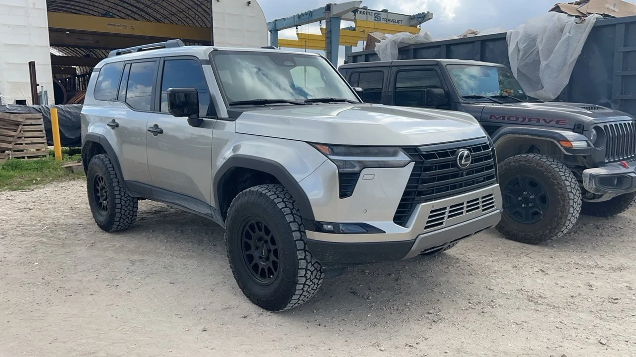

This is my daily so I went with the safe Method wheels route with no lift. No rub, no shakes, low noise here are my specs... HAPPY MODDING I hope no one has to overnight parts and go back to the shop twice.
Wheels: Method 307 (17x8.5 +35 offset)
Tires: Toyo Open Country AT3s 285/70/17s
Hub Centric Rings: Wheel Connect Aluminum Alloy OD 106mm/ID 95.1mm (*ones that came with the wheels are too big)
Lugs: 14mmx1.50 Thread Small Diameter Duplex Spline Gorilla Automotive (*your OEM lugs will not fit the new wheels, OEMs will be too wide. Had to overnight these) They seem to be doing the job at the moment but I'm sure there's a more reputable brand out there.
TPMS: 315mhz 2024 Tacoma TPMS (dealer will program them for $180)
Spare: I have no idea what I'm doing with it yet. Open for advice. Might be ok with keeping the stock 20s since the diameter is 32.52in (265/55/20) vs. 32.71in (285/70/17).
