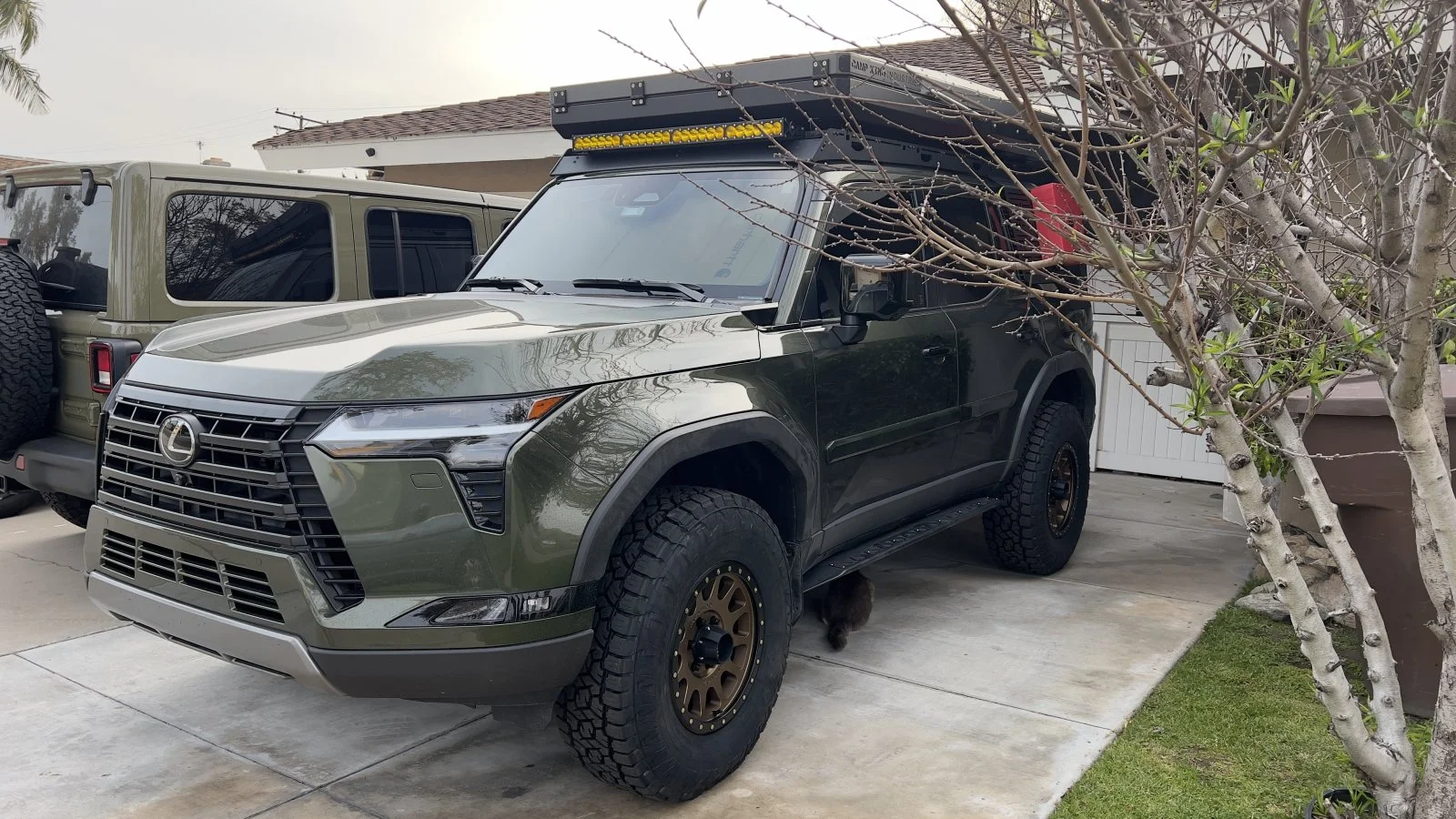

Here is my current setup...
Overtrail+
Matte PPF
Westcott Preload Lift Kit
Volk Racing TE37SB 18x8 +30 Pressed Double Black
Toyo Open Country A/T III EV Tire - LT305/70R18 126/123R E/10 (34.8" Tall Tire 60lbs)

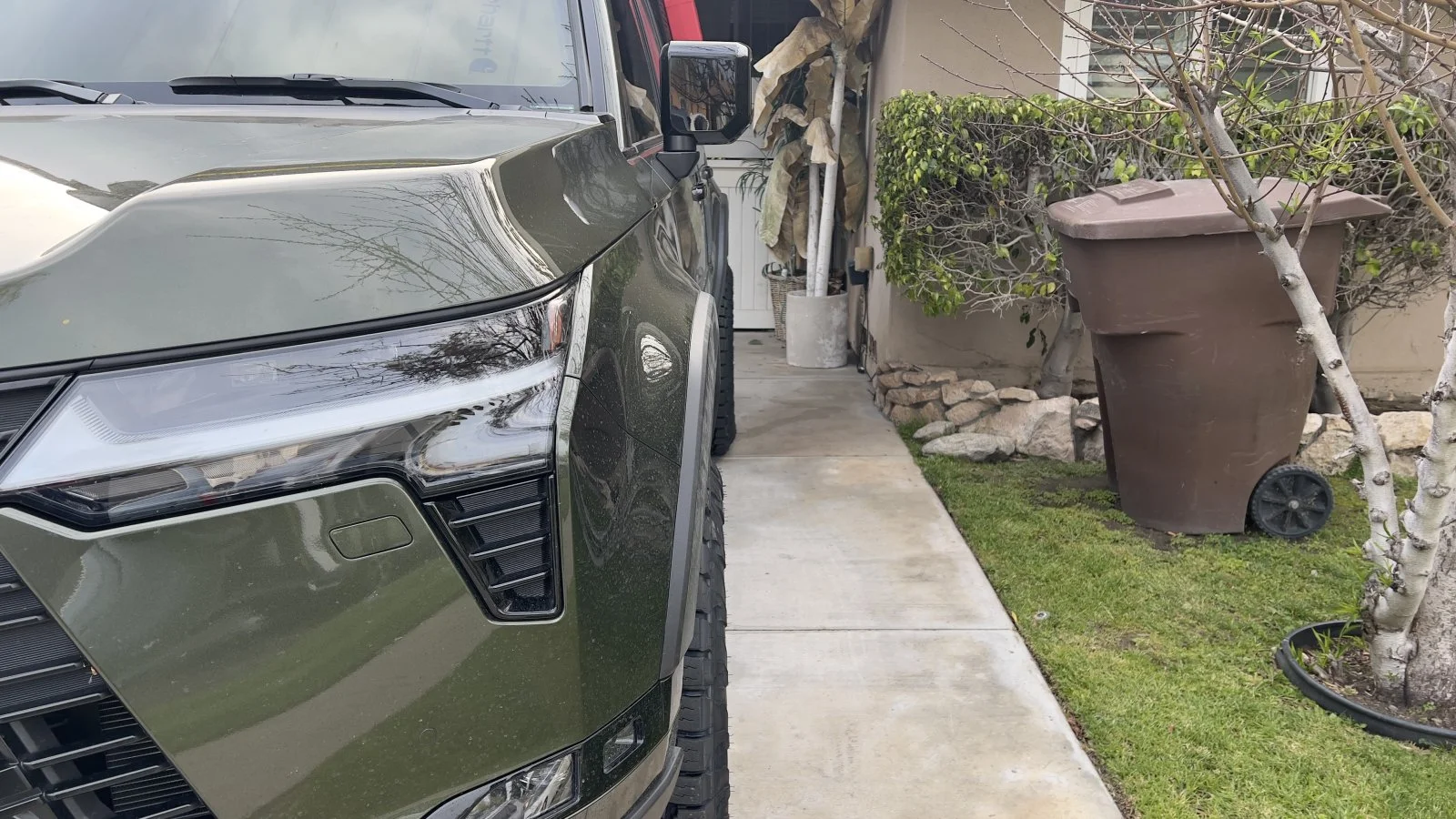

I had to push in the front fender line in a little bit. Took off the cover for the safety bracket. Going to remove the bracket soon because after I got an alignment I get slight rubbing in reverse.

Looks great - I am guessing you're not running a spare/keeping the stock spare in place?
Curious how you like the ride post-Westcott and LT Tires compared to stock.

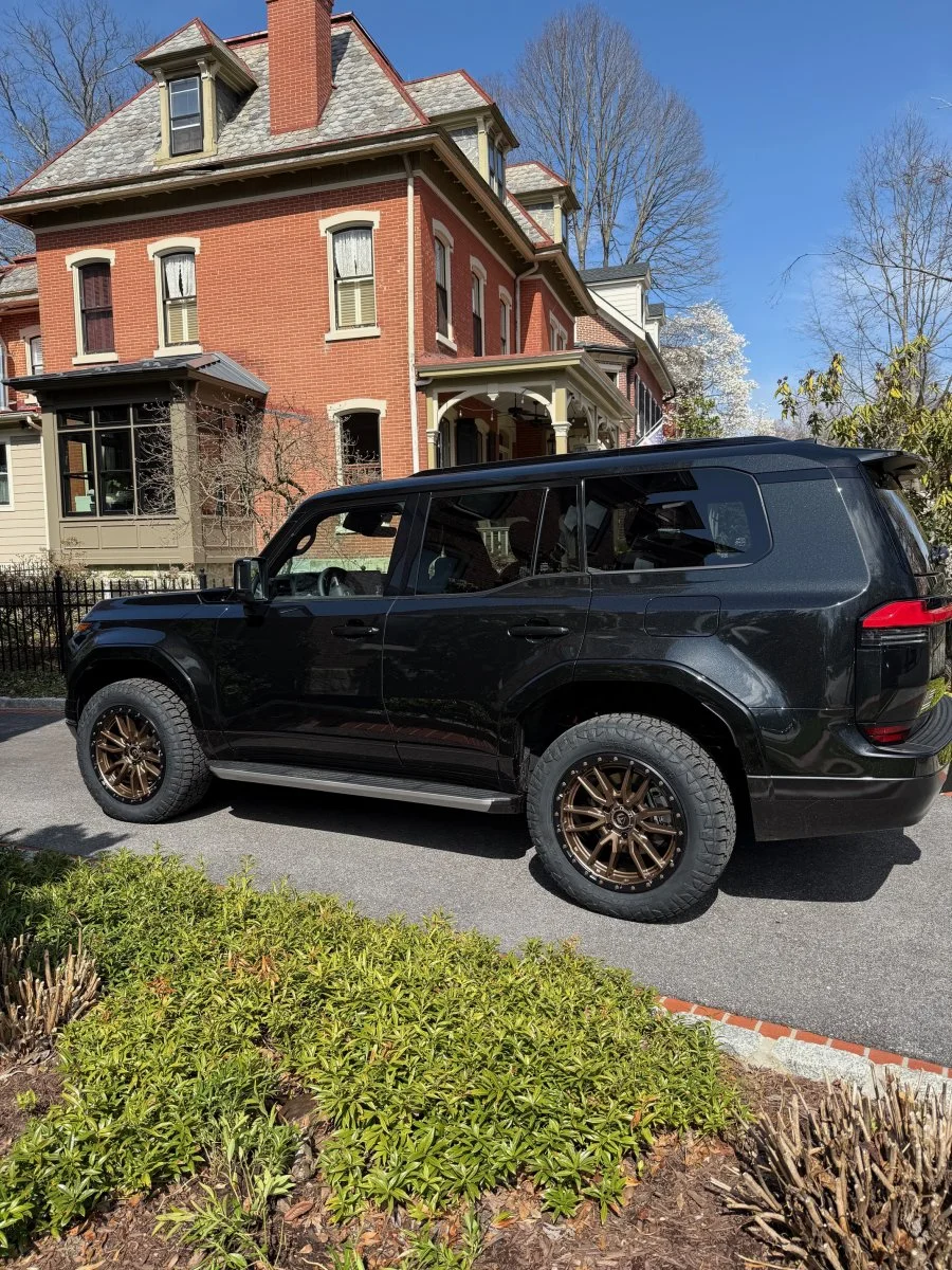

Here's a pic of my 2025 Lux. First thing I did was swap out the 22"' wheels and tires for Fuel Rebel 20x9 (+20 offset) and Nitto Terra Grappler G3's (275/55-20, XL). I think the bronze (which also has a bit of metallic color to it also) looks fantastic with the Caviar and the (mostly) blacked out appearance. The +20 got me exactly the wheel pop I was looking for, and it added some aggression as well as better foul weather performance. Very little road noise as well, much to my surprise

No full size spare as a 35" won't fit. I have a plug kit and a portable inflator. I transport stuff often so don't like swing arm mounts.
The ride from just the Westcott kit is slightly harsher but nothing bad. Ride overall is quiet from the tires. I get some noise from the roof rack when there are strong cross winds. I removed the rear brackets yesterday but still have slight rubbing from the front fender liners. Need to do more clearancing...
