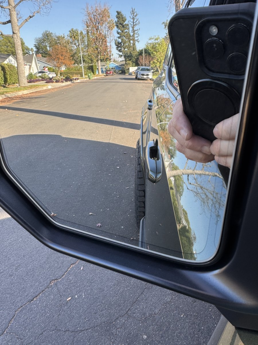

Gonna have a good bit of poke.
Yeah, I have decide to go with 275/60/20 on 9” rim with +18 offset. Hoping it’s not too much poke, but Vossen doesn’t make anything better unfortunately. I really do like the rims, going to go for it.
That's similar to my setup - 9", +20, 275/55/20. About 3/4" of poke. Looks great. I am adding mud/rock guards though, just to save the paint and fellow drivers' windshields.
