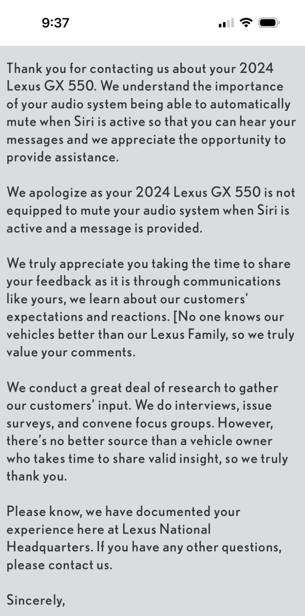

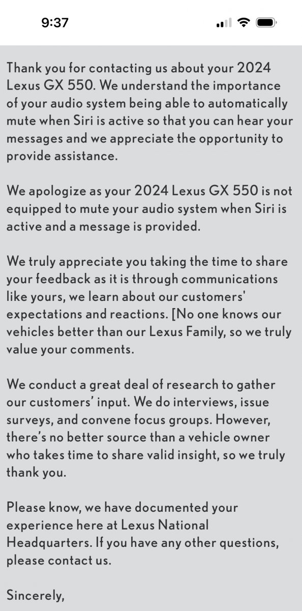

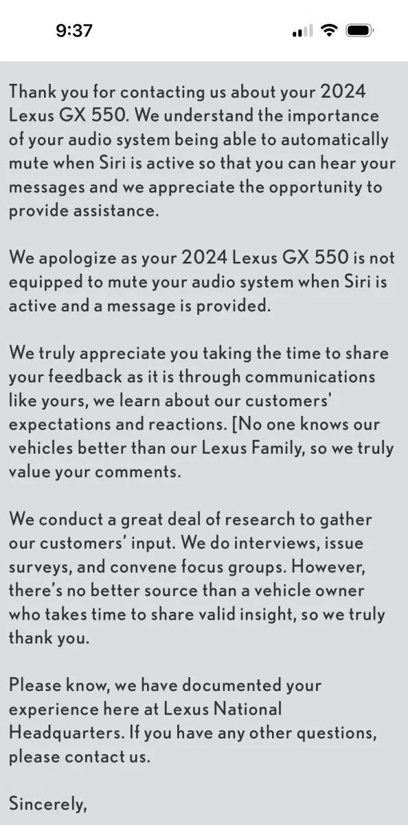

The response I received this morning regarding the Siri mute audio issue:
I was able to get an engineering case created, and will be meeting with a diagnostic specialist at the service department next week to document the findings and video the behavior, so that we can get it prioritized and fixed.
