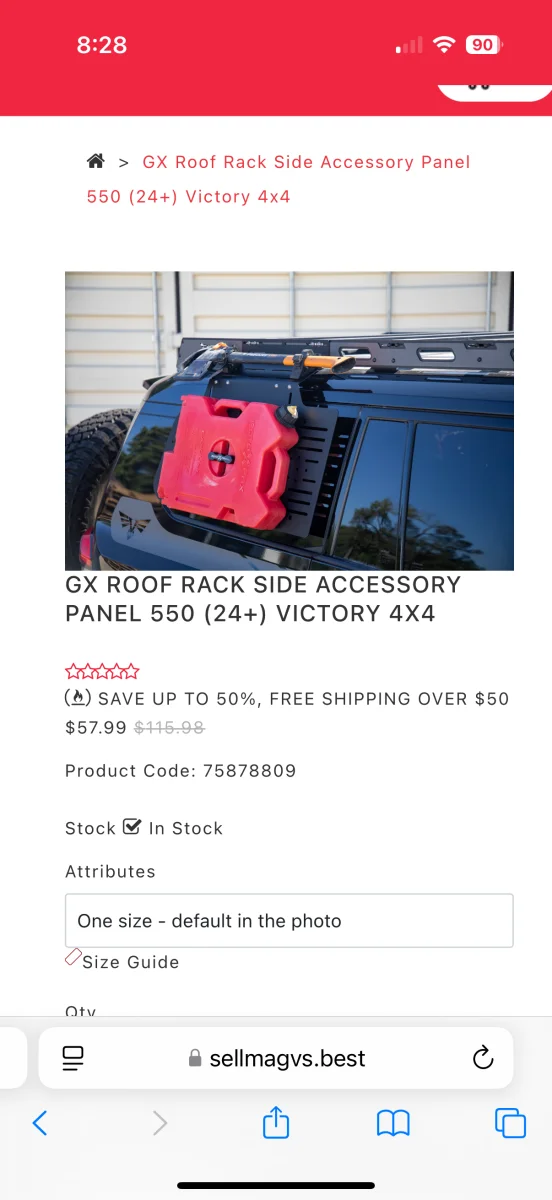

This one is made for the GX550 window fitment

Yes, thinking of the short LC rack.
This looks flexible. Like to find a locking one
