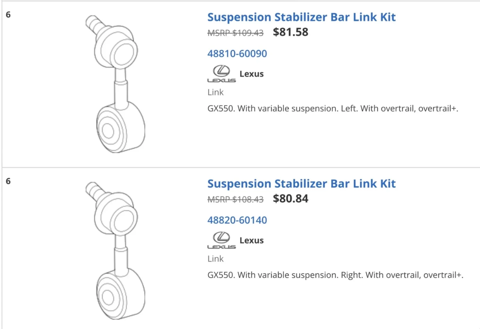

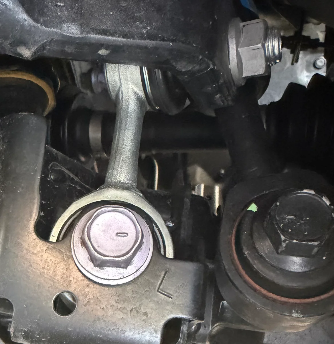

Mine issue with the clunking ended up being the stabilizer bar links. They were both replaced and the clunking sound/feel is primarily gone. I do on rare occasions feel it slightly but it’s minimal.

Through my research it seems to mostly affect OT’s and many are experiencing the same problem. There are other GX550 forums and FB has 550 groups that also mention the issue. I was fortunate to have such a great service team that went above and beyond to get this issue corrected. Not once did they try to pass the buck and say it was normal or log a concern with Lexus. Ask them to replace the sway bar stabilizer links. After all its under warranty and they should do almost anything for customer satisfaction
