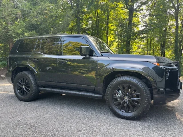

Was just planning on doing 2.75 front and 0.75 rear. Take the rake out.
This is 275/65/20s on the stock premium+ rims

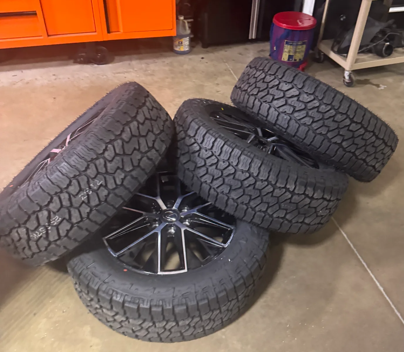

20” GX550 Premium + wheel 20x7.5” -
Nice looking, very strong OE rim. Looks really good w/ AT tires mounted on them. Find take-off sets very easily that are affordable.
275/60R20 115T Falken Wildpeak A/T4W -
Large 33” tire, looks good in wheel well, comfortable ride @38# leaving tremendous load capability, 115T gives you lighter tire & T 118mph speed rating. Wildpeak 275s are larger & wider AT tires, but will handle like street tires in rain, dry, & are great in snow & mild off road. Make sure to stay with lighter load rating.
Puck Level kit 1.25” -
If you want to fix rake use Puck system as inexpensive & perfect for on-road & light off-road. GX springs are variable rate, & the Puck 1.25” spacer will increase preload slightly making the front springs compressed & firmer, but not at all un-compliant. Will handle better, reduce brake dive & still feel fine. Puck & Westcott concerns in my opinion are totally blown out of proportion that their preload ruins ride. The wrong load rated AT tires getting put on these luxury SUVs do much more to ruin ride. Really don’t need rear lift to level, unless you will be towing often w/ front level.
You’ll have nice looking rig, larger lighter comparable weight tires, leveled, & handle better.
