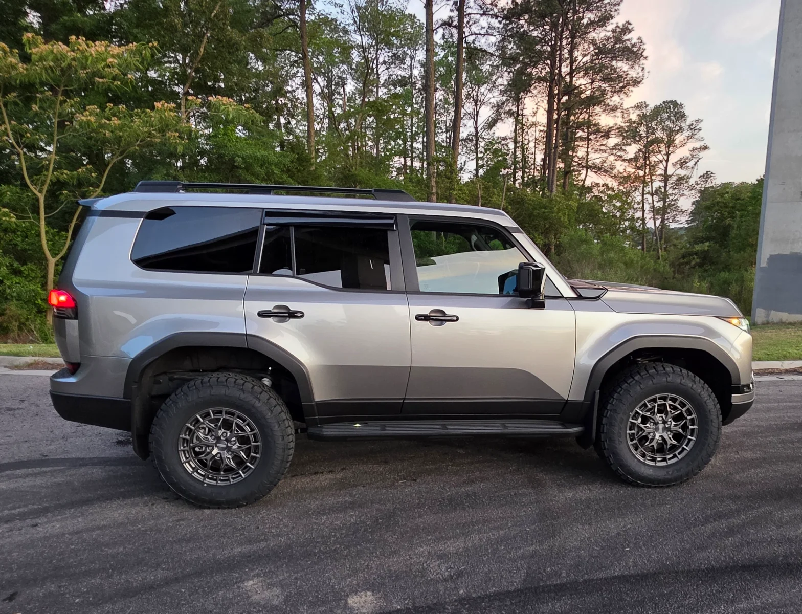

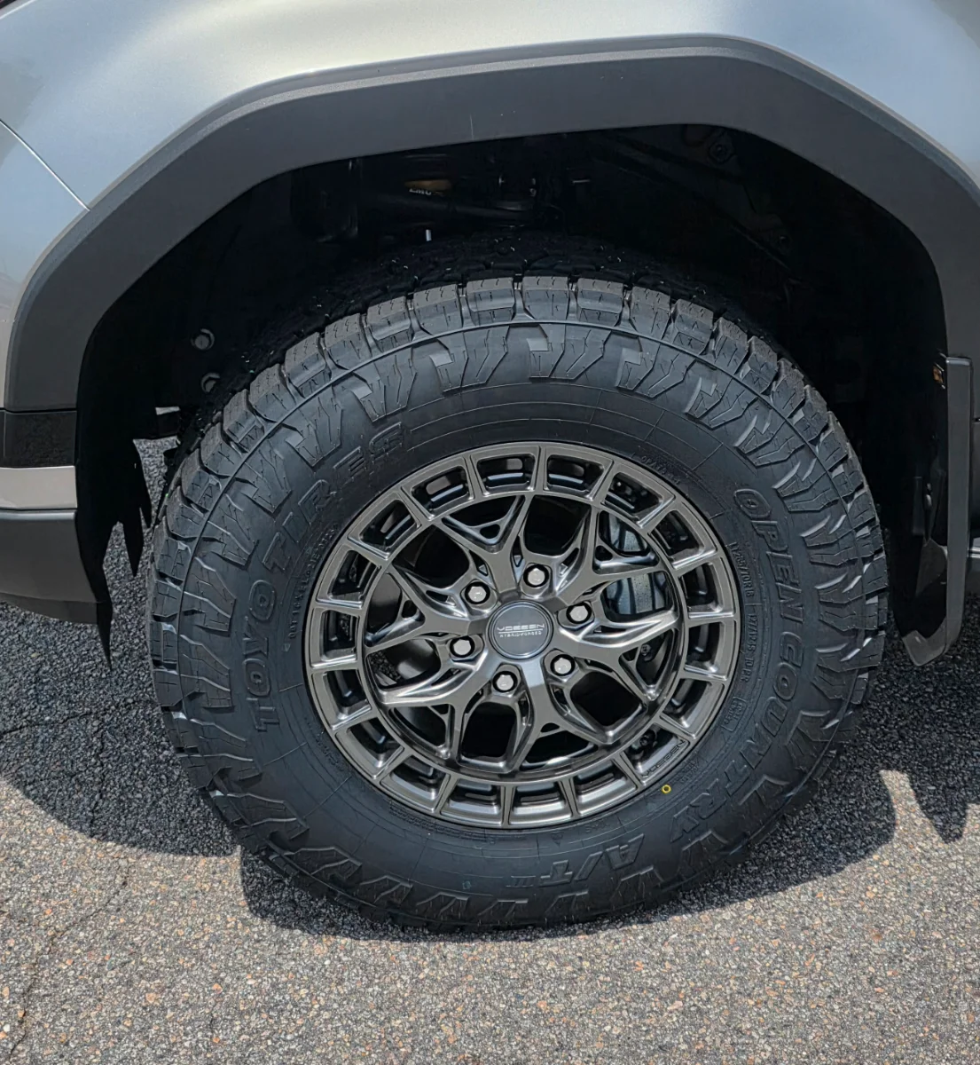

I have a 25 OT, and went with OME MT-64 3" lift for offroad purposes, and to fit 34s with no issues. I will say the ride was better with the OMEs compared to stock suspension, but not drastically for the costs. Again, it was only for approach angle for offroading at the beach, otherwise I would have not spent 4K on the lift kit itself. I went with 18x8.5r18 wheels, and 285/70 Toyo's ATs. Listen to these forum responses, 22s are for looks and NOT ride quality. Make sure you offroad tires are Load C or SL, and NOT E rated for ride quality.
That’s a great looking wheel, really unusual. What is the offset? And do you know what the wheel weight is? TIA. 😊
Wheels and tires look great but my god the shop could have did you a solid and offer black lug nuts
