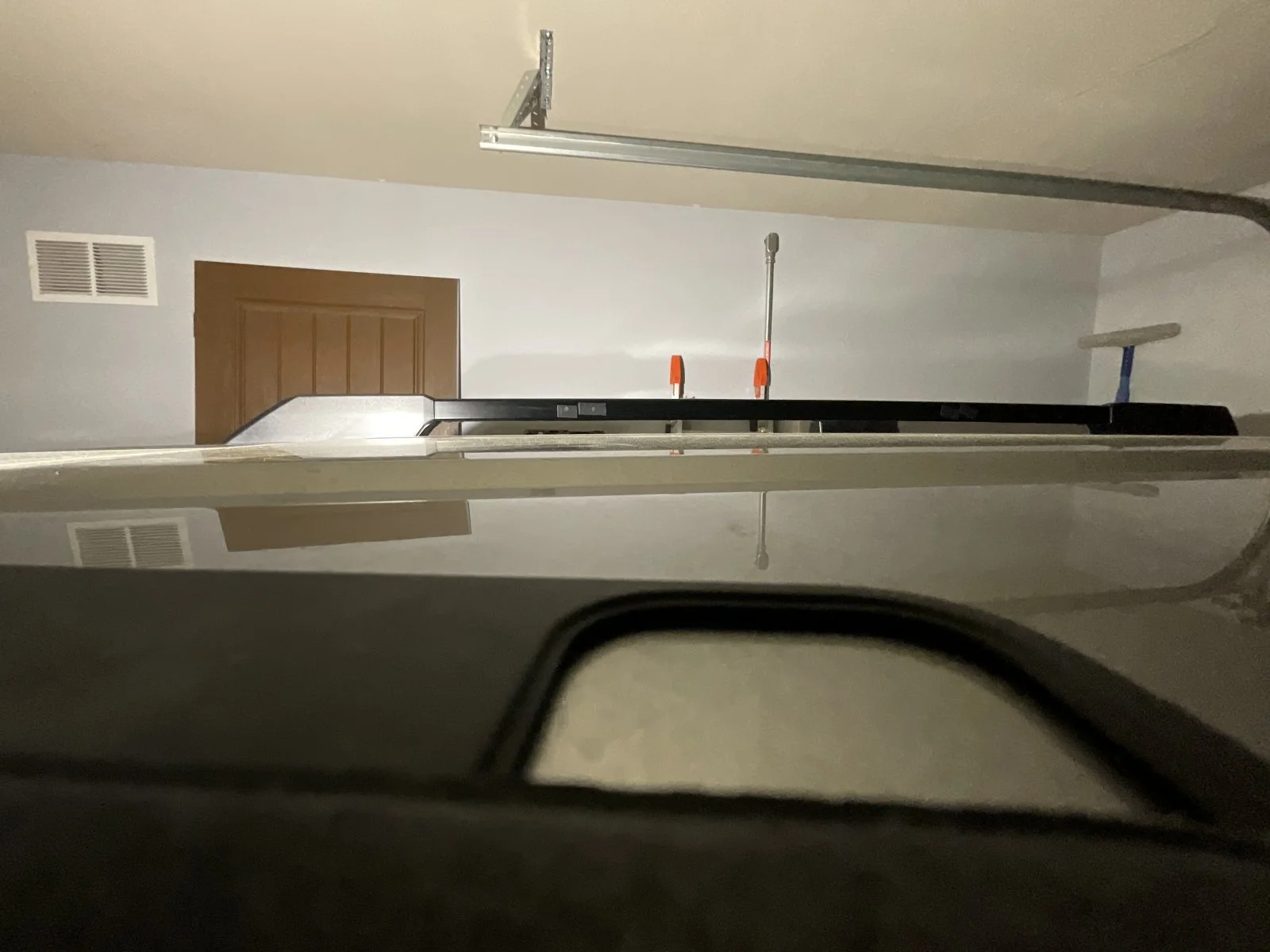

I removed the cross bars from the original roof rack on my OT+ and now I can see small holes on the inside of the roof racks where the cross bars fit.

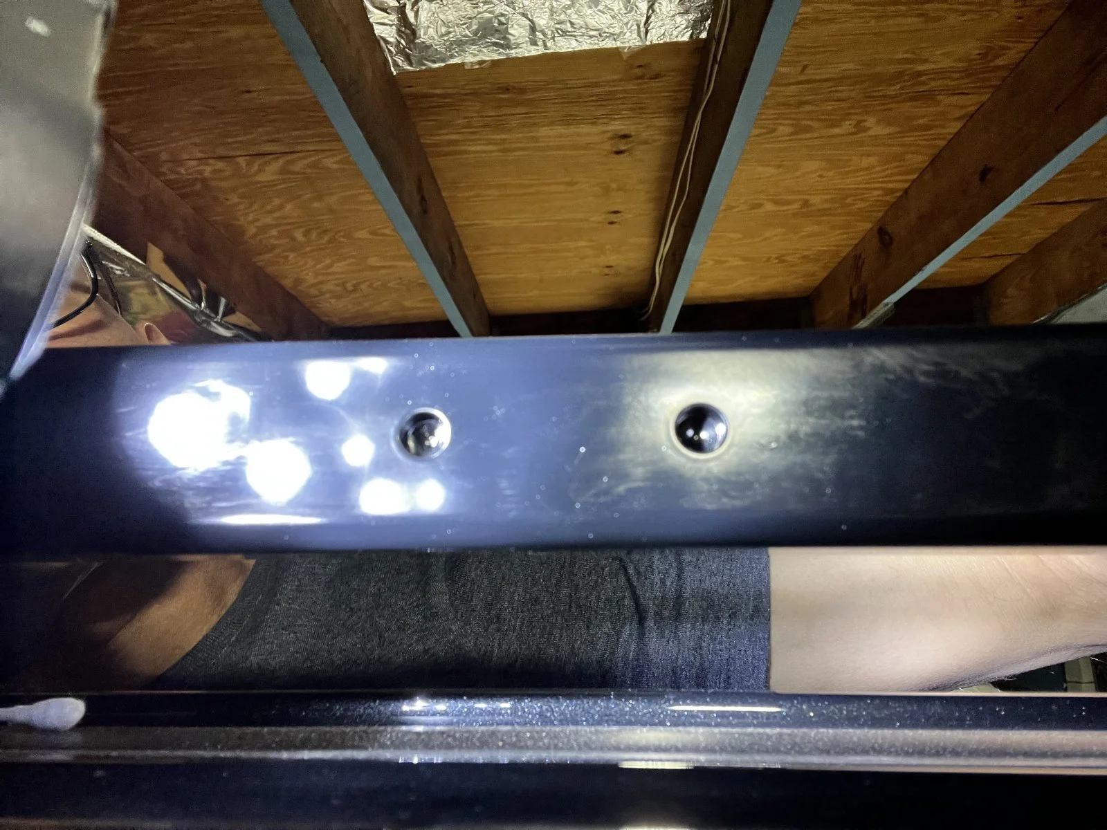

Correct. The cross bars have two prongs where they fit on the roof rack at each attachment point. These correspond with two holes on the inside of the roof rack.
On a hunch I took a picture of the two holes at each attachment point and guess what? The hole are sealed from the inside about a 1/4 inch deep from the opening!
No need to worry about sealing them up with anything. No water can get in. 👍

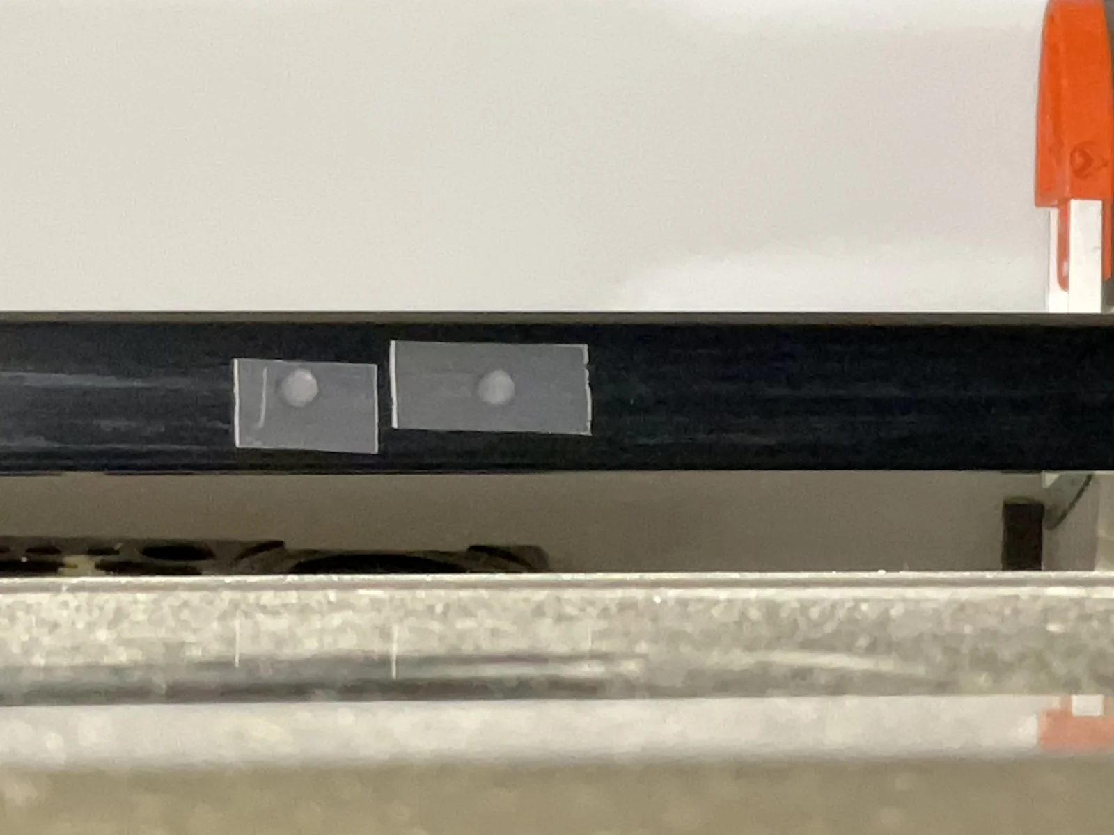

I put a small piece of black electrical tape over area with the holes. It creates a good seal and is largely unnoticeable (except with a bright light focused on it).
There’s no need for the tape since those holes are actually just depressions and not really holes.
Cool. I assumed they were threaded back when I did this . - at least they’ll be clean when I put rack back on.
