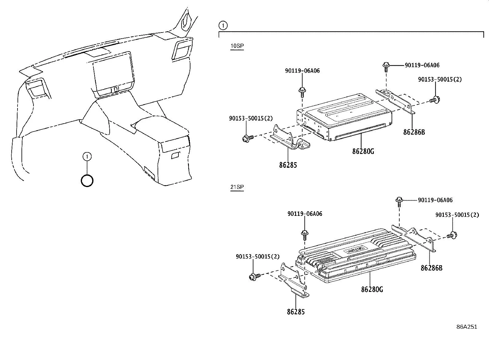

Where is the factory amp located? I'm looking into installing a powered sub and wondering where I should tap the speaker wires from.
Underneath the drivers seat.
Nice, is there any wiring diagram available online? Crutchfield has no information on the GX550 yet.
