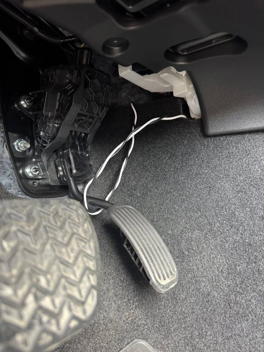

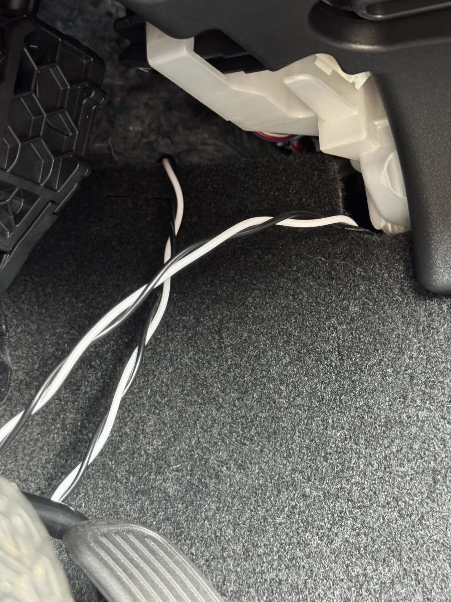

I am SO glad to hear that it's not just me! My husband thinks I'm being too picky and comparing it to my GMC Yukon Denali, which has a Bose system. I just had an amp and sub installed and it STILL sounds terrible. Like with you, Lexus says it's all normal and that since I have the Luxury+, it is the top of the line. It is one if the very few things that I dislike about the truck and I'm super bummed. I was starting to think that the speakers/system were defective. I also just saw two wires, one black and one white, literally hanging out above and around the accelerator. I assume this is not normal? I'm an old (51) lady and don't know much about cars.
