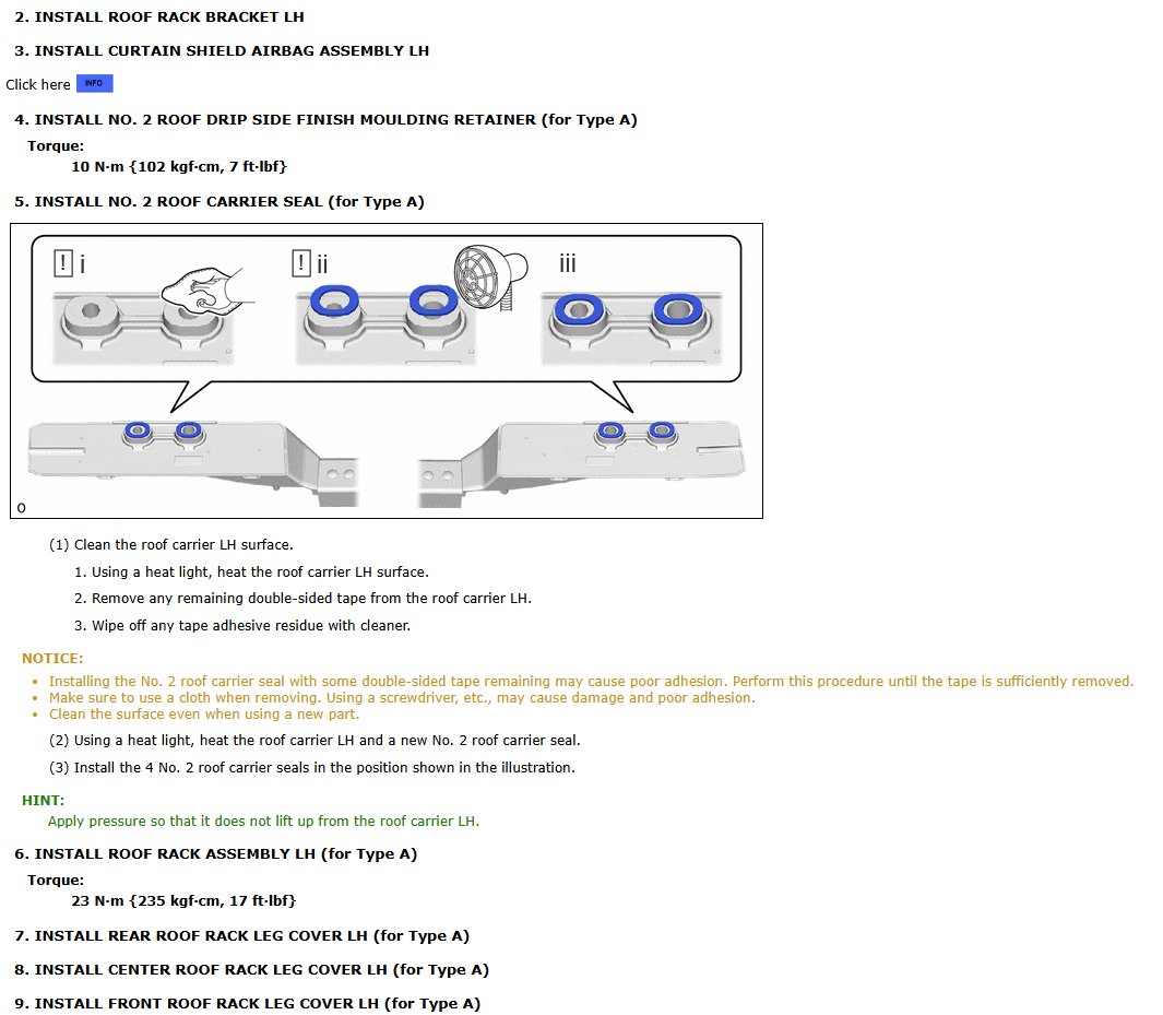

I had to remove my overtrail roof rail on my passenger side, when taking out the six bolts from the factory I noticed there was a little bit of red on the bolt threads. The bolts weren't hard to remove, so I don't think it was thread locker. I put everything back the same way and torqued them down to spec. Each bolt have a little rubber washer from the factory.
In the Lexus service manual there is nothing listed in the install procedures about adding any sort of loctite or sealant when reinstalling. Same thing when reading the Land Cruiser roof rack install PDF, no mention of sealants or thread locks (https://www.landcruiserforum.com/attachments/pt970-60241inst-roof-rack-pdf.4207/):
