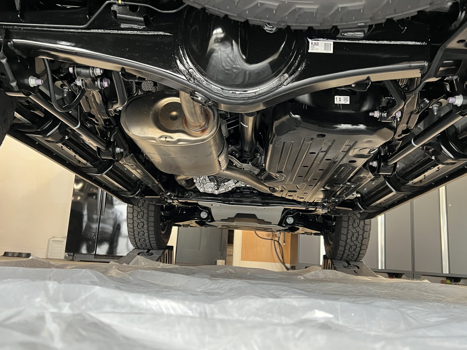

Have a feeling we’re in for a biblical winter. Toyota not being known for great rust protection I decided to stack the deck.
View attachment 4660View attachment 4661

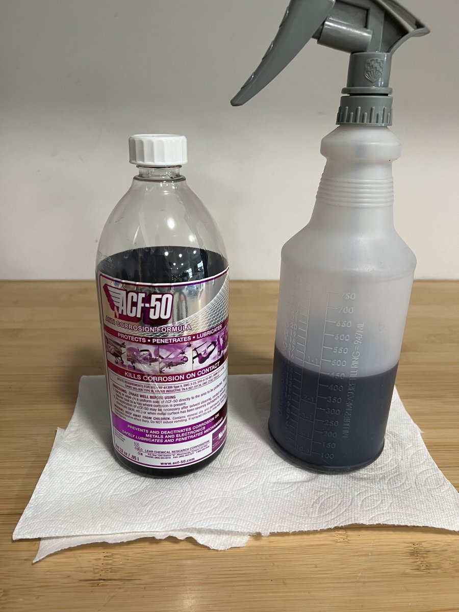

The ACF-50 is a great tip because of its reported ability to fix existing rust, not just prevent new rust. So it seems perfect for dealing with a rig that wasn't thoroughly treated when new (like my 4Runner). I'm having trouble getting in to my nearest Krown shop, where I had mine done for the first time last November after 3 years of ownership. So this looks like a great interim step until I can get another full professional coating. Thanks again for posting it.
You bet and agreed on the 4Runner needing all the help it can get on rust prevention. I'm living the same dream with my son's 23 Tacoma😉
I wouldn't say it ever cures or dries but rather leaves a protective film. I'm not a fan of anything that dries up.
What's the deal with this and the exhaust piping? Is it flammable? Avoid?
I inadvertently got some on the stainless exhaust and noticed some light burn off fumes but went away quickly. Many do use it on the exhaust without issue. I’d stay away from the cats though.

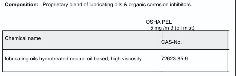

FYI ACF50 MSDS looks like it's oil & a bit mineral spirits
and Corrosion Free is just oil
