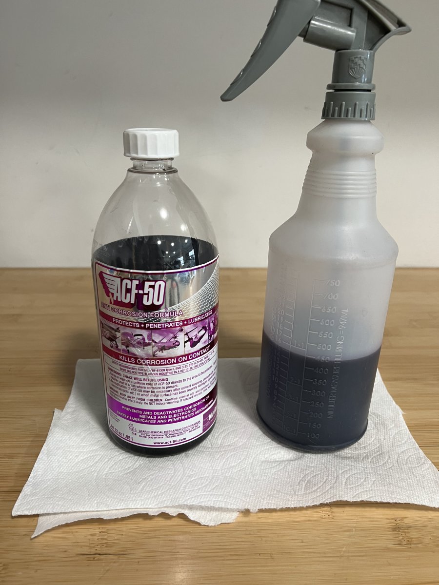

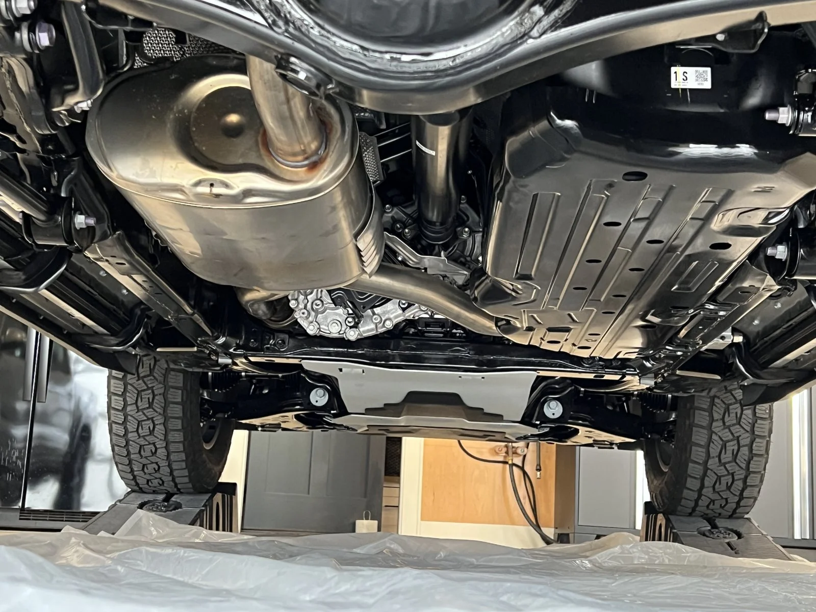

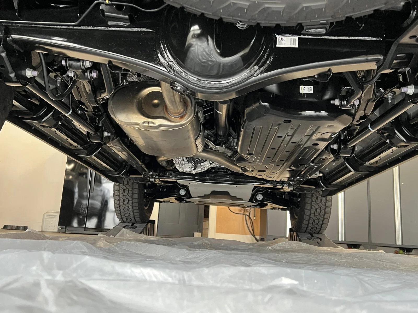

Have a feeling we’re in for a biblical winter. Toyota not being known for great rust protection I decided to stack the deck.

Cool, how'd you choose that product instead of say Fluid Film, Wool Wax or something else? I don't think I've seen ACF-50 before.
PS -- cause I couldn't find anyone who'd apply anything else I ended up doing Krown on my 4Runner. Was a very mild winter with not much exposure to road salt, but in any case the underside still looks good a year later. Want to get a second treatment but the nearest location is like 90 min from me and they're pretty booked up too...
Pilot friend recommended who’s had experience with it on aircraft. It’s also popular on a RAM truck forum I’m on. Goes on easy and lasts 2-3 seasons. Won’t harm electrical connections etc. and acts as a lubricant.

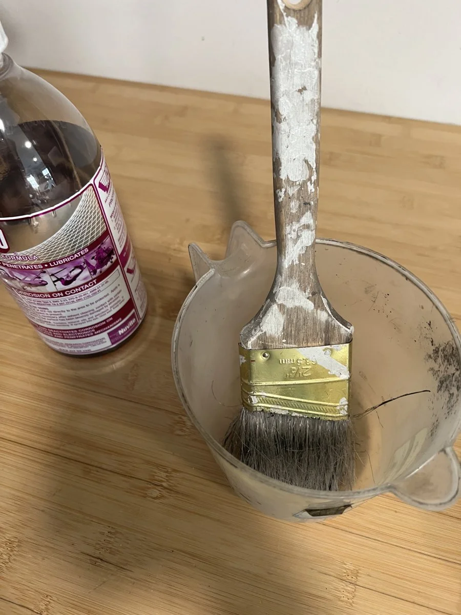

Is the product sprayed on with the mister bottle and does it require mixing? Is second photo after application? Looks great if so.
Yes, sprayed on then i use a 3” wide fine bristled paint brush to even and spread. A little goes a long way. Photos are post application.
