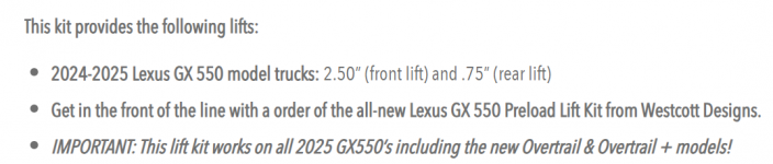

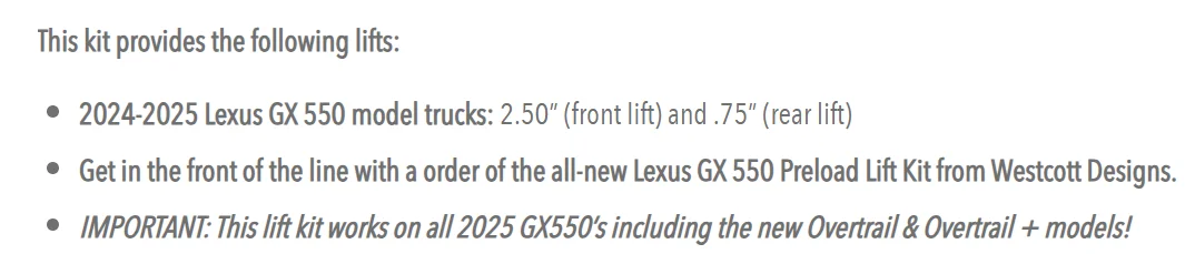

I was told the Wescott leveling kit would not affect the warranty because that is the kit Lexus uses.
Someone lied to you. I can guarantee that Lexus does not use Westcott leveling spacer.
And yes they can void certain warranty if the lift kit caused the problem. I can see lexus denying the whole suspension warranty due to modification

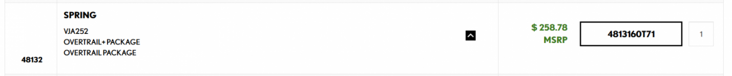

when you purchase springs on lexus online, does is come in pairs? like 2 fronts and 2 rears? or do we have to order 2x front and 2x rear.
If we have to order 2 of each, parts alone is 1k.
Hi, don't know the answer to that, but bet it is per spring. I'll see if I can get info when I take it in next week or so.
EDIT: I just went online to Lexus OEM parts seller, and they list the springs separately. If you get all four, the online price appears to be all in $1,032. I am not going to order them until I talk with the service department here to see if they will agree to install them. May have to order from them, which would add a bit more, since the online service says they are discounting them.

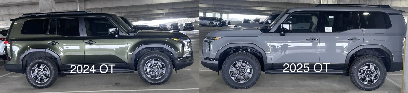

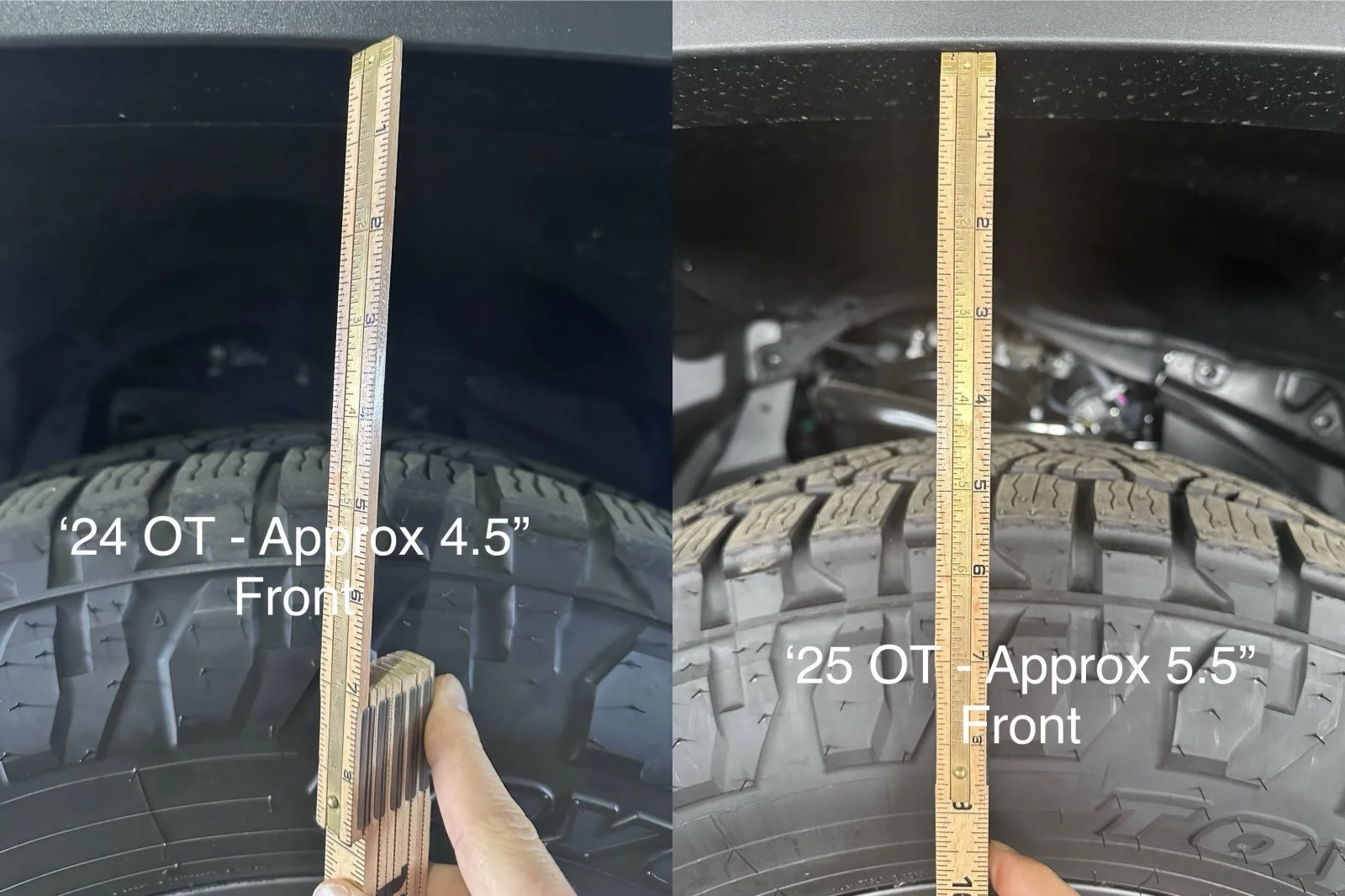

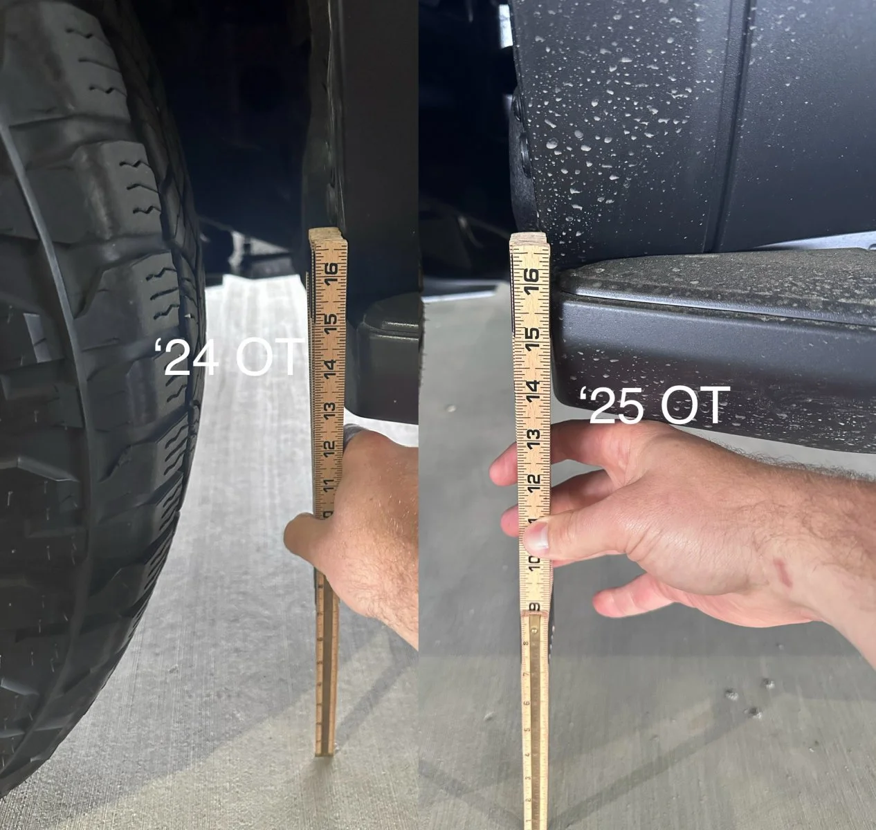

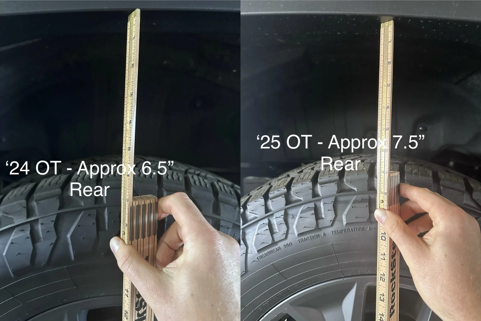

A few updates and thoughts on this topic, would love hear this group's inputs on these development and poke holes my thinking to keep me honest. Sorry for the wall of words.
I have read and heard elsewhere (this forum, reddit, etc.) that the 2024 and 2025 Overtrails have the same ground clearance and suspension components. Even when speaking to Westcott sales, he parroted this falsehood in saying their engineer found zero differences between the '24 & '25 OT's suspension components. He went as far as to say "it was a sales gimmick by Lexus calling out increased ground clearance for 2025 OT models as it was already present on 24 OT's". Further, the fact they are using the same kit for '24 & '25 OT's indicates they believe that both years have the same suspension components.
Skeptical that a reputable outfit like Westcott would be wrong about this, I went to a Lexus dealership so I could compare '24 vs '25 OT clearances in person. Photos are attached and I apologize for any parallax error. Hopefully folks can see the difference between the two:
In summary: '25 OT's do indeed have a +1" lift compared to '24 OT's
I still believe that the spring coils are the only suspension component difference between '24 & '25 OT's. I've had this corroborated by the multiple Lexus parts departments willing to go down that rabbit hole with me. In speaking to Westcott, they said that installing their kit on a '25 OT would still yield the full +2.5" in the front.
If true, installing Wescott's Preload kit to a '25 OT means you would get 3.5" lift over a stock '24 OT height. As stated previously, '25 OT's have the exact same suspension components as '24 OT's except for the coils. In that case, you're essentially lifting a '24 OT +3.5" in the front. I wonder if this start's to become a concern for your UCA's, CV axles, etc.?

  • I'm fairly certain my '24 OT does not have rear coils "48231-60Q00" because my height measurements are identical to the '24 I cited in the attached pictures
