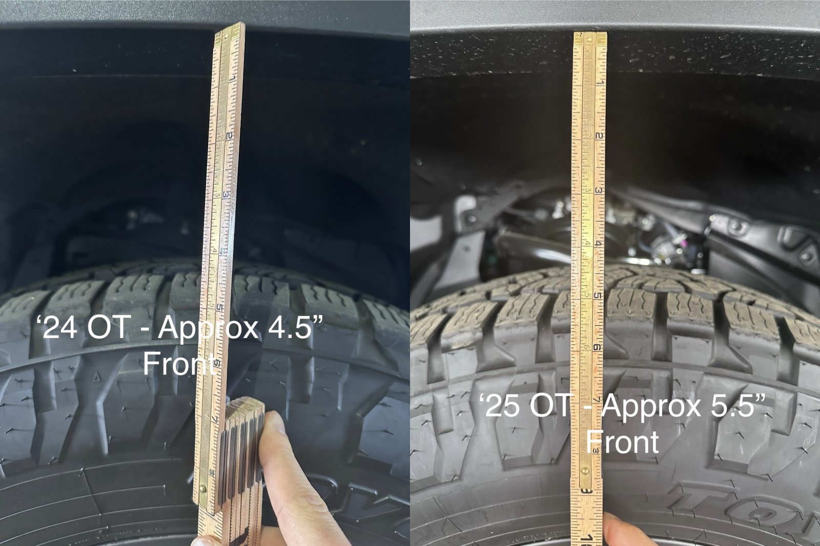

I have read and heard elsewhere (this forum, reddit, etc.) that the 2024 and 2025 Overtrails have the same ground clearance and suspension components. Even when speaking to Westcott sales, he parroted this falsehood in saying their engineer found zero differences between the '24 & '25 OT's suspension components. He went as far as to say "it was a sales gimmick by Lexus calling out increased ground clearance for 2025 OT models as it was already present on 24 OT's". Further, the fact they are using the same kit for '24 & '25 OT's indicates they believe that both years have the same suspension components.

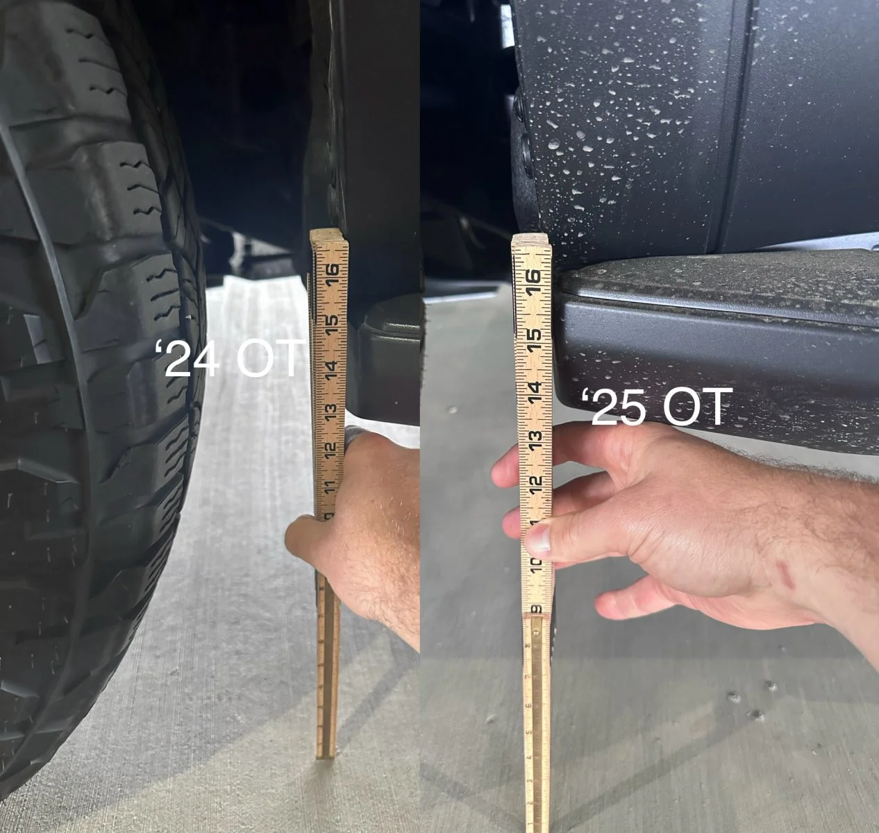

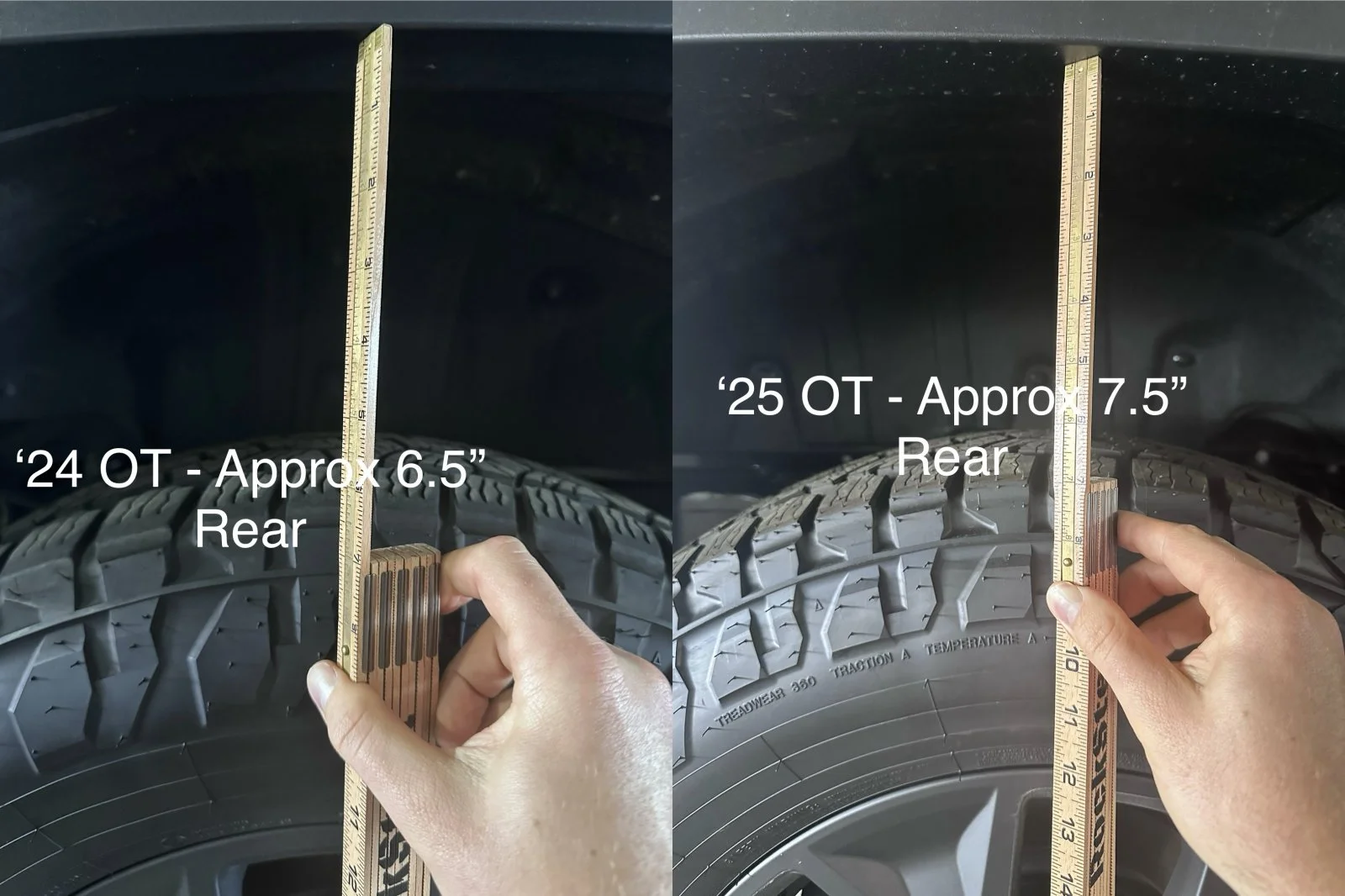

Skeptical that a reputable outfit like Westcott would be wrong about this, I went to a Lexus dealership so I could compare '24 vs '25 OT clearances in person. Photos are attached and I apologize for any parallax error. Hopefully folks can see the difference between the two:
In summary: '25 OT's do indeed have a +1" lift compared to '24 OT's
I still believe that the spring coils are the only suspension component difference between '24 & '25 OT's. I've had this corroborated by the multiple Lexus parts departments willing to go down that rabbit hole with me. In speaking to Westcott, they said that installing their kit on a '25 OT would still yield the full +2.5" in the front.
If true, installing Wescott's Preload kit to a '25 OT means you would get 3.5" lift over a stock '24 OT height. As stated previously, '25 OT's have the exact same suspension components as '24 OT's except for the coils. In that case, you're essentially lifting a '24 OT +3.5" in the front. I wonder if this start's to become a concern for your UCA's, CV axles, etc.?

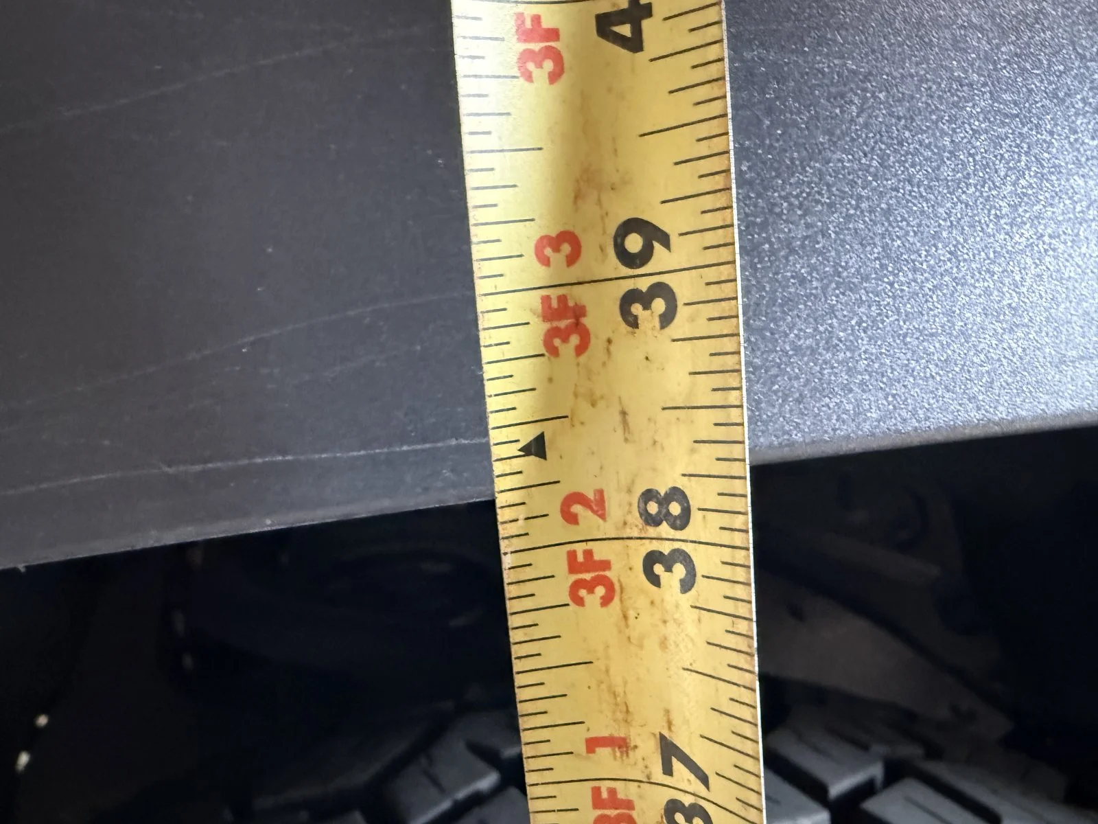

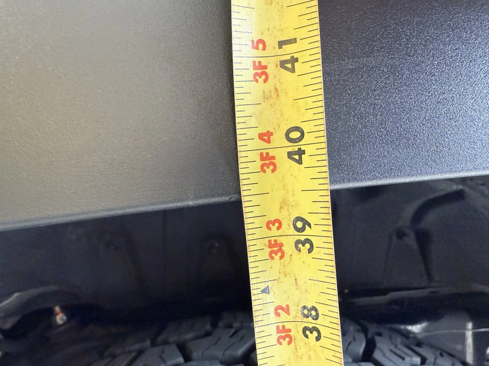

Here are my current ground-to-bottom-of-wheel-arch measurements through the center of the front & rear wheels.
Westcott pre-load collar lift is about 9 months old and tires are 35x12.5x17 same age.
Measured with the tip of the tape measure on the level garage floor, running vertically up over the center of the wheel center cap, to the bottom of the wheel arch. I made sure the camera lens was parallel with the bottom of the wheel arch.
Current measurements are:
38.25" front
39.5" rear
difference (forward rake) of 1.25".
The same measurements collected immediately after the lift in July 2024 were:
38.75" front
39.875 (39 & 7/8") rear
difference (forward rake) of 1.125" (1 & 1/8")

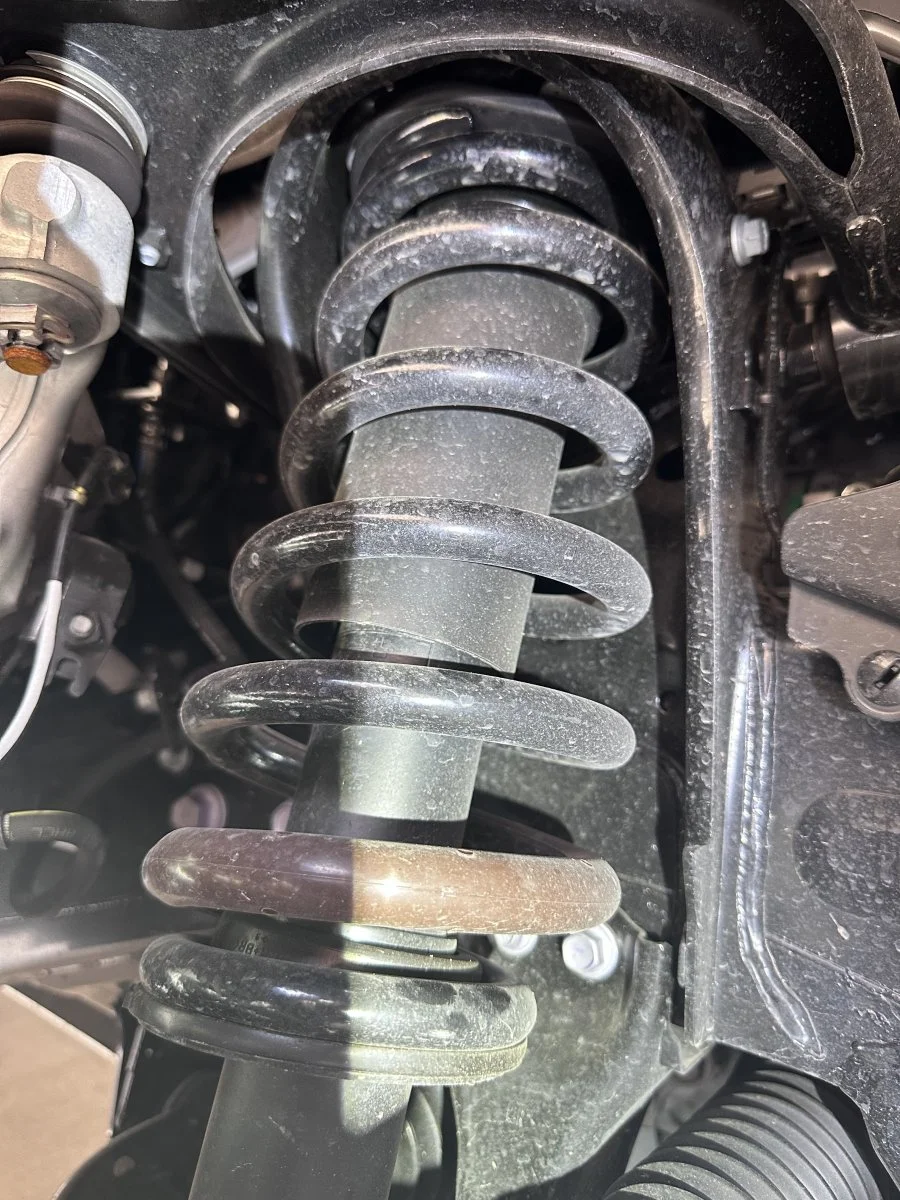

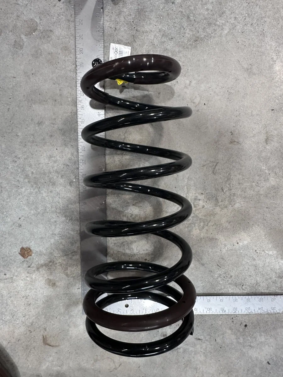

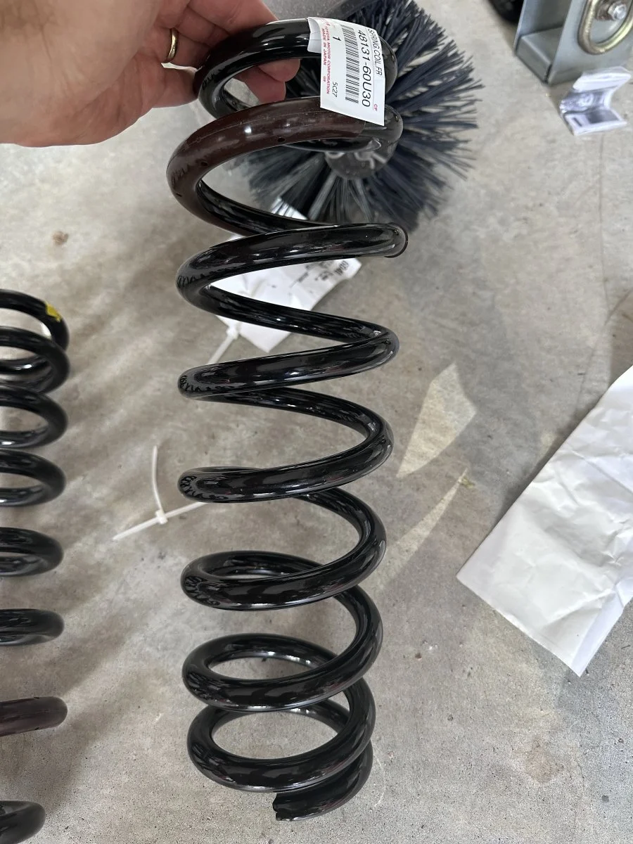

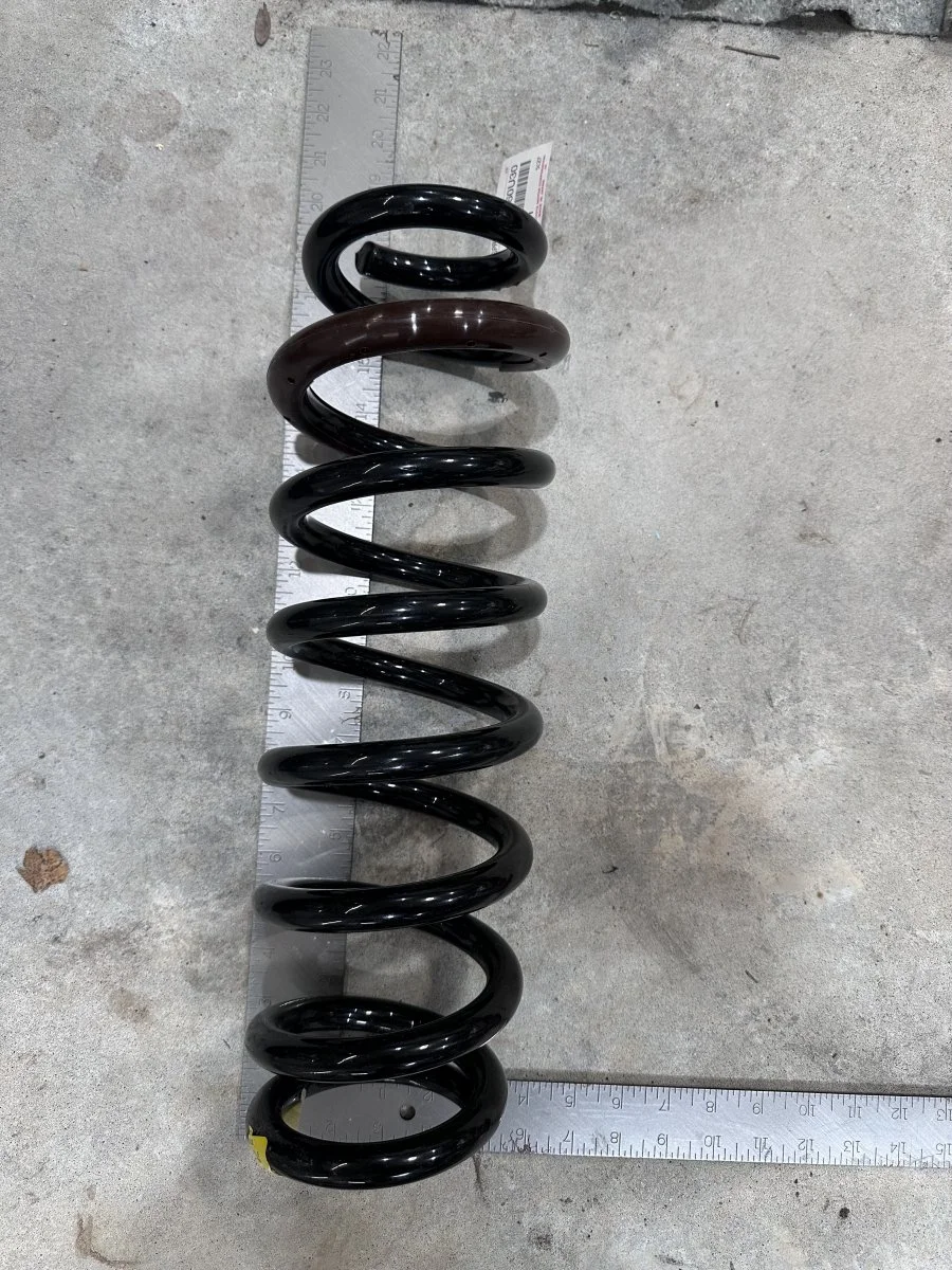

Got all 4 springs in, but haven’t installed them yet.
Specificity on the fronts, I counted the coil rings on my ‘24 (8 including the seat flat at the top) to compare to the new ones (9 including the seat flat at the top). +1 turn difference looks promising I think? but won’t know for sure until installed.
Rears seem to have the same number of turns but different markings and plastic cover locations.
Thanks, I look forward to how the install goes. Could it be that the only difference between 24/25 are the front springs?
Could you post the part numbers on them that actually showed up?
