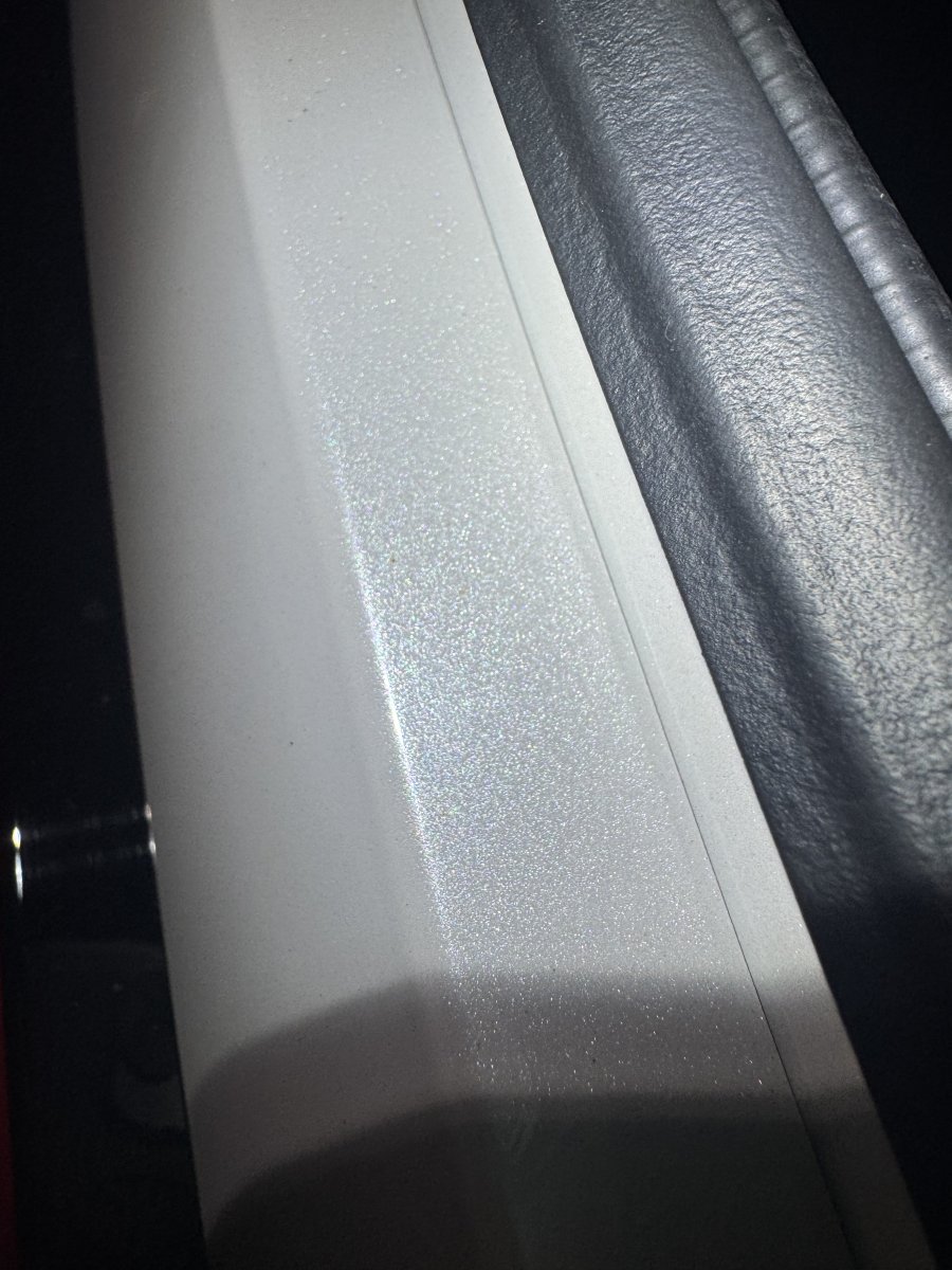

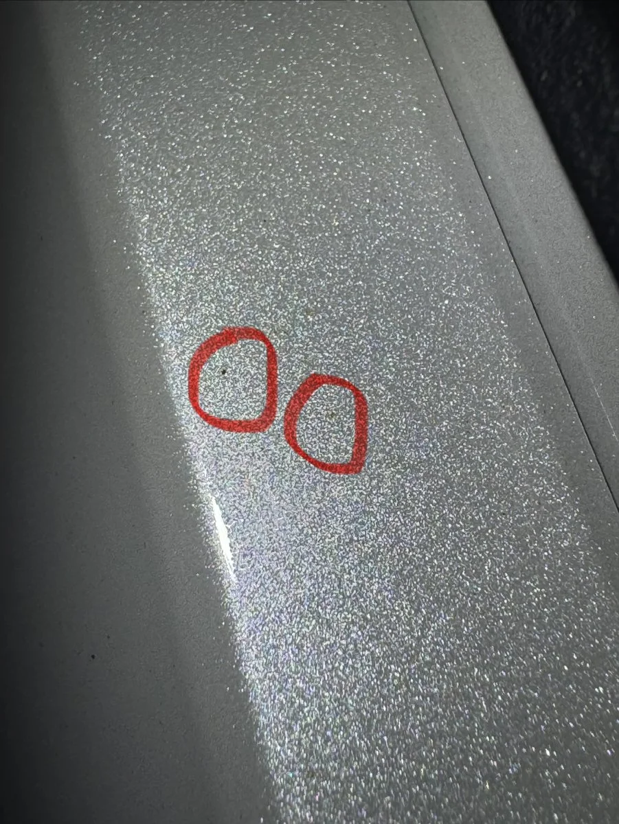

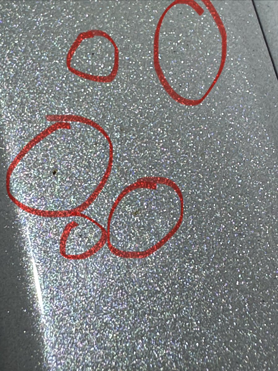

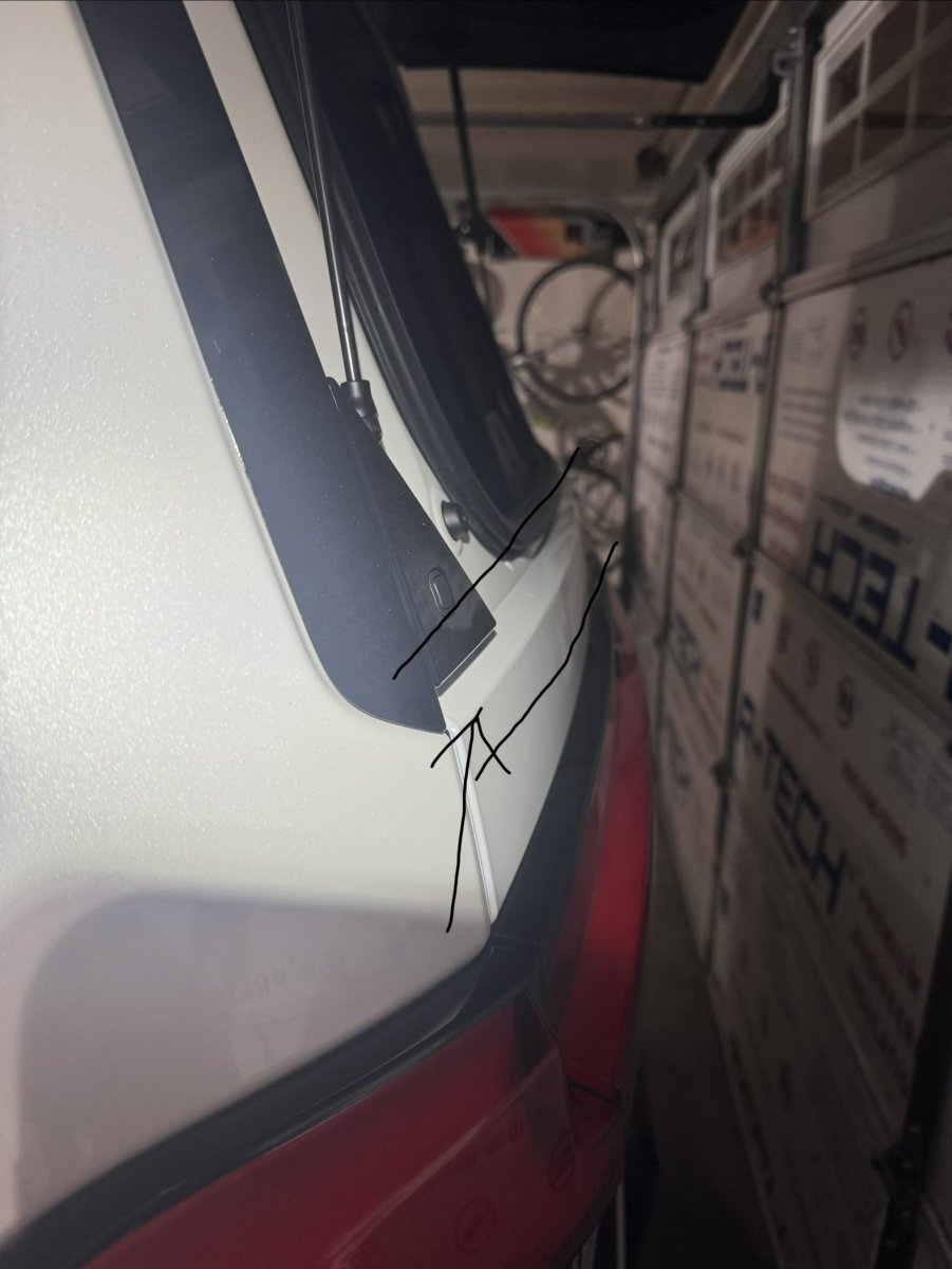

Maybe I’m being too picky or over the top noticing things like this but discovered a new “2026 accessory” when giving my ride its first wash the other day… pitted little rust spots 🥲 will be interesting to see if these little minions grow over time, don’t know if it helps or not but had the painted parts ceramic coated a few weeks after buying (maybe they coated this part maybe not who knows or if it even matters). All along bottom ledge below the rear hatch window, y’all think I should address this somehow or just keep an eye on it?

can you feel with your finger nail if the paint chipped off? It might be just iron contamination that has embedded on the clear coat that can be easily removed with an iron decontamination spray or clay bar.

Running my nail over it I can feel/hear the click of passing over it & it also doesn’t come off if I go back & forth over it. I dont think it got ceramic coated when I had that done as it doesn't have that super smooth feel to it, if they grow I’ll see if I can get just that section repainted under warranty.

Does it feel like it’s on top of the clear coat or does it feel like the paint came off and rust is forming underneath the paint? If it feels like it’s sitting higher than the paint then I think an iron remover spray can easily fix that. Here are some better explanations of what may be going on to your paint.

Thanks for the video links! I definitely feels like it sitting above the clear coat not actually rusted through paint down to metal so I think it's fine... I'm going to look into removal options
