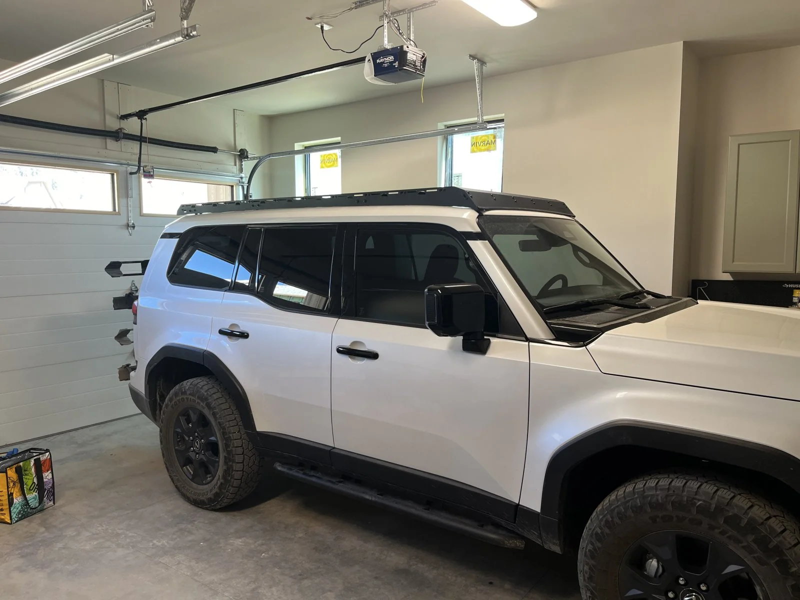

I have the Westcott Roof Rack as well and I agree with everything Bill said above. I have a moon roof so initially we left off two cross bars and there was some play. I added one of the cross bars that we left off and it tightened it up. I'm very happy with it and it replaced the OEM RR which has a totally different look and sits much higher.

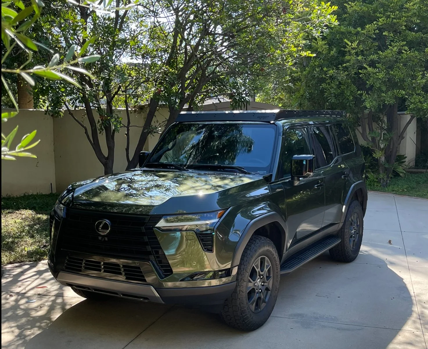

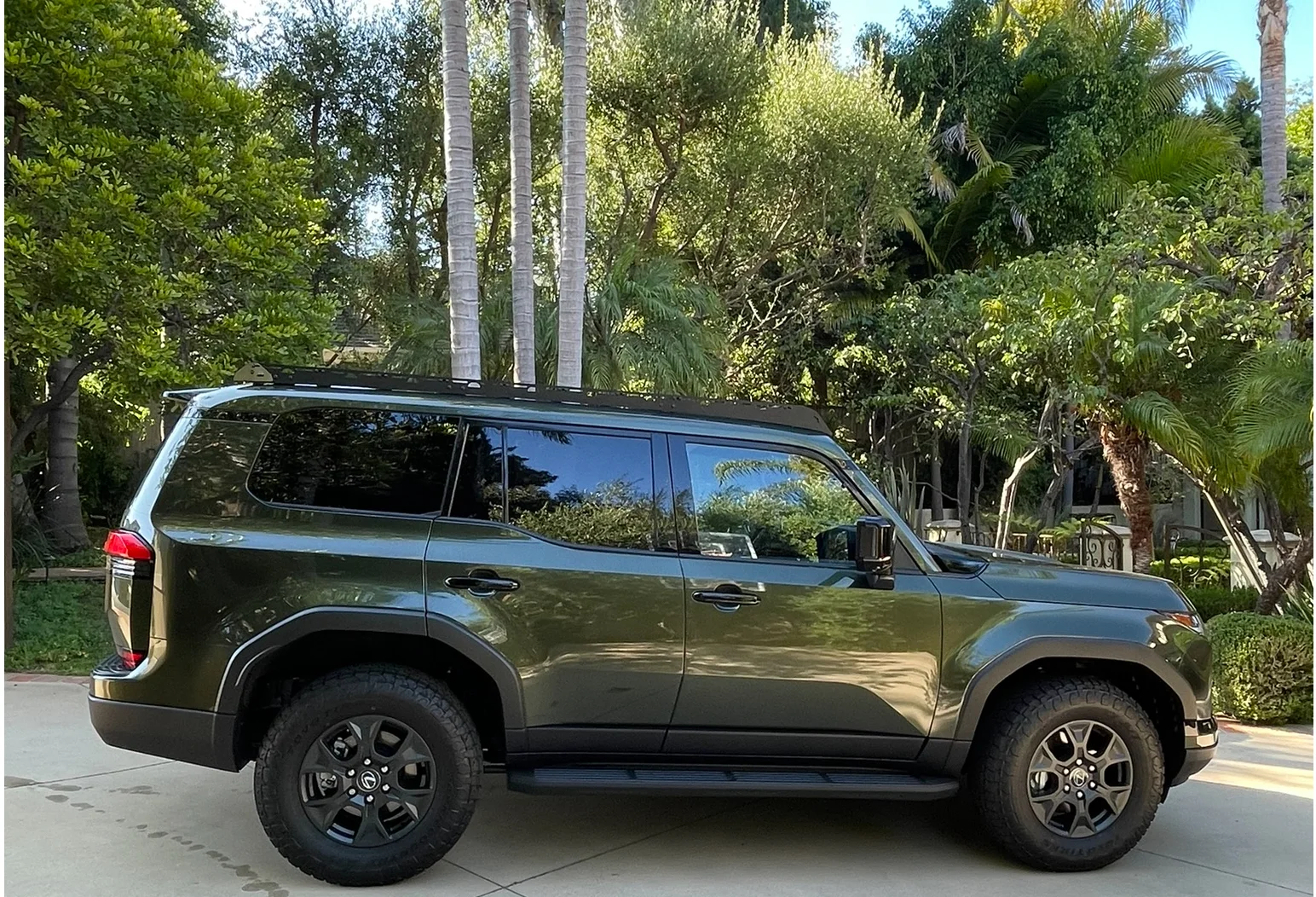

I originally had the Lexus crossbars on my OT+. Way too much wind noise. I removed them and only had the OT roof rails running front to back. Then I installed the Westcott full rack. This is quieter than the roof rails! I am very pleased with the aesthetic, the weight, the value and most of all the noise!

Thank you for your valuable feedback! and pics worth more than 1000 words!

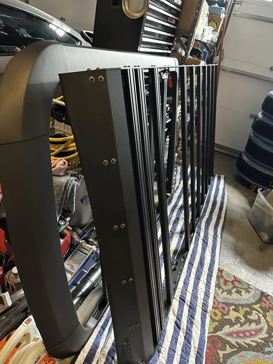

The Westcott is the lowest profile which means less wind noise. It was one of the first to market and many have it reporting no noise.
Prinsu is about 2” taller and basically the same design with the few detailed differences described above (drop in t rails, side pieces are reenforced)… that don’t warrant the price difference to me.
The Sherpa looks structurally the same as the Prinsu, however it mounts using the cross bars vs the side frames. I’m not sure if that’s the strongest design.
I do like the sherpas “booting” systems for keeping water out.
It’s also the gaudiest design competitive with the victory4x4 from my view.
I think the Westcott is the superior design and best price. I’ve got mine assembled and will install in a few weeks.
I’ve made a few tweaks (pics to follow) preparing for install as I wait for roof PPF.
I used brass washers for the crossbars mount bolts- (the brass will contrast and patina and look sharp against the earth paint).
I also ordered a box of epdm rubber 1/8 washers to sandwich between roof spacers and mounts to seal it.
You should use silicone in any circumstance for added water penetration security. My 17 Taco was victim of the roof tail light leak and rusted all my tools behind the seat and molded the truck a bit. Still stinks. Pissed.

That's going to look really cool with the brass washers on the Earth color. On my rack I removed the two stainless steel rear accent pieces with the bottle openers and painted them black and clear coated them and then reinstalled. I tried to use the bottle openers this past weekend but you can't get a bottle in there because the truck body sticks out too far under the rack. Bummer.

I really like the brass washer idea!!

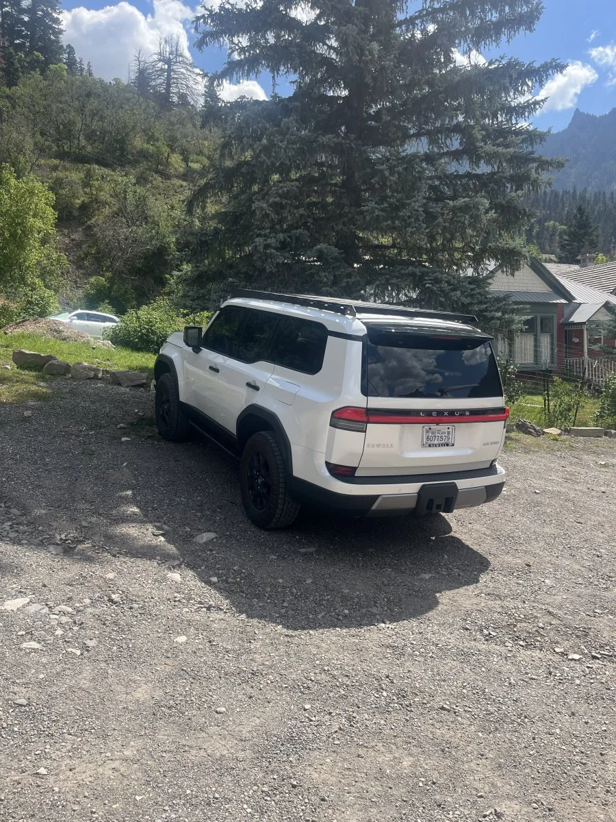

I looked at all the racks and chose Westcott. Light weight, easy to assemble( they have a you tube video),low profile ( almost no noise), left out the 2nd bar and almost unobstructed moon roof and it look better in person than in photos! To boot if you are a first responder or military, you get $100 off so $1095 including $200 shipping!
Looks really good 👍🏻
