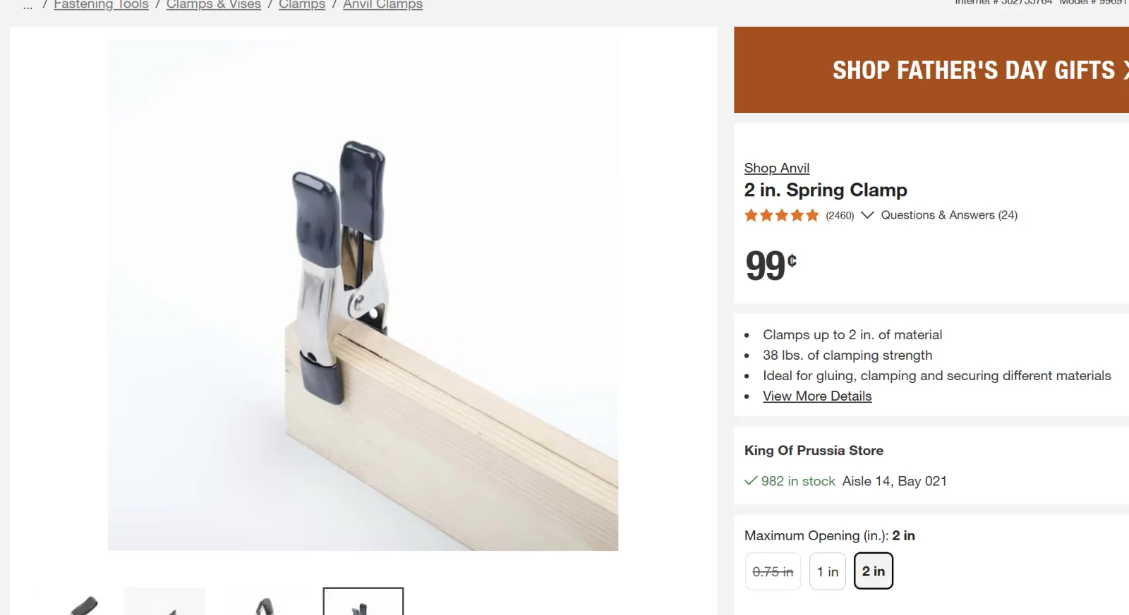

But you're right. It's a single-purpose tool to avoid me having to buy another length of arbitrary diameter hose that will also inevitably be single-purpose. I'm hoping it'll help avoid me fussing over getting an oily hose connected & disconnected, because I've done enough swearing at hoses when flushing brakes, ATF and power steering fluid. I can feel the early onset arthritis coming.
During the first few oil changes the hose kept slipping off the funnel tip right as I unscrewed the filter.
Mildly annoying when the entire built-in funnel ("oil filter receiver") is designed to catch the oil drippings, but the very opposite occurs at the precise moment the filter is pulled away and my two hands are otherwise busy with the filter.
However I can't complain much because the built-in funnel is a very nice feature.
A $1 spring clamp from Home Depot solved the problem, it's strong enough to hold the hose to the funnel but not so much force as to crush the funnel tip.

Agree. Also use a $1 clamp to hold the hose to the funnel -- see upthread -- and you won't spill even a drop.
