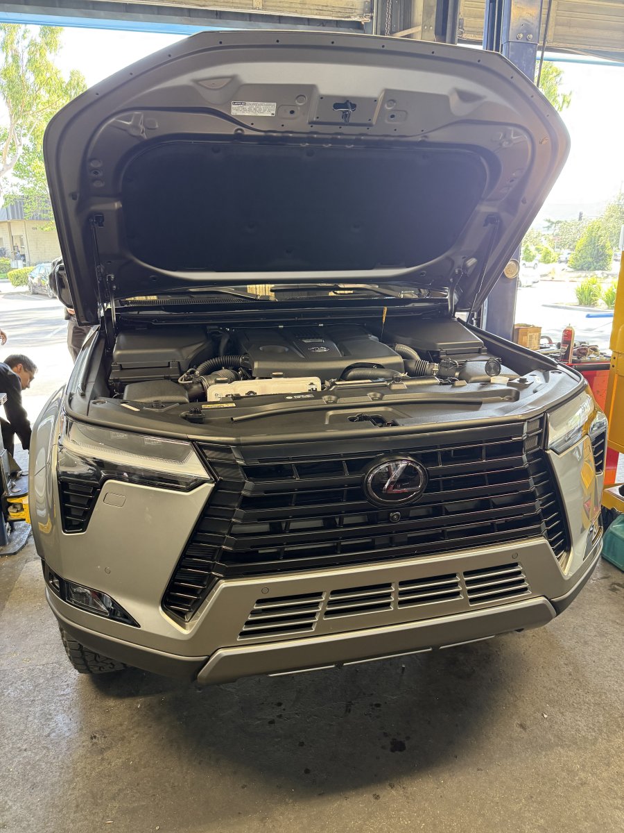

Initially I drank the koolaide and actually took my car to a local shop with an OEM filter, crush washer and two gallons of 0W20..
As I watched the light amber oil flowing out .. my first thought was damn that looks really clear.. in fact damn!! … “it looks like BRAND new oil”.. and then I said to myself, “well duh.. The car has 386 miles on it of course it is BRAND new oil.”

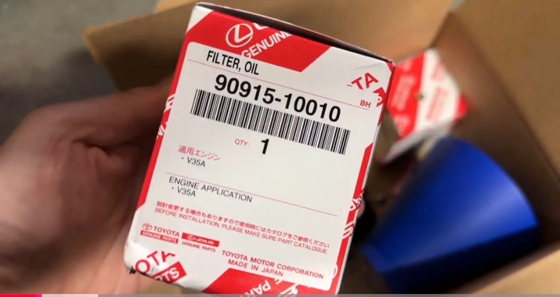

Also, I found out that if you order the oil filter and crush Washer from any local Toyota dealership, but do so online it’s only like $6.50 plus $1.50 for the crush Washer.. NAPA currently has 0W 20 mobile one extended life full synthetic oil for $35 for a gallon. Keep in mind when you’re changing the oil on this car you need a 5/8 plastic tube to attach to the tiny black plastic catch basin under the oil filter. The purpose of the tube is to route any oil that comes off the filter away from the member below it that sometimes we will catch oil and then drip from the sides. The fellow that did my oil learn this after he didn’t use the tube as I had instructed.
The filter is Toyota part 90915-YZZN3 Aka 90915-10010
90430-12031 - crush washer - $1.98

Not that it matters but out of curiosity where did you find the original filter made in Japan?
To get the OEM Japanese filter for the GX 550 simply go to Genuine Toyota Parts and Accessories: Official Online Store Toyota San Luis Obispo - and navigate to the closest Toyota dealer near you - which you can get to on through this link. The filter is only $6.57 .. and just click in store pick up and there is no shipping fee. (Interestingly the walk up counter price was almost twice as much! … so well worth ordering via their on line portal.
I take that back - I’m not certain mine was Japan sourced.. it may have been made in Thailand as the part number was 90915-YZZN3…. the picture I posted was a frame from an online video I was watching .. sorry for the confusion..

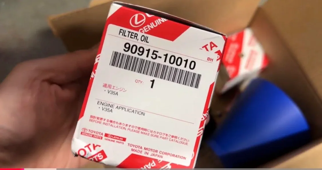

I found a dozen of the Japan made filters last year on eBay, before these were depleted, and bought a dozen of them. I think they cost me about $8/filter, but I was happy to pay that for Japan made filters over the Thailand stock.
