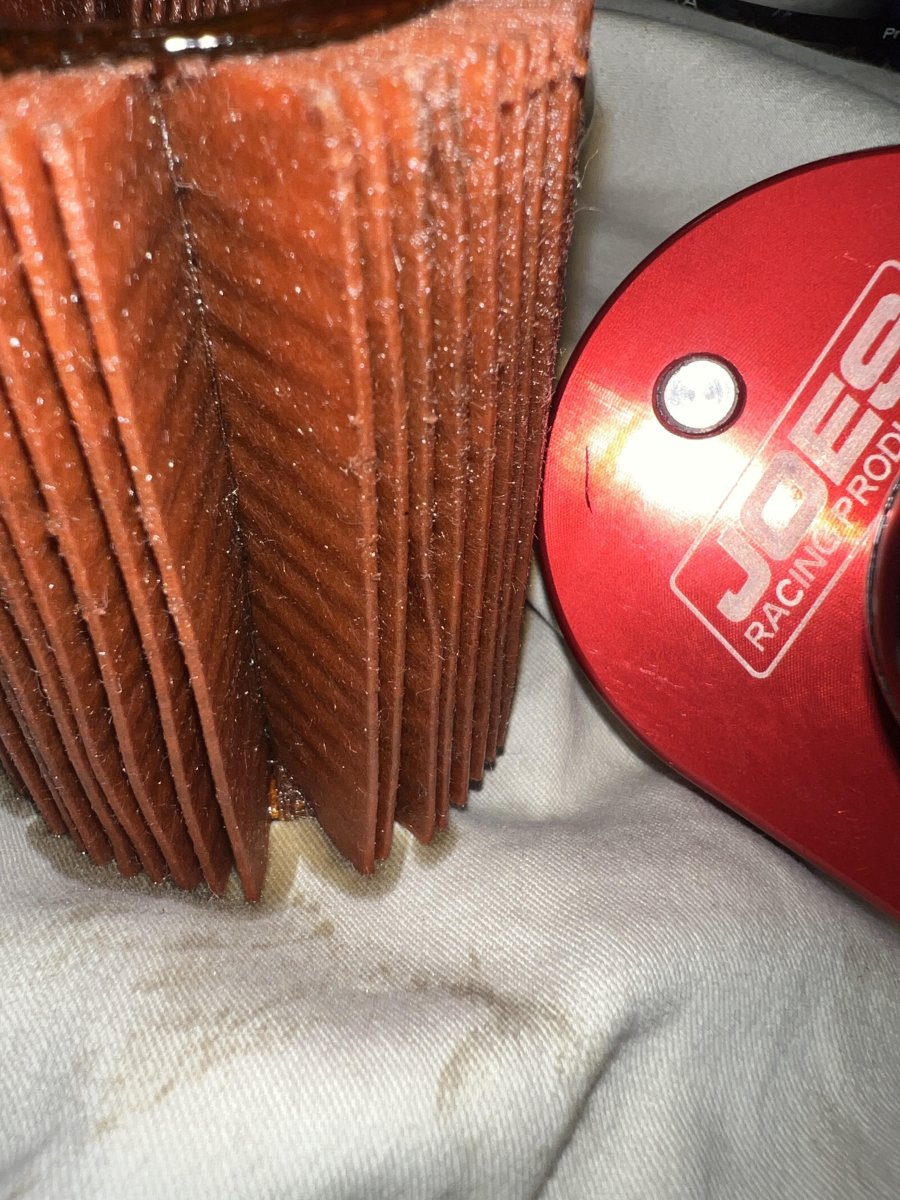

Follow up. Cut open the OEM filter after 1000 miles. Not great but not all that unexpected. A bit of break in glitter but not excessive. I hope it
improves at 5K. Will ask the dealer for the filter if they change it at 5K. I used a Joes Racing filter cutter so it typically does not produce metal shavings in the cutting process.
