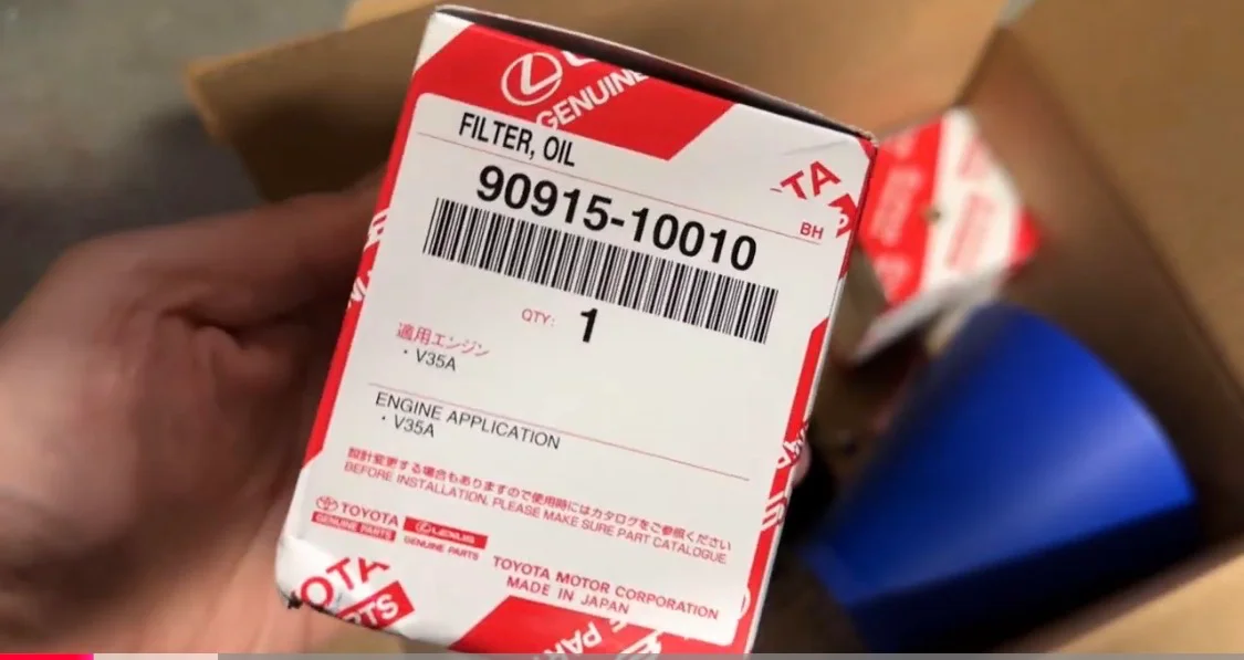

Also, I found out that if you order the oil filter and crush Washer from any local Toyota dealership, but do so online it’s only like $6.50 plus $1.50 for the crush Washer.. NAPA currently has 0W 20 mobile one extended life full synthetic oil for $35 for a gallon. Keep in mind when you’re changing the oil on this car you need a 5/8 plastic tube to attach to the tiny black plastic catch basin under the oil filter. The purpose of the tube is to route any oil that comes off the filter away from the member below it that sometimes we will catch oil and then drip from the sides. The fellow that did my oil learn this after he didn’t use the tube as I had instructed.
The filter is Toyota part 90915-YZZN3 Aka 90915-10010
90430-12031 - crush washer - $1.98
