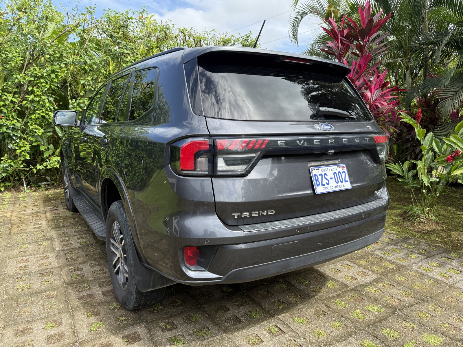

In the meantime, I’m testing out the suspension on my 4X4 Ford Mt. Everest here in La Fortuna, Costa Rica.

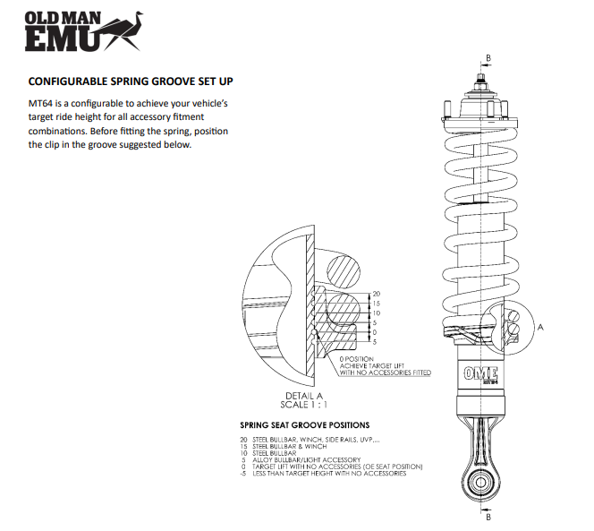

There were not any fitting instructions in my coilover boxes, the rears had instructions. I reached out to ARB and they gave me this generic sheet.
They also said the 250/GX550 coilovers are set up for maximum height from the factory. So the clip is in the top position. I only wanted 1-2" of extra height from stock and they recommended moving the clip position down 3-4 grooves.

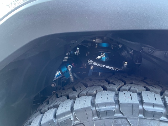

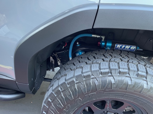

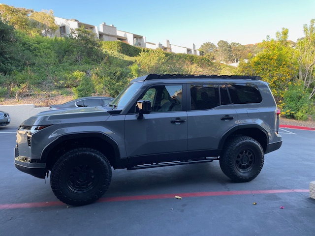

Well my decision was to go with the King Shocks in combination with the Built Rite Control Arms. I had them installed today at The Truck Shop here in San Diego. So far I love the ride and after the first 500 miles I get everything re-torqued. Once that's done I plan on trying a few trails If anyone is interested in my Westcott lift kit I will be selling my old shocks complete with the Pre-load collars installed front and back. They have about 3K miles on them. If anyone is interested send me a message.
I have been asked why I went with the Built Rite UCA's and here is my answer:
I wanted to go with the Total Chaos but got talked out of them by the salesperson at the Truck Shop. The Truck Shop has been working with Built Rite for over a year to come up with a better UCA. According to them it's better built (thicker and more maintainable ball joint) at a lower price point. It gives you more articulation and a better ride for non off-roading. They recommend it for all their lifts. They have a tremendous reputation here in San Diego. If your interested call and ask for Henry. I really liked working with them.
