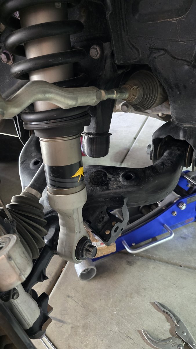

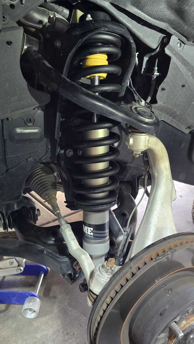

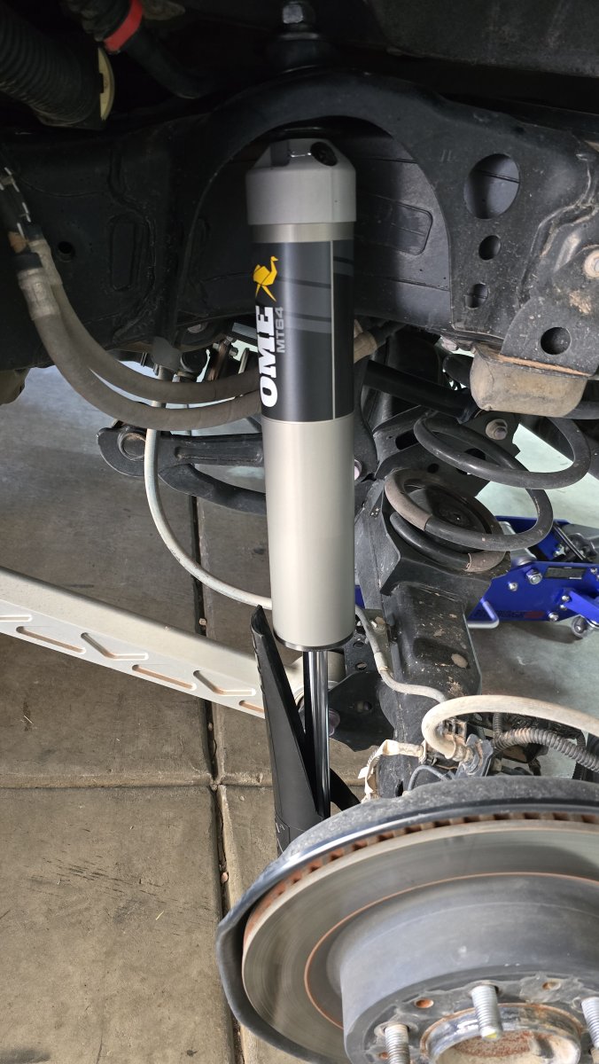

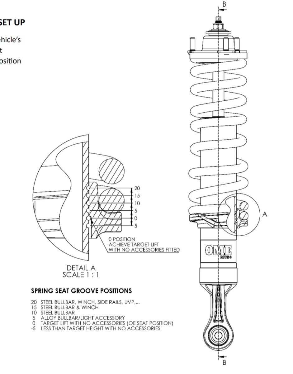

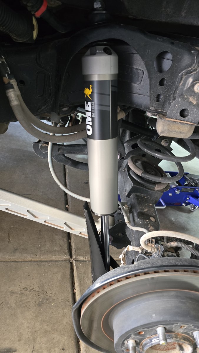

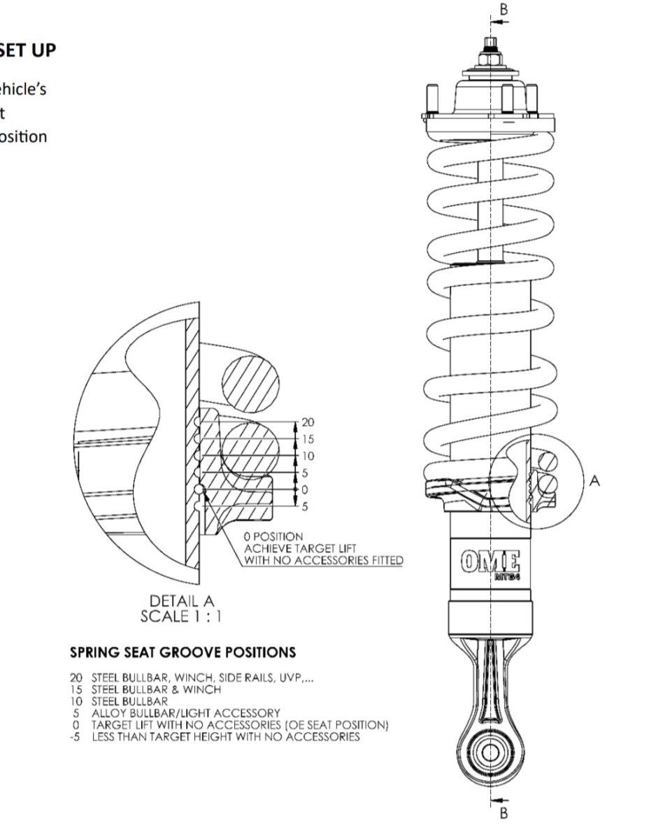

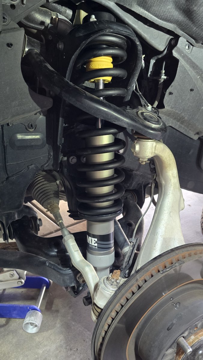

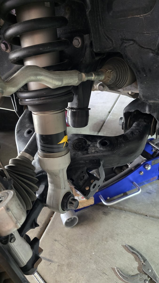

I installed the MT64 shocks. I only wanted 1.5-2" of ride height increase to make the front level with the back. The front shocks were set to the highest perch (20) from ARB.
ARB suggested moving down 3-4 spaces to get that height. I went down 4 (0) which provided no lift.
So I moved the driver side up 2 (10) and the passenger side up 3 (15) to correct the lean my GX had. This got me to where I wanted to be.

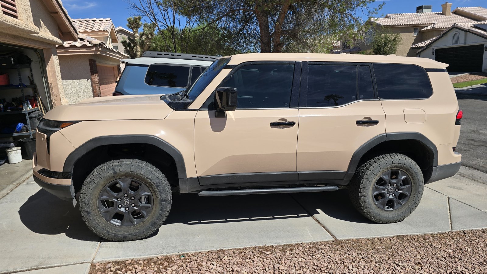

With the proper Toyo AT3 275\70r18 tires there is 12" of ground clearance measuring from the bottom of the front skid plate.
These shocks provided 2" additional droop travel and the ride is pretty good!
I also installed some Perry Parts bump stops.

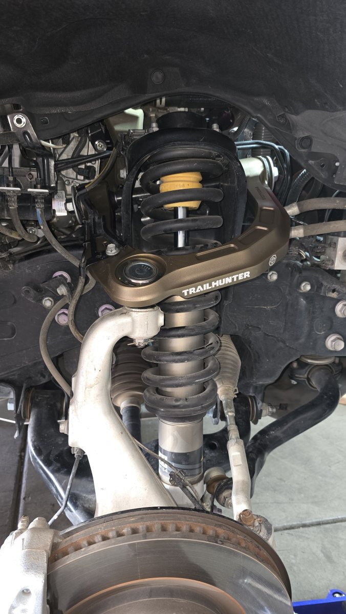

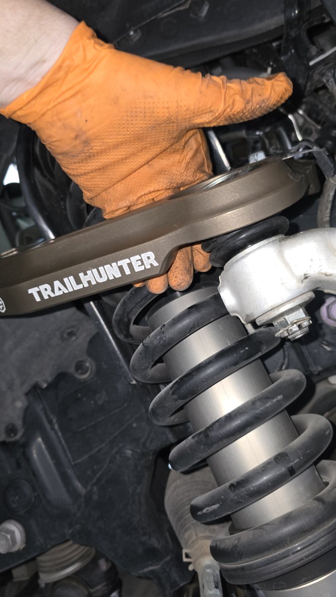

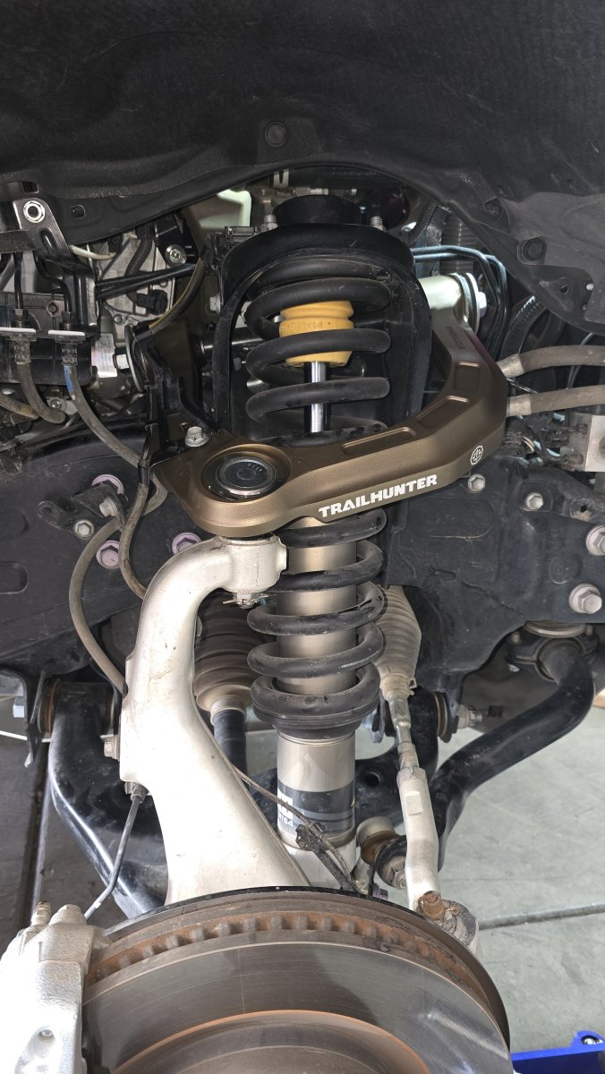

Did you change out your UCA’s? It looks good. Never saw Earth without a black top
Kept the OEM upper arms. On full droop the upper arms just kiss the springs.
Since I only raised it up a little, I'm sure it will align fine.

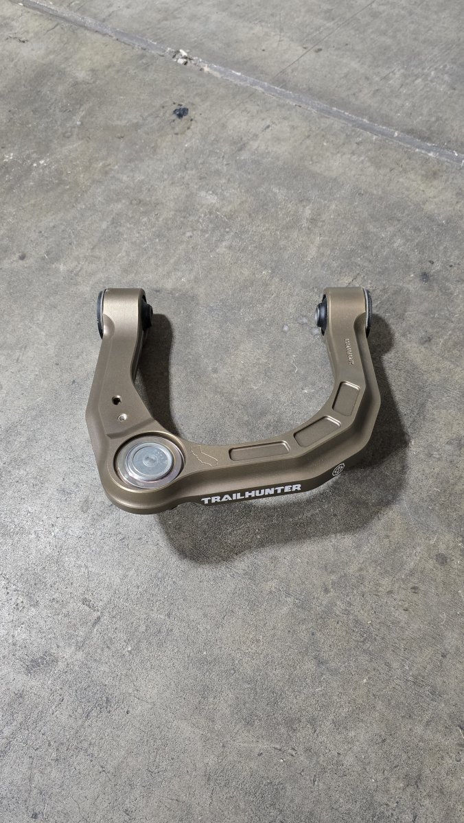

I'm hoping to get the TRD pro\trail hunter upper arms from the 4runner.
I hated that black roof, so I had the whole vehicle wrapped in the color sand storm.
I like what you did. It looks great. I got the Built Rite UCA’s The worked with The Truck Shop here in SanDiego. Gives more articulation and a nice ride on road
I also installed some Perry Parts bump stops.View attachment 13584

Which rear springs did you go with? TIA.
I think it’s almost a necessity to go with new UCA’s after a lift You get more articulation and more droop. The ride improves as well
