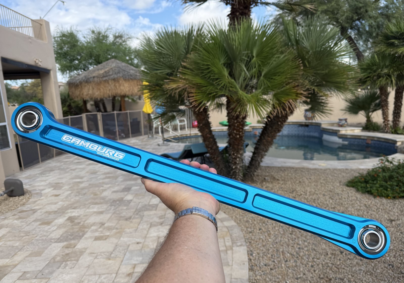

I had to abort my quest for the gold. The price isn't too bad from King ($330 per pair for a total of $660) but the wait would be a good 3+ months...which I've found probably means more like 4 or 5 months. The wait from Camburg for their gold would be an estimated 2 months. Also, the front springs from King would still be blue. I could have have the front springs removed, stripped, and powder coated but now we're getting a bit ridiculous (as if $660 for custom anodizing isn't ridiculous enough). King also black cerakotes the shock bodies for an additional $170 each. I suppose I could have them dipped in 24k gold too. Actually 14-18k would probably be more appropriate for this application.
So I went with blue.....which is actually my favorite color.

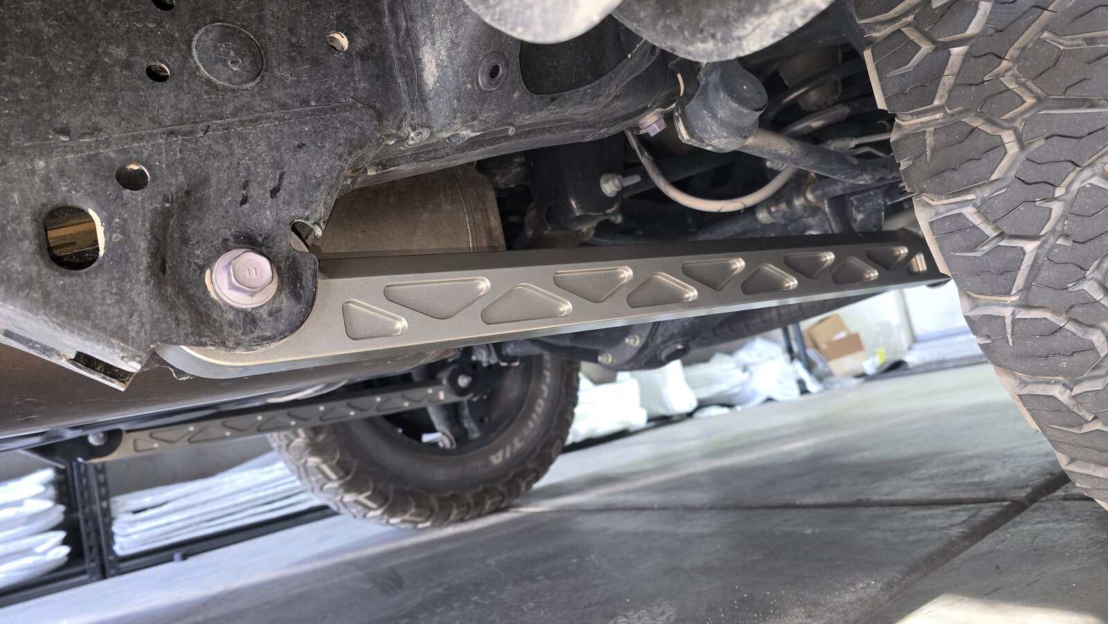

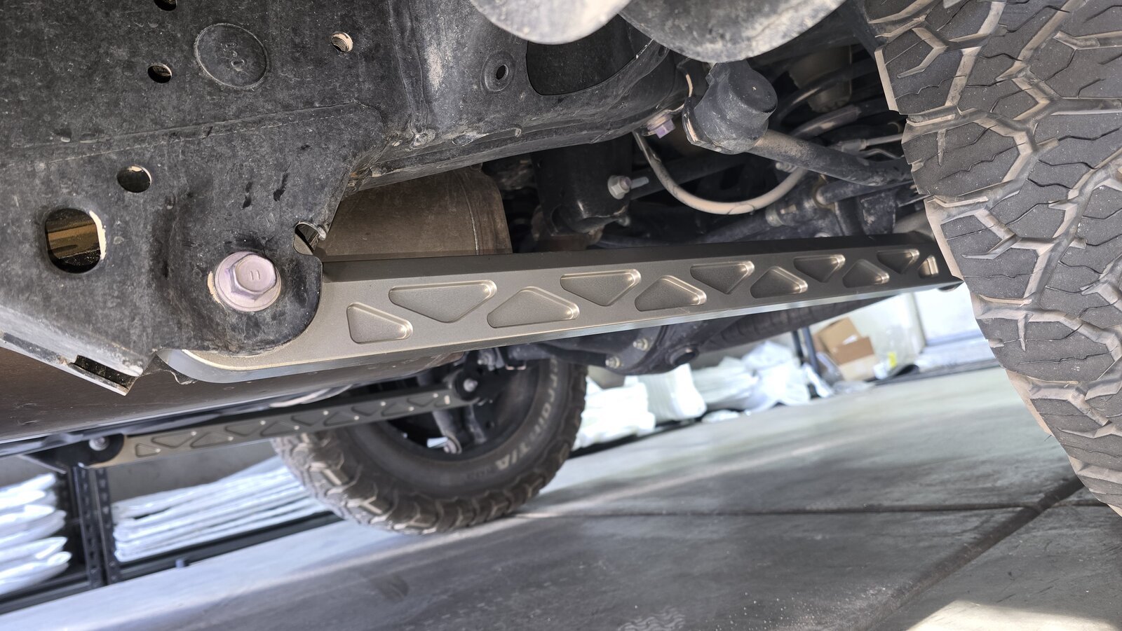

If you want billet arms and oem bushings look into superior engineering's arms for the 200 series. I guess they don't realize they fit the 250, 550, 300, 4runner and the Taco yet.
Before they started manufacturing those I made my own for my 200 series and found out they are the exact same size as the 250 series.

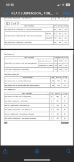

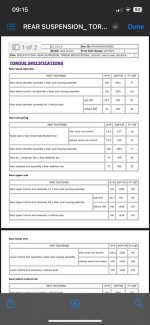

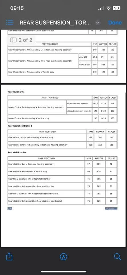

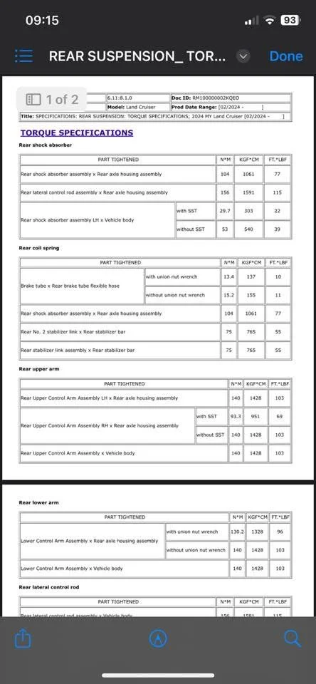

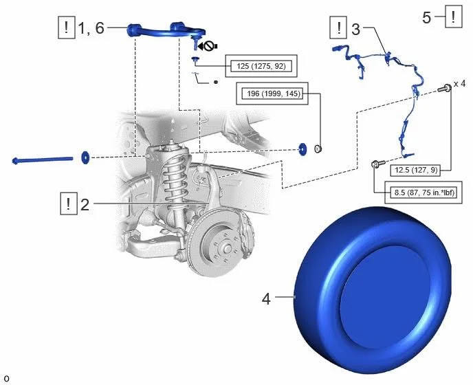

does anyone have the torque specs for the most of the front and rear bolts. ie rear control arms and UCAs

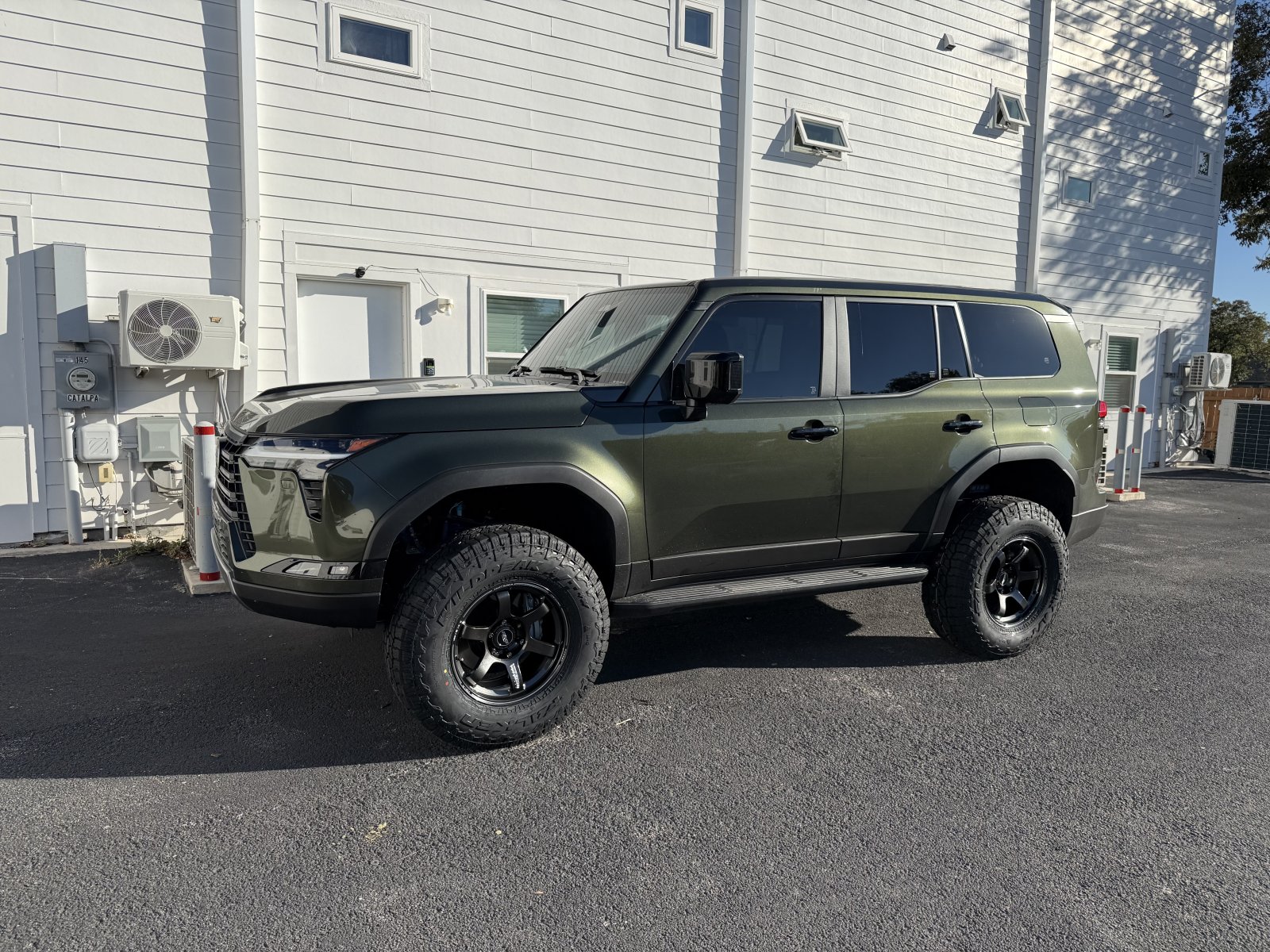

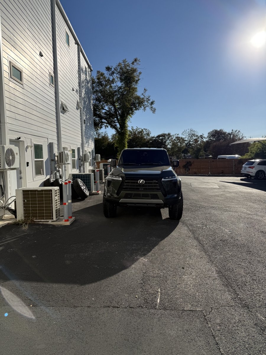

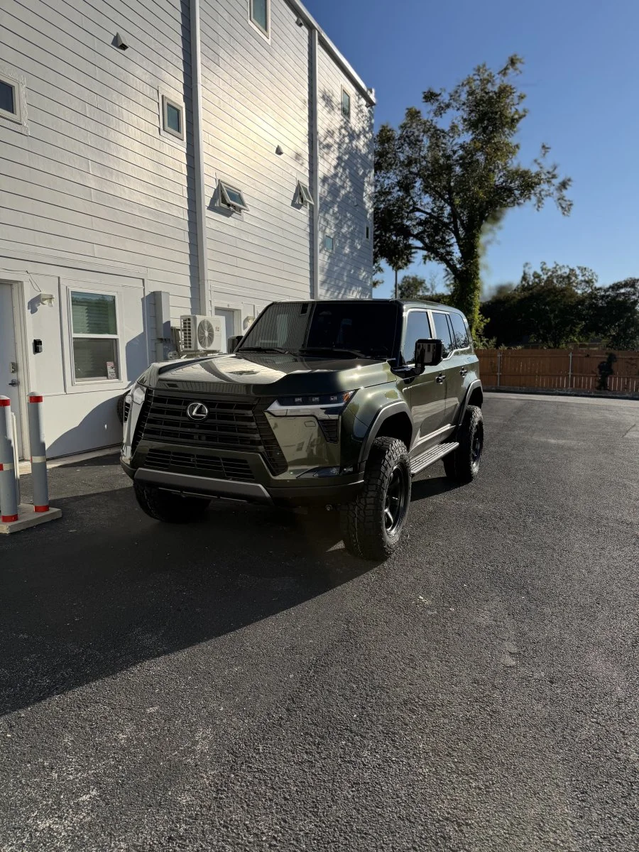

Got my Kings and Icon control arms(Front and Rear) installed this weekend torqued everything and drove it for 300 miles. (ive had my suspension for more than 6months in storage)
First impressions are they ride way better than my oem '25 OT shocks and springs.
Also first car to mod it before i hit 500 miles but well worth this mod.
Need to massage on 18x9 et0 but it rubs. Switching to a 18x8 et20 or 18x9 et15
