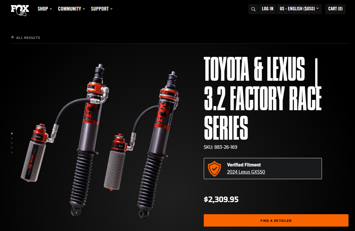

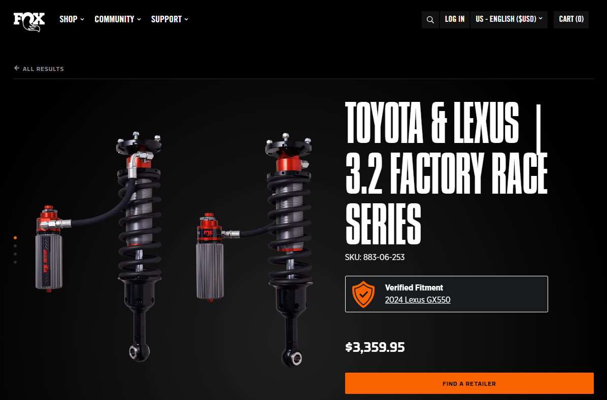

I don’t think I’ve seen Slee/ADS kit mentioned. Definitely on par with King/Fox’s top offerings.
Fox released their 2.5 and 3.2 series shocks. I wonder if their live valve version will make it's way to the platform, since they are making it for the Tacoma.
i like fox stuff one of my buddies works for BDS/FOX if i could i would probably gone that direction but King has great customer support, Peter Vu at king always gives me the best technical support and warranty issues settled so quickly im glad i went the direction i did. plus that blue in the wheel wells pops so nice
I'm real happy with my Kings and yes you want some color in the wheel well.
That Fox price tag is chunky…. I’m curious to see their front bracket on the overtrail
Fox claimed a live valve version may be available for the gx/250/4runner in the future. I'll wait for that.
