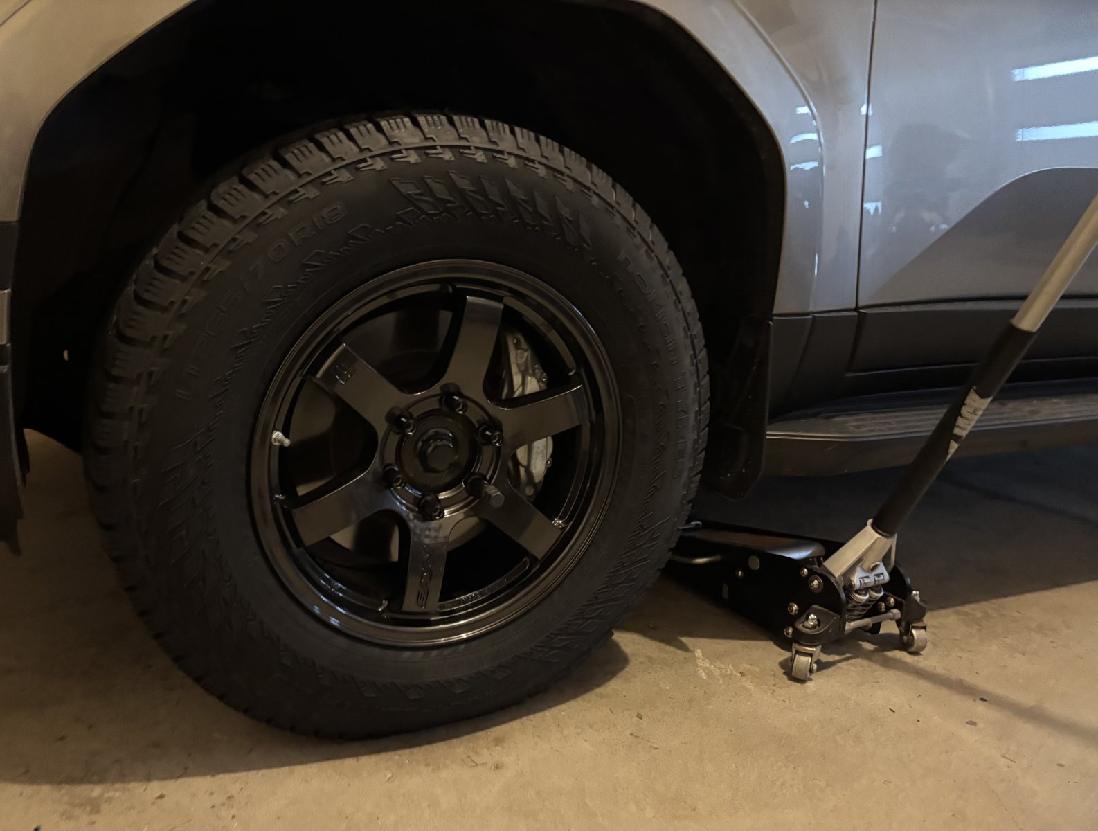

I just test fit a winter wheel to see how many turns I get on the stock bolts, about 6 fully torqued using Rays Formula lugs. I’m going to install the longer bolts when I do my switch over at the end of the month.
Gramlights 57DRX 18x8.5 +52, 265/70R18 Nokian Hakka LT3s.
I trust Nokians more in deeper snow and backroads vs other brands when we road trip to Quebec and the more Northern regions of Ontario. They’re probably overkill for GTA conditions.
Also I know they’re on the wrong side, just grabbed the first wheel from the pile 😀

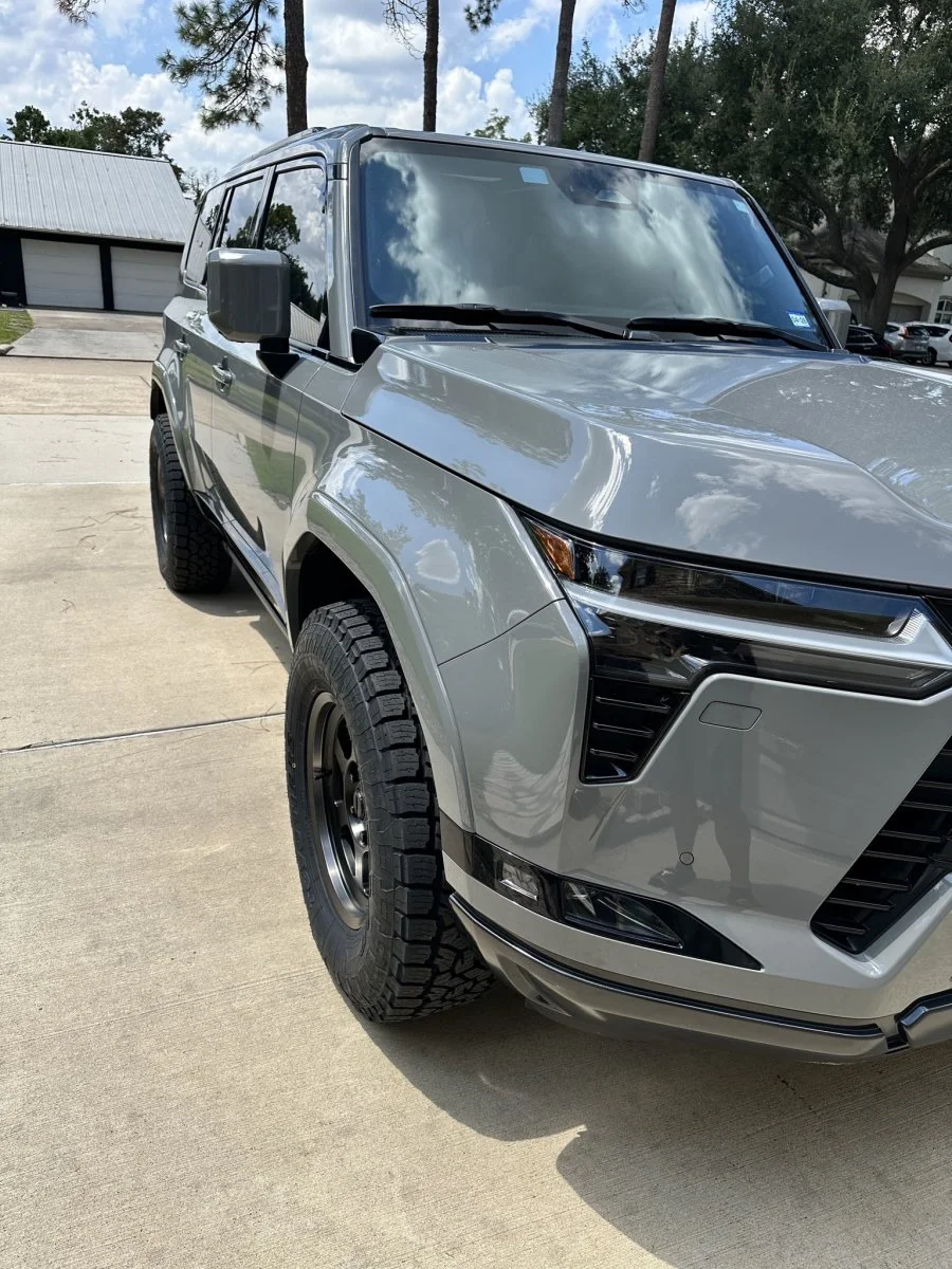

Fuel Rebel 6 Matte Bronze wheels 20 x 9 with 20 mm offset, wrapped with BFG AT KO2's in 275/60/20. No other modifications were necessary. Unbelievably happy with the Nori Green/Bronze combination.
LOVE your truck. Do you think the same wheels wrapped with BFG AT KO2's in 275/60/20 and 15 mm (as opposed to. your 20 mm) offset still fit? I am looking at the same tires but with Vossen (Introducing the Vossen HF6-1 Wheel) rims that have a 15 mm offset.
Much appreciated! The wheels and tires just got installed yesterday and this was the only shot I got before I dropped it off to get PPF installed to protect the paint from chips and scratches. I believe the offset and tire size only pushed the tires out about an inch and the fenders on the Overtrails have extra width due to the plastic fender flare. I’ll post some more pics from different angles after I get her back in a couple days!
