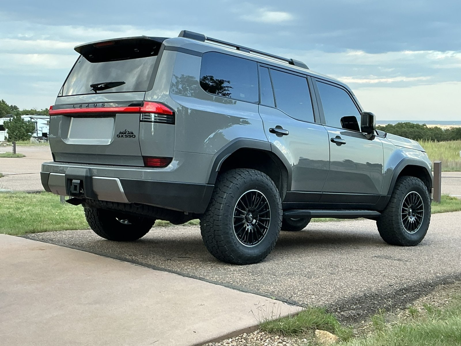

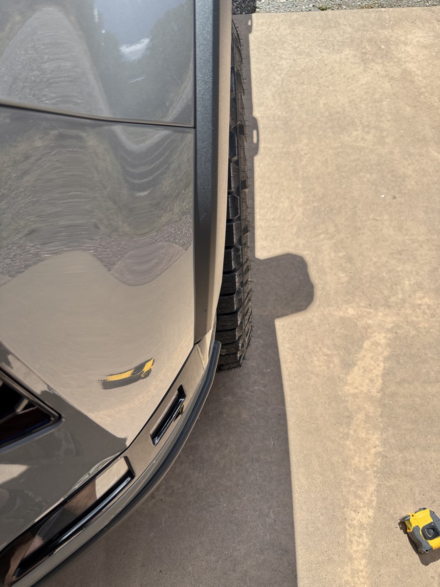

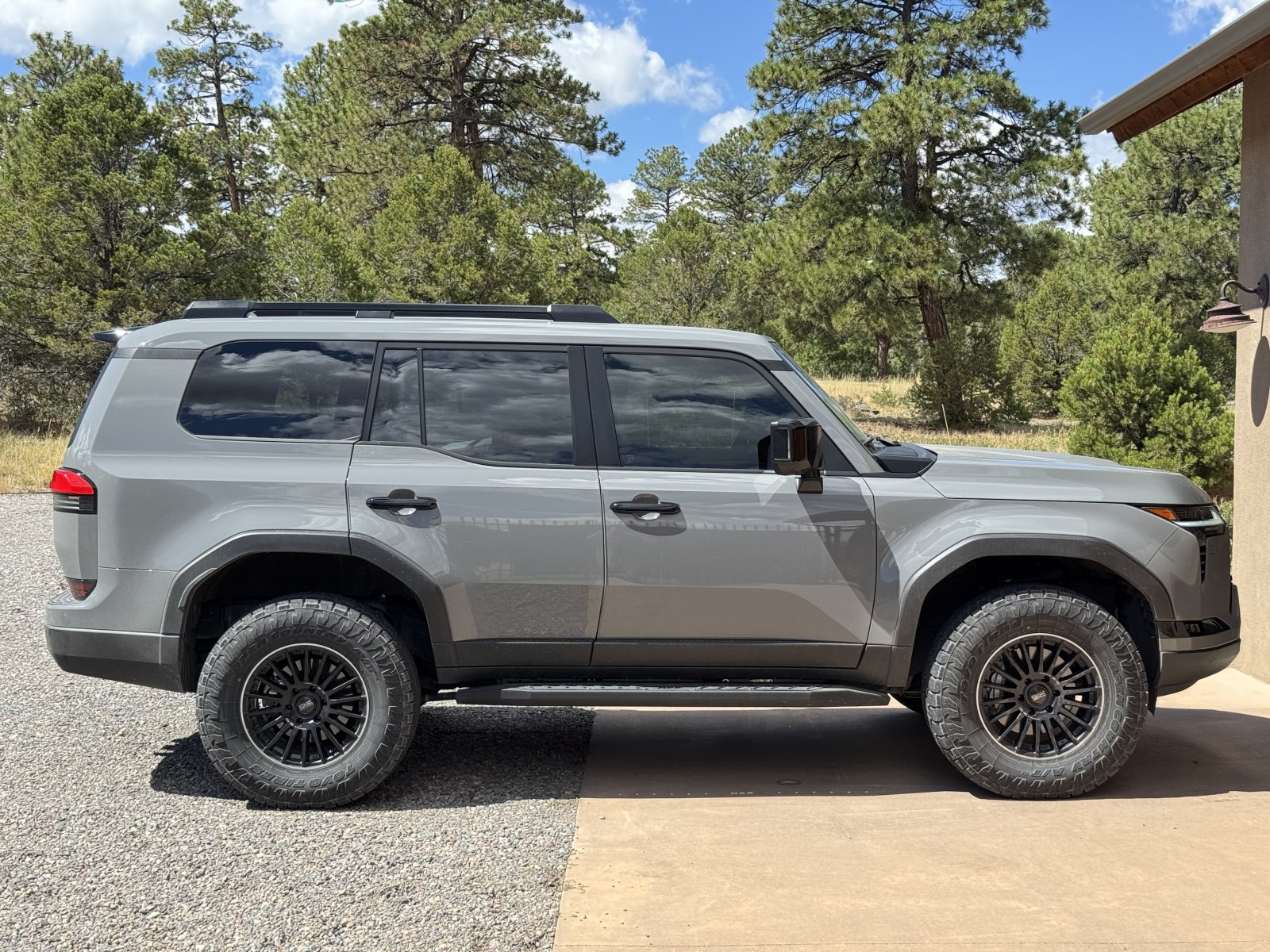

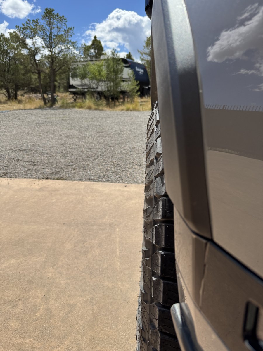

Although I’ve posted this info in a few other places, I thought I should add to the community knowledge for this Aftermarket Wheel & Tire Thread…
2024 OT, MT64 lift kit (about 2.5” added rear, 2.0” front as currently dialed in).
18x8, +25 offset. Toyo AT3 285/70R18 E load, 3PMSF. Spec's state 33.7”, 57 lb. No rubbing, no trimming.
My spare, which fits perfectly tight, is a Cooper Discoverer 275/70R18 E with a 3PMSF rating, mounted on one of the OE OT wheels 18x7.5, and is spec’d at 33.6 - so height-wise it matches if I ever need it.
I gained a little bit of poke at the thickest part of the tire wall, which I really like.
More importantly, I gained about .75 to 1” track width at each side - which has contributed to extra towing stability.

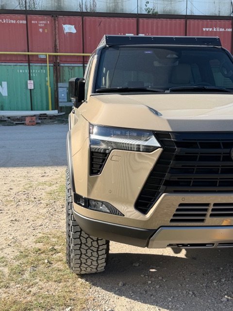

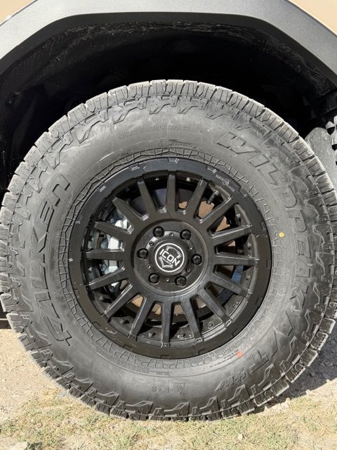

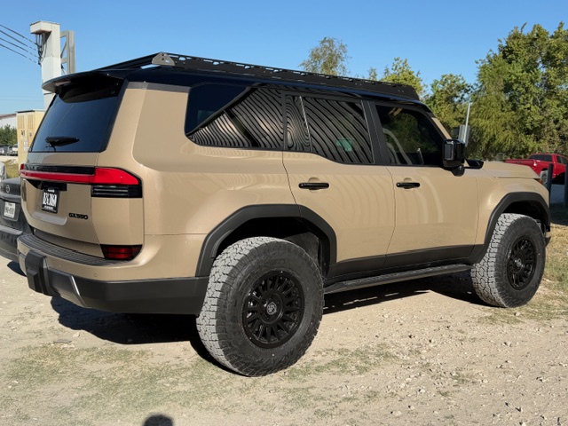

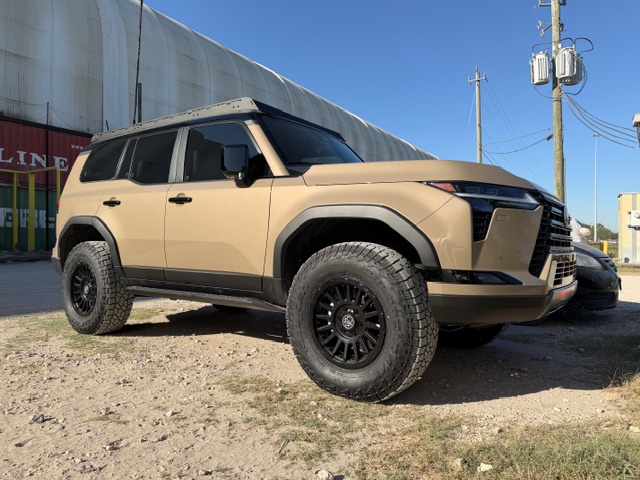

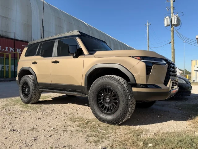

GX2.0 (traded my '24 for a '25 - another story) finally got new shoes this weekend...
Peak Performance 1.25" spacer in the front to level her out.
18" Icon Recon Pros w/ 40mm offset.
Falken Wildpeak AT4w 35x11.5r18, Load C (34.9" dia. x 11.9" wide @ 62.6lb).
"Crash Boxes" unbolted and removed from behind the front tires.
Minor rubbing in the front which required pulling the fender liners forward about 1/2" (drilled new holes and remounted) and a VERY small trim on the corner of the bumper to line up w/ the new position of the liners - easy peasy and looks OEM but will likely replace the front bumper anyway over the winter. Full flex test w/ a forklift and no rubbing or clearance issues inside the wells whatsoever.
Looks amazing. Rides great. Very little poke (basically flush).
Discount did the install and alignment, which took quite a bit longer than normal due to the pins.
Love the wheels (satin black looks so much better than the matte black Methods I had on my '24) and the bead lock 'innovation' is slick. A lot of hate on Falken tires out there, but this particular size is a Load C w/ decent weight specs, and boy are they smooth - I generally run Toyo AT3s, but this is my second set of Falkens and I'm thrilled with them so far, just as I was with the first set.
