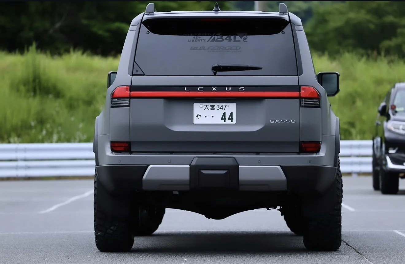

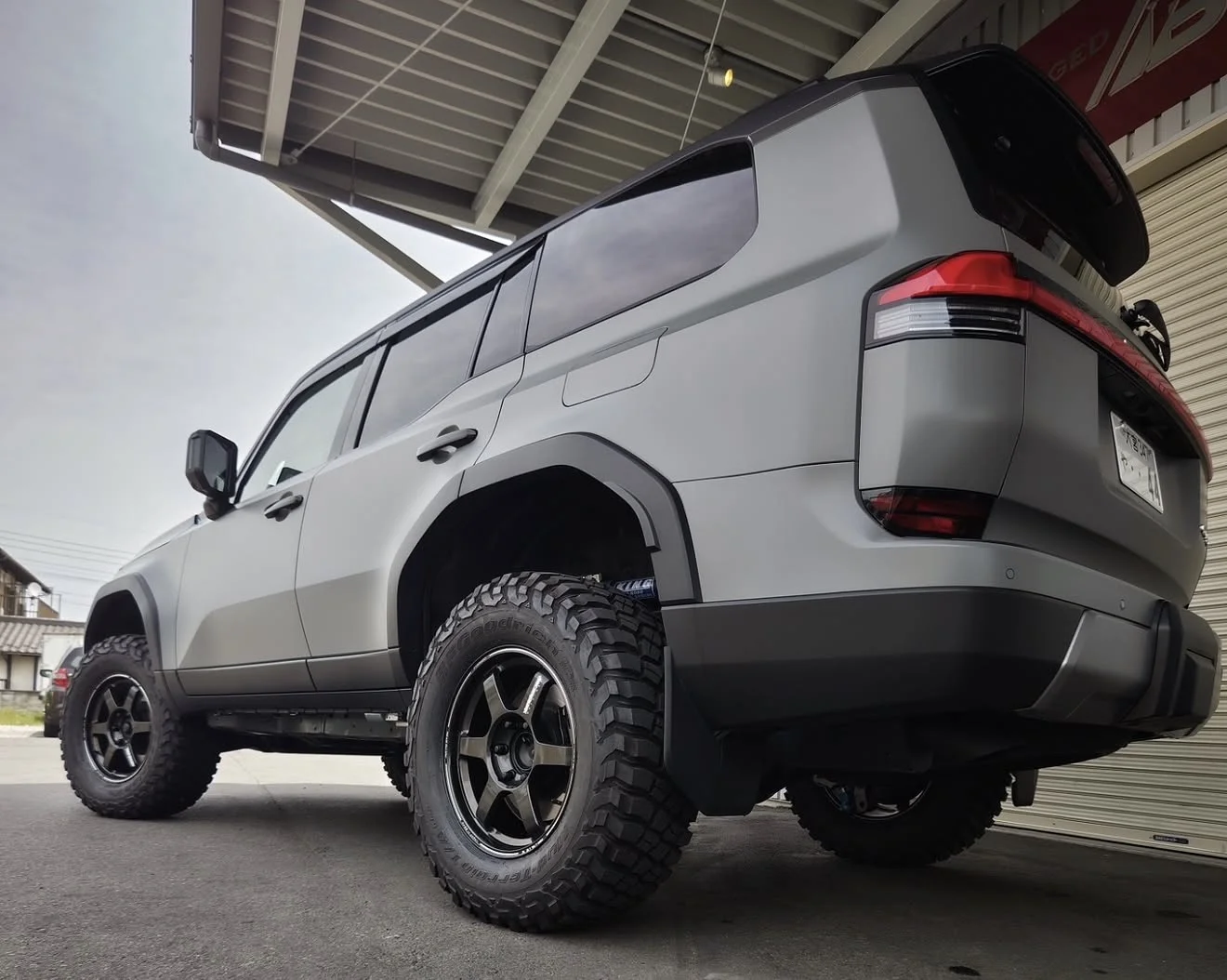

18x9 +15 volk te37xt
35x12.50 18 ridgegrapplerd
2.5 wescott

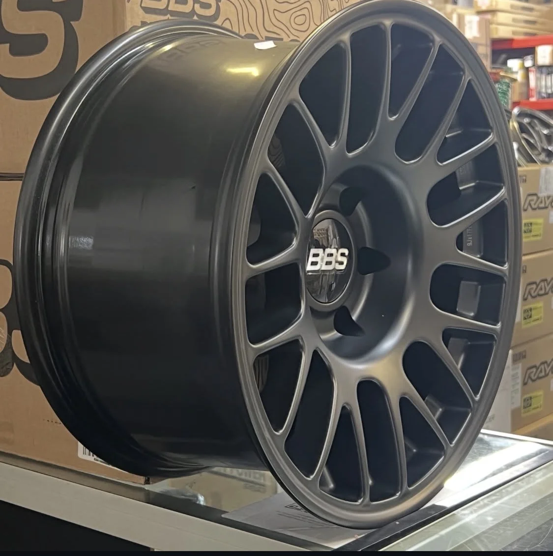

Is this the CH-R? Do they have the correct fitment? Very interested...
That's a BBS TS-M. These do come in an appropriate GX fitment though they're slightly aggressive. The common size for these is 18x9 ET0 so it's aggressive but not crazy. Should look really good if you don't mind a little poke.

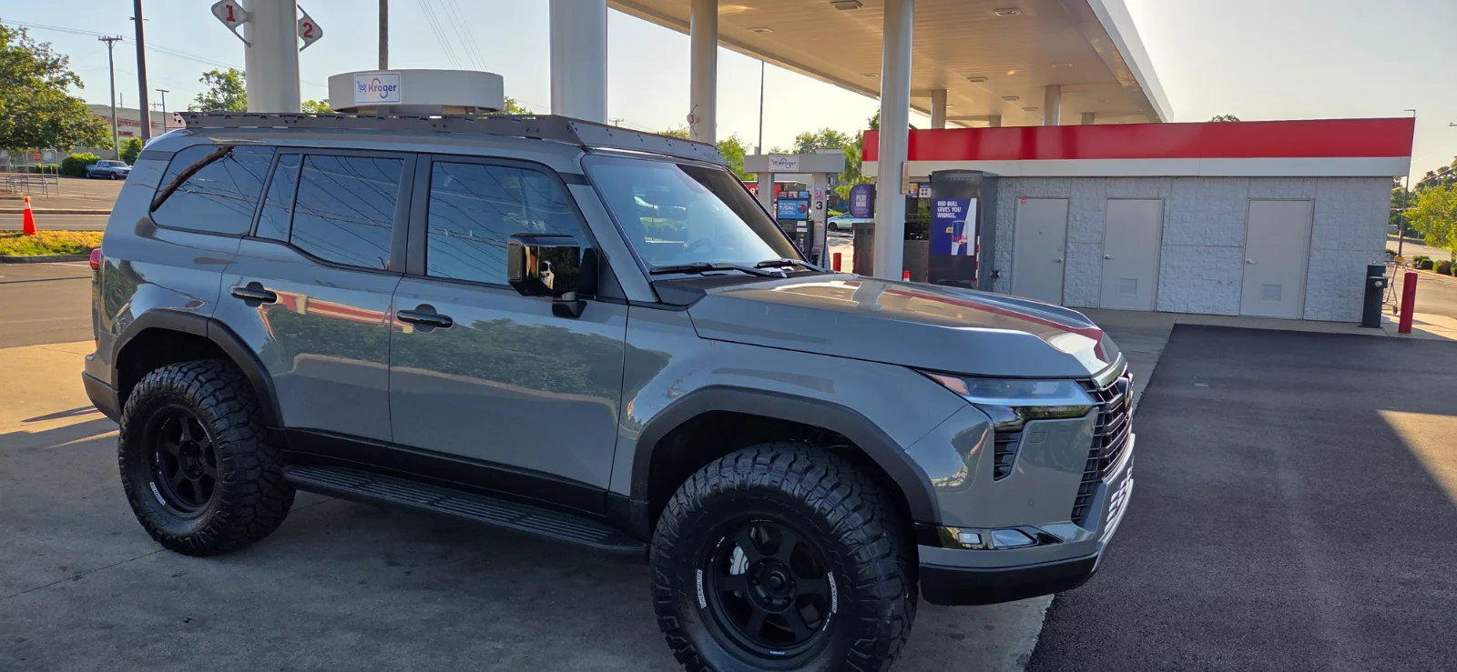

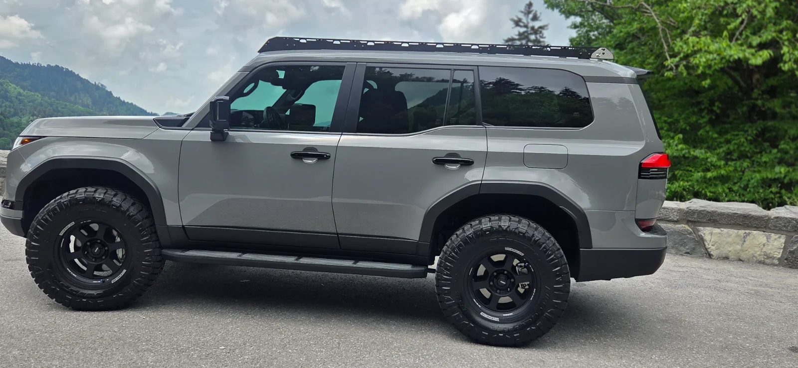

I have a 2024 Overtrail +. It’s on stock suspension and have 275/70/ R18 Toyo Open Country AT III tires.
The build looks great. I am looking to put the same size tires (looking at Mickey Thompson Baja Legends) on 18 wheels. I have a 24 Luxury plus and will add the Wescott Leveling Kit. What offset are your Vossens? I feel like +25 would fit without rubbing and provide a sharp look. Unfortunately at the moment, almost all the 18 inch wheels seems to be (+18, +12 or wider, unless you want to go to +35 or narrower).
New to the group, appreciate any info!
Hi all, new GX owner here. I have a 2025 Premium+. Looking to get a set of new wheels and need some help/advice. Thinking of getting a set of wheels that are 18x8 +22 offset. Would I be able to fit a 285/70/18 tire size without any cutting or trimming on Stock suspension? Thanks in advance!
The Baja Legends are fantastic tires. I would highly recommend something like the Peak kit instead of the Westcott as it will ride significantly better without a bunch of preload on the spring. Regardless however, that's a solid gameplay and if you can find a wheel in your desired offset, it will look aggressive, shouldn't rub, and I think you'll be very happy. I agree that around +20 is a nice sweet spot with a slight poke but still looks OEM+
