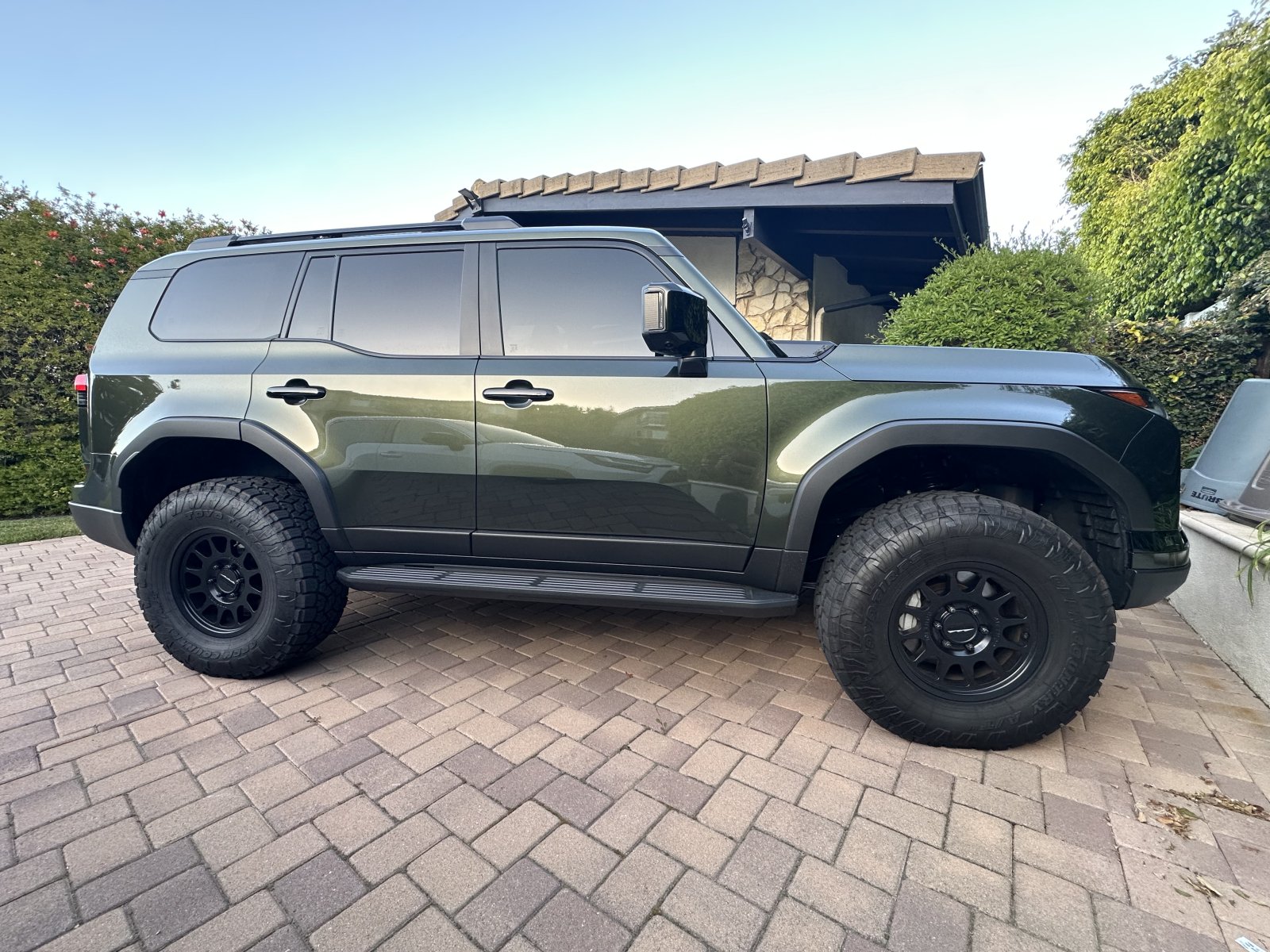

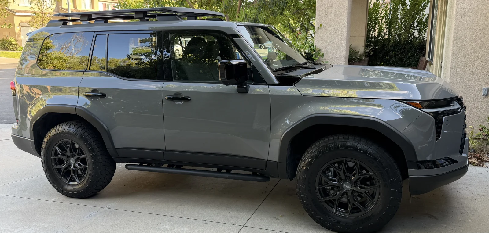

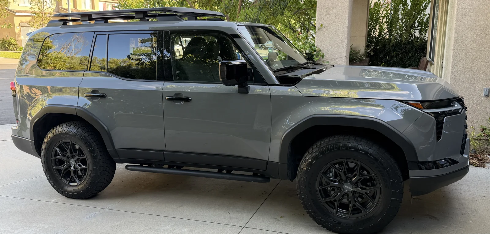

I went with Method 703, 17in, +35 offset wheels and 35/12.5/17in Toyo Open Country AT3 C rated tires. Also, I did the Westcott Pre-Collar lift. The C rated tires have more flex than the E rated tires and made up for the lift’s pre-load firmness. I’m happy with the setup, ride and stance!View attachment 21182
That stance is as perfect as it gets IMO. Beautiful truck!

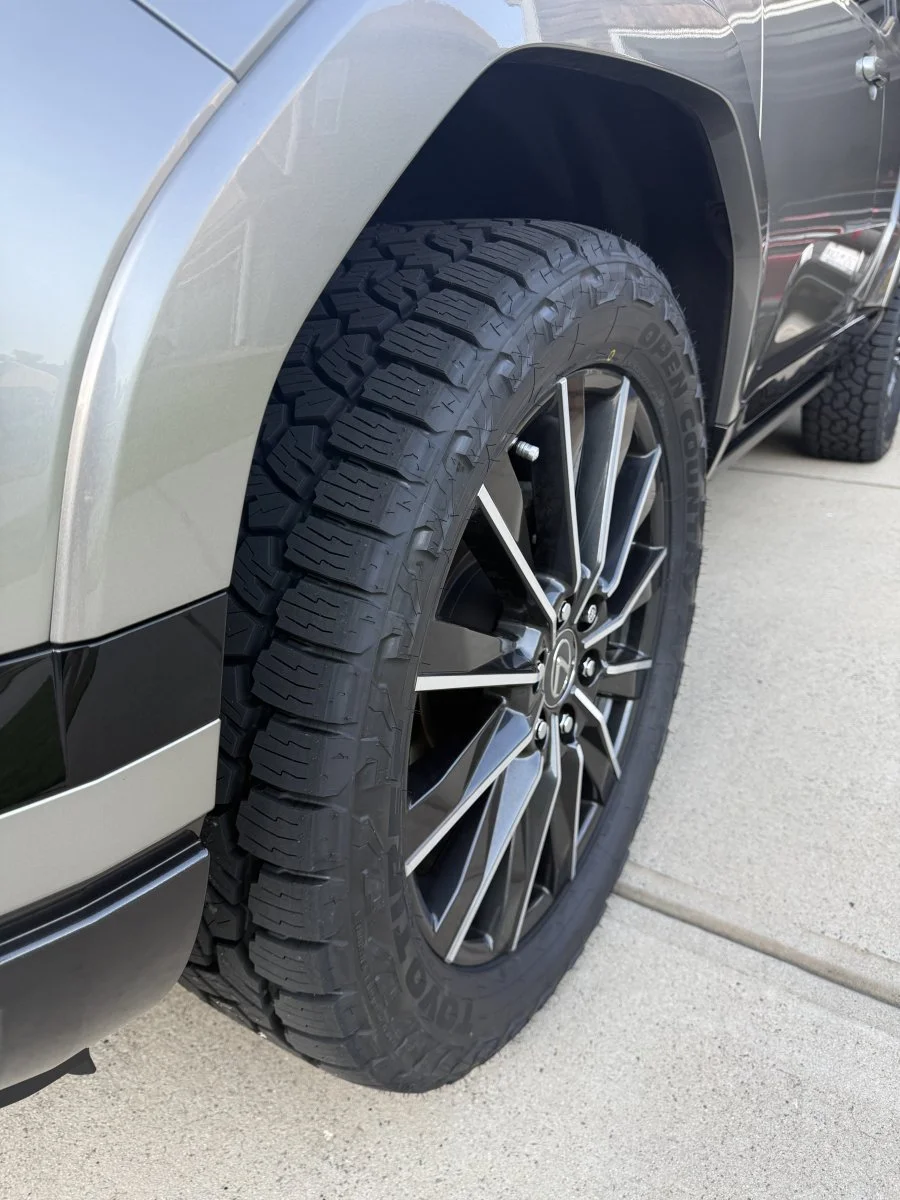

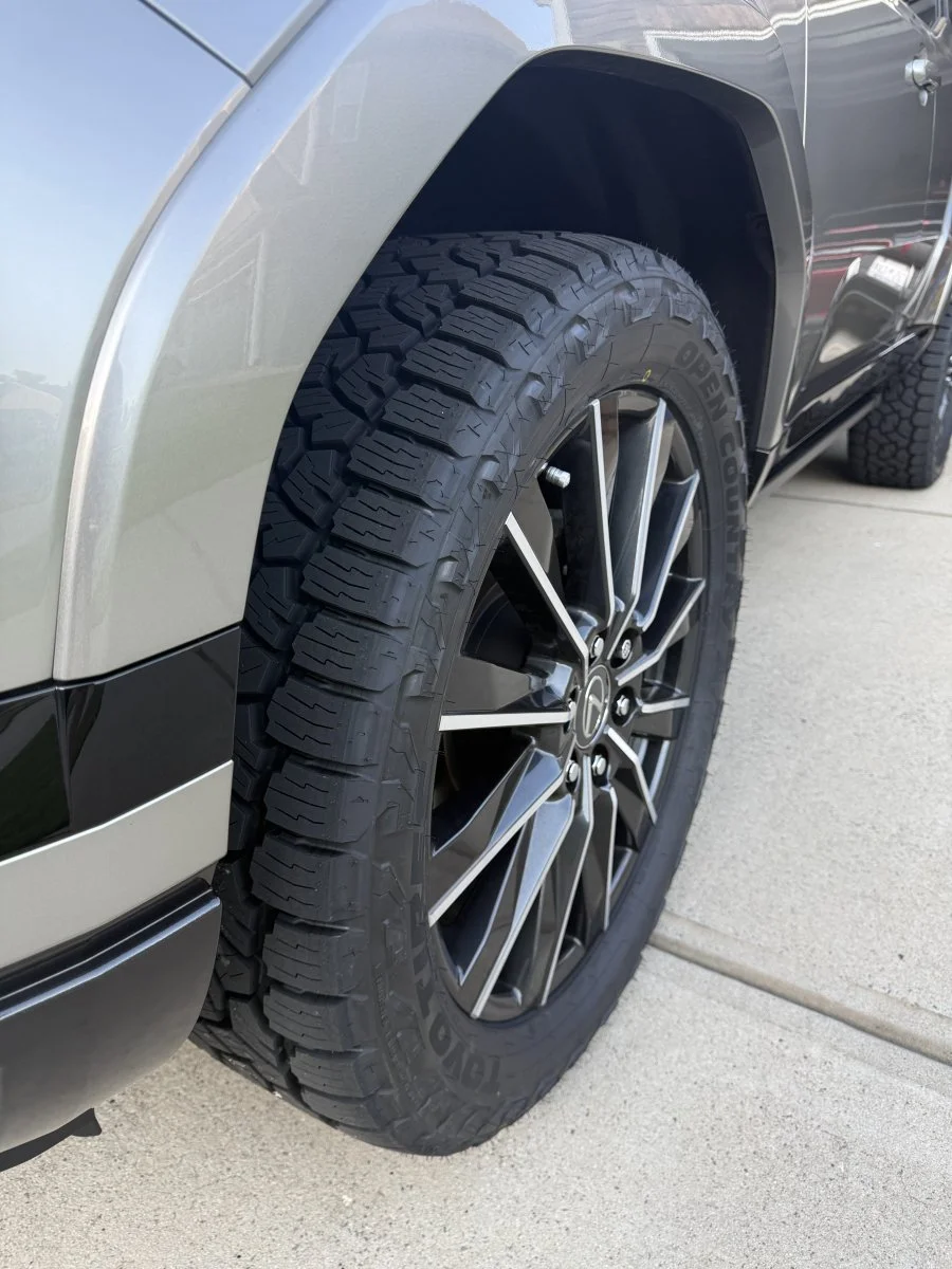

These look great! Was thinking about replacing them with the Vossen's and same tire but seeing this offset with the stocks might change my mind and save a few grand. Did you use spacers to get the offset? What are the tire specs?

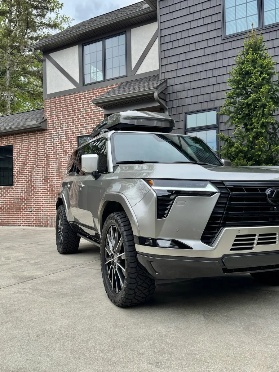

If you want to know the Vossens look like in 18 inch. Here you go! I got this size so I can still air down for off-road trails.
