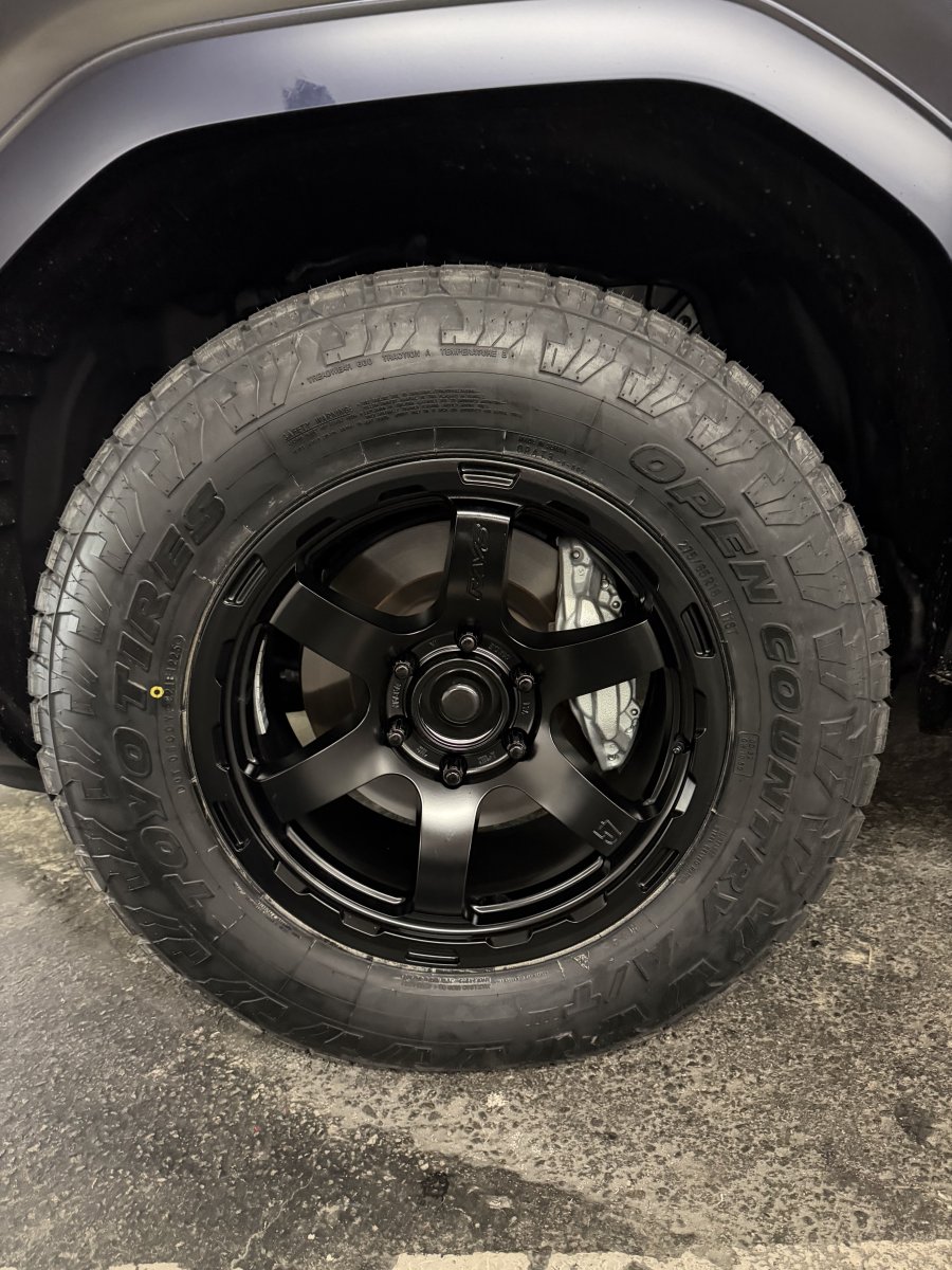

Finally got my wheels delivered from Japan.
Rays CR57DR-X HD 18x9+20, wrapped in Toyo AT3s 275/65/18s couldn't go bigger due to garage clearance issues fit like a glove.
My center caps are back ordered but in the way!

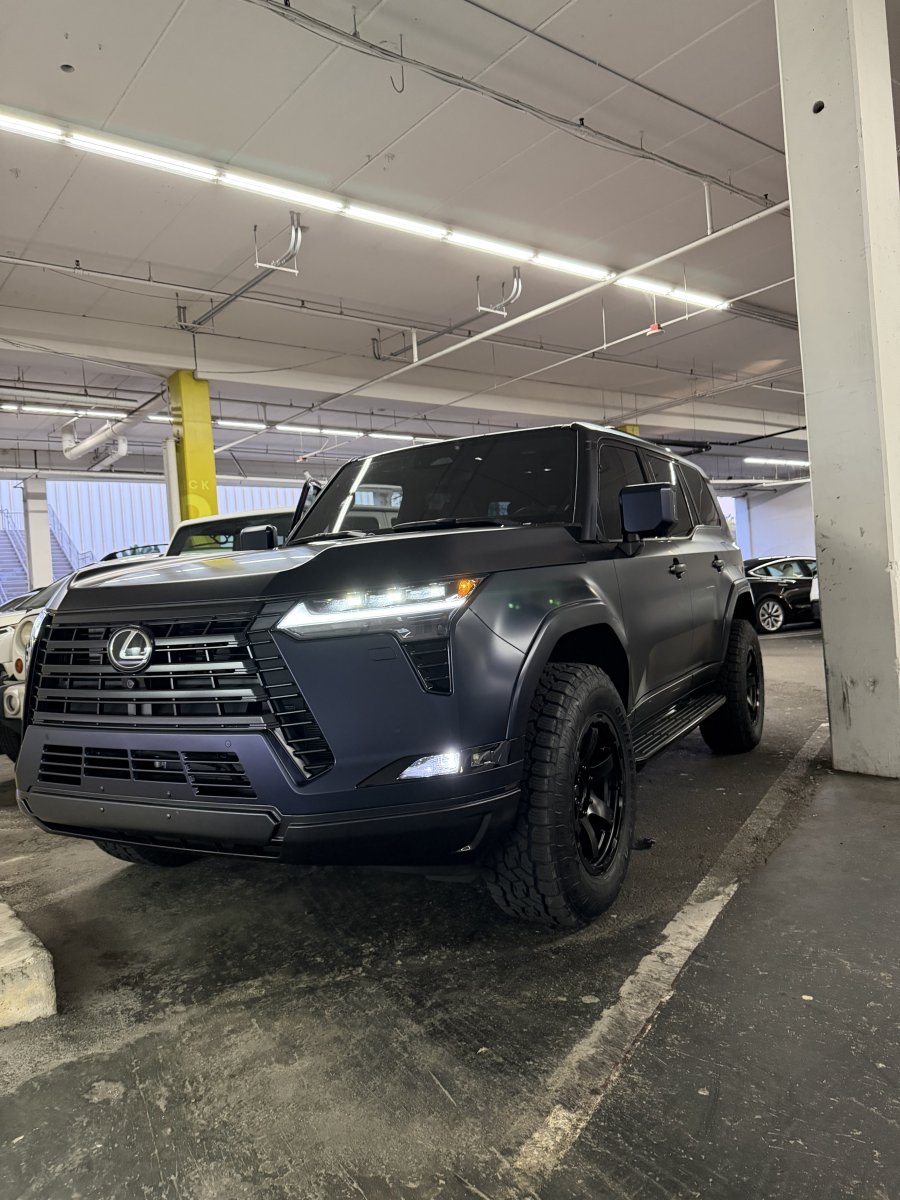

New setup:
Fox Performance Elite 2.5
Fox Billet UCA
Rear: Eibach 1/2 inch lift springs (1 1/2 for non overtrail) LSC: 2 clicks HSC: 1 click
Front: Coilovers set to level ride height
LSC: 3 clicks HSC: 2 clicks
Wheels: 18x8.5 +22
Tires: 35x11.5r18
Anybody running 18x8.5 +44 or +52 on stock suspension? Pics?

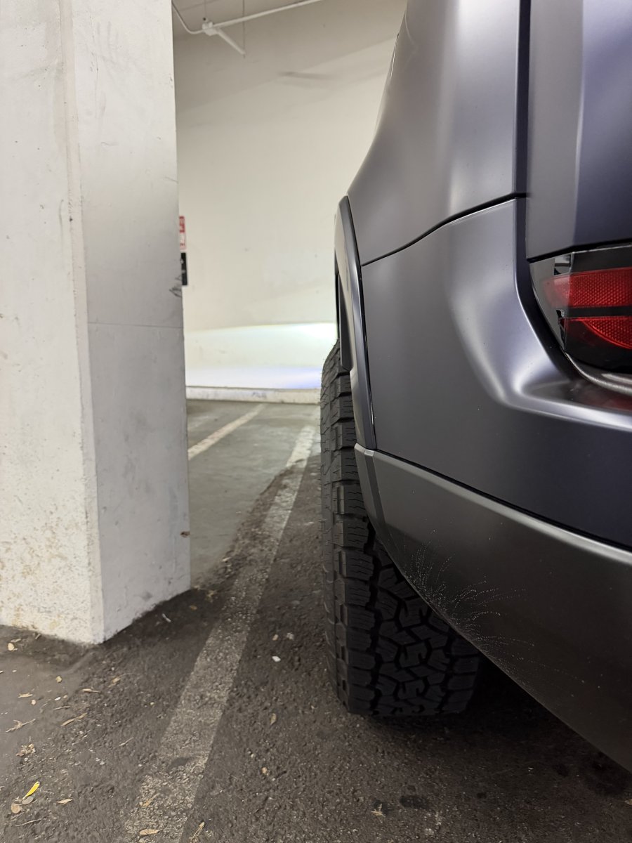

Not what you’re looking for, but here is another visual reference, comparison for you to see poke. My sidewall sticks out just a little. The tread is just even with the top of the arch.
18x8 +25, with 285/70, Toyo AT3 E rating. edit: that’s a 33.7 tire inflated, unladen.

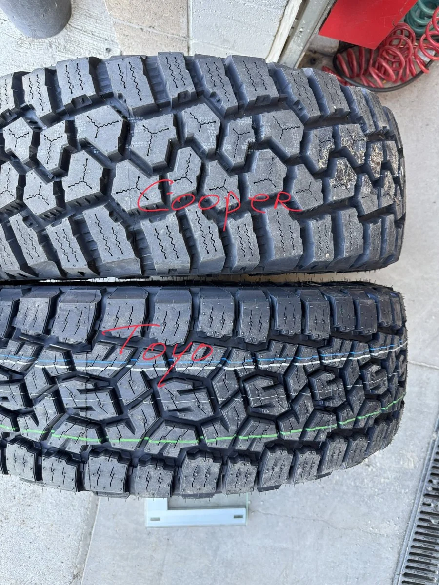

edit: if you want a tire (also 33.7..), such that the tread width and wall width are virtually the same, the Cooper Dis AT E, size 275/70/18, is worth a look.

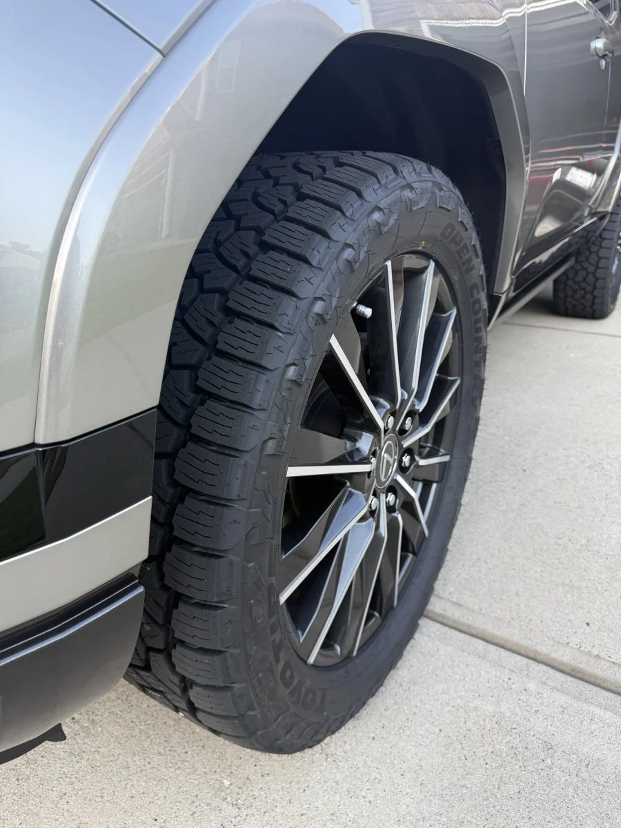

275/50/22 Toyo AT3 EV on the OEM Lux+ wheels installed.
Ride is a little harsher than stock. Can feel the knobbier tires coming to a stop. Ride compliance over bumps not as cushy despite being a touch more sidewall. Noise marginally higher on highway. Looks way nicer IMHO.

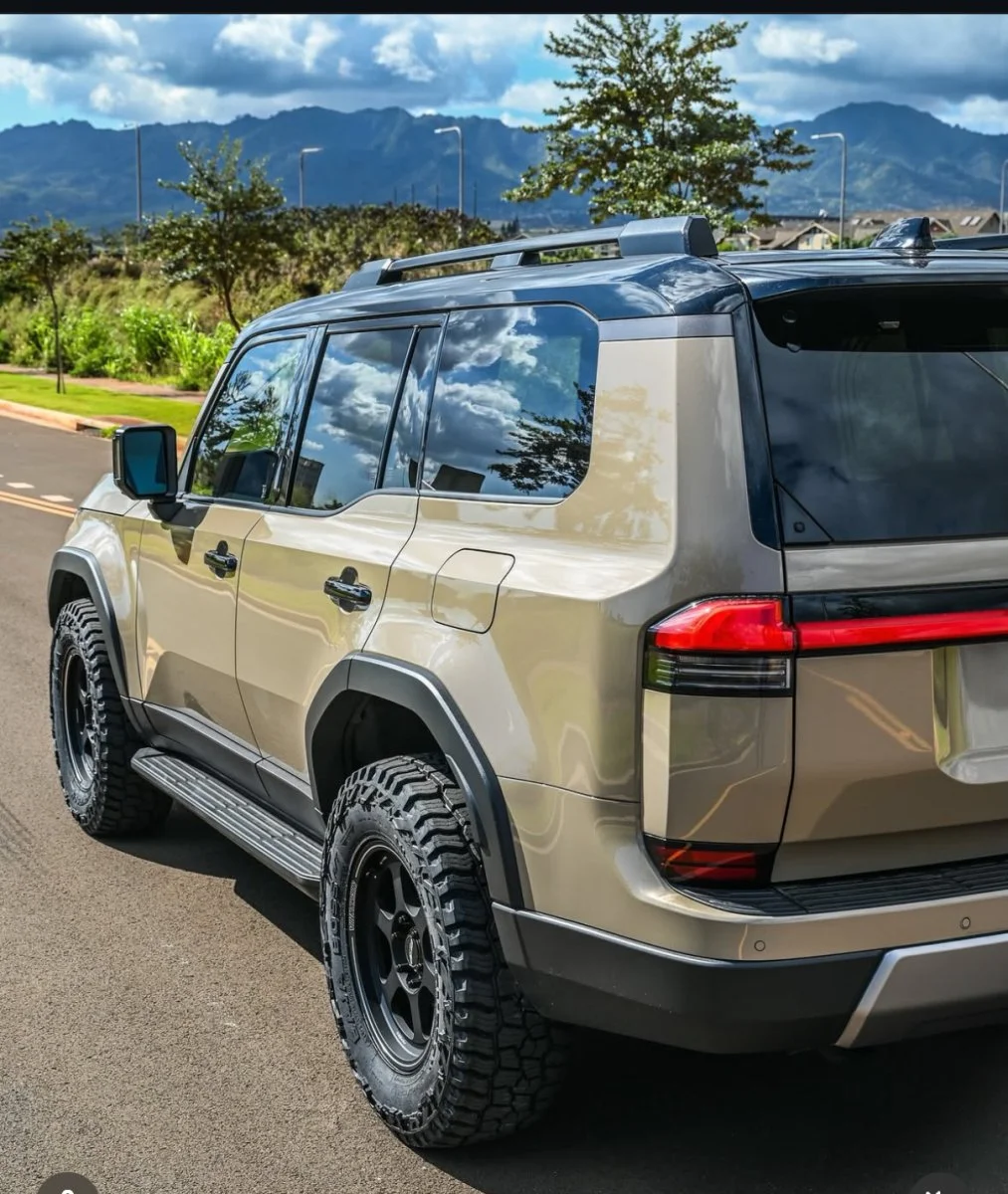

Just got my stock OT wheels swapped out for the popular Method 703's in the 17x8.5 35+ and went with Falken Wildpeak A/T4W LT285 /75 R17. Fits great with zero rub that I've encountered so far on the factory suspension with no collar lift or anything. Went with the gloss titanium and very pleased with the look. I was initially looking for something in like a dark bronze, but best I could find was the RRW in a 25+ offset and since I haven't decided if I want to do any lift yet, didn't want to chance that not working. I'm happy with the result though, just need to see if I can stuff a deflated spare down below now.
