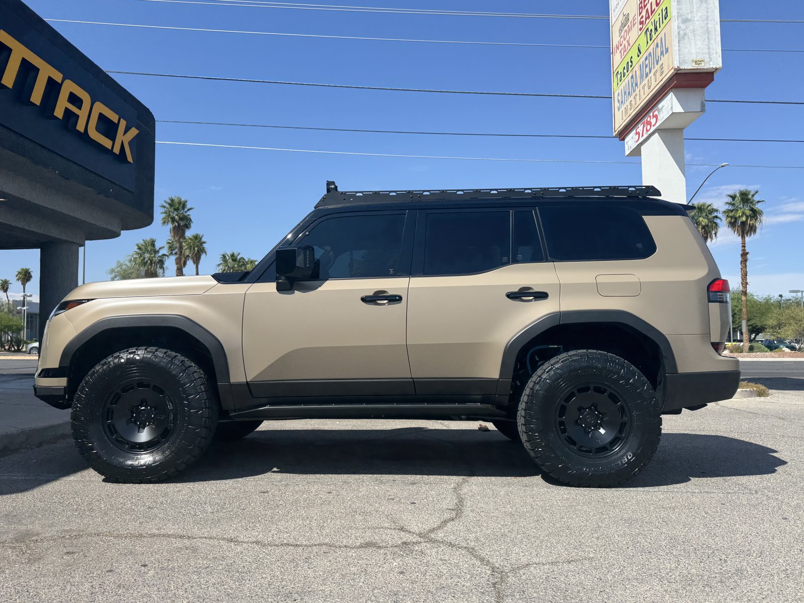

Looking good! Do you have any "poke" pics? Or can you tell me how your setup looks down the fender? I'm looking to run the exact same spec.
There is no poke with this set up. The wheels are just sitting 10mm out compared to stock

Understood! If you don’t mind taking a down the fender pic, like looking over top of the fender towards the ground, that would be awesome. And one from the rear of the vehicle as well 🤞!
How do you like the terra grapplers? Torn btwn those and the toyos myself.

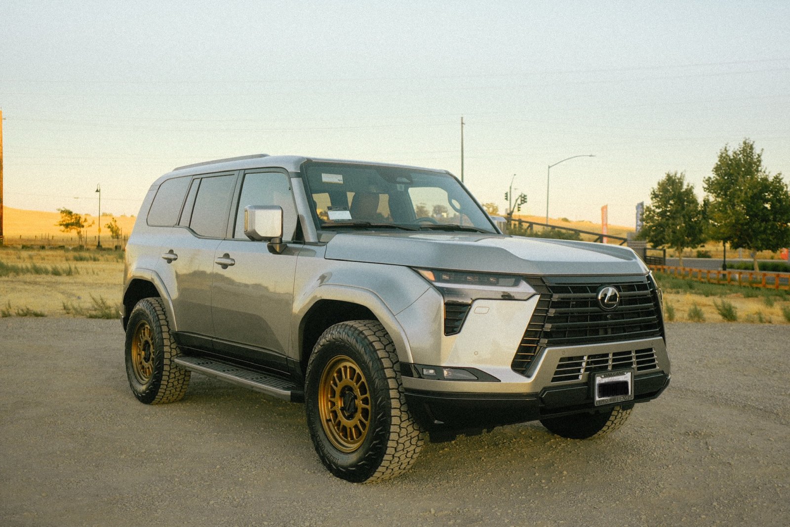

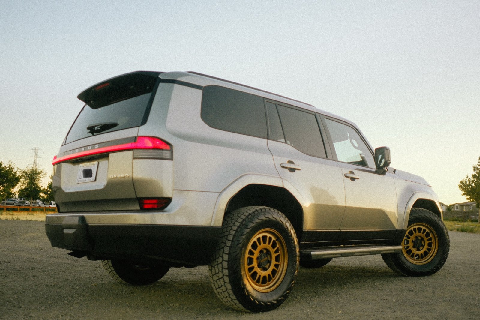

method 705 +35
315 70 17 Goodyear territory
Stock suspension
No rubbing at all
No poke with gx wider fenders

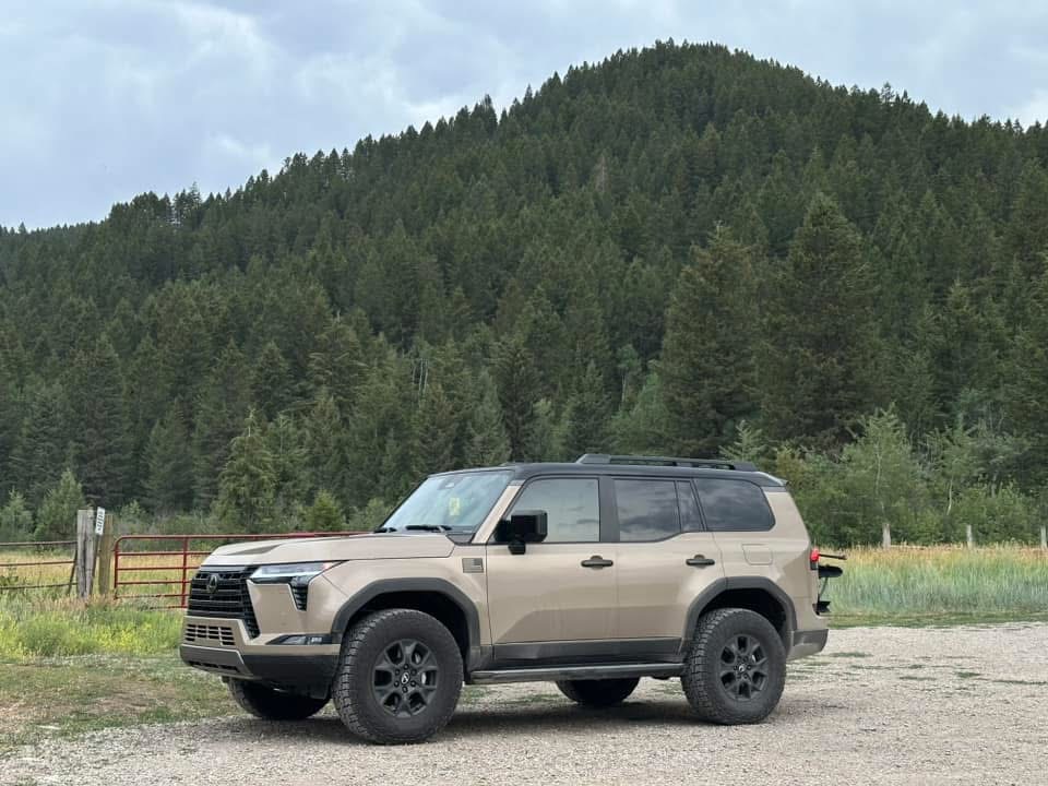

ADV-Classic wheel 17x8.5 +25, 22 lbs per wheel.
95.1 mm Hub Centric Adapter Ring Kit.
Toyo AT3 35x12.5R17LT (load range C).
Love the wheels. Best looking wheels in my opinion but def on the expensive side at 700 a piece . How much lift do you have ?
method 705 +35
Stock suspension
No rubbing at all
Wheels are 25 lb which are light for non forged wheels
Tires are 53lb , the lightest 35s out there
Looks good. Was surprised to see you fit a 315/70 in there on stock suspension. Those would rub like hell on my 2024 OT
