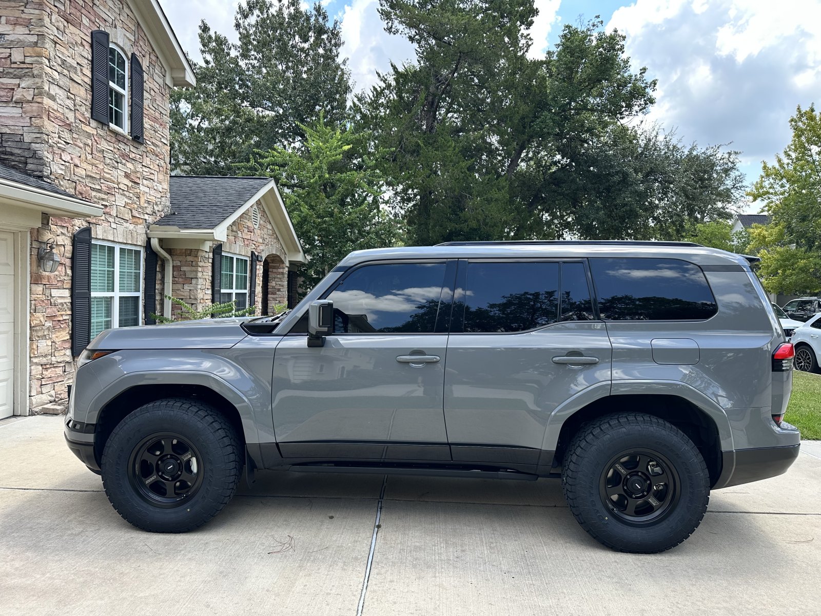

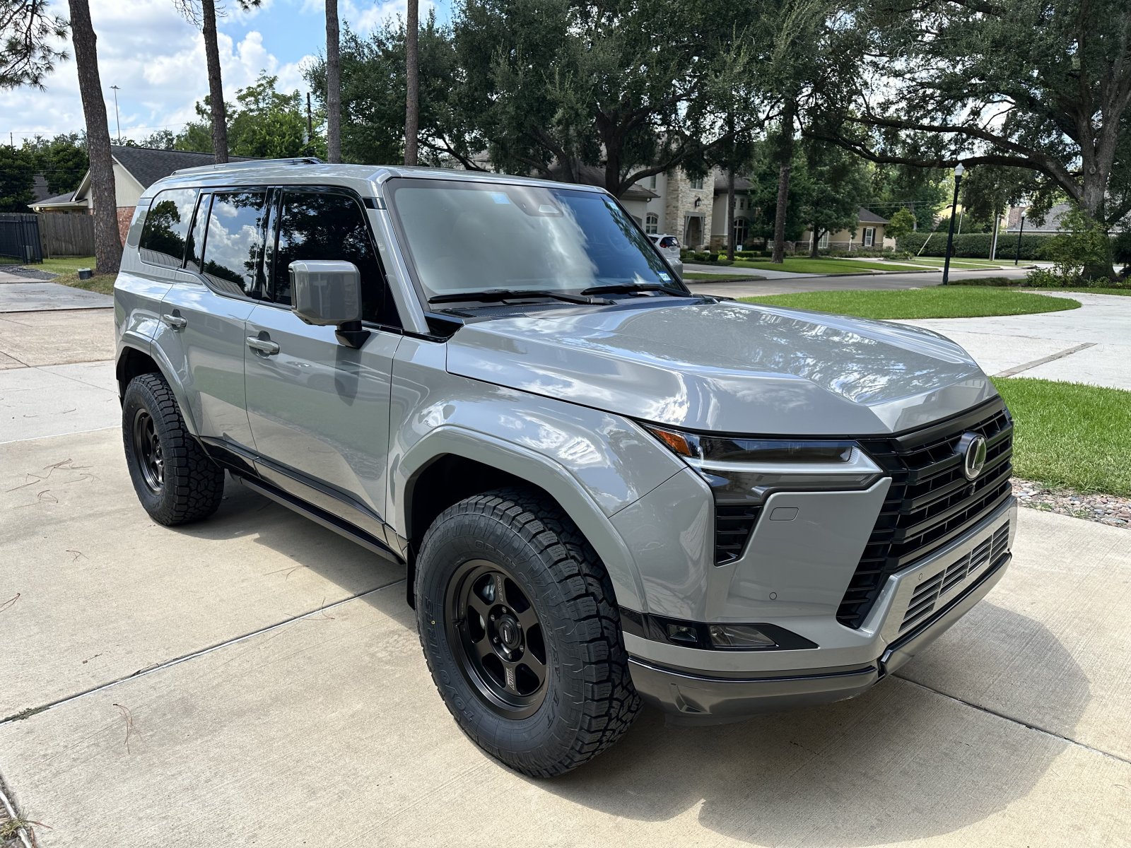

Got my tires and wheels mounted so I can finally contribute to this thread :).
Special thanks to everyone who posted their pics/specs before me...it helped me in figuring out my "ideal" wheel/tire spec
2025 Lux+ on Stock suspension
Volk TE37xt (Shadow Black)
17x8 +20
285/70/17 Toyo Open Country (SL)

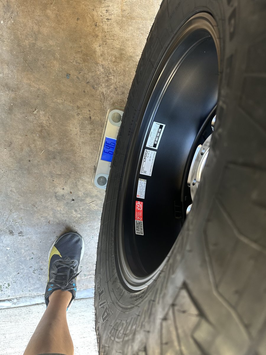

Total Weight: ~65LBs vs. ~80lbs for 22" OEM Lux+ wheels
My takeaways:
  • Fitment: No rubbing or trimming and in fact, it looks like I could've gone 285/75 but I've read folks start rubbing at that size (on stock, non-OT suspension)

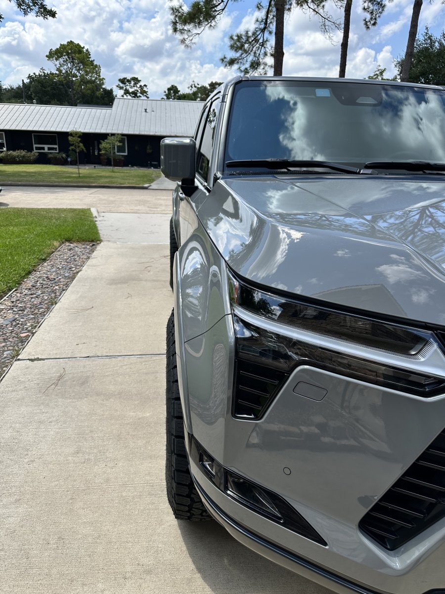

  • 17" wheel - This wheel barely cleared the front brake calipers so be careful on where the wheel weights are stuck on as there might not be enough tolerance to clear it.
  • Noise/Vibration/Harshness: Definitely hear more "humming" while driving. Hoping it settles a little once the tire get more mileage. slightly more vibration but I feel there's a little less harshness and more "plush-feel" Will need to get more miles on it.
  • Poke: I didn't want "that" much poke but it's ok. I think +30 offset is perfect but it even if Rays made that spec, it would have less "lip" on the TE37xt so I'm happy with the compromise. I also installed the front mud flap to limit the debris it will sling up.
  • Definitely happy about the weight savings.
  • Worth noting since there's a separate thread about this... I got about ~5 full turns on the Rays lug nuts. I measured the stock nuts and it was about 9 full turns so definitely less. I will keep an eye on it and re-tighten every few hundred miles.

Yeah I've read through it and decided not to run extended studs. I am running hub rings but the vibration is more of running AT tires vs HT tires. It's not bad vibration... more of "resonance"

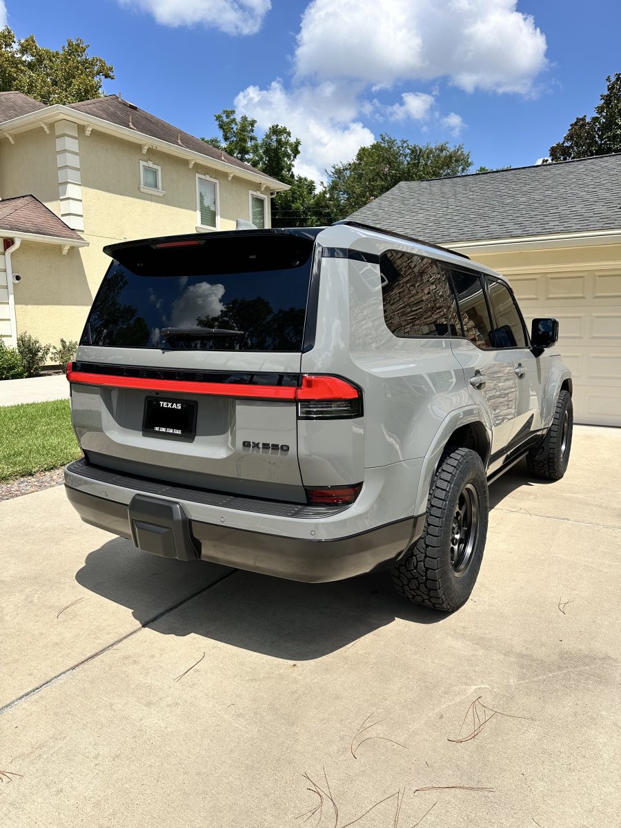

O.Z. Rally Raid, 18x8.5 +35
Falken AT4W, 285/70/18, C load
No lift and no rub after removing the small covers in the wheel well behind tire.

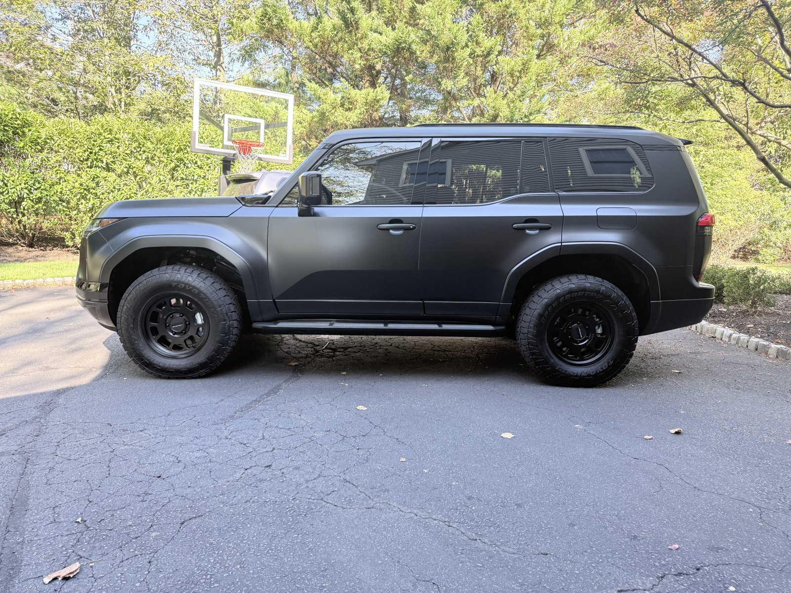

17” Method 705s with 285/70/17 Toyo Open Country.
