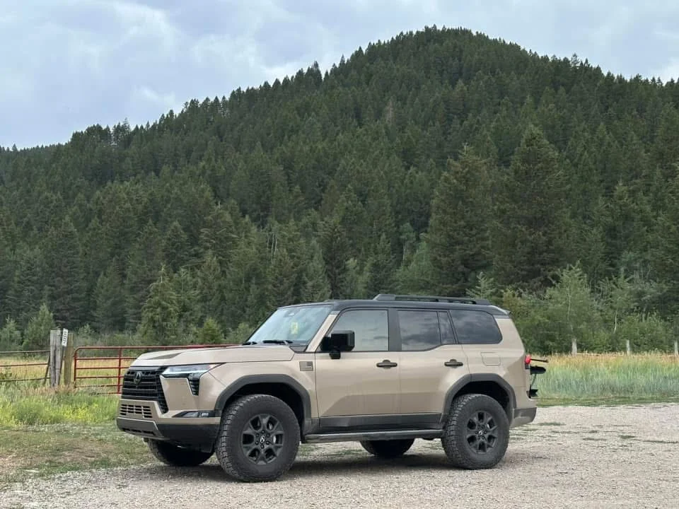

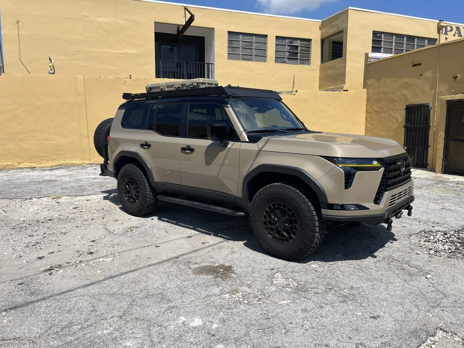

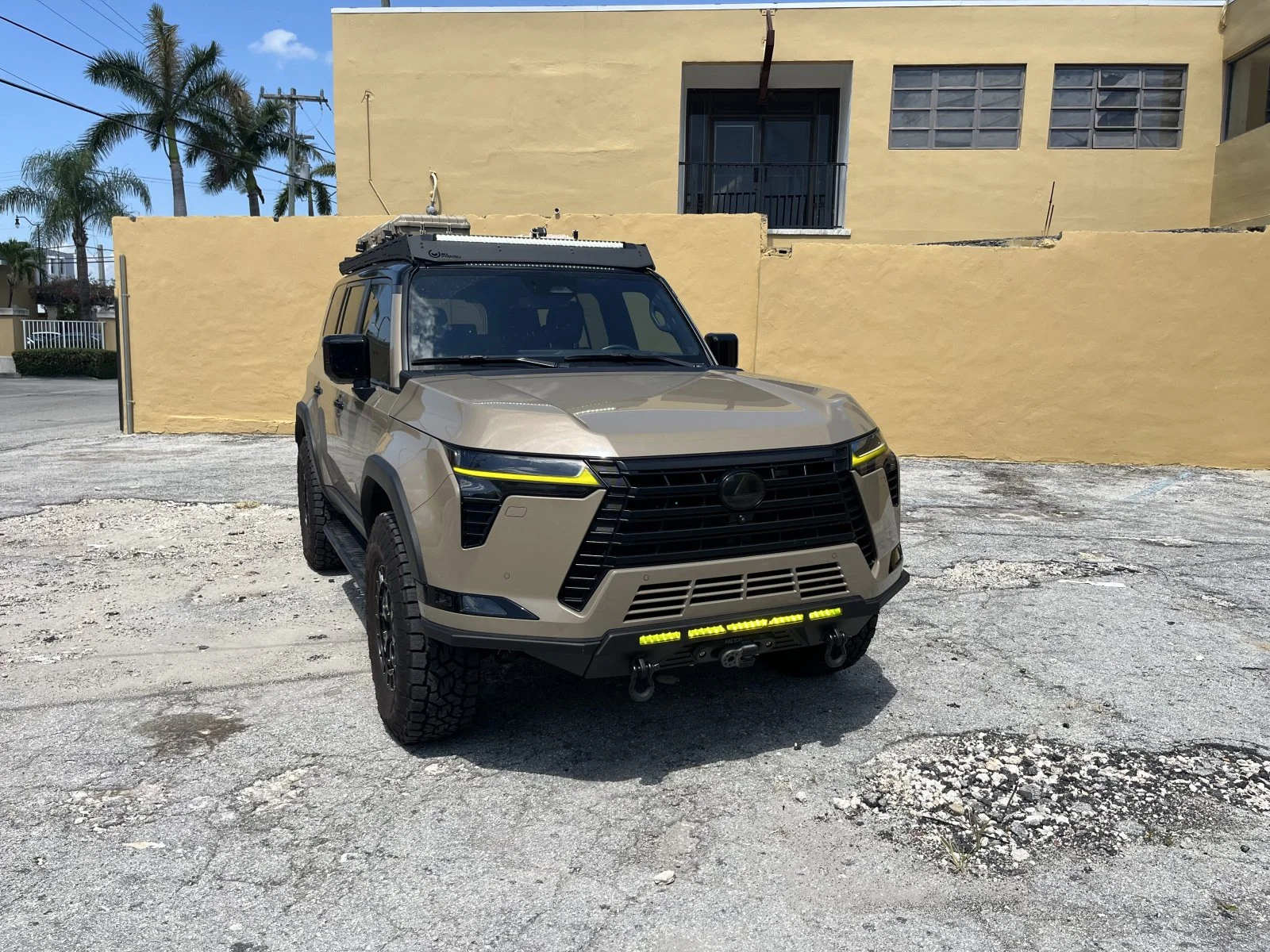

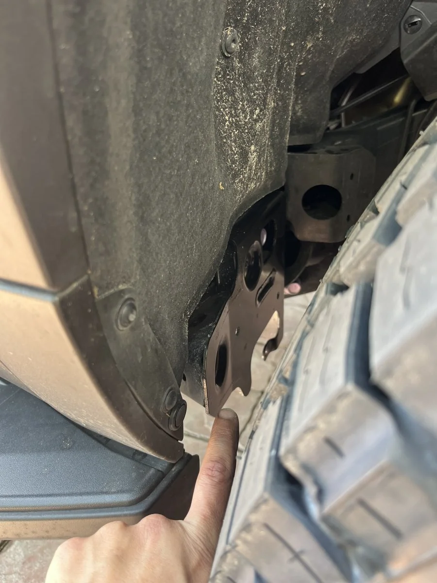

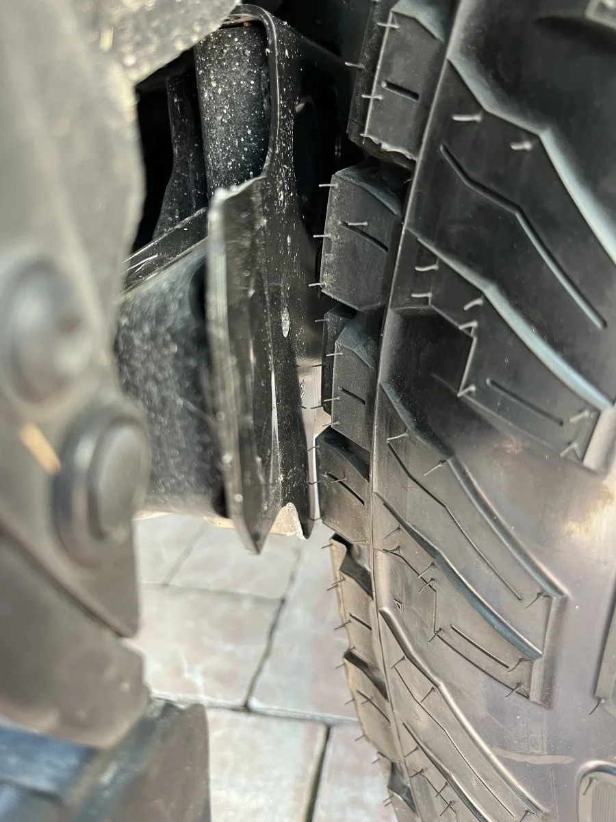

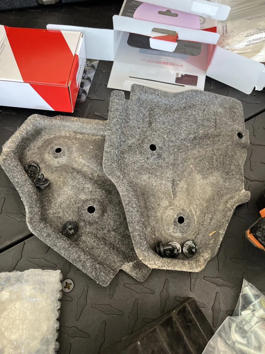

Vossen HFX-1
17" x 8.5" +35 offset
Toyo Open Country AT3
35" x 11.5"
Required For No Rub
Westcott Preload Collar Lift (or similar)
Remove Liner/Panel that covers the crash box

Very nice build! I removed the crash bars for more clearance and my tires are slightly smaller than yours at 285/75R17. My offset of +25 is probably the reason for rubbing.

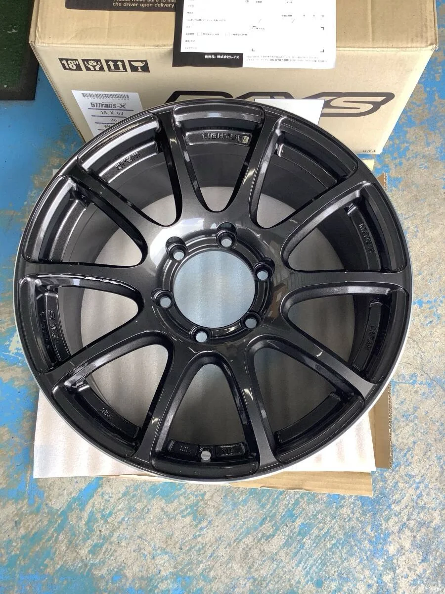

For those running Volk/Rays, what hubcentric rings ya’ll using? Looks like I’ll need 112-95.1 for these TEs
That’s what I purchased for the ZE40X. The wheels are stuck in custom and the extended studs are not here yet. Hoping to have them installed in two weeks.

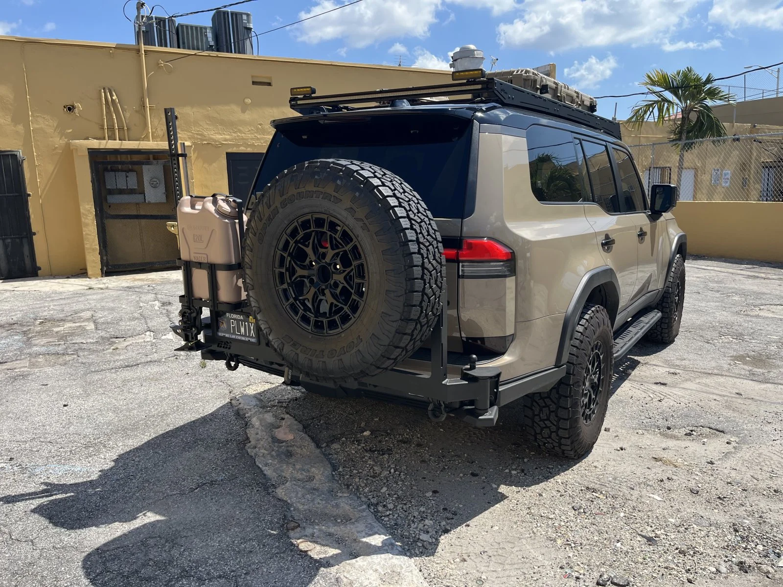

Vossen HFX-1
35" x 11.5"
Required For No Rub

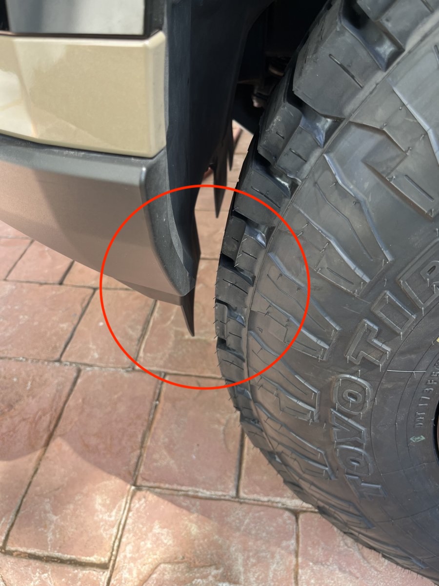

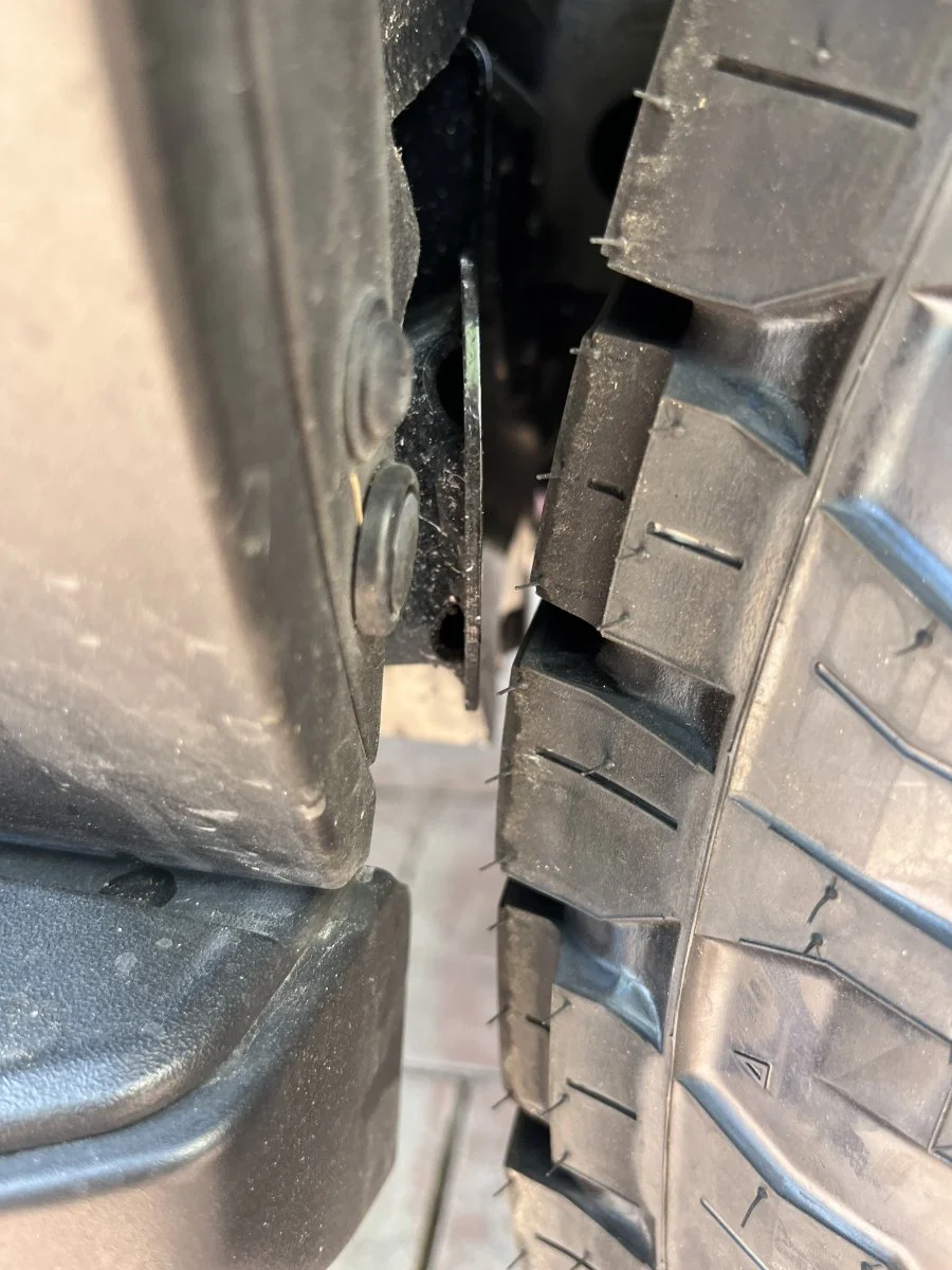

Can you help me understand why the Westcott lift is required for no rub? Unless your bump stops have changed, the suspension travel (most notably into the wheel well) remains unchanged. The preload collar basically just stiffens the spring, so it sits a little higher while resting.
I understand your point. However, the lower bumper/valance was the main point of concern. This picture is with a lift installed already and it was extremely close when I had my steering wheel slightly turned. This isn't a good reference picture as the my steering wheel is straight here and it looks like there's quite a bit of room but with the wheel turned it's very close. So it may be possible with the wheel and tire fitment I went with but unfortunately I had the lift installed before the wheels/tires arrived so I couldn't test It out.

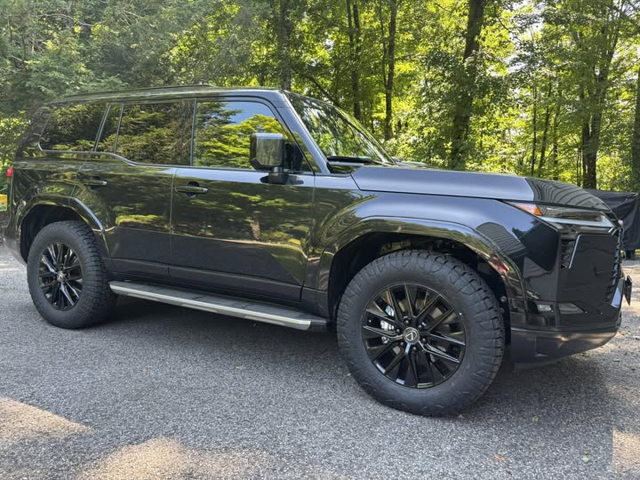

Not my car but 285/75/18 on stock ‘25 OT
