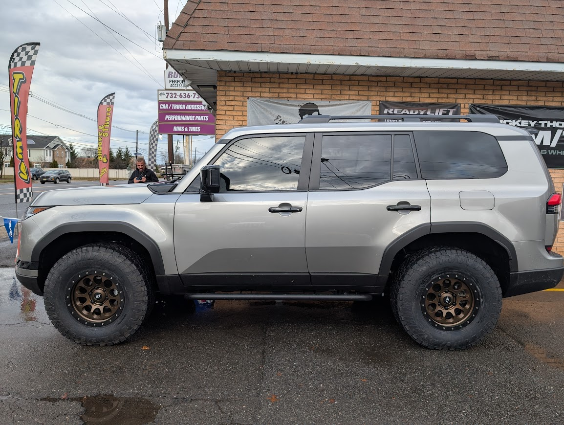

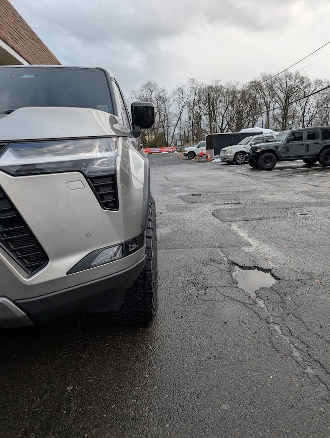

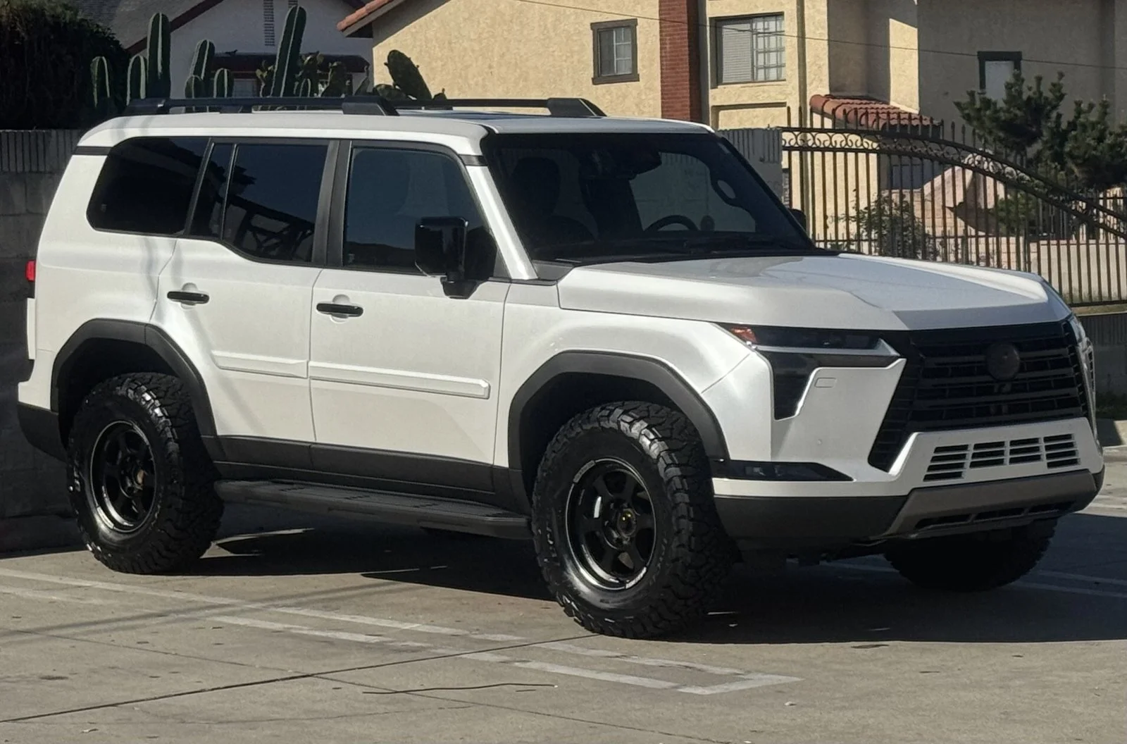

Buyer beware of member @IntrinoX/BBO for misleading me on these wheels! He told me these wheels were going to look good on my car and I would like them. He didn't tell me that they were going to look THIS good and I would like them THIS much! :ROFLMAO:
Jokes aside. He's an excellent vendor. Quick, responsive, and all around cool guy. Thanks for the wheels and seamless transaction.
Went with TE37XTs in 17x8 et 20 with KO3s in 285/70/17. Loved how they came out.
Center caps inbound.
Those look great!

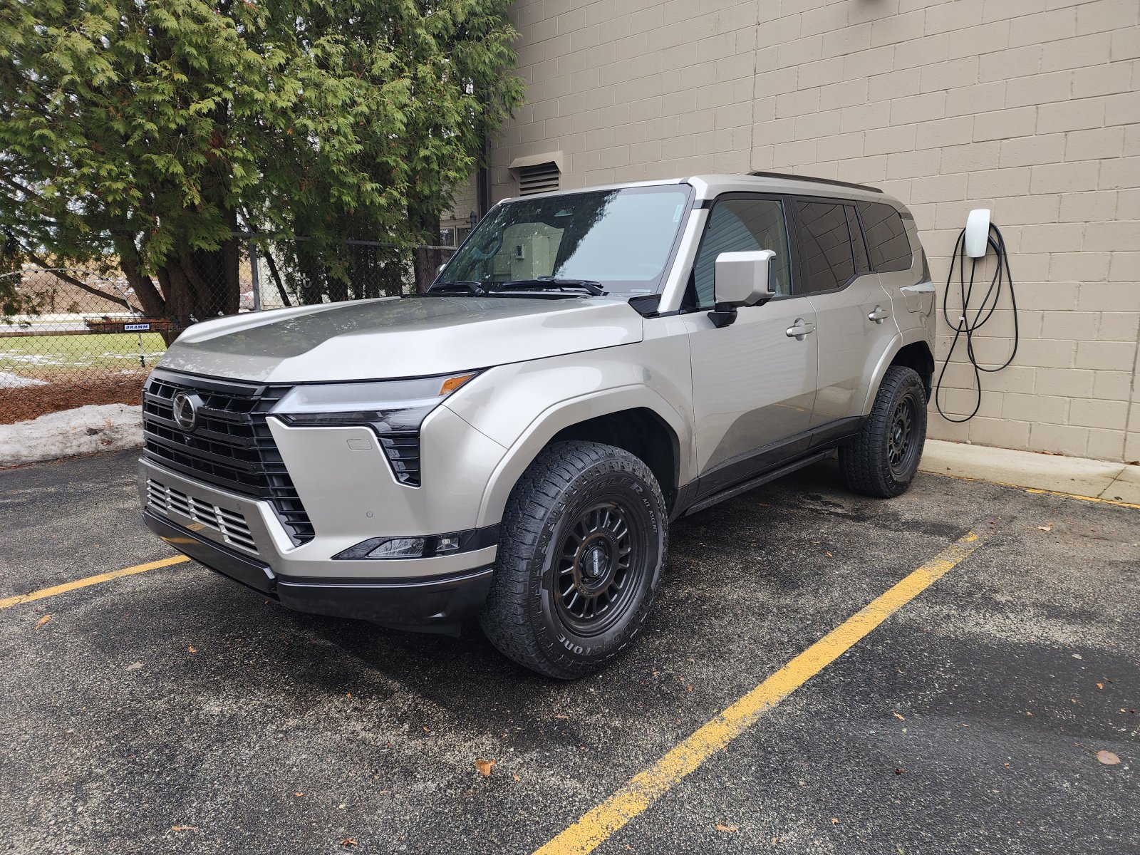

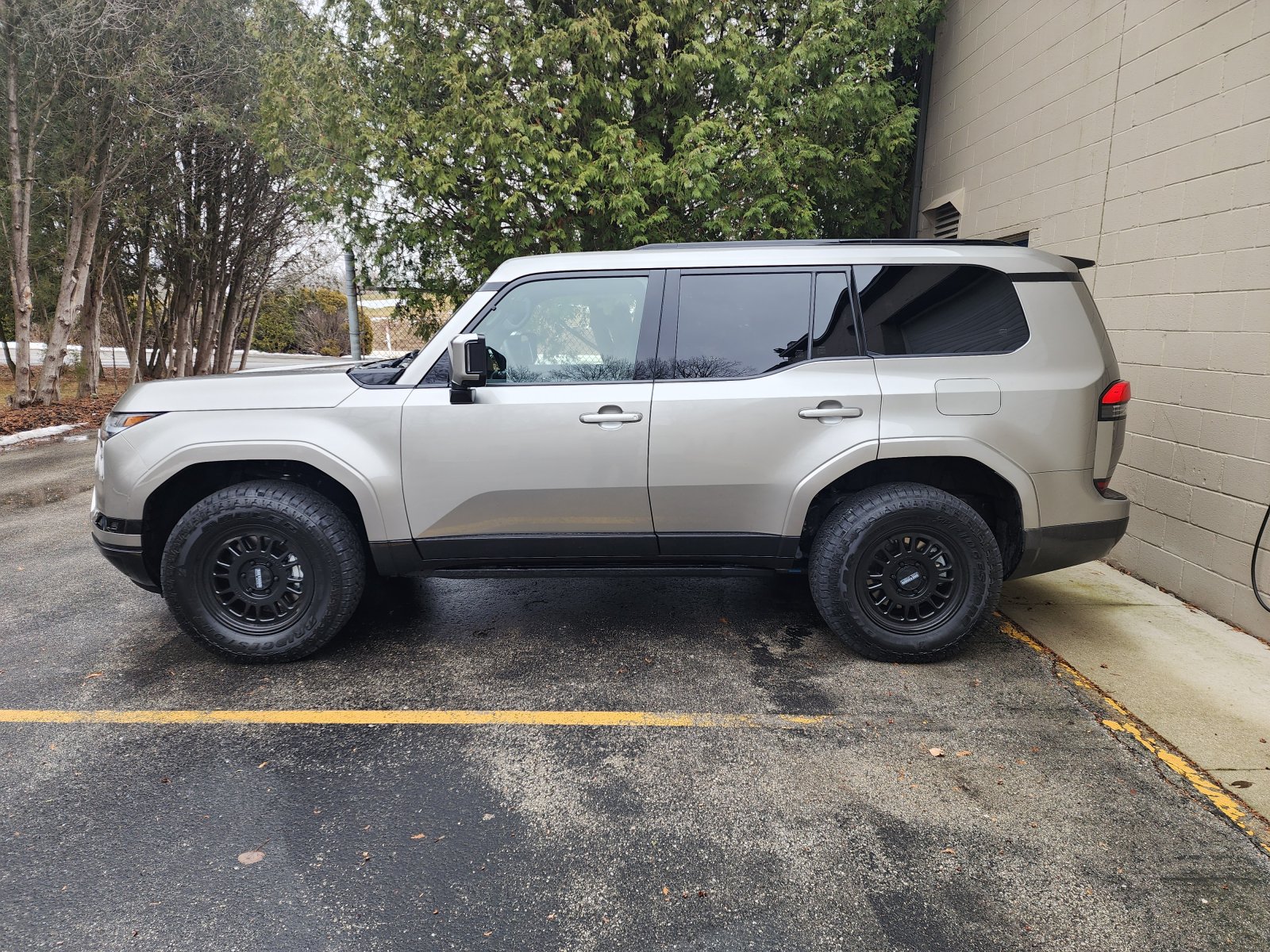

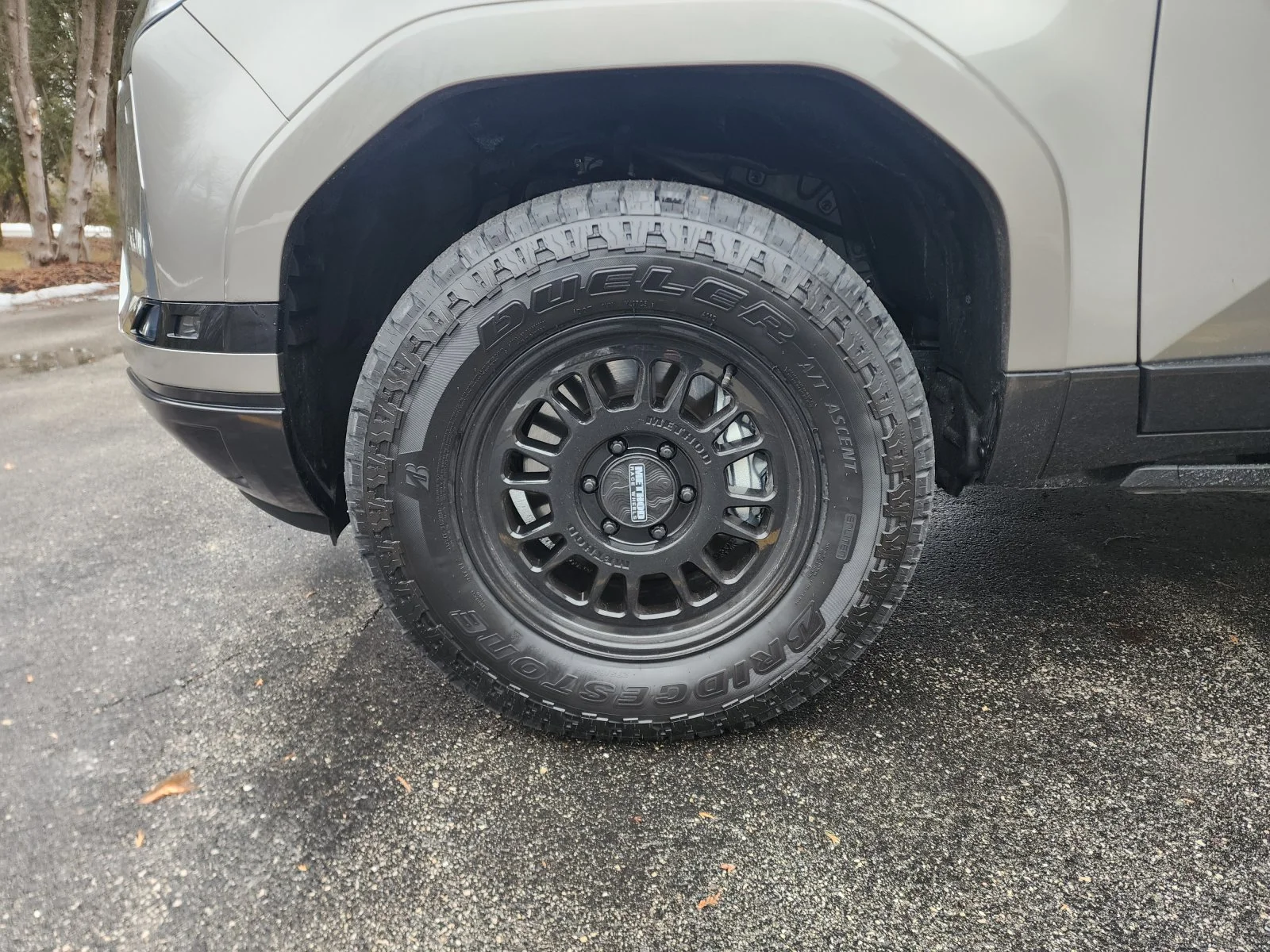

25 Luxury + No Lift
Method 318 18" Gloss Black Wheels +40 offset 275/65/18 Bridgestone AT Ascent Tires
Wheels are flush with fenders.
Big improvement in ride versus oem 22".
Spare tire with same wheel and tire fits good with no issues.

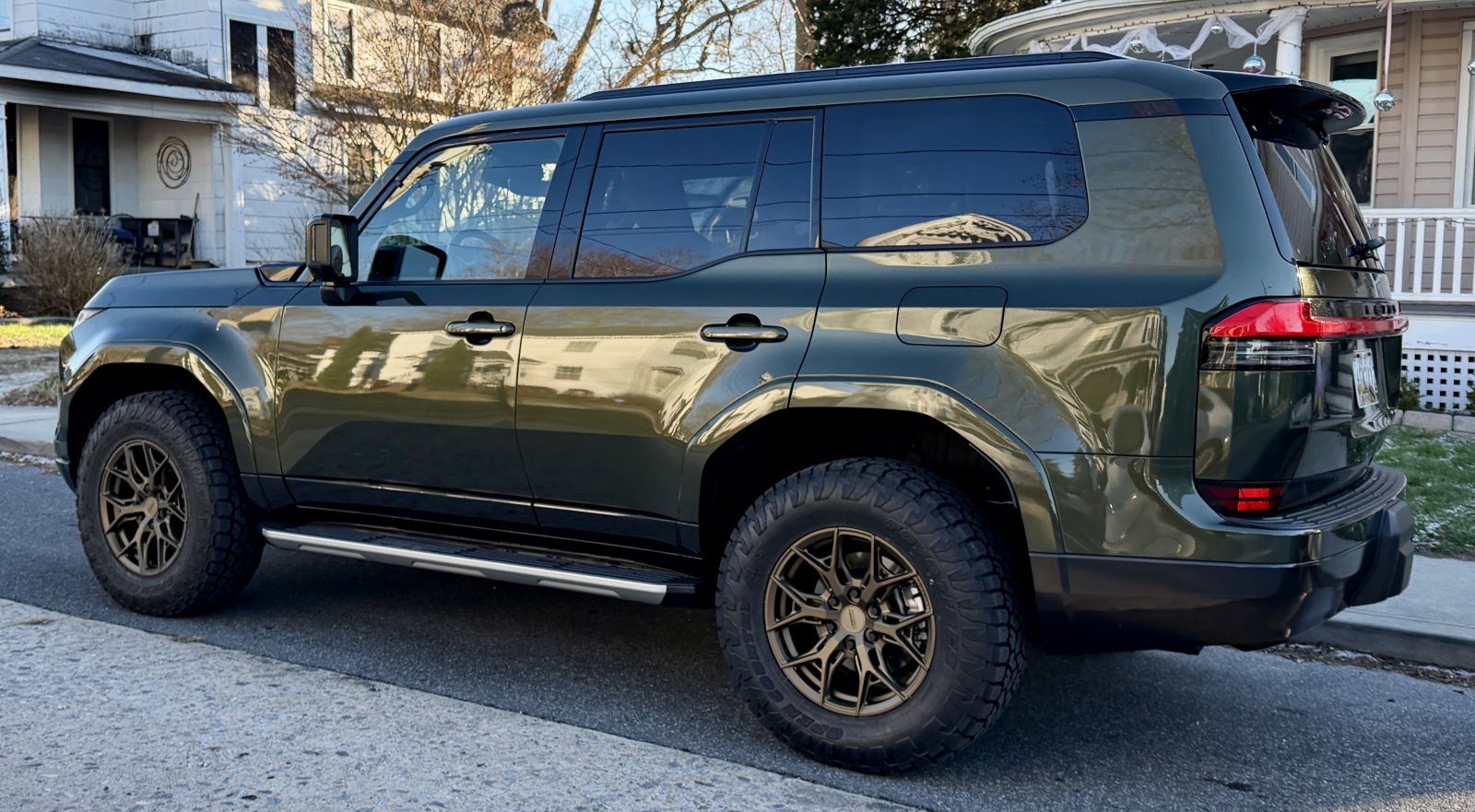

Those look great. I had my eye on those for a while, but ended up going with some Titan Wheels to save a little bit of weight over stock while they had their sale.

This is the setup I want. No rubbing or modifying? Fit a spare easily?
No rubbing, zero issues.
The wheels and tires fit great. I didn't want any poke, but looking for a little more aggressive fitment than stock and these fit the bill.
I did order hub centric rings for proper fitment.
Going from the stock 22" wheels on the Luxury+ to these 18" is a good improvement in ride. Love these tires in the snow and no increased tire noise vs stock.
I will let you know on spare fitment in a couple weeks. I am ordering another wheel and tire for this. I wanted to make sure everything fit properly and I was happy with them before I purchased a spare.
UPDATE
Added the spare tire (18" Method Wheel w 275/65/18) and it fits as it should with no issues.

Thanks. Would love to know more regarding spare when it happens. These are all the same thoughts I have: flush, no poke, more aggressive tire but mainly road use. I'm on a P+, but looking for more rubber than stock.

The spare will fit for sure. I have the stock spare with a 275/70/18 AT3 tire. There is room for slightly larger tire under there before you get into the 34s+.
