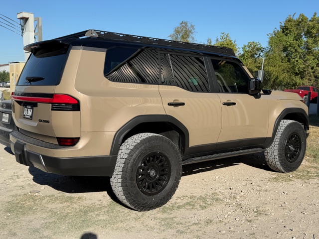

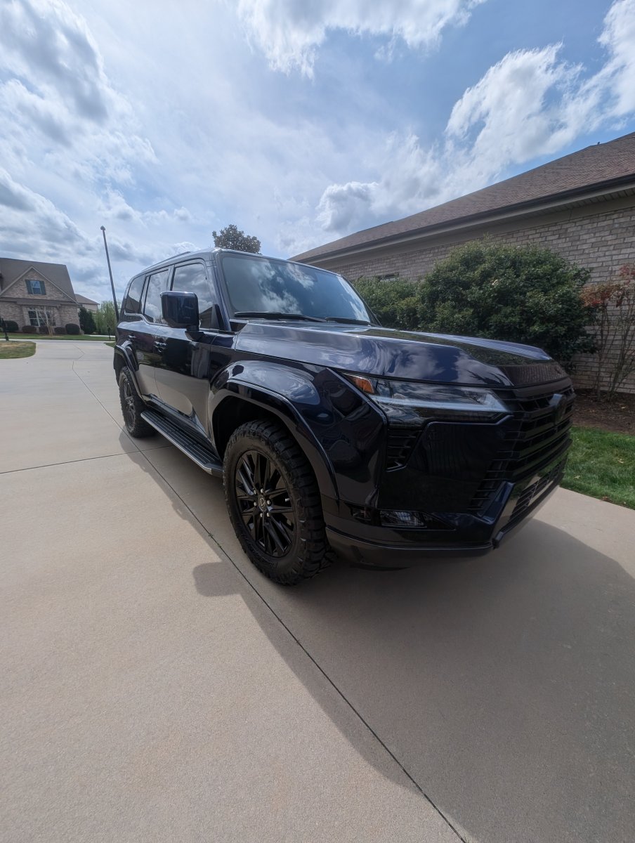

I previously had a 285/70/17 on a 17x8.5 +18. See attached.
My current set up, see few posts above, is pretty much flush but my wheels are half an inch narrower than what you’re looking at with the 18x9.

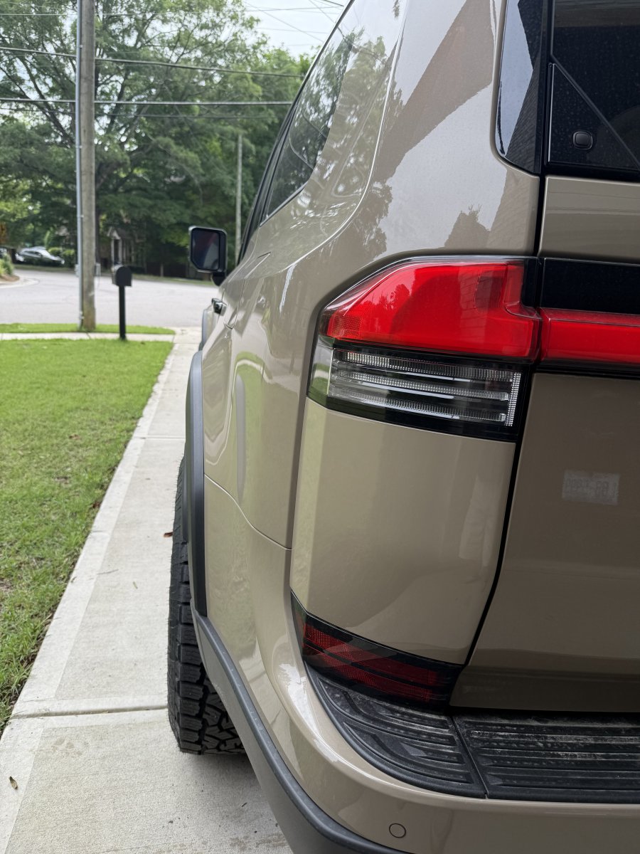

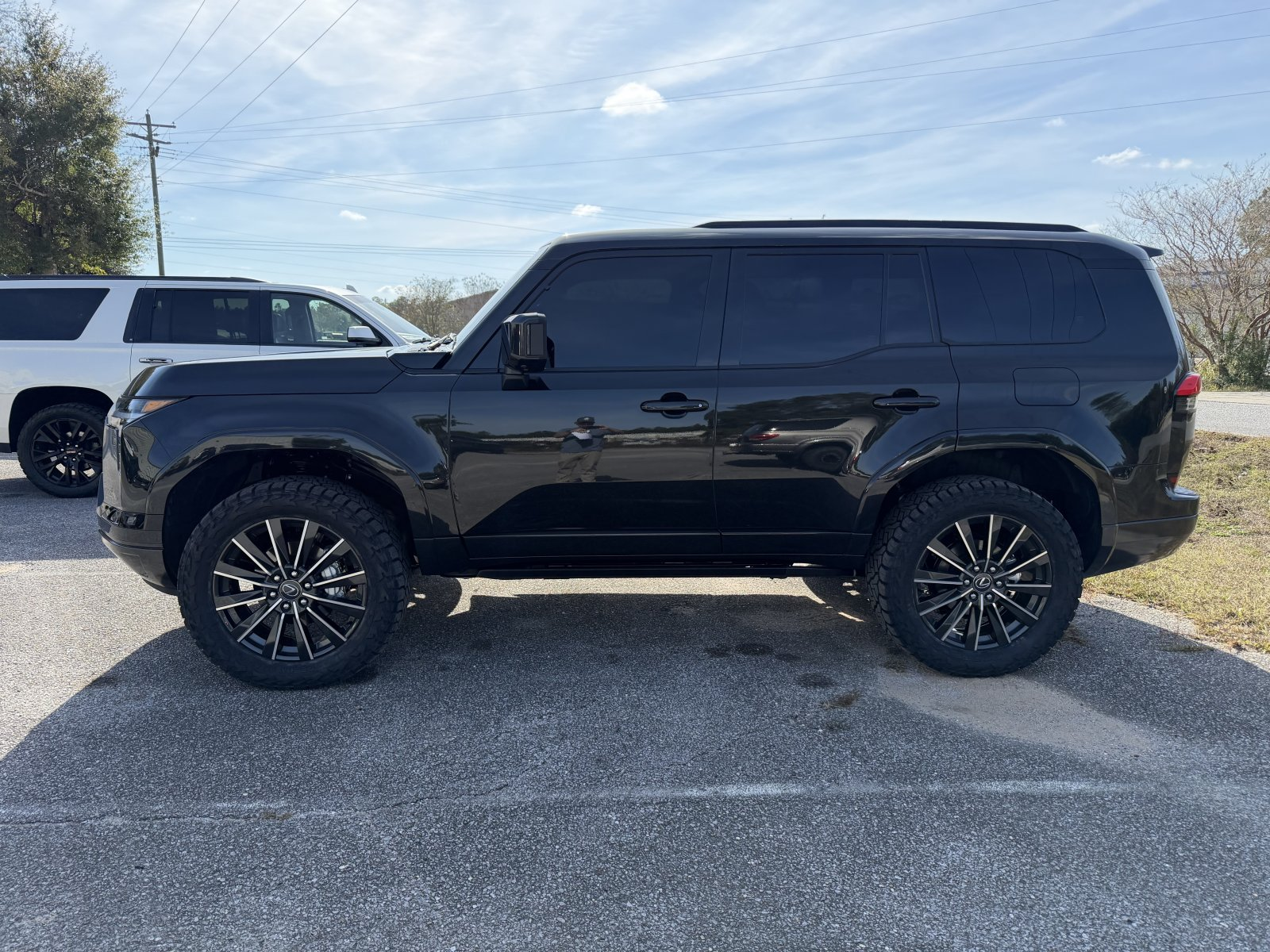

Update - swapped my 305/70r17 tyres out for 35x12.5r17, did a quick walk around for anyone wanting to know exactly how I made them fit: cheers
Is this a 2024? I’ve seen 2025+ owners claim you can run this setup on stock suspension with no rub
I've heard a lot of different things. What i think comes the closest is this westcott designs video ,
i honestly have no idea how others would make this tyre fit on a stock gx550 with no rubbing or trimming. Even with a levelling kit some claim this tyre set up needs no modifications or trimming... Again not sure how that's possible if we're talking about a true 35" x 12.5" tyre. To give you an idea I first mounted the wheel/tyre on the car before i did any modification or trimming and could not turn the steering wheel at all as it was hitting at the front liner and back bracketry in the wheel well.

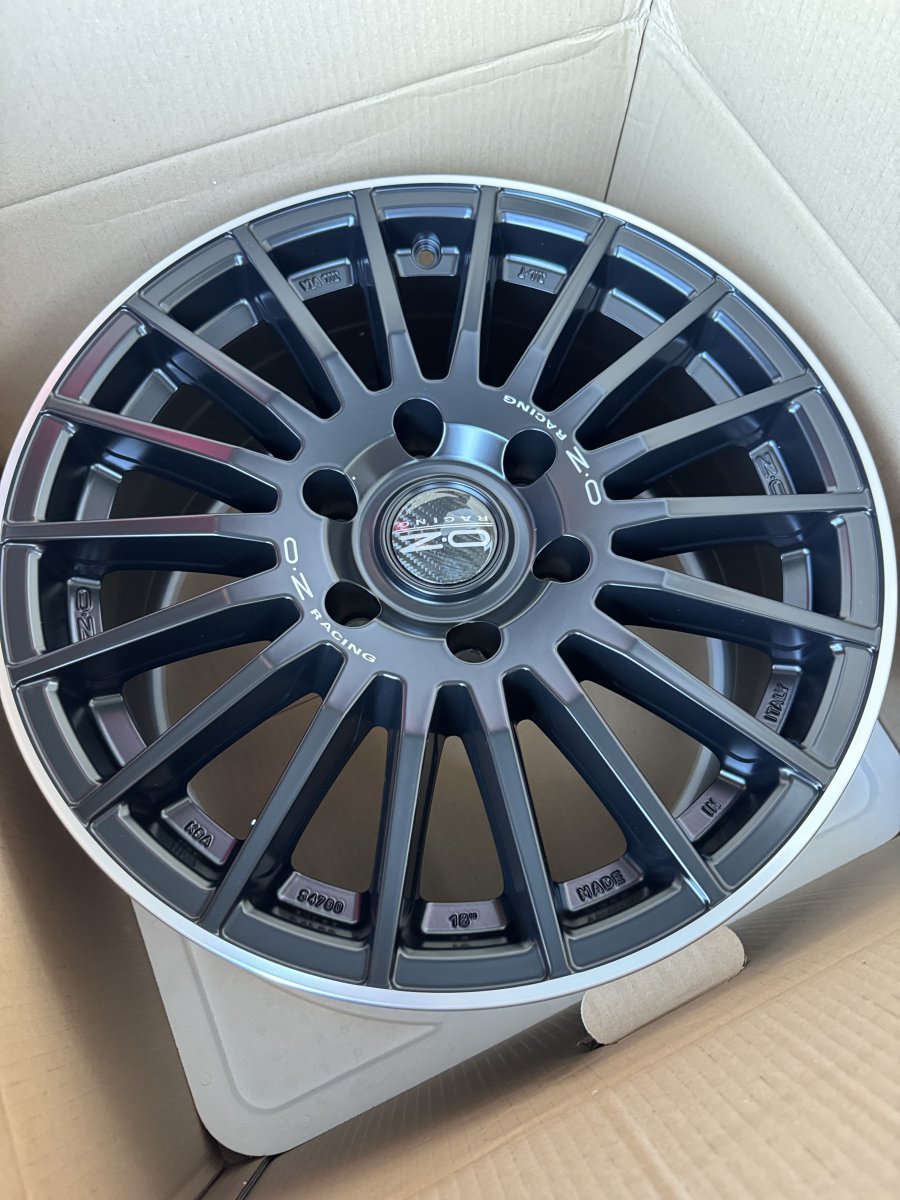

Has anyone installed the OZ Rally Legend 20-inch wheels on their GX 550? Would love to see pics. Tire Rack has them with a +45 offset.

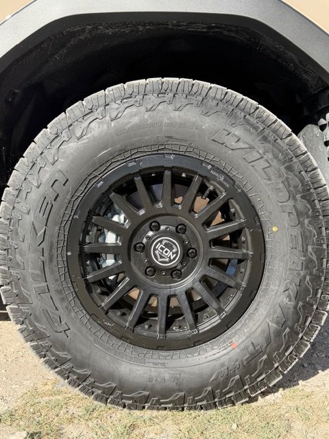

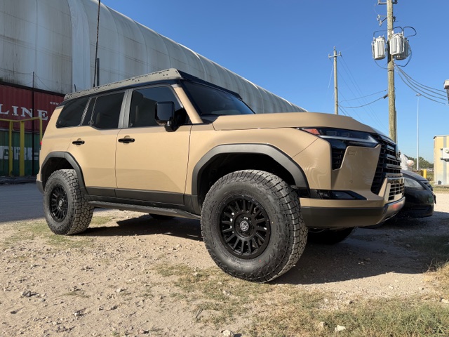

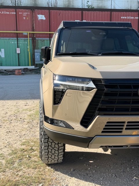

GX2.0 (traded my '24 for a '25 - another story) finally got new shoes this weekend...
Peak Performance 1.25" spacer in the front to level her out.
18" Icon Recon Pros w/ 40mm offset.
Falken Wildpeak AT4w 35x11.5r18, Load C (34.9" dia. x 11.9" wide @ 62.6lb).
"Crash Boxes" unbolted and removed from behind the front tires.
Minor rubbing in the front which required pulling the fender liners forward about 1/2" (drilled new holes and remounted) and a VERY small trim on the corner of the bumper to line up w/ the new position of the liners - easy peasy and looks OEM but will likely replace the front bumper anyway over the winter. Full flex test w/ a forklift and no rubbing or clearance issues inside the wells whatsoever.
Looks amazing. Rides great. Very little poke (basically flush).
Discount did the install and alignment, which took quite a bit longer than normal due to the pins.
Love the wheels (satin black looks so much better than the matte black Methods I had on my '24) and the bead lock 'innovation' is slick. A lot of hate on Falken tires out there, but this particular size is a Load C w/ decent weight specs, and boy are they smooth - I generally run Toyo AT3s, but this is my second set of Falkens and I'm thrilled with them so far, just as I was with the first set.

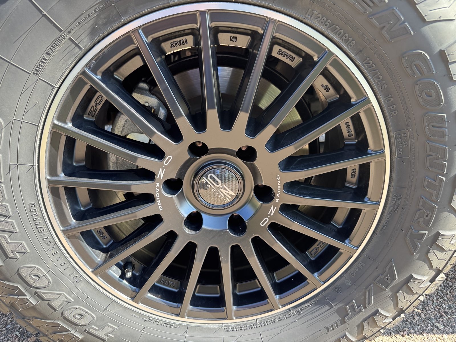

MrAce,

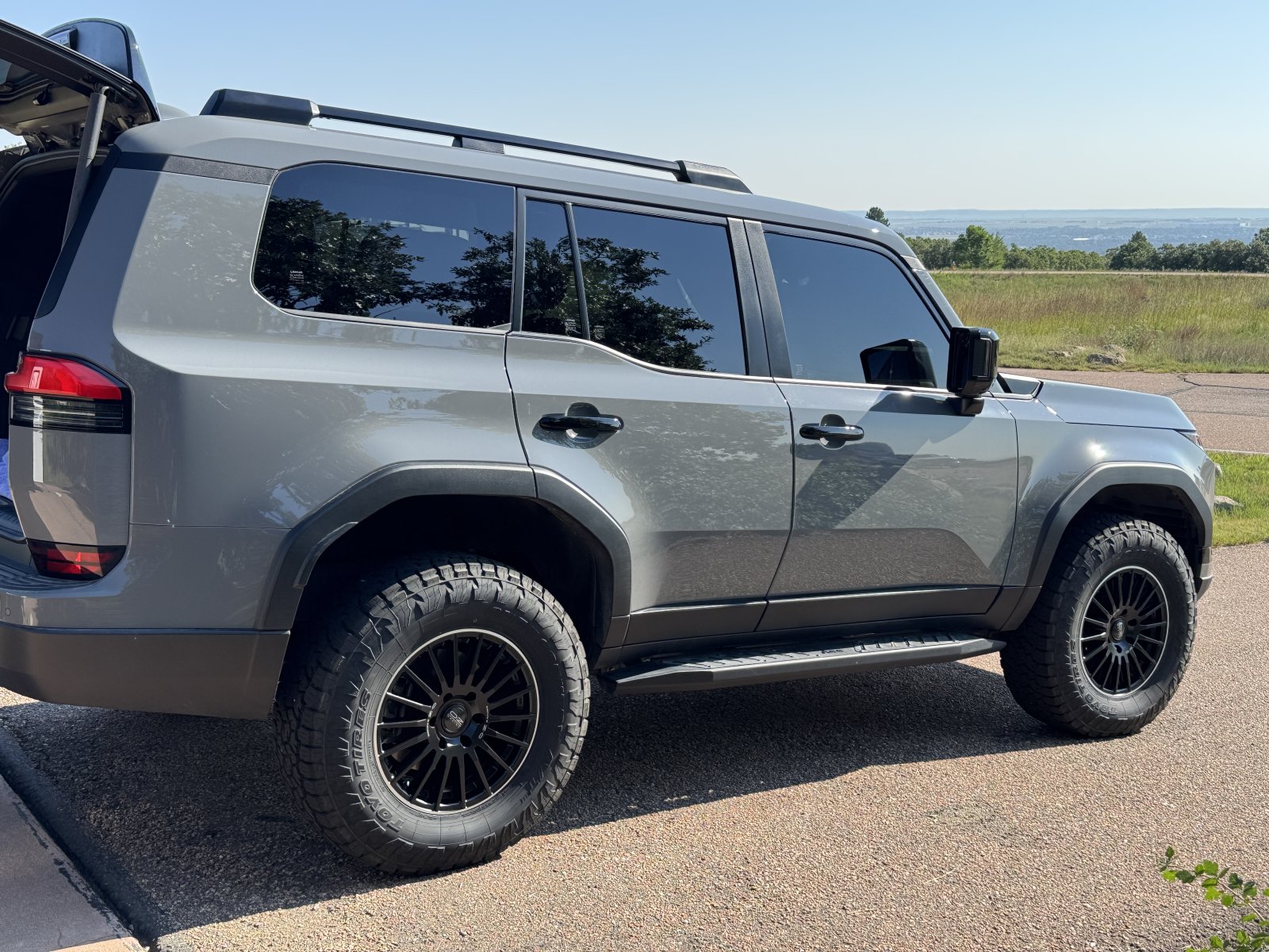

Not much help to you. But I’m using the O.Z Rally Desert, 18x8, +25. From Tire Rack / Discount Tire. Very high quality build, but not forged so it’s a lot heavier than most on the forums here would ever want; understandable. It’s a bit more heavy duty..which I’m good with for towing. I feel like I can beat on it with no worries. I’m using some NYTOP metal hub rings to ensure perfect mounting. Absolutely gorgeous wheel in person.
I strongly looked at many high end forged wheels, but couldn’t quite get a look I really wanted for the $$. So went this route. In the future I may relegate this to winter duty..we’ll see.
