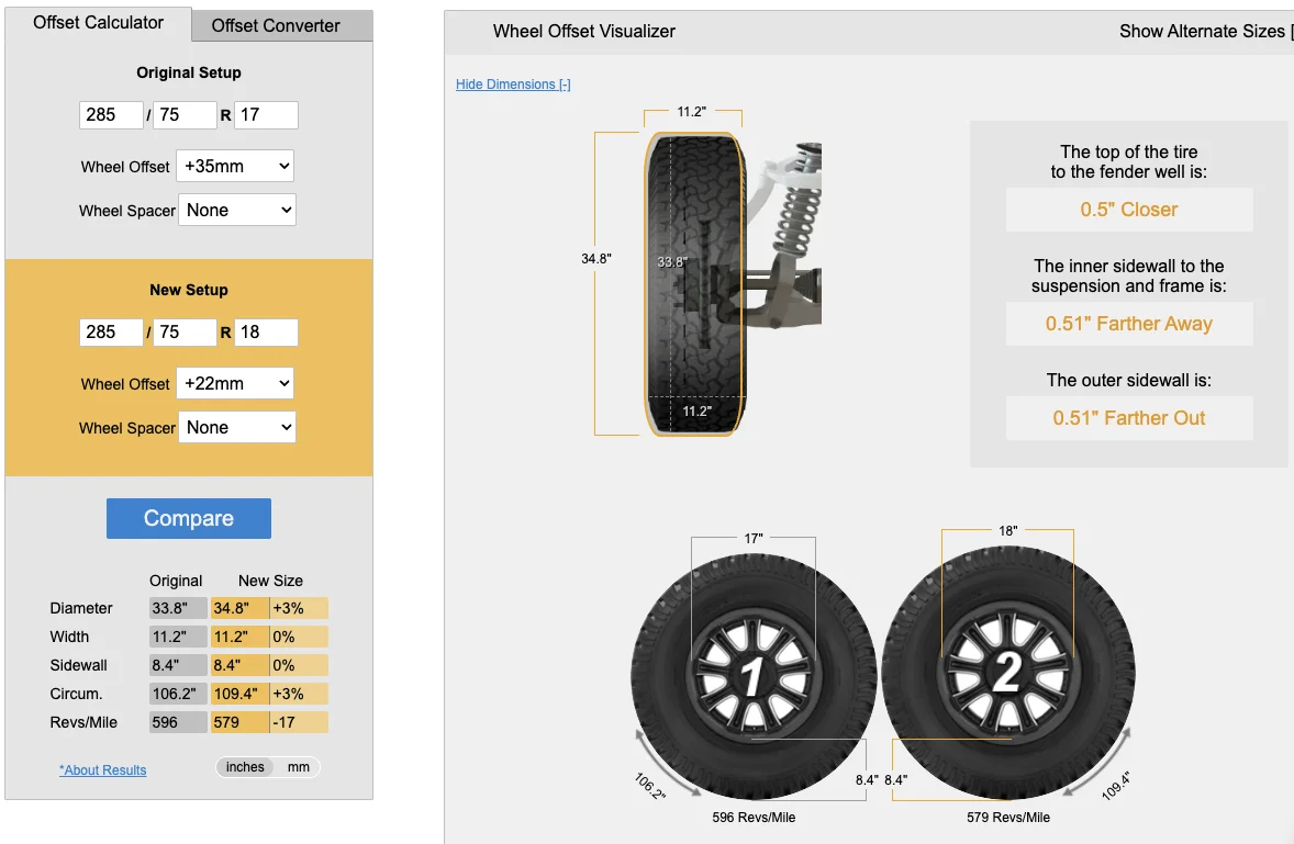

Appreciate as always Bro! The wheel set that Im looking at is a 18x8.5 with a +22 offset. Trying to see if I can fit 285/75/18 tires.
you will basically be .5" larger radius and .5" further out from my setup. What that means...who knows?...lol
