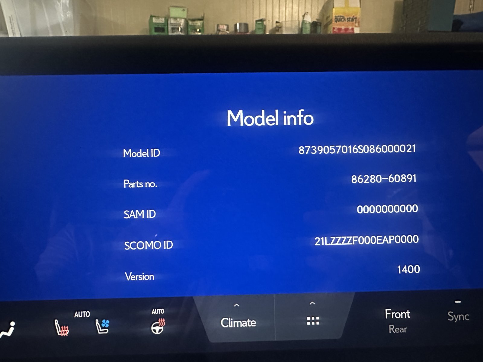

Wait a moment, the part version No. on my GX, which built in Jan 2025 was 1300. the part No is 86280-60890. I guess 1200 was the version No. for TX?

I have the same part number and version as you do and I’m not experiencing any audio difficulties or performance issues. My vehicle was built in July 2025 and delivered in late August 2025 .

A few weeks ago, I was using ChatGPT to aggregate some data related to this issue as well as the TSB that fixed the issue in the Lexus TX. The following is the final output that resulted from a series of prompts asking if the Mark Levinson issue had been addressed in my specific 2025 GX550 Overtrail+:
On your AP SW screen you now have:
  • Parts no.: 86280-60891
  • Version: 1400
Here’s how that lines up:
Known TX “fix” reference
  • The TX TSB (L-SB-0029-25) ties the correction to amplifiers in the 86280-0E3xx family, with software versions in the 13xx–14xx range after replacement. Owners report the fixed units show “Version 1400” (or higher) on their AP SW screen.
GX situation
  • The GX550’s amplifier family is different: 86280-6089x, not 0E3xx. Catalogs list 86280-60890 as the “base” ML amp. Yours (…60891) is a later revision not yet tied to a public bulletin.
  • The fact your software version is 1400 suggests you’re running the same generation of firmware that TX owners describe as the “fixed” set. That’s a positive indicator that your amp revision incorporates similar updates.
  • But: Lexus hasn’t published a GX bulletin or campaign, so there’s no official confirmation that 60891/1400 is the GX equivalent of the TX fix. It looks promising, but not “documented.”
Bottom line
Your GX’s 86280-60891, Version 1400 strongly suggests you have a newer Mark Levinson amplifier revision with updated firmware, analogous to the TX’s fixed amps.
However, since the TSB is TX-only, Lexus hasn’t formally declared this a GX “fix.” So functionally you likely benefit from the update, but it isn’t recognized as a campaign item for your VIN
I hope that this is useful to some of the members of the forum following this thread!

My July 2025 production Luxury+ also has the 86280-60891 amp, version 1400.
The bass does not appear to fade in and out, but the default frequency response and fader tuning is still pretty garbage, IMO. The 120-200hz-ish region of male voices is super over emphasized and "woof-y", like a poorly integrated, overpowered sub. I still get very little volume when fading the audio to the rear speakers.

Another follow up post here after much testing and fiddling. Again - I have a July 2025 production GX with the updated 86280-60891 amp, version 1400 in the infotainment.
I think I've nailed down the bass fading issue - it seems to be due to the "Auto Sound Levelizer" speed sensitive volume setting. Disabling this setting produces full, thumping bass at any volume I'm willing to listen, with the bassiest EDM and phonk music I have. I haven't experienced fading bass or tinny, harsh sound since I've disabled it.
The Auto Sound Levelizer appears to change both volume and frequency response, boosting bass and treble as the speed of the vehicle increases, so I'm guessing it tries to boost the bass beyond some misconfigured safety protection level, cutting bass earlier than it's supposed to. I've run bassy music well louder than what I was playing before and it's so bassy I've discovered a rattle in the driver's door that I never noticed before.
Sadly, I have to manually increase the volume as the wind noise increases, but it's a small price to pay to have a decent Mark Levinson system back.
