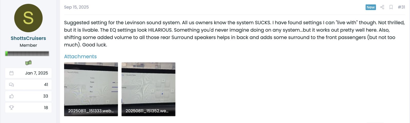

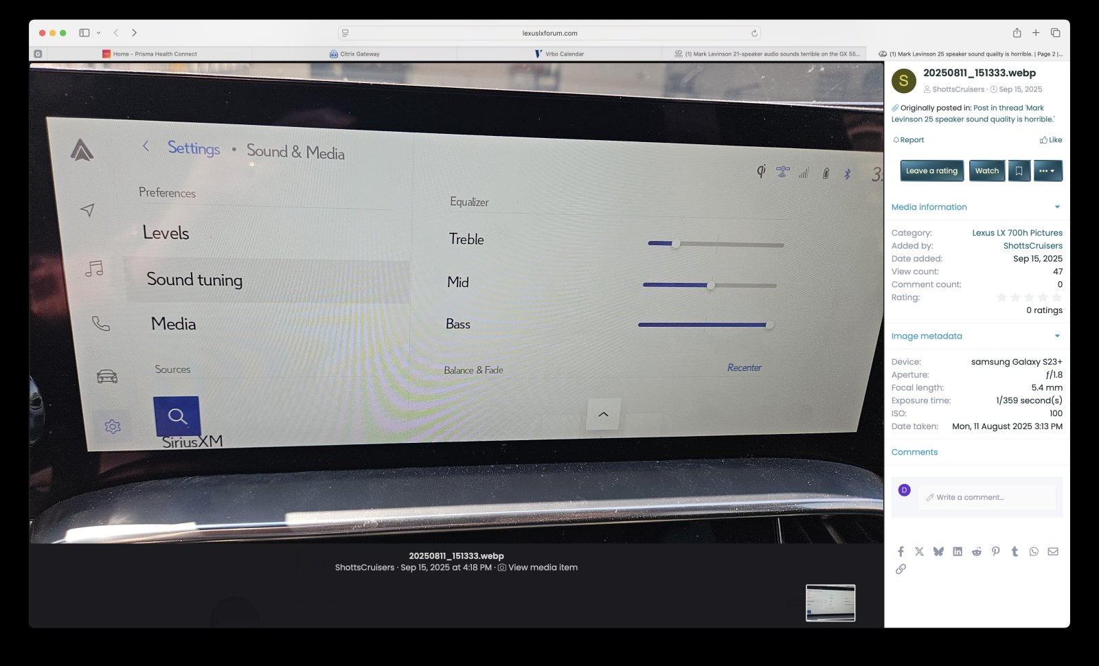

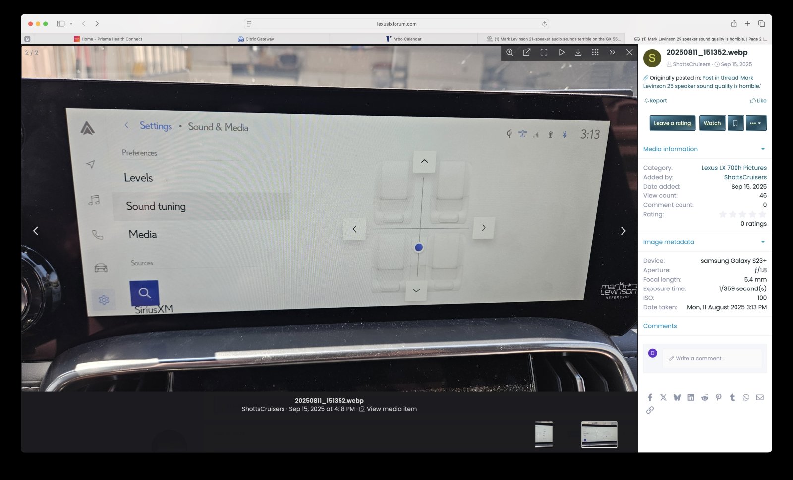

Someone posted this on the Lexus LH forum, and to my untrained ear, it really helped a lot. Also, bass hasn't cut out since I tried this. Sound improvement is especially noticeable at mid/low volumes. Sound is subjective, but maybe worth a try to see if it helps.

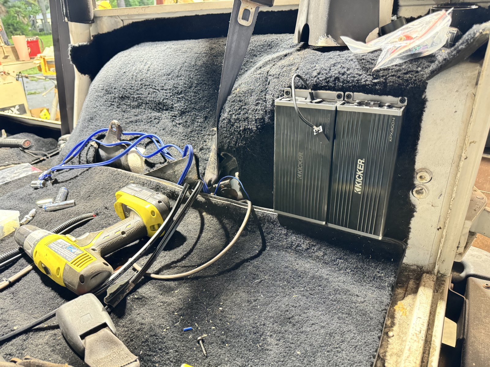

In my past life I was an installer. Tin Ear is pretty much spot on. If you need more bump in the ML system, just about the only thing you can do is tap the front door woofers for a high level input amplifier, for simplicity sake, one that has built in DSP.
I plan on attempting this when I eventually get my GX. Of course ill report back with detailed instructions for my valued forum members. I’ll be using one of the two mono amps:
Kicker 47KEY500.1​
Or the expensive:
JL Audio VX600/1i​
I think I’ll wind up using the Kicker since it’s a much simpler design and they’re built in tuning is pretty darn good and also simple. I also have experience with this class amp with my BIL’s Wrangler install I did and couldn’t believe how much power these little things cranked out.
For a sub I’ll use the Dayton Audio RSS315HO-44 12" or if I can get my hands on another Peerless XLS 12” (but that’s almost an impossible find) which was one of the most musical subs I’ve ever heard. The model was XLS-P830500 I believe and last I checked you can’t just get one… you had to buy like 300 of them in bulk before the Tymphany factory would even talk to you. Group buy anyone? Haha.
Edit: For clarification, using the door woofers rather than the anemic subwoofer is your best bet as it’s likely to carry a broader frequency range than the sub in the tailgate. But for the benefit of all I’ll try both locations.
Adding on, I used to advise people to buy a vehicle with the cheapest audio it can come with. In fact, if you had an option to get a new car with a hole in the dash to get that and add your aftermarket system then. Now these days I tell people the opposite because systems are so damn integrated. But today’s ML Lexus systems seem to be an outlier along with a growing list of other manufacturers.
Kicker 47KEY500.1​
Or the expensive:
JL Audio VX600/1i​
Thanks Remmy. I don't know a lot about car audio, but would love to find a way to get more bass without a huge investment or worry about an installer tearing the car apart. Are you saying that this one amplifier could be used to improve the woofers in the front doors, while keeping the rest of the factory system intact? Can one amp be used for both speakers? Where do you think this amp could be mounted to be as discrete as possible? And you think this can all be done even with all the issues Tin Ear brought up? Thanks so much for this info.
No. I’m implying an external aftermarket amplifier with aftermarket subwoofer is a solution. Everyone complains the system has no bottom end.
The signal wiring would likely tap off the front door drivers. I suppose a specialized LoC could also sum the subwoofer channel but I don’t know how effective that would be since users report little actual sound from the factory tailgate sub.

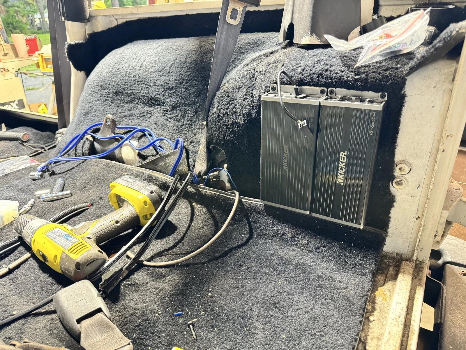

The Kicker brand amplifier is tiny compared to typical subwoofer “mono block” amplifiers. Like really tiny and can go down to 1ohm stable which people here who know, know that’s crazy… in a good way.
I haven’t had a good sit down with a GX yet but I’d wager this amp could be squeezed into almost anywhere.
I’ve attached a pic of the install I did in my BiL’s Jeep last year. Mounted next to it is the 4 channel version as well. Being in a Wrangler you can see how small they are. Very impressive for their size.
