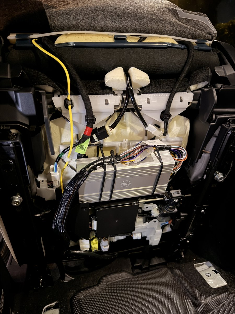

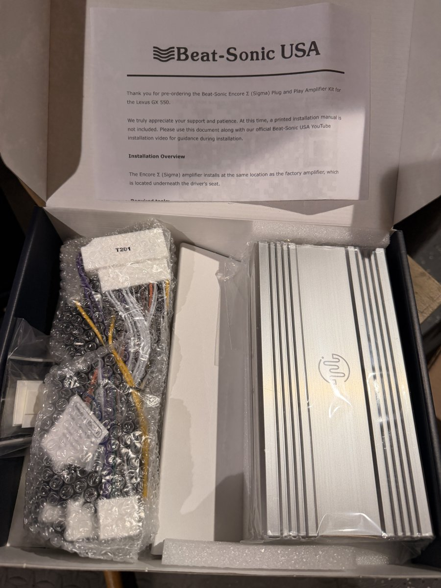

Beatsonic Sigma Amp
Great improvement of the stock premium system. Better sound (highs/bass) and clarity and the ability to play louder with less distortion.

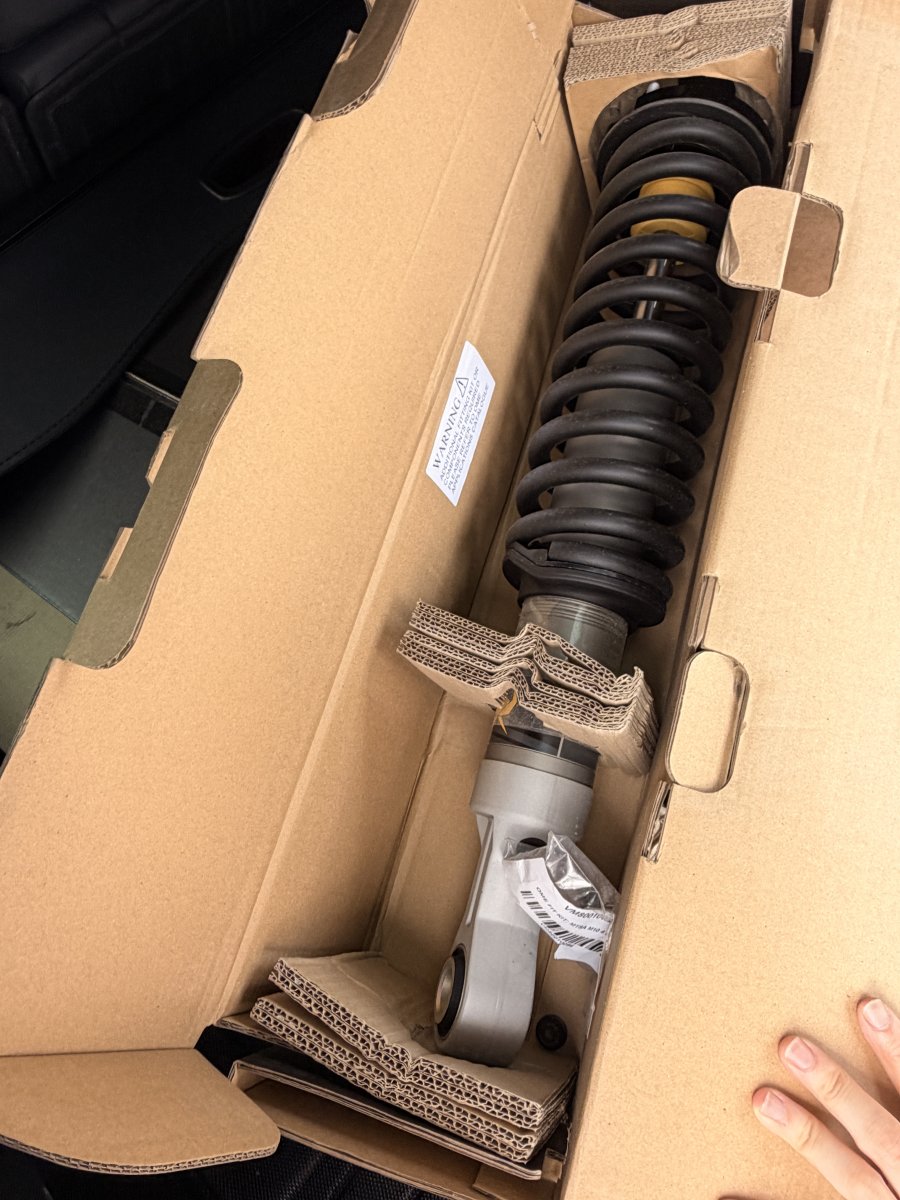

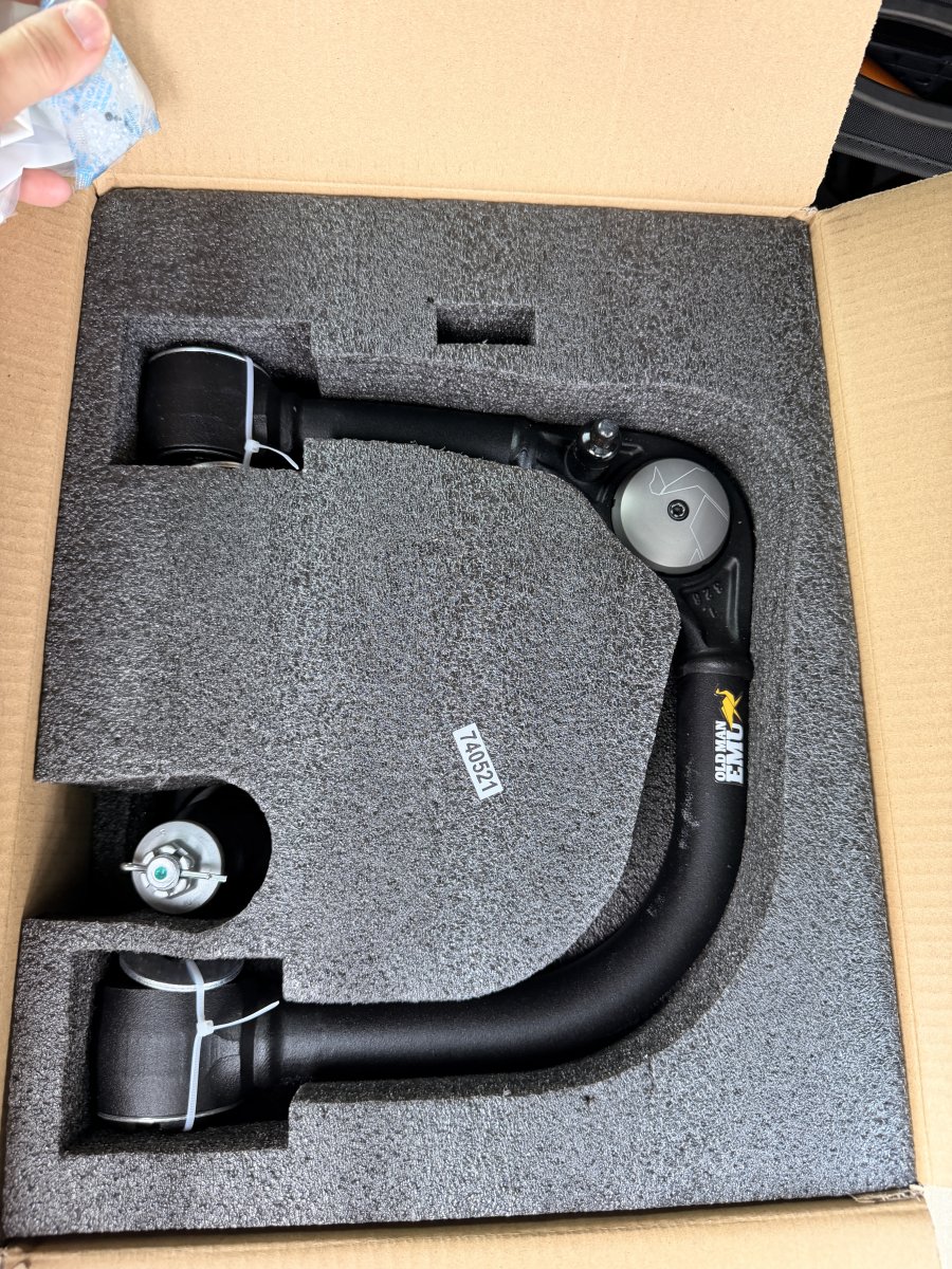

OME is installed with a much more compliant ride. Soaks up the bumps a lot better. Still need to figure out my tire PSI as I think I’m quite high at 40 psi cold (or maybe not). Added 1” all around over what the Westcott added
Anyone else running 285/75/17 Load C tires want to share their Psi?

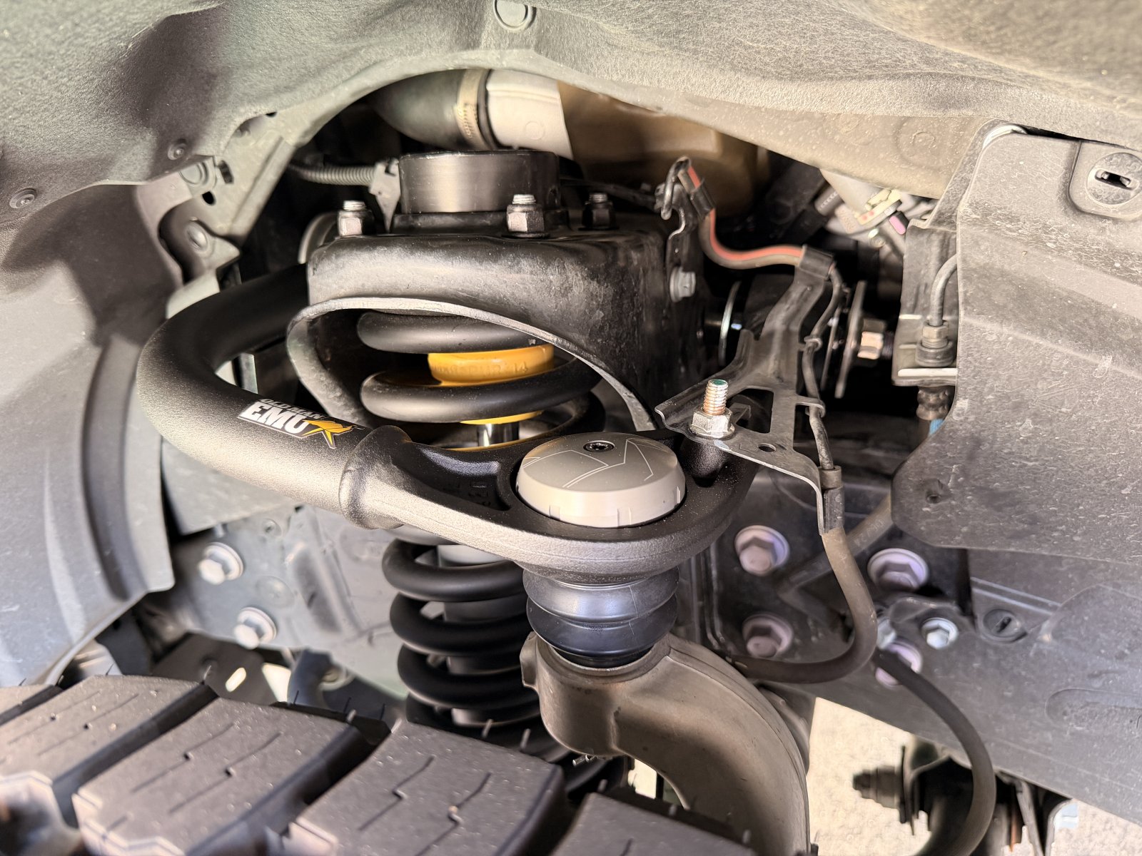

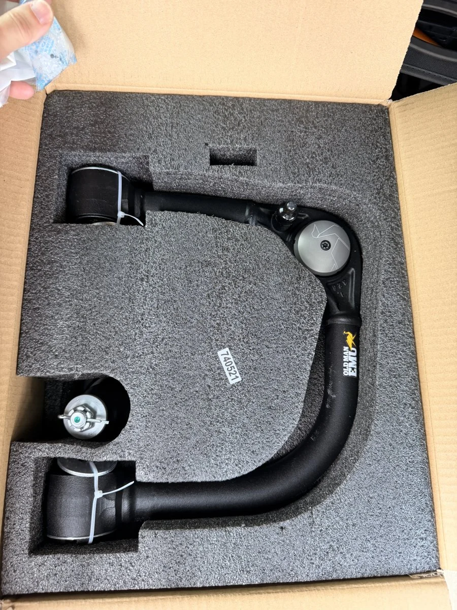

Damn they go hard on that ball joint dust cap screw or what ?
I noticed somethings I didn’t like when the shop installed my kings so I notice small things like this
Luckily, it’s an Allen head and although it appears chewed up, the proper sized Allen head still fits securely and the issue is cosmetic.

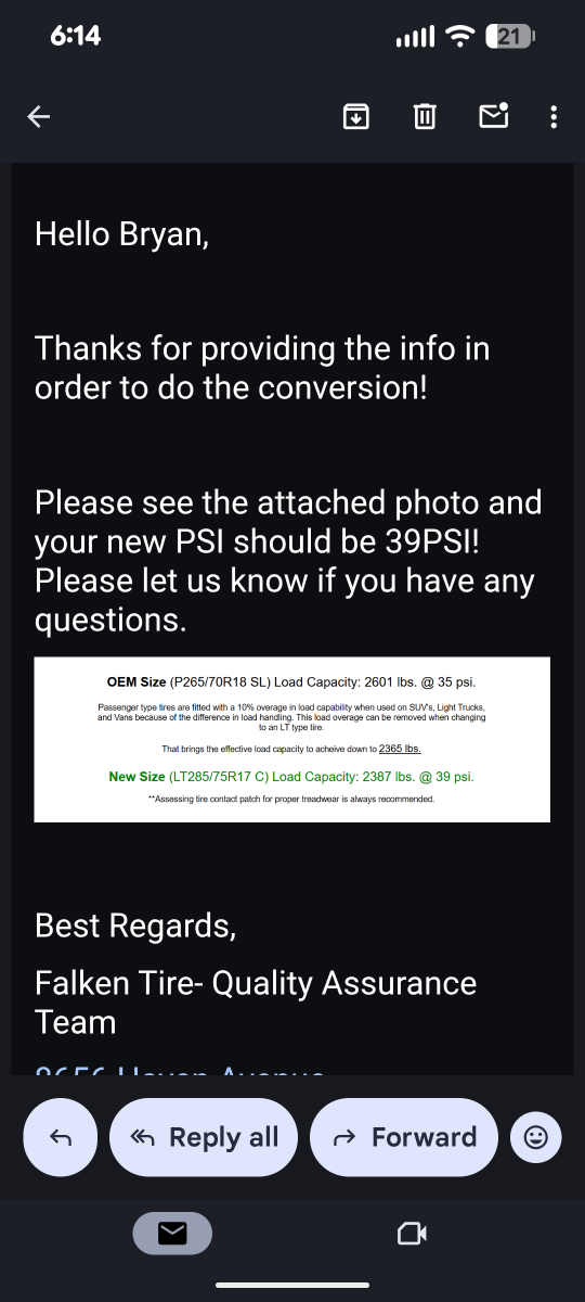

I'm running 285/75/r17, the below screenshot is per Falken tire QA folks.
