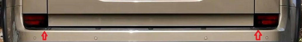

I have been working on this same thing for some time now. There is a factory rear fog light but not for the US market. I had this option on my Volvo and miss it. I am getting details on the pats and need to work out how to activate it(them). There is a different light control stalk with that option integrated. The light bracket for the US spec appears to have the cutout for the bulb/lamp. The reflector is just missing the lens in the corners (see picture). This will be one of the first modifications I intend to do.

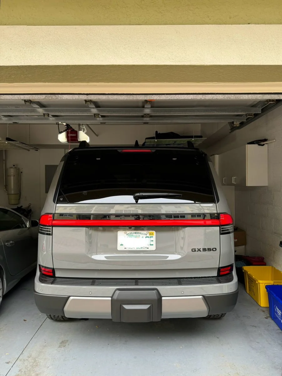

The quest continues... Here is a preview of the rear fog lights on. Enjoy
Reallyy nice, NOTICE the nice looking hitch cover!!!!!!!!!!!!! WHY do we get that big black diaper looking cover here in the states?????????????

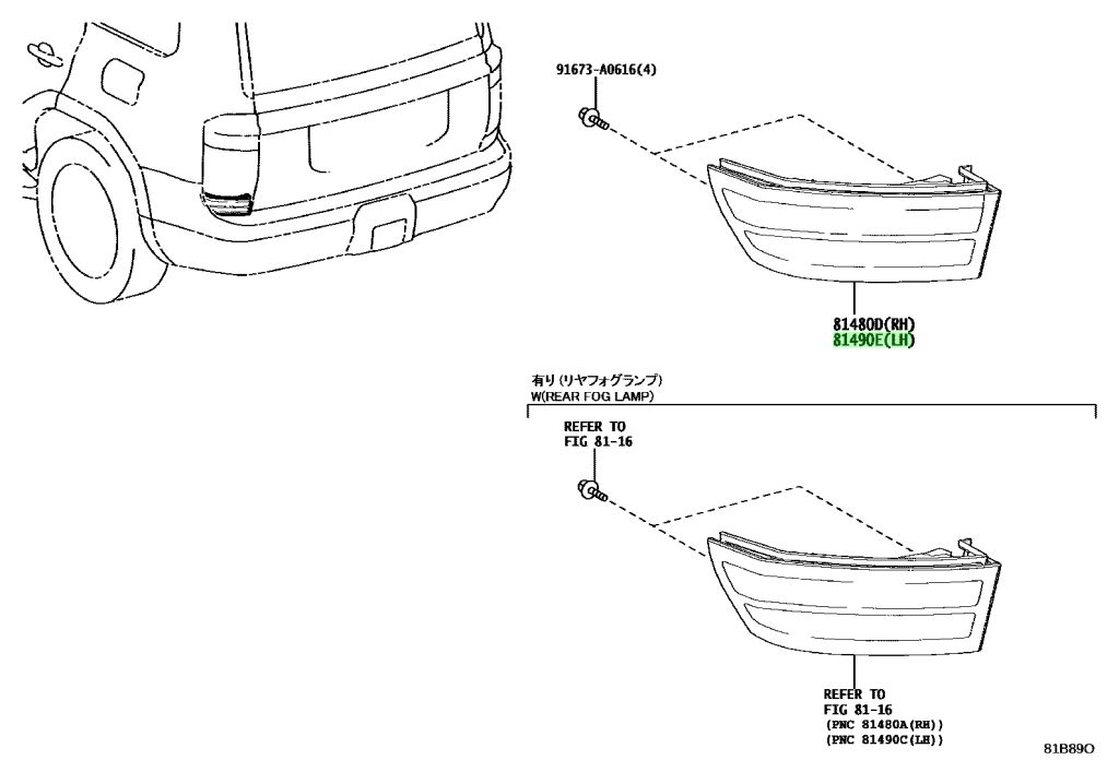

I think these are the part numbers...
LAMP ASSY, REAR FOG, RH (8148060160)
LAMP ASSY, REAR FOG, LH (8149060160)
Just the reflectors have different part numbers....
REFLECTOR ASSY, REFLEX, RH (8148060150)
REFLECTOR ASSY, REFLEX, LH (8149060150)

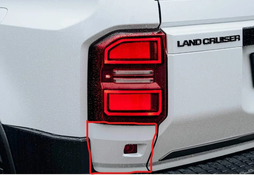

Looks like our LC brothers have some success retrofitting rear fog lights
